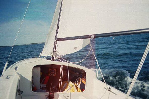

My jibsheets are rigged as shown for the PORT side jibsheet, I have had my DS II (and one of those rigging diagrams) since 1996 and was so familiar with the rigging that I failed to look closely at the diagram before answering. (I missed your question!)
Look below for a picture of how my boat's jibsheets are rigged, note that the lazy sheet leads around the forward side of the mast <GRIN!>
I was answering 31seahorse based on the CORRECT way the sheets should be rigged, not based on the error in the diagram. Now that you mention it, I had noticed the error on the rigging guide before..... but had forgotten about it. I answered based on the fact that I couldn't see why it would be difficult to tack with the jibsheets rigged as shown for the portside.........which DOES work fine.....and COMPLETELY missed the error in the Starboard side jibsheet.
OOPS!
By the way, the jibsheets do need to lead INSIDE the shrouds on these boats, in order to be able to sheet the jib in all the way. It does cause the shroud to sort-of get in the way of a straight lead for the sheet when running before the wind........ but I only notice that if using my whisker pole.
