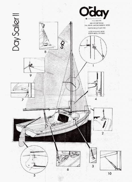

In the drawing the mast appears stepped to the roof of the cuddy cabin. How is your boat's mast set up? I think you could easily fabricate another roof with plywood and fiberglass... but it might be worth your while to find a complete boat to investigate, measure, photgragh and compare before you make your decisions.
By the way...... look at the drawing closely and tell me what's wrong with the way the running rigging is depicted in this "factory" manual.

Yes, Joe, the rigging is....interesting

RE: Joe's picture......Tacking would be more complicated with the jib sheets lead as they are in the picture. I think I've tried that!

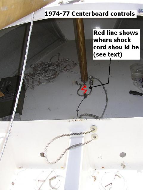

I'd say put some thought into the boat over the winter and by Spring you can start rebuilding. I doubt it would really be worth restoring to "factory" specs, but either a canvas cover for the area (problem of fitting around the mast though?) or a plywood version of the cuddy could work, it would not have to be exactly as original. One consideration, depending on when in the 1977 Model Year this boat was built, the Centerboard is held down by a line that runs through a block on the inside of the cuddy, the block is mounted to the inside of hte cuddy top directly above the forward end of the centerboard trunk. If this boat is an early 1977 model (built prior to October 1, 1976) the centerboard down line will not be affected. If built after 10/1/76 then you will need to restore a mounting location for that block. (picture below of how this looked stock)

31Seahorse, what do you mean by saying that the jibsheets as rigged ithe picture would make tacking difficult?? Most if not all Day Sailer II boats have been rigged that way since 1975 or so, my 1979 model is rigged that way and I have no trouble tacking..... I did need to angle the camcleats a bit further aft to accomodate single-handing, but with a crew the factory setup works fine. The earlier Day Sailers had the jib sheets running through adjustable blocks on the inside of the cockpit coamings and lead to cam cleats on the top of the CB trunk (I had that setup on my old 12' O'DAY Widgeon and it works pretty good, except the jibsheets may be a tripping hazzard as people move forward/aft in the cockpit. The O'Day Javelin is rigged the same way as the DS II.
Lazy sheet on the foresail is routed aft of the mast?
bingo!....... You could run sheets inside the shrouds depending on the lead angle, but behind the mast?
Sunbird...... did you really rig your jib sheets like that?

I've tried to run sheets sorta that way on a spinnaker, once.
However, 31Seahorse did get it right first.
