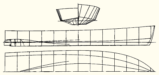

I'm thinking of a hull form like this which would be an enlarged version of a design by Bill Atkin. Robb White built and owned a modified version for many years.
I think I could get about 2 foot draft on a boat that would be about 40 feet long but quite narrow. I would only power it for displacement speed, 7-8 knots.
What ever I got for another boat, one of the two top items on the list if it does have sails is a mast that I can get up and down myself. I might put steadying sails on the Rescue Minor hull but it is not one that would drive very easily under sail.
Another feature it would have is a watertight hatch with a plug over the prop that could be removed for complete access to clear crab pot lines or other fouling.

Great looking hull. Would be ideal for SW florida. My wife lusts after a Pilgrim 40 but it draws 4 feet.

The watercloset access to the prop is a very fine idea and quite common in Europe. Like the controlable pitch prop, not so common here. To work even in calm water you need the sides of the watercloset coming up a foot over water level, so leaning down into it to get at the prop means a long reach and quite likely head under water, so a neoprene hood, a mask and a snorkle are also needed tools, but it still beats diving in the cold and the dark.

To work even in calm water you need the sides of the watercloset coming up a foot over water level...
The RM hull form already puts the prop tips above the waterline. I would almost certainly have the prop well opening into a watertight and self draining cockpit. It wouldn't be much of a reach on a boat like this down to the shaft. I'm sure I can work it out so you could open it in any conditions as long as the prop wasn't turning.

How about a tunnel drive? should be able to put a guard around the prop to keep things out of it.

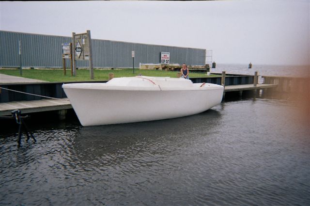

sail boat already proto typed
Roger,
Find picture of 27 foot shallow draft sailboat with deck stepped mast and system to raise and lower for bridges, etc. The picture is of a proto type never finished. Builder is 85 year old boat builder who is still around and would like financing and partner.
If you want to see hull in picture you would have to back track to North Carolina on the Albamarle River.
Ed K
