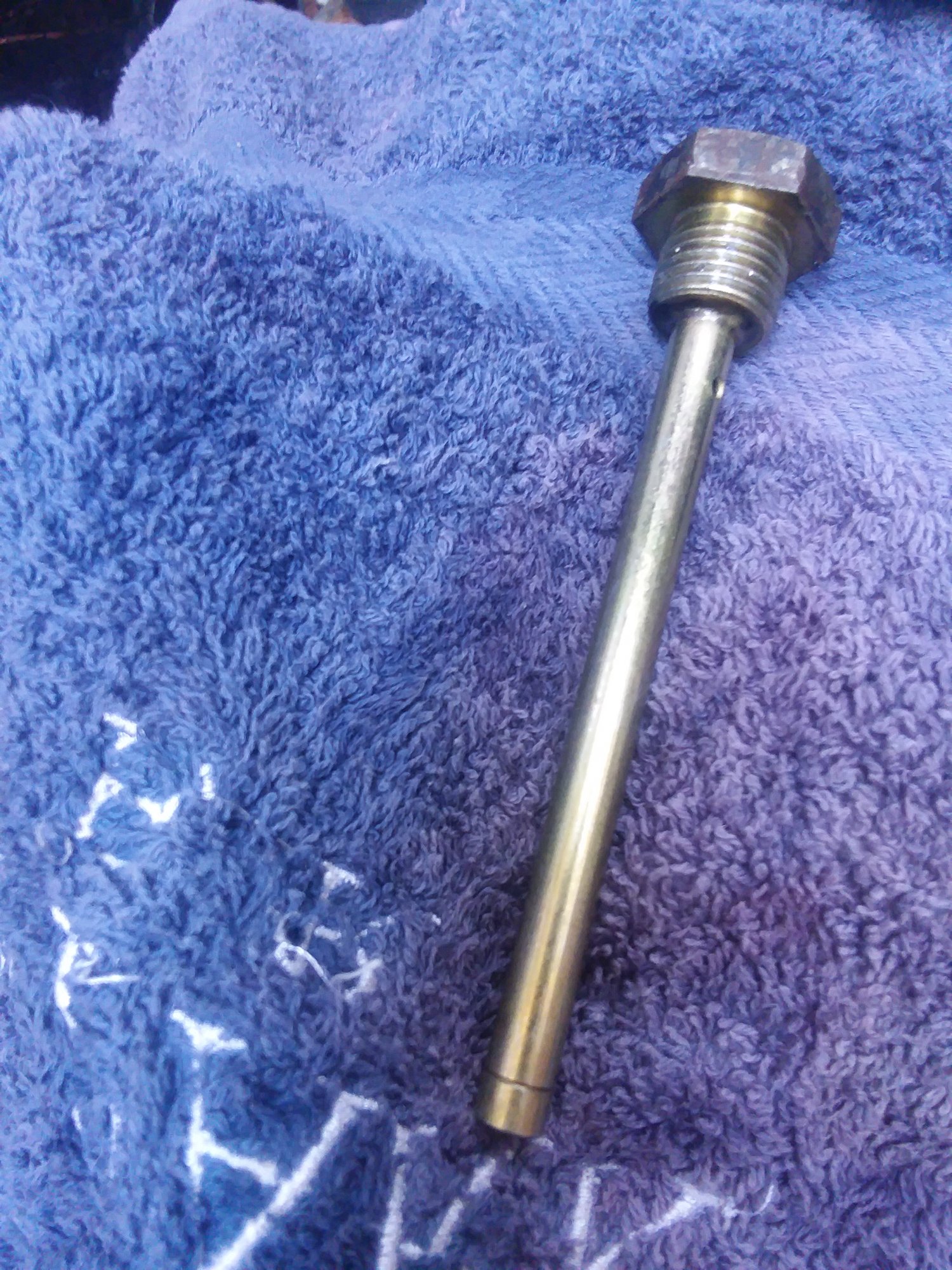

Very simply, how am I supposed to read this dipstick? Oil line right on the grooved line? Above it? Up tot eh hole? Something else? Thanks for any help and sorry for what I am sure is a silly question.

Usually just up to the line, for most with the stick fully inserted but not screwed down, not much oil, usually measured in fractions of less than half a quart.

Helps to know the Xmission make but the stick appears the same as everything else one sees here.
The fluid is filled TO the line. But even more important than that, is that the dip stick is not screwed into the Xmission casing when checking the fluid level.

Please refer to these threads below where the level should be filled to. Please be careful not to overfill since the transmission case holds a very small of oil.

Just went through this myself on our 3YM30. I pumped out the old fluid, and replaced with the listed capacity of 300 mL. The level was here (With dipstick screwed in):
Turns out that was too much. After a test run it was all foamy. After reading the link in post 4 above, I pumped it all out and drained it from the drain plug. 320mL came out, so there must’ve been a little left in after the first pump out. I put 275 mL back in, and the level was here (with dipstick unscrewed):
No more foam after that, so that’s what I’m going with.
