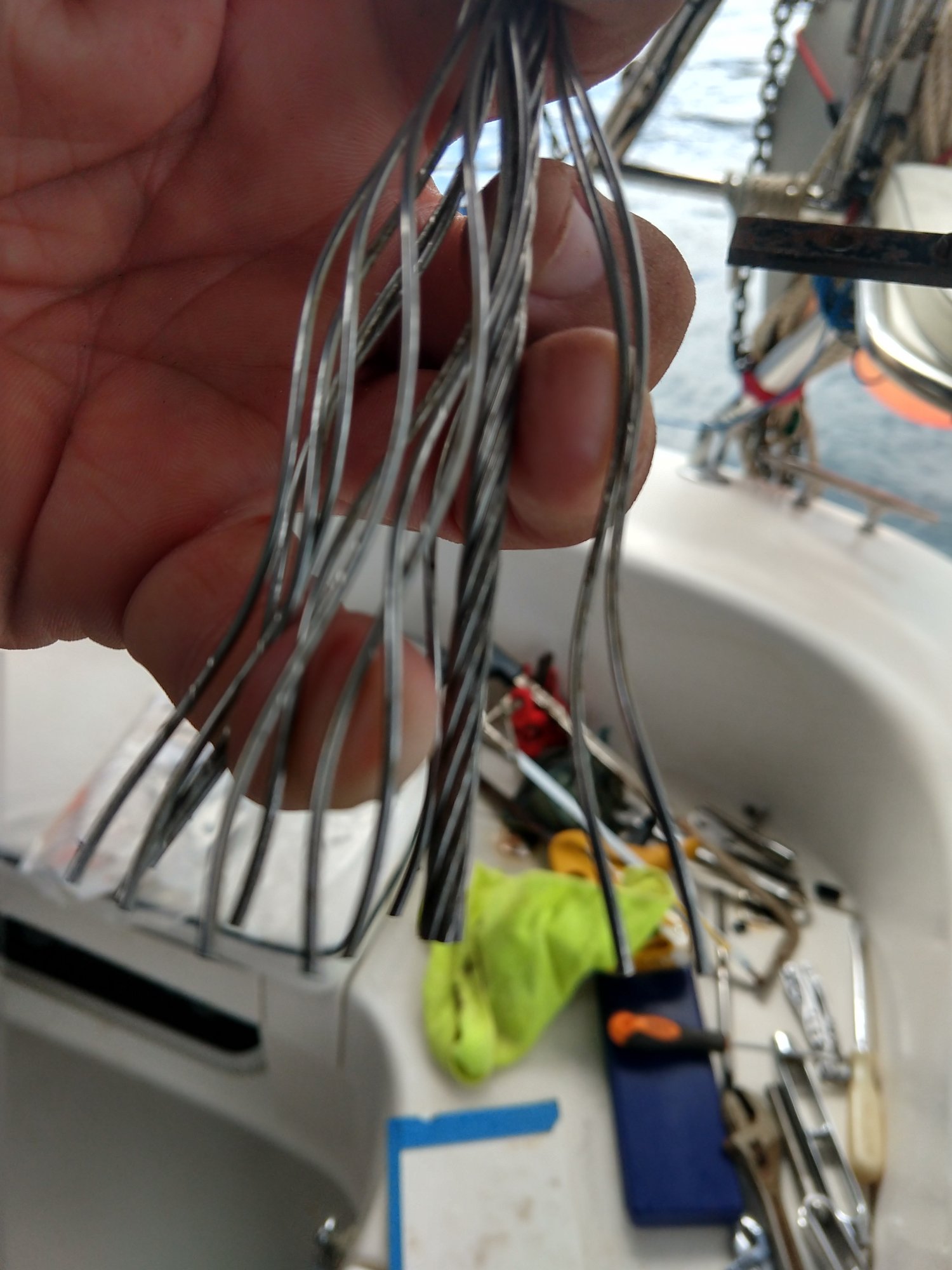

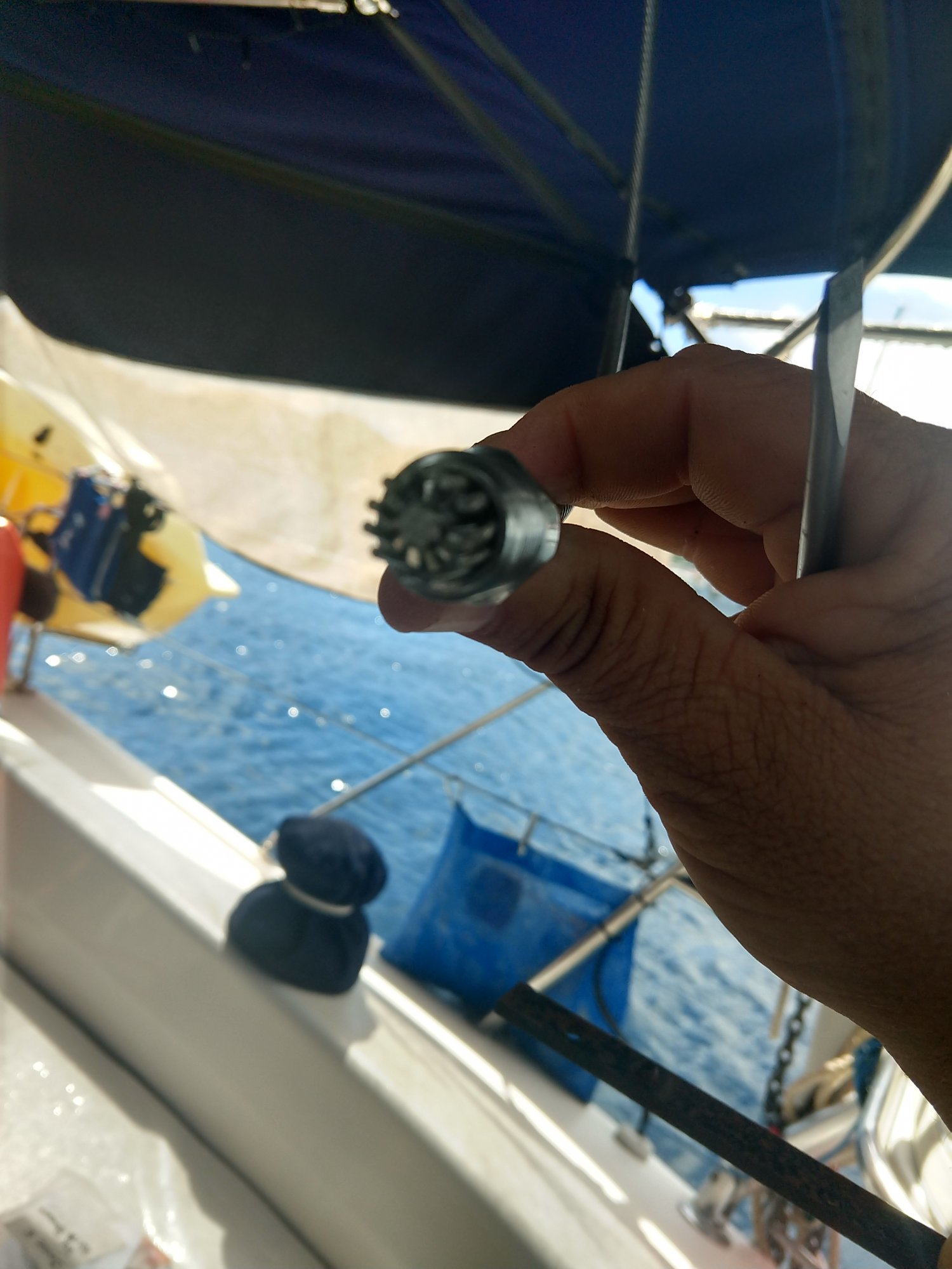

It appears the rigger who did the initial rigger used the backstay lowers from a different boat. They didn't even have the typical covered turnbuckles from Catalina. I couldn't get the tension correct for the backstays, they were buried and they weren't tight enough. One rigger suggested I tighten the forestay. I did that and we had some pretty bad performance because, as you noted, the mast was tilted forward instead of back. Catalina recommends a 6-inch rake.
I recently gave up on half-a$$ measures. I ordered Sta-Lok fittings and new turn buckles. I cut off about 5 inches from each backstay lower and reterminated with the Sta-Loks. I then retuned the rig and it's a different world. No more headsail pumping in heavy winds and much better performance in light air.
This illustrates my objection to the standards around tensioning. They are based on the breaking strength of the wire, but if someone "upgrades" to larger wire, for example, and try to use the same standard, the whole rest of the rig can be thrown off and over strained.
I'm glad to read that you have it worked out.
