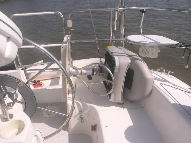

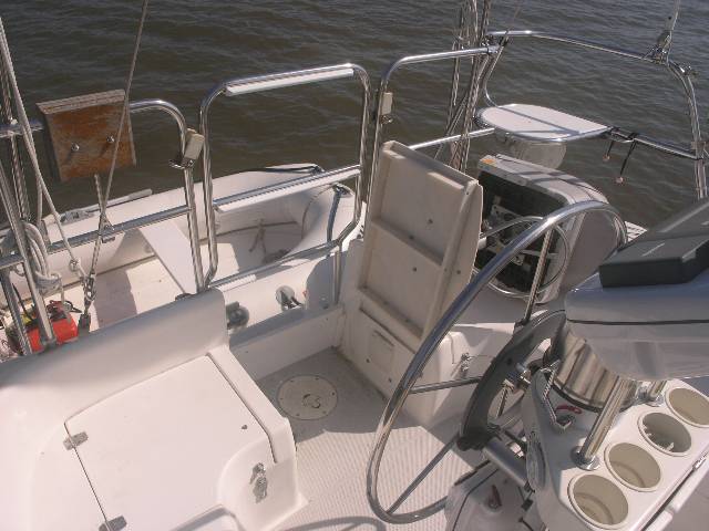

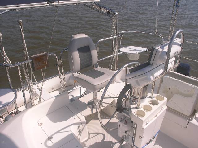

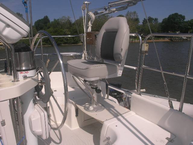

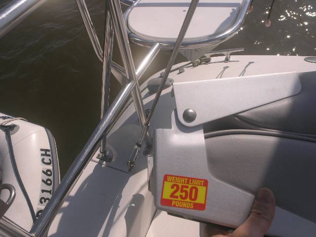

Never really liked the lack of visibility after mounting the chart plotter. So I came up with this. Gets me up for a safer view and I can easily walk through by tilting it sideways. It just clears the back stay to fold completely out of the way. Total cost $150 W.M. Chair and Base. I built the mount out of Corian which I already had scraps of and all the SS hardware I had. At an extreme heal it may be a bit uncomfortable but if I flip the foot rest up, I can stand and lean back on the seat comfortably.
