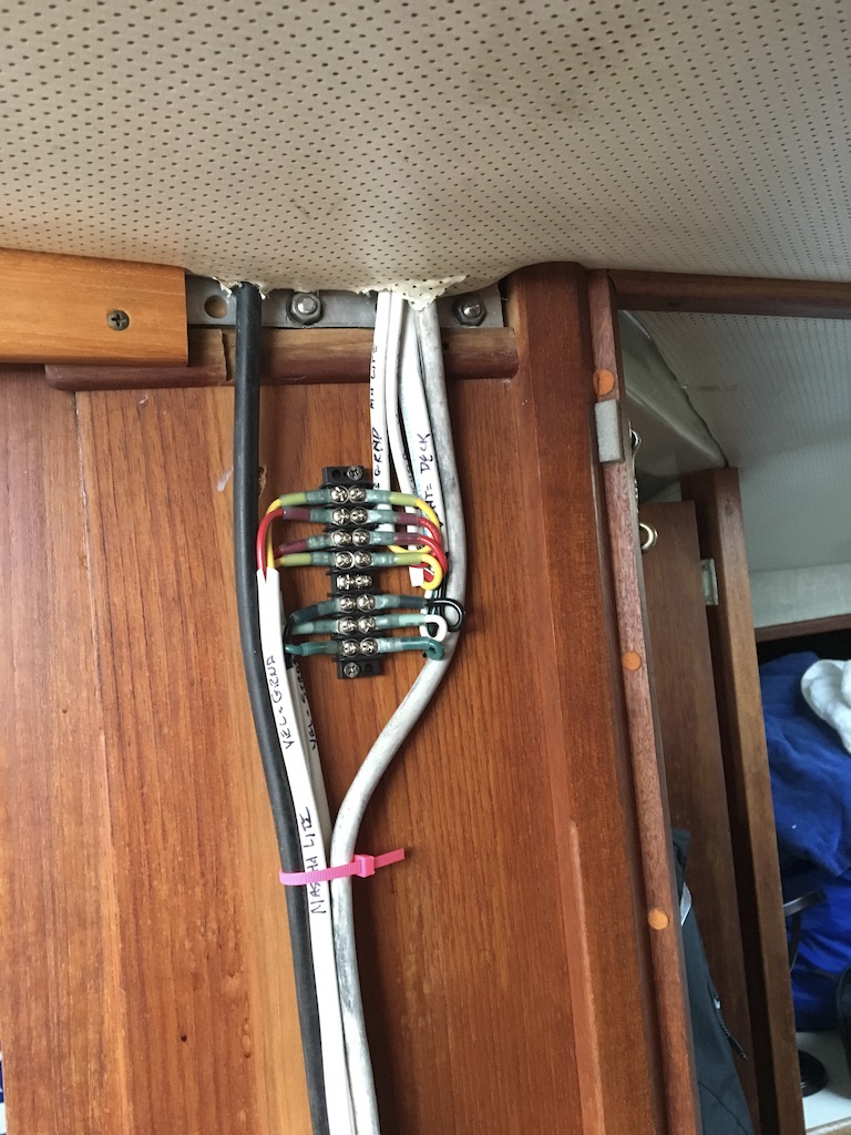

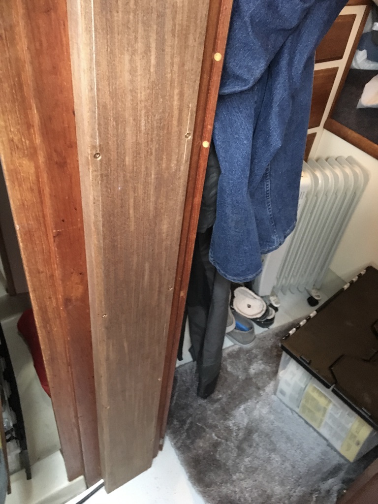

As the electrical wires were buried in my compression post I redesigned the connections. Here is the new wire block used to connect the wires in the mast to the wires I ran through the boat to the switch/breaker panel. I put a chase over the wires to hide them against the compression post. Note that the VHF and Radar cables were not cut. They are unbroken and run from the hardware in the cabin to the mast antenna's.
