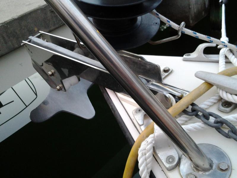

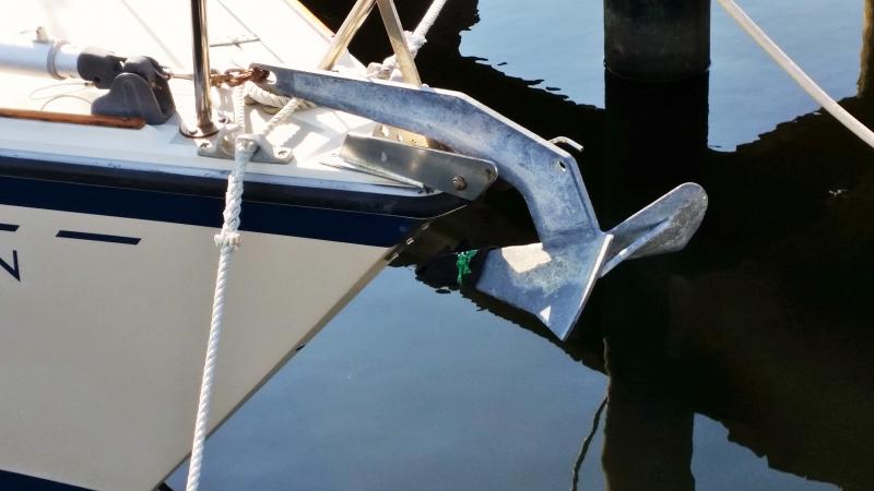

I would think so but can't honestly say as i don't know but suggest you take the anchor out of the locker and put it on a bow roller to make handling easier and give you more room.

We were able to keep a danforth with its rode, along with about 15' of chain and 200' of line for a CQR in the locker on our '85 28. I'd guess that it's possible to fit what you're looking for, but as njlarry suggests a roller is a worthwhile addition for storing and easily deploying the anchor.

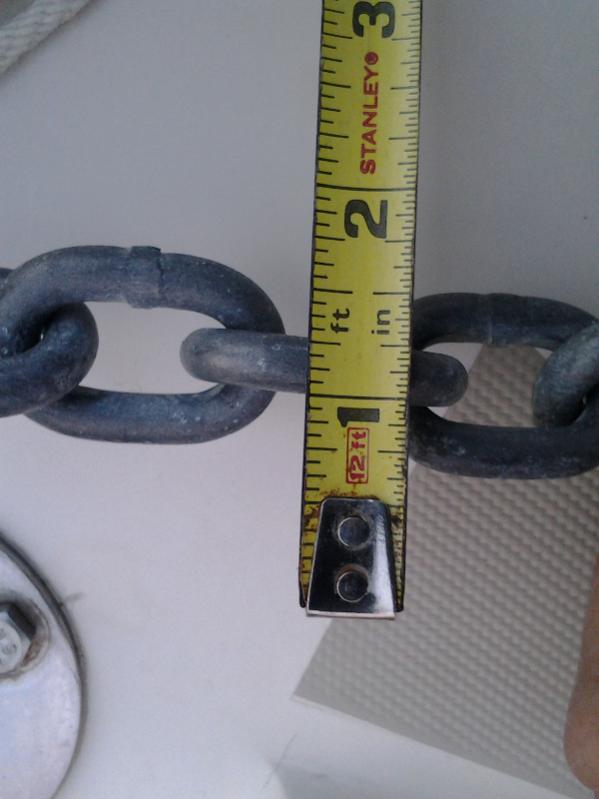

Please make your chain at least, if not longer, than the length of your boat.
Depends on how you sail.
Bow rollers are very convenient for frequent anchoring, but puts the anchor weight high and as far forward as possible, and in a place where it very easily snags on spinnakers. We often keep our delta stored low in the locker when sailing, even when cruising.
