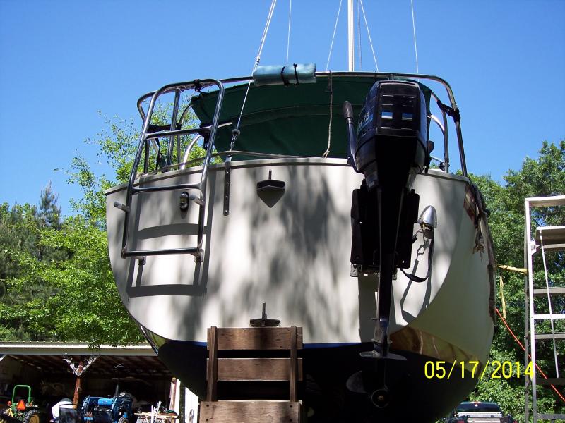

I need general advice on my boat transom, its not solid it has a inner and outer pieces ,I don't think it will support a newer9.9 thruster motor with much power from the prop. have a older 7.5 mercury which isn't sufficient to power the boat on a windy day. I think that the whole transom needs to be beefed up to be on the safe side . I don't have the expertise to jump in I need some one that has more knowledge in boat repair or building.whos got some info for a new sailor? Ive done carpentry work for 30yrs and some fiberglass work ,but I need some help!

There is a product called Seacast specifically made to do structural repairs to boat transoms. http://www.transomrepair.net There are some "How To" videos on that site and YouTube.com which will give you a basic idea of the product and process. You will probably have to come up with a procedure to pour the product into the hollow area between the inner and outer fiberglass skins of your boat as I can't determine the best method based on your photos.

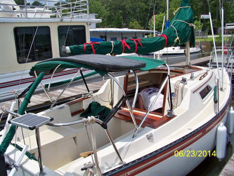

Hear here to rgranger, I have a 1981 H22 and I use a Tohatsu 6hp with no problems. You may have additional wind issues (?) with the extra topside gear of the bimini and stern railing shown in your pictures as compared to mine, which has neither. So maybe you might warrant additional hp...?
Also, my stern is wood cored, and am surprised that yours is not as well. I don't believe they changed the construction techniques during this run of boats.
