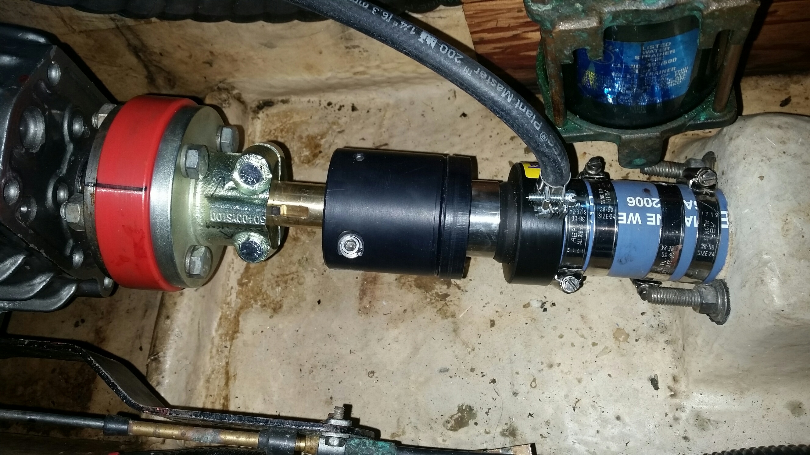

@Justin_NSA correct. You hand tighten the nuts and lock them down. I do not have any water coming out of the stuffing box when the engine is not turning the shaft. When turning I get the occasional drip. I also have a tube that vents water from the Heat Exchanger into the shaft log to reduce the chance of an air bubble forming in the shaft log and overheating the stuffing box causing the shaft to get scored.

My new Lasdrop shaft seal has a vent for that same reason. It's just vented to the air though. The directions say if you are under 20 knots you don't need positive water flow. I guess speed would cause a siphon bubble

Quite possible. It is about cavitation. Your open hose has water in it to some level. Just keep the end above the outside water level. I tried lowering my hose below the water line and out came a trickle of water. THen I stuck it up on the fitting on the heat exchanger. I guessed the hose had not been removed in a long time as there was a salt plug in the hose. Cleaned it out and water flowed.

I'm happy with it so far. I know water is getting up into vent tube. When i put it in the water for the first time yesterday. I had to tighten the double clamps some more. The other end is way up next to the siphon break in the exhaust water hose

Just be careful not to lay her over on her side beating up wind.. There could be a little spillage from the open hose. Not a drowning flood but splashes about the engine compartment that when found could drive you crazy looking for the possible leak.
One option is to put a closable valve on the end.. You shut it most of the time. You open it to let the box breath out any air bubbles.
