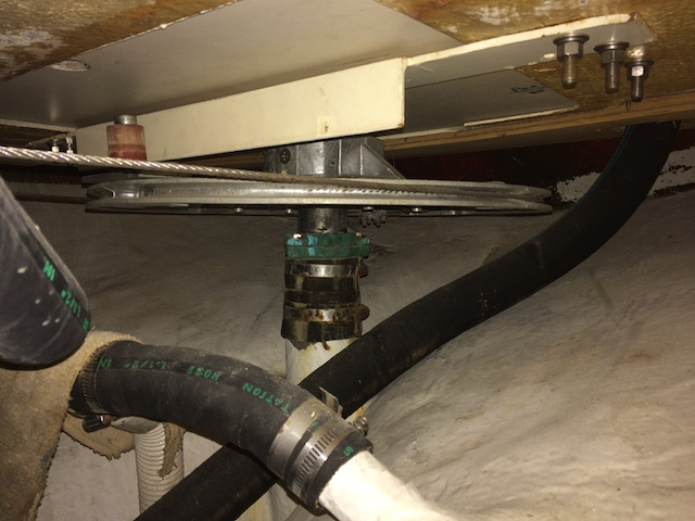

Sounds like you have your answer - just sharing a picture as to what we did a loooong time ago. The original hoses were replaced with 1-1/2" black hose. Here is a picture that I took some years ago when I needed to have the Rudder Stuffing Box rebuilt. You can make out the CP drain hoses on the left. We still have them criss-crossed, and I put an old rag in between them, where they touch each other as a quick anti-chafe protection. Probably need to check that now that I think about it...these have been in place for many years, no issues thus far.

Many thanks. The chafe guard is a great idea. I’ll definitely add that.
