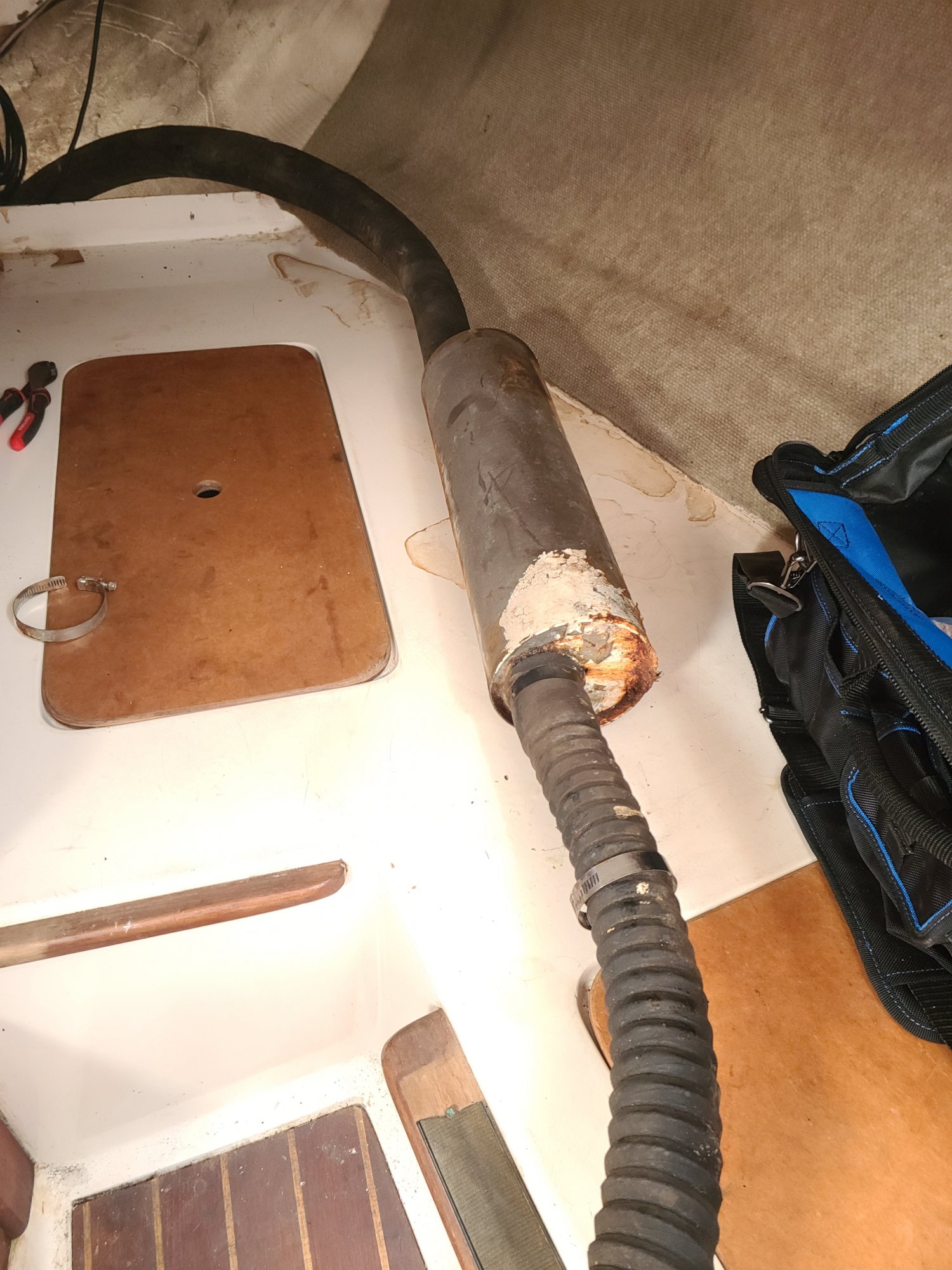

Finally, after 7 months of hemming and hawing from the shop I decided to get in there and do the job myself.

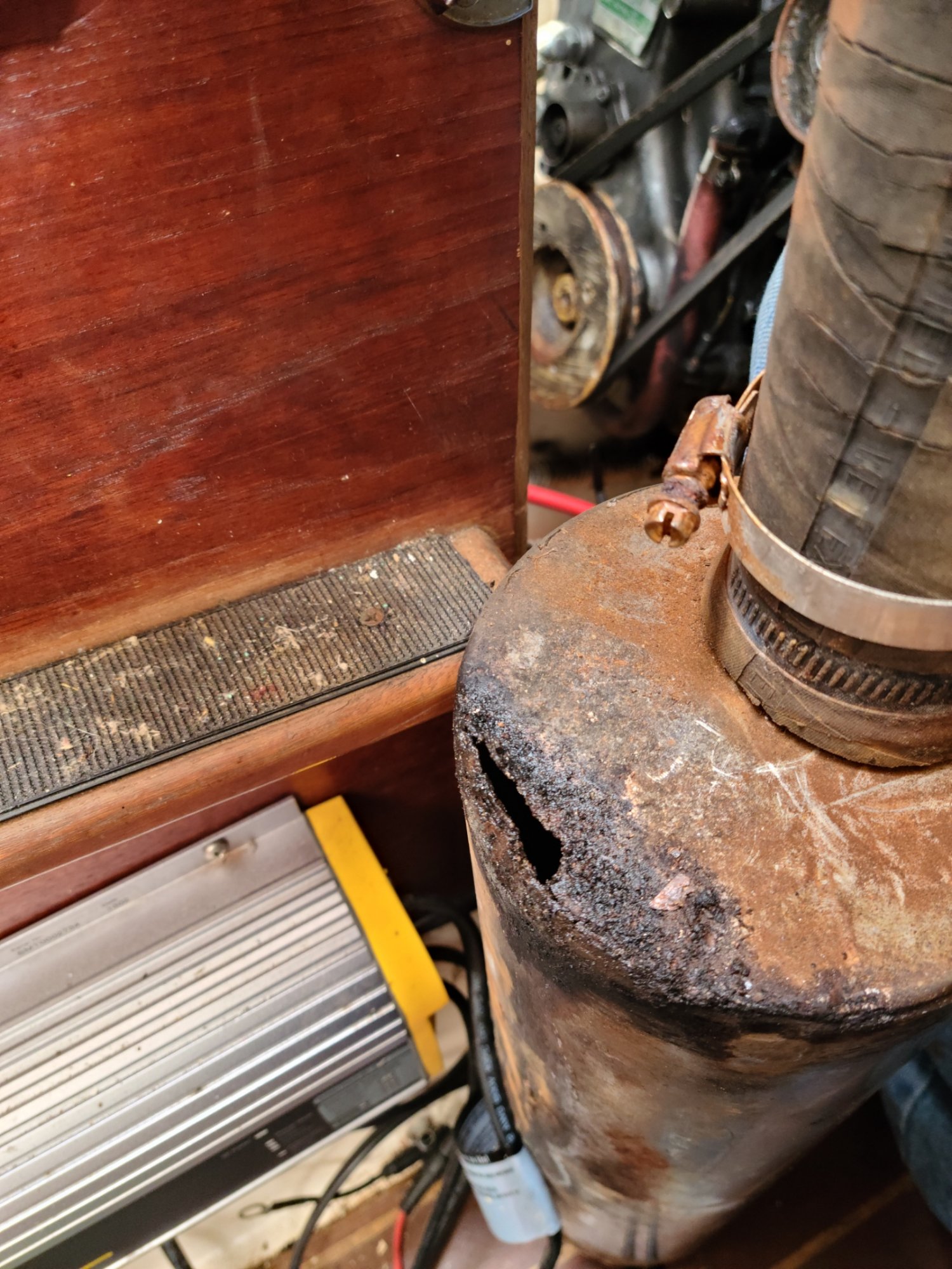

It took me a good 3 hours but I was able to remove the old muffler. I had to remove my water heater and cut through the exhaust hose to do it but it's out. Sure enough, there was a hole rusted through it.
The existing hose was cracked and needed replaced so there wasn't really anything lost here.
For posterity, here's the dimensions of muffler and hose.
Muffler:
5 1/4" body diameter
18" body length (without inlet / outlet)
2" OD inlet & outlet diameter
2" inlet & outlet length
22" overall length
Hose from engine to muffler. 2" ID, 24" length
Hose from muffler to factory exhaust outlet 2" ID, 55-60" length (I destroyed a section cutting through it)

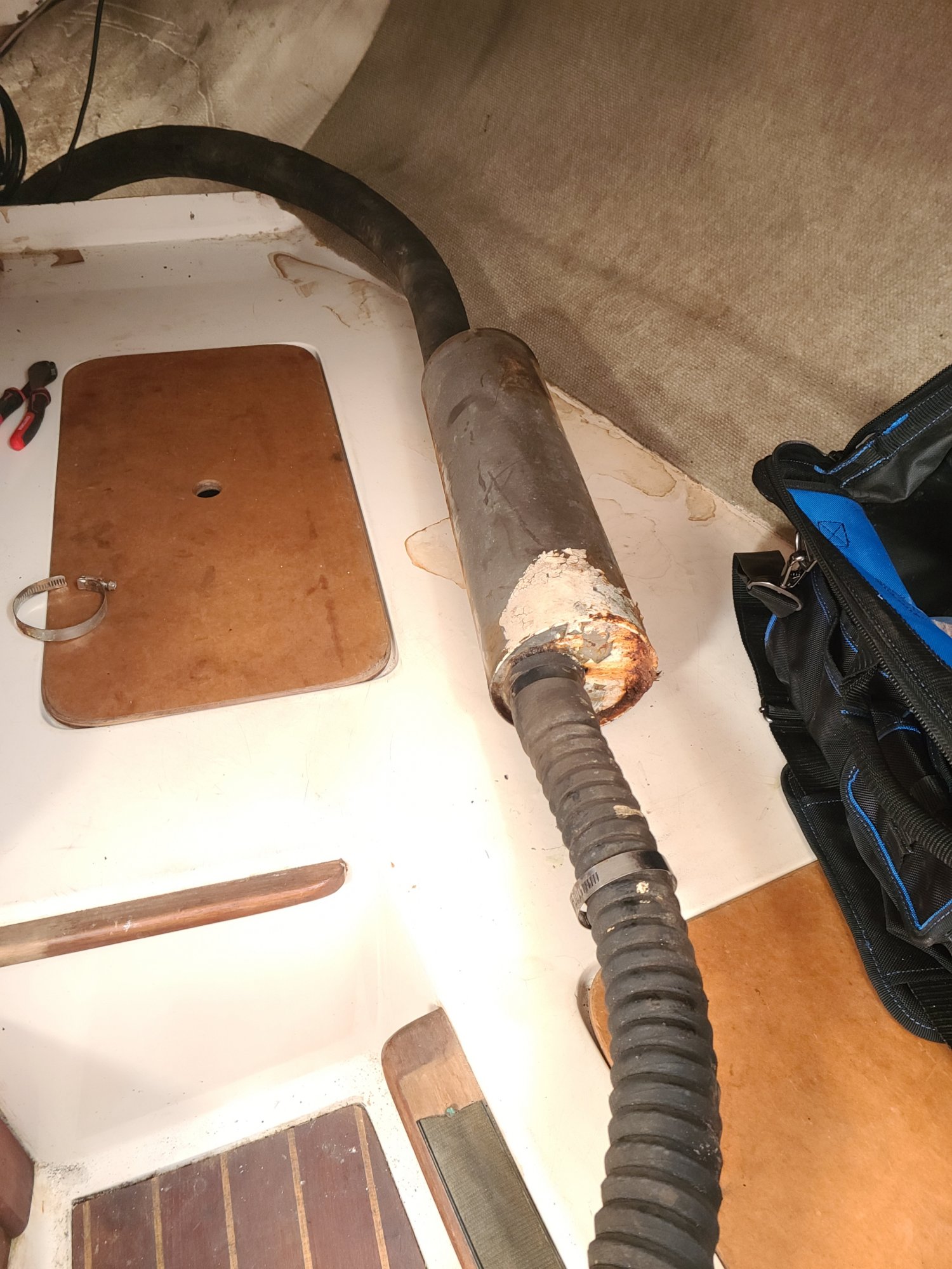

Muffler:
22" overall length
