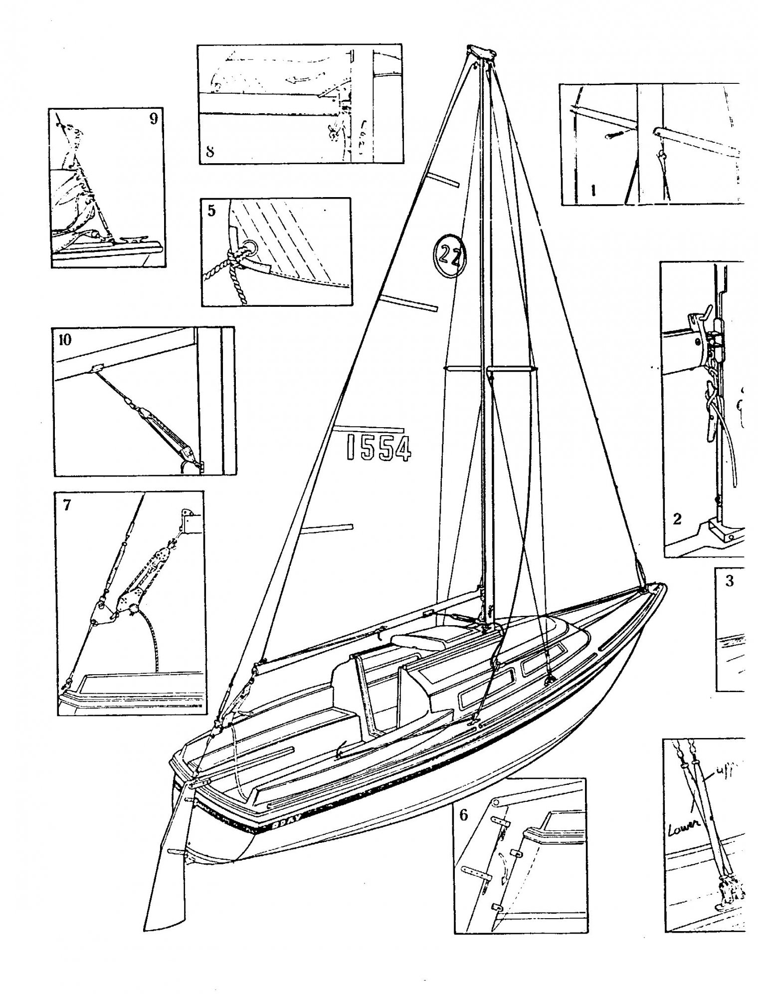

Old style (1972-74): Tie or shackle the end of the mainsheet to the becket on the top of mainsheet block (near stern). Thread the other end through one sheave of the double block on the end of the boom, then through the block near the stern on the other side, then through the other sheave of the block on the boom, then through the first block and the attached camcleat. Tie a figure-8 stopper-knot in the free end of the sheet.
Newer style (1975-83): Take the free end of the mainsheet, thread it through the upper sheave on the block attached to the triangle plate on the Backstay, and bring it up through the block on the boom, then back down to the bottom sheave and through the camcleat. This type of mainsheet arrangement frees up the cockpit considerably. Tie a figure-8 knot in the end of the mainsheet so you won’t lose it.
(See Fig. 7)
For Boom Vang Instructions (Fig. 10): See Glossary
