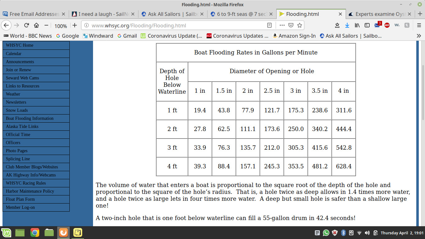

Below is a water ingress table. It will give you some idea of what your pumping capacity should be for a thru hull failure, etc.
