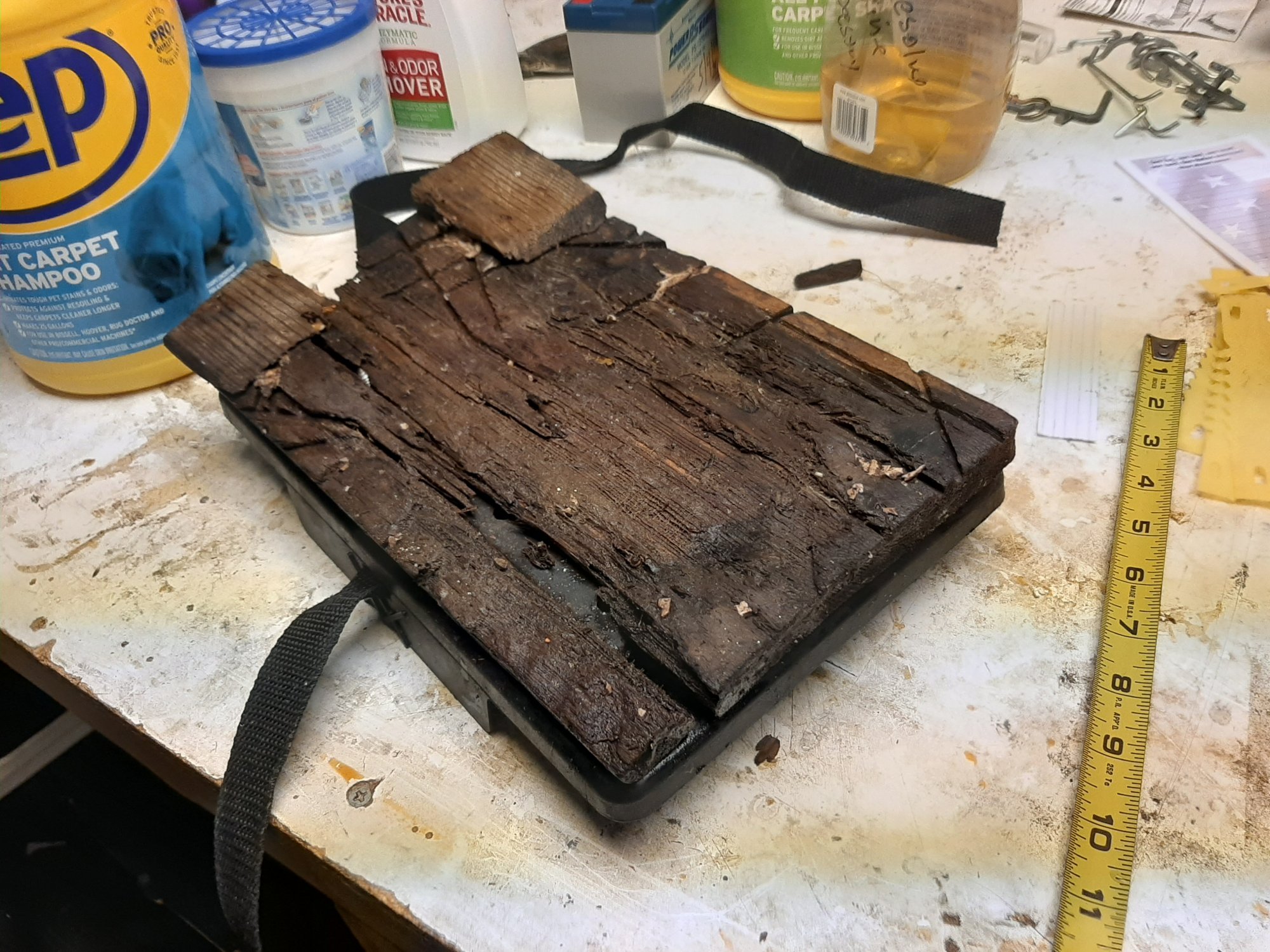

The photo is actually the remnants if the ewood block thatcwas glued to hull and plastic battery tray, upside down. I will have to wire brush to remove remnants of rotten wood still remaining in the fiberglass. This is in a battery compartment under the jumpseat at rhe transom, not finished,exposed gelcoat to deal with.
If it is unfinished, it probably is not gel coat. Some builders paint the visible parts of the hull interior and only use gel coat in high wear areas like anchor lockers.

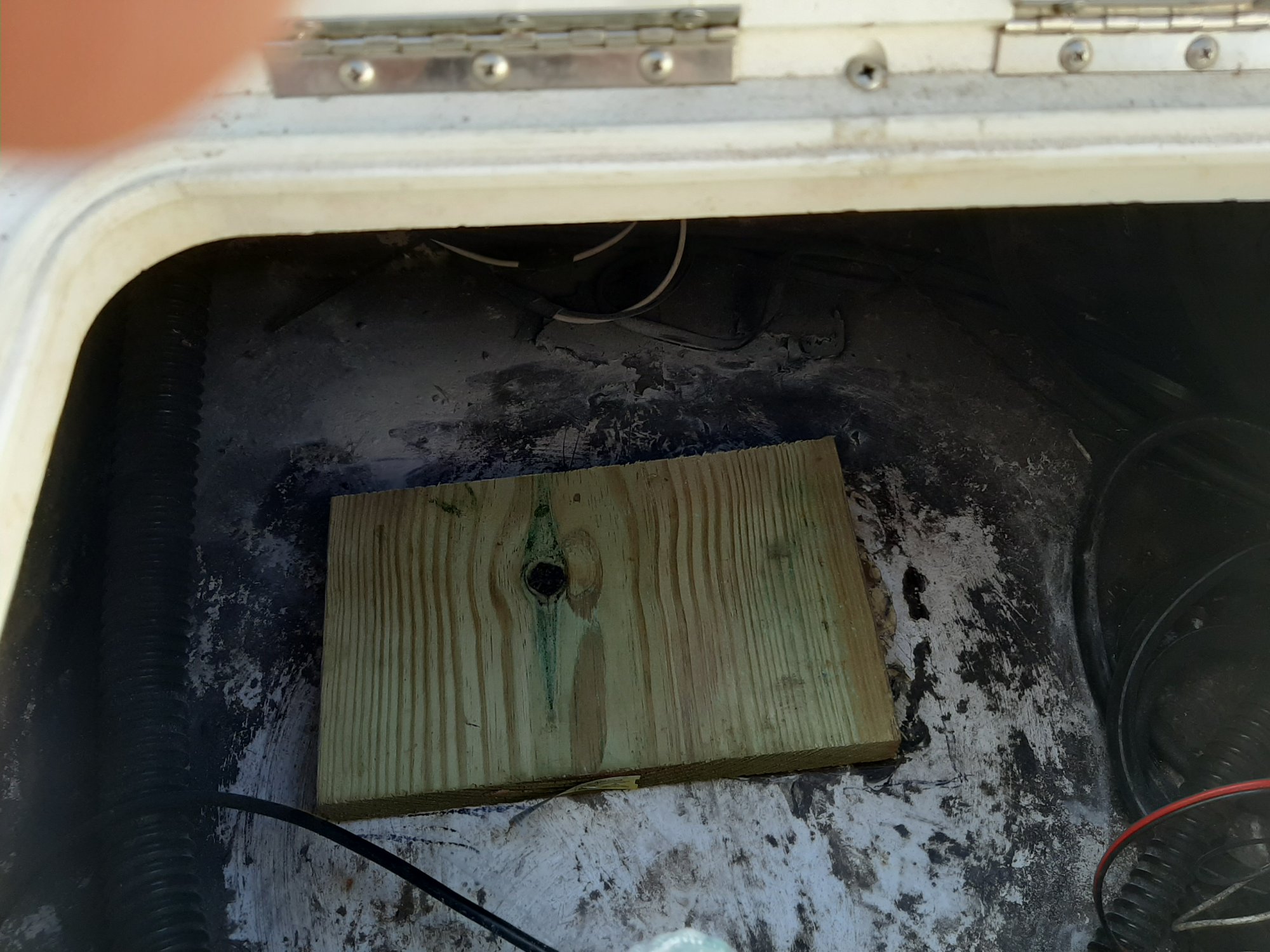

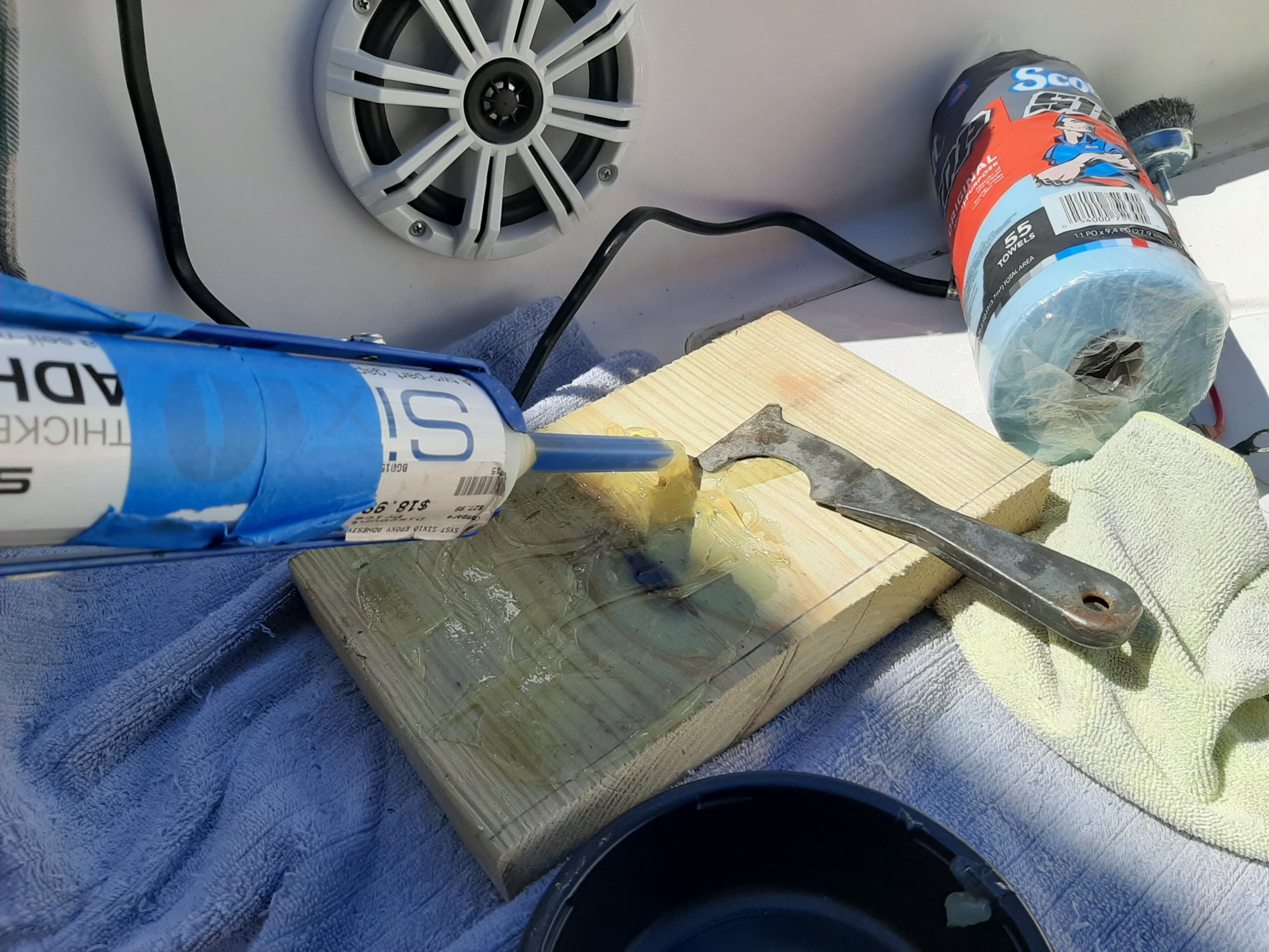

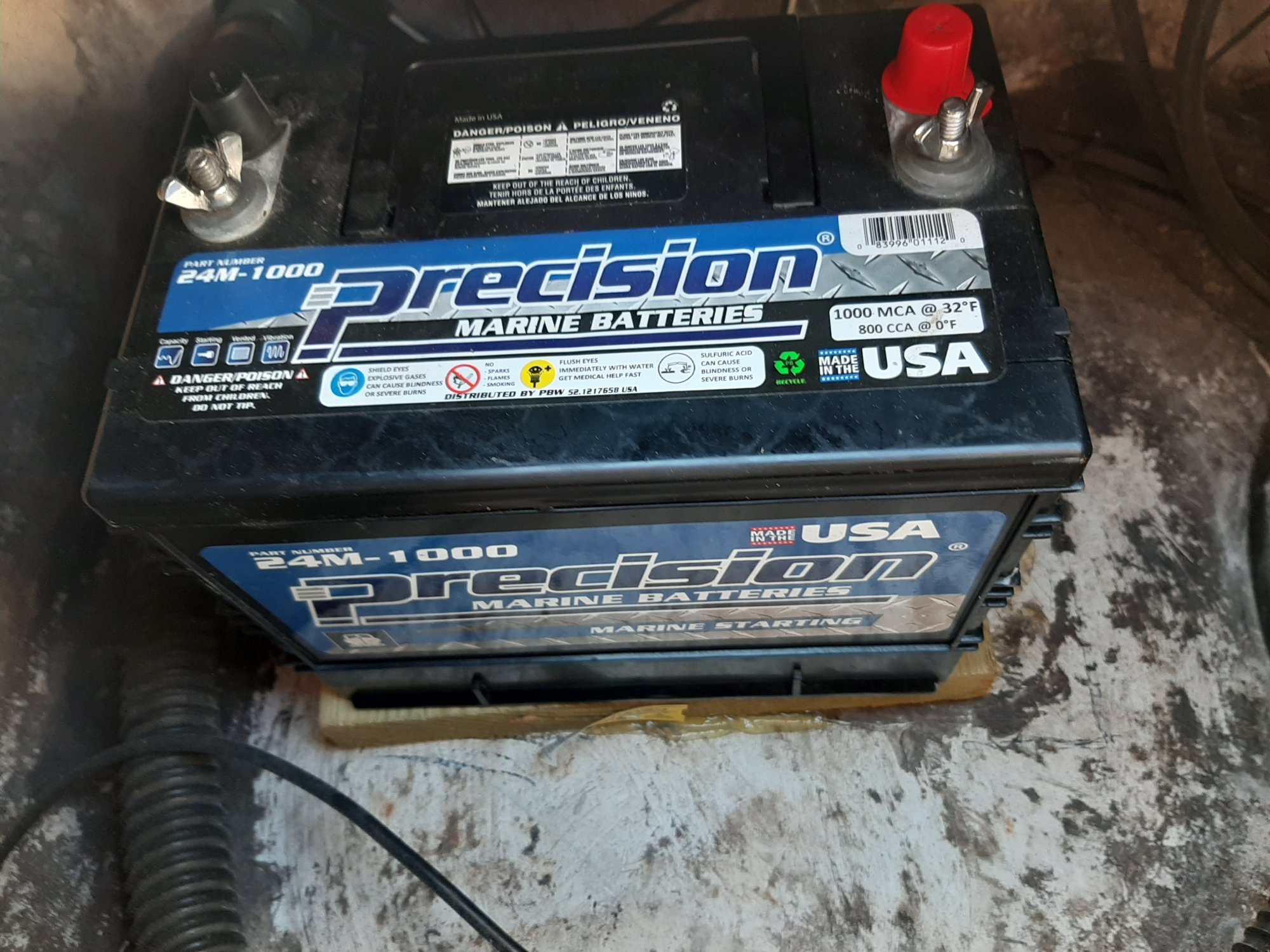

Update: Found 2 tubes of West in my supplies so decided to use it. Pressure treated board readily available. Wire wheeled and wiped mounting area, smeared board with epoxy. Useing the battery to wieght it down for 24 hours then will install plastic battery tray( with strap) with stainless steel wood screws. Thanks for a replies, appreciate very much.
