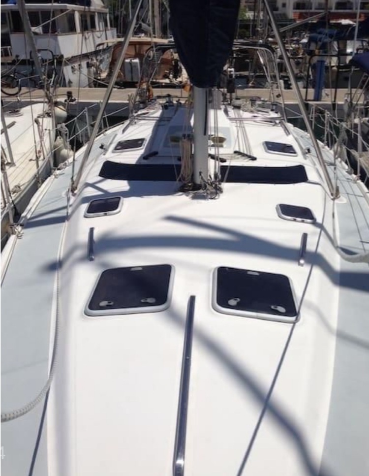

Terry, one last thing. What are the big bars for that form part of the mast support rigging? They perhaps from the deck chain plates, go up the mast 10-12ft or so. Can you see them in the photo? Bill

Not sure, Bill. I've seen them before on other newer boats. Do those bars go up to the first spreader? Our boat has stranded steel cables on both sides that connect from the deck chain plate to the first spreader mast connection similar to the bars that you show in the photo. Our cables are there to reinforce the mast at the lower spreaders. Just all part of the standing rigging. Just my opinion, Bill. Can think of no other reason.

Okay. Well they can only add strength to the already standing rigging to beef matters up. Okay, thats for the natter. Good sailing to you. Bill
It maybe the "Cutter" rigging extra support. The extra headsail force needs it.
If so, the forward headsail is called the "Yankee" , and the second is called the "Staysail"
Jim...
PS: I have friends with one. They say better performance than the standard Sloop rigging.

Hello James. I have seen a few 466s with them but, not many. For a cutter rig I thought generally the mast is placed further back but, I really just don't know. Okay, its a thought but, not really concrete. Thanks for the suggestion. As you are on the coal face over there in the , perhaps there is an email address I could contact (maybe the manufacturer) to find out for sure?

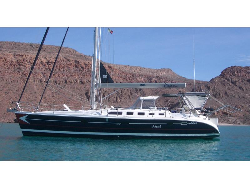

Here is a 466 with "Cutter" rigging.
Two Head sails and In-Boom furling for the Main Sail.
Great looking boat!
If you have a similar picture , you can tell.
Also, I suspect those bars are there for the "option" of Cutter too, even though your candidate boat may be a standard "Sloop".
Jim...

Wow!! That is nice and a lot like "Wings of Gold" My wife has always liked that colour. You've been a great help. As I perhaps mentioned. I have put a deposit down and I see no reason why soon I should not become the owner of a 2002 466 which I will rename Casper. Again, thanks. Bill

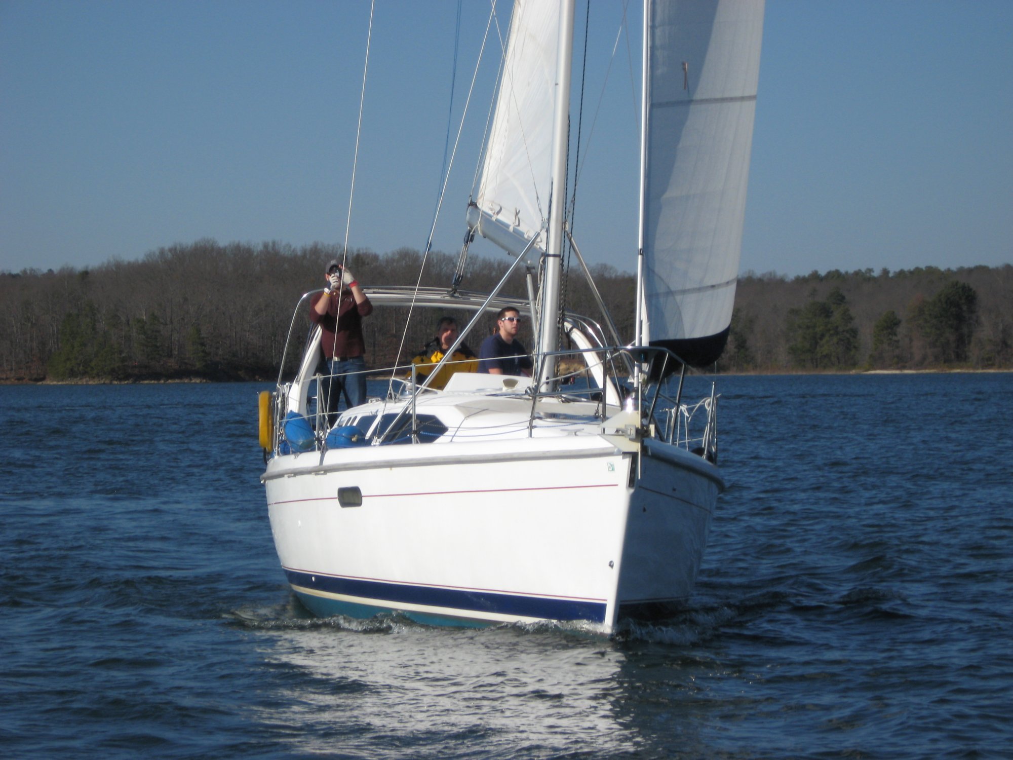

The "big bars" appear to be the same as the mast struts that Hunter/Selden specified on mid 30 ft boats (late 90s, early 00s) with conventional (not in-mast furling) main sails. You can see them in the attached picture
090.JPG.
They were designed to help stabilize the lower part of the mast as the mast cross section was smaller since it did not have to accommodate the furling setup. Big warning in my manual not to sail without them installed, but can be removed at the dock. They go into compression on the leeward side.
I assume they serve a similar purpose on the big boats.

Fantastic Ed, that answers that; I am learning. I am most grateful to you and looking forward to getting my hands on her. I have been watching a YouTube series of a family sailing a 466 and they have several times had problems with the in mast furling. I have always had slab reefing and am happy enough the one I am purchasing is the older traditional single line reefing. Bill
