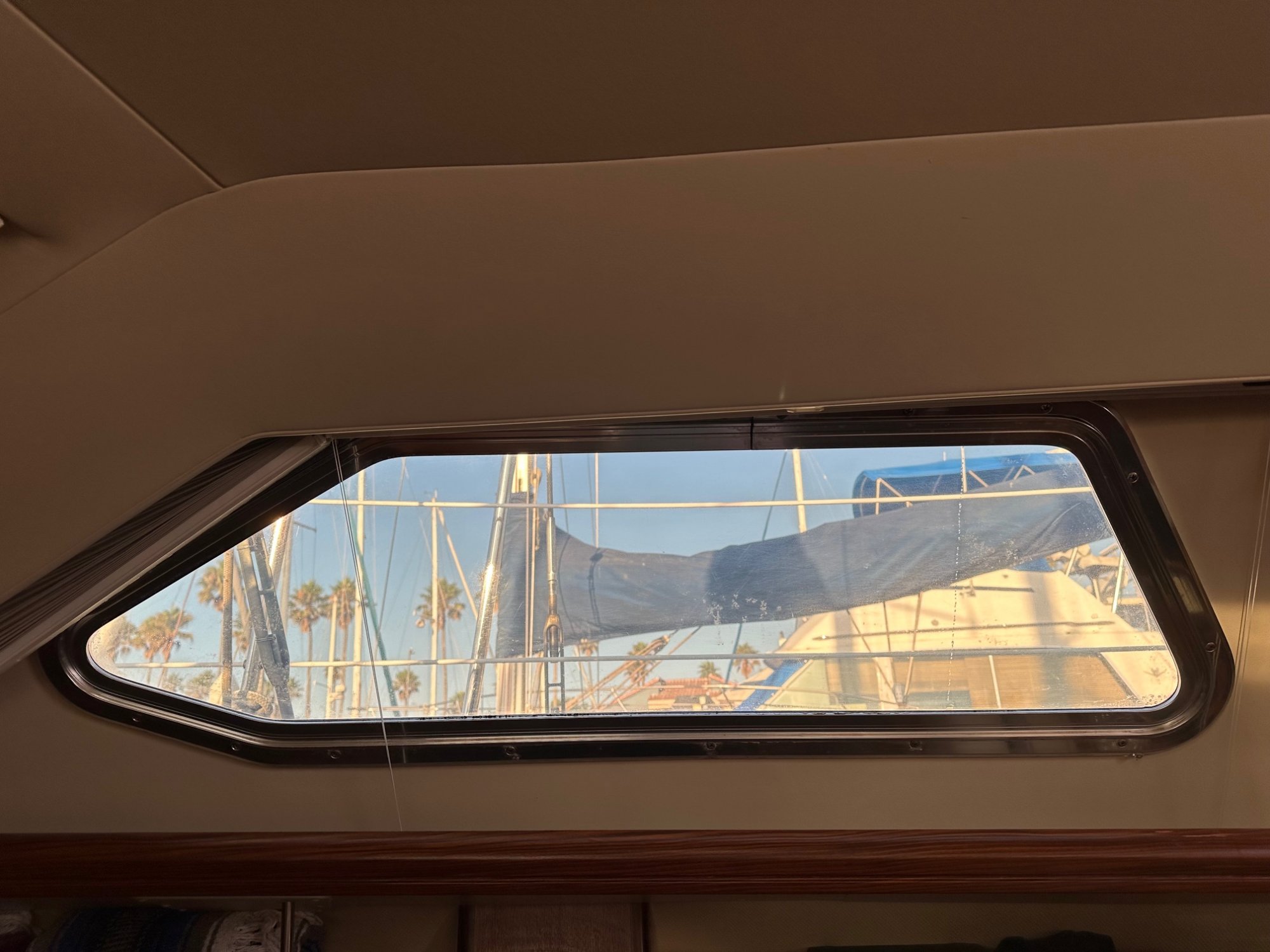

The forward windows are leaking on my 41 DS. The plexiglass has a rubber gasket attached to the edge which is disintegrating and the window is separating from the aluminum frame. The plexiglass was originally attached using caulk and the gasket created a snug fit to help the seal.
I would like to find a source for a replacement gasket or a complete plexiglass window with the gasket attached. The windows were made by Bomar. Nothing is available on this site. Worst case,
I can strip the gaskets and reseal with Dow 795 but I would prefer to reattach as per the original. any help finding parts would be greatly appreciated!

The original gaskets are quite thin and barely allow the window to fit in the frame. I have been unable to find replacement gaskets or complete windows w/ gaskets. I don't think there would be room for butyl tape. Even if it did fit, the window will need to be caulked to hold it in. I have decided to just use Dow 795 to seal and cement the window in place.
I did use butyl tape on one of the smaller windows that was leaking around the frame itself and the hull and it worked quite well once I finally got the frame out of the hull which was pain- took 3 or 4 hours to free it using a guitar string with a helper on one side to saw the old caulk loose (another poster used 40# fishing line to do the same thing). Not a fun project! Good luck and have plenty of beer on hand for the task.

IF you can see a gap where the water is leaking, can't you just add a bead of 795 to that area to reseal? I highly recommend NOT removing the frame if at all possible!
I would like to find a source for a replacement gasket or a complete plexiglass window with the gasket attached. The windows were made by Bomar. Nothing is available on this site. Worst case,View attachment 234008 I can strip the gaskets and reseal with Dow 795 but I would prefer to reattach as per the original. any help finding parts would be greatly appreciated!
I finally got around to the window reseal. Removed the inner frame and very carefully pushed/ detached the plex. from the outer frame which is held in only by the original calk. It came loose fairly easily since the sealer had deteriorated over the years. Once out, I cleaned it ,removing the damaged parts of the original gasket- the new 795 should seal any gaps which are very small since the gasket is less than 1/16" thick.
The outer frame channel the window mounts in was thoroughly cleaned with a scraper and Acetone. I replaced the window and traced around the inside of the frame with a sharpie to mark where it needed to be masked and masked the areas on the outside of the window/ frame/ hull where exposed. I thoroughly cleaned the edge of the widow with acetone and sandpaper Finally laid a generous bead of the Dow in the channel and pushed the window in place and removed the excess Dow with a finger and damp rags. After a couple of hours I removed the painter's masking tape before the 795 set and it's finished!
A word of warning: I temporarily used Gorilla duct tape to seal it before I was able to perform the repair. Don't do it! The residue left after removing it is an extremely sticky mess: most solvents/ cleaners/ goop-off can craze/ cloud the acrylic. I used olive oil and it came right off. I have used butter to remove tree sap for years so it would probably work as well
Bottom line is it is successfully fixed without removing the frame. Cheers!
