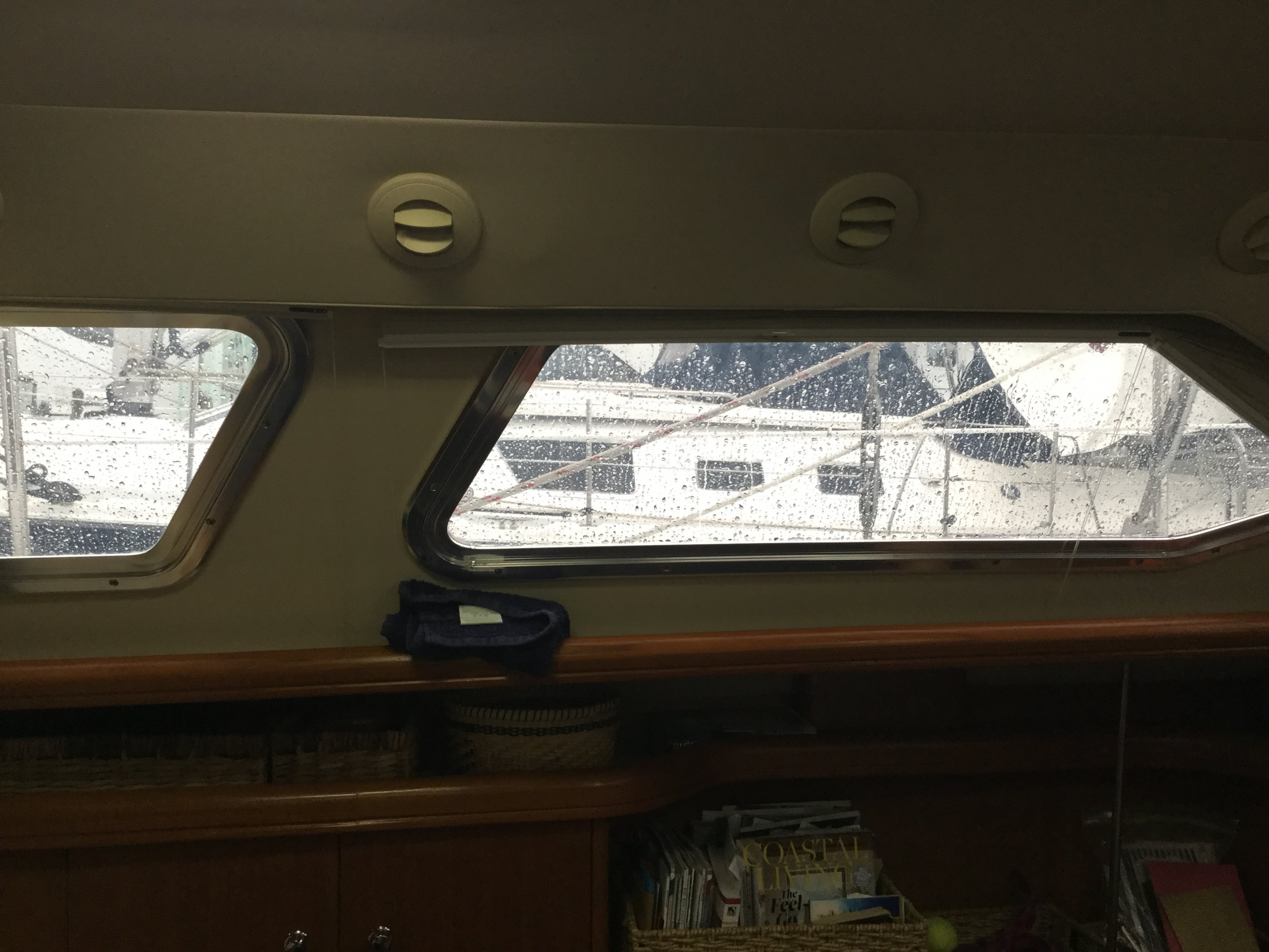

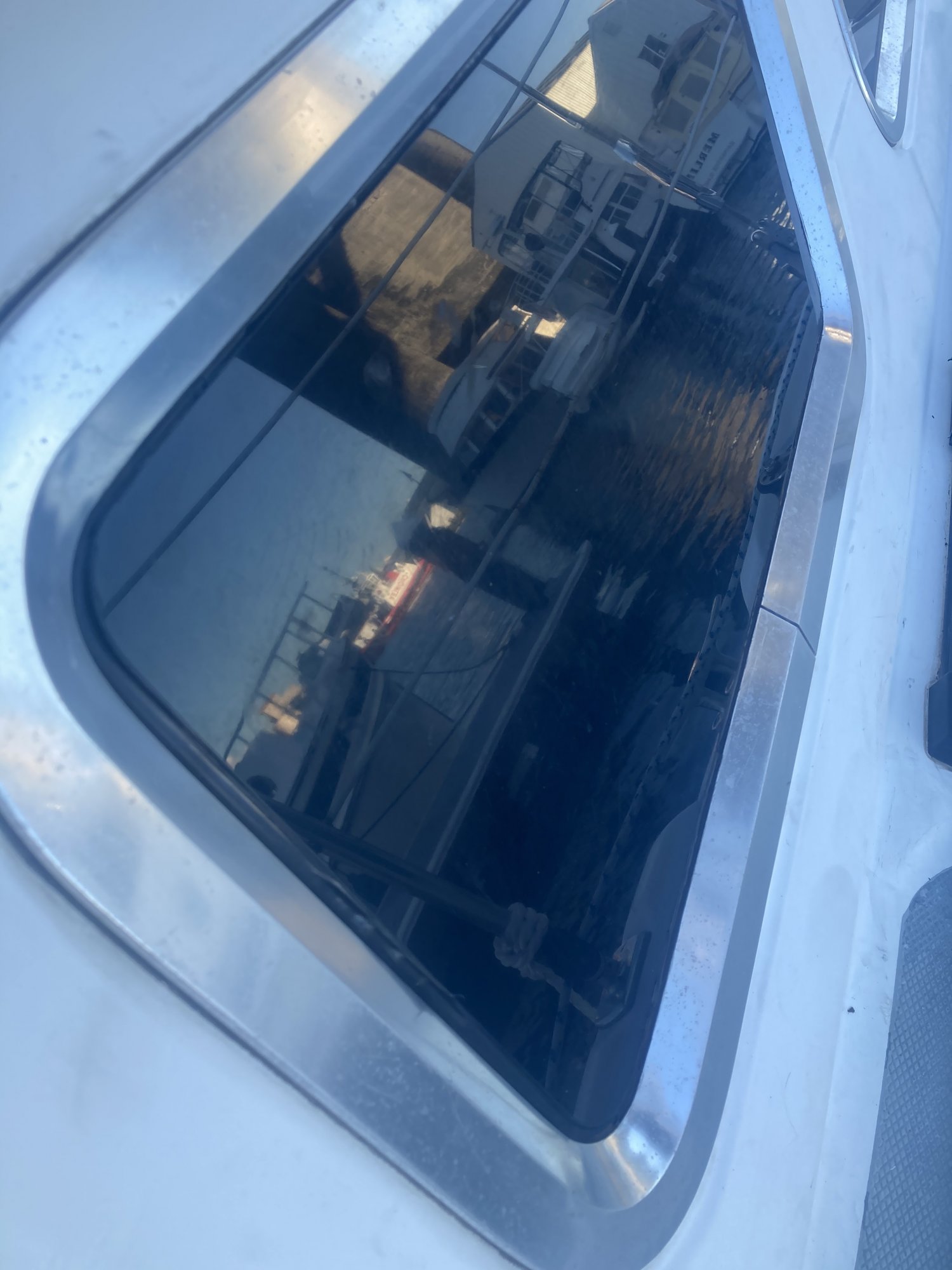

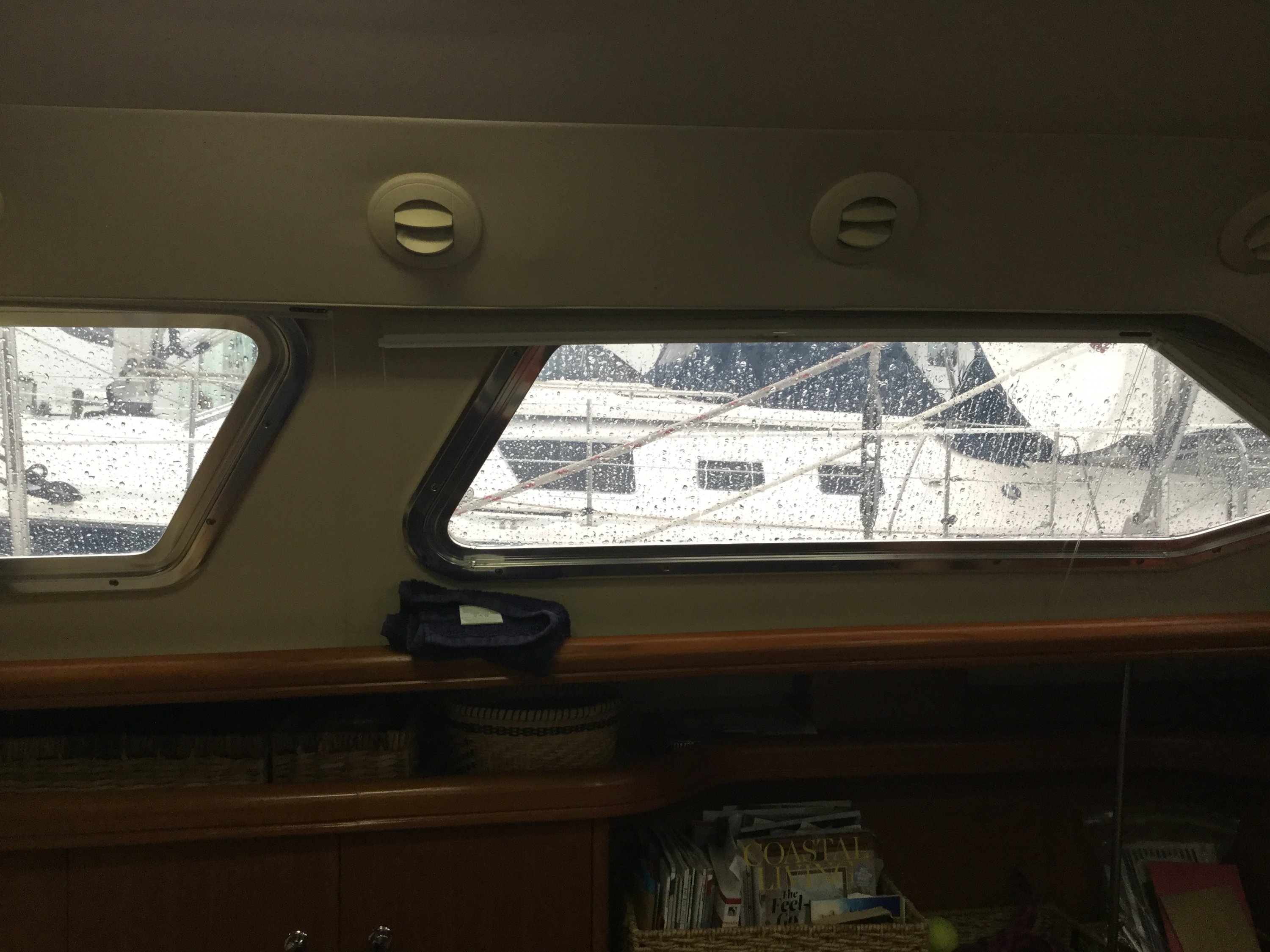

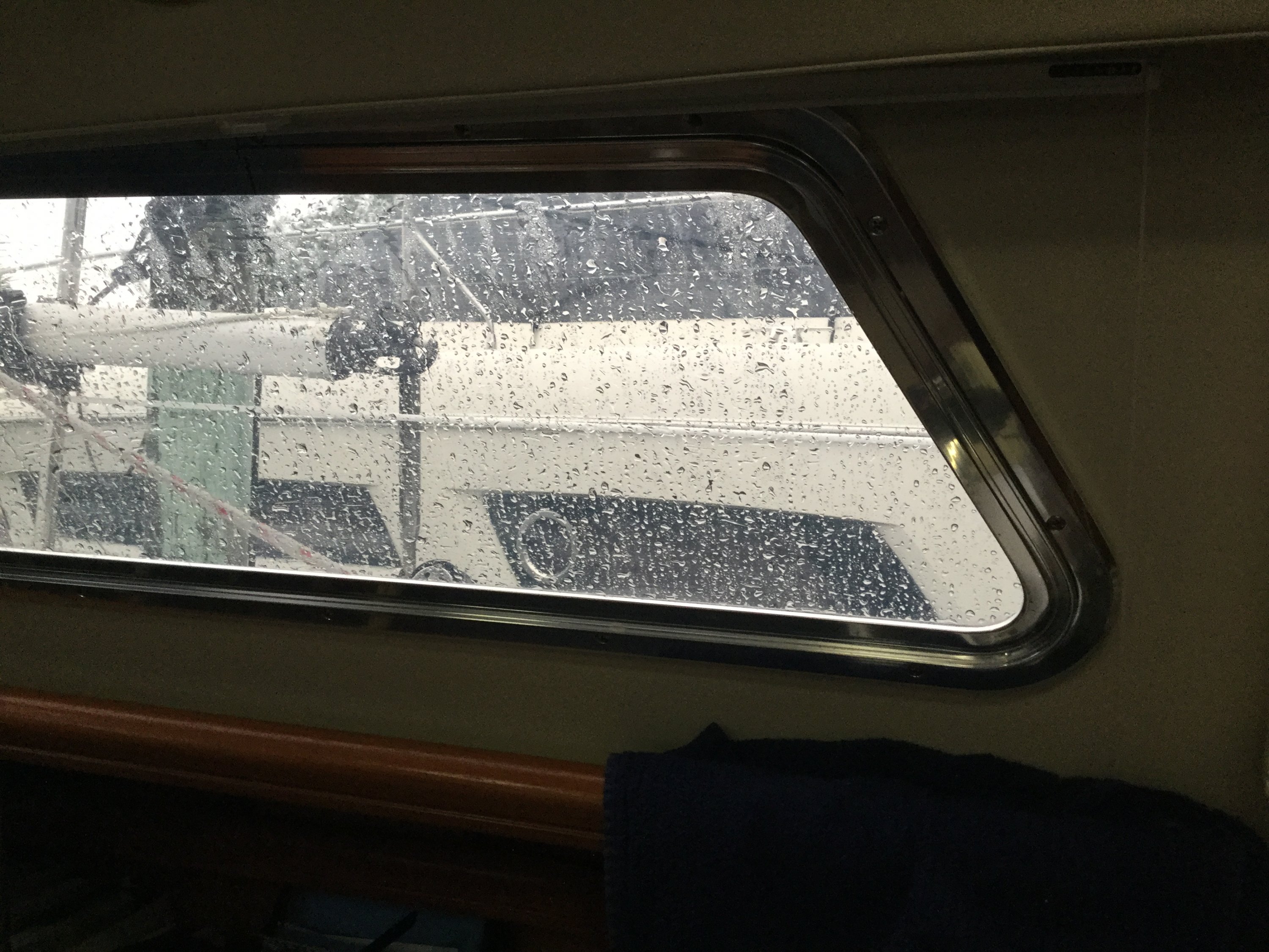

I have a 2005 Hunter 41 DS. The boat has large fixed window on each side of the saloon. See pictures. Each of these are leaking in the bottom aft corner when it rains. So I need to pull them out and re-bed them. These windows have screws on the inside holding them in place. Nothing on the outside except the Crome window edge. Before I pull one off has anyone done this already. I saw a lot on the black sealing but that is not what we have.

I recently resealed the upper half of the exterior trim on the 4 port and starboard fixed lenses. Figuring this is actually a 2 part job, 1 sealing the Al frame to the fiberglass (white), 2 sealing the lens inside the frames,(black). If you look closely you will see some places where the exterior trim is 1/16" away from the fiberglass. I cleaned it up very good, sanded edges , cleaned, taped, sealed with white 795 using a rounded squeege to make look nice, remove tape and touch up any imperfections with denatured alcohol. I haven't had a leak since:) This is the place to start.

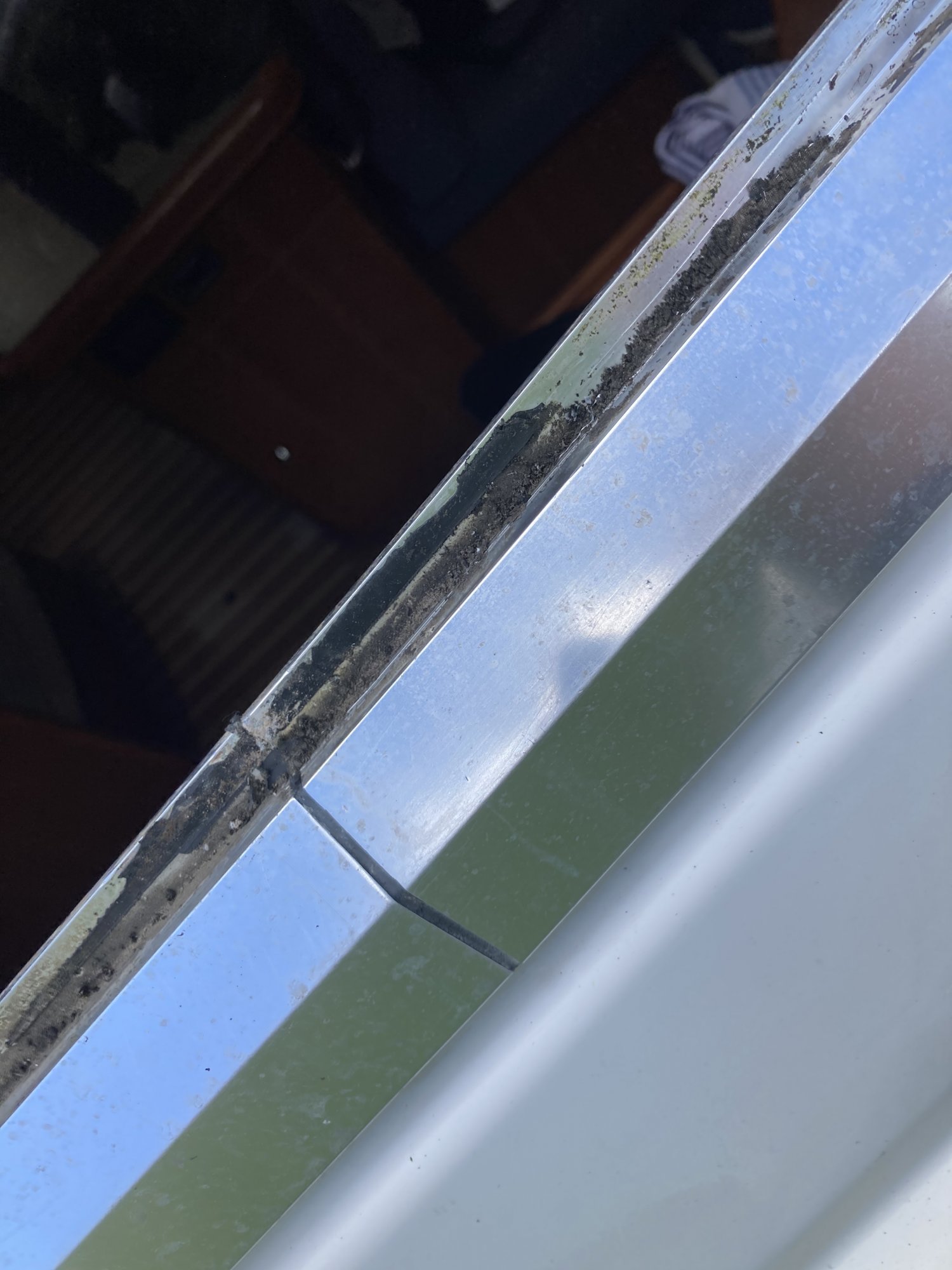

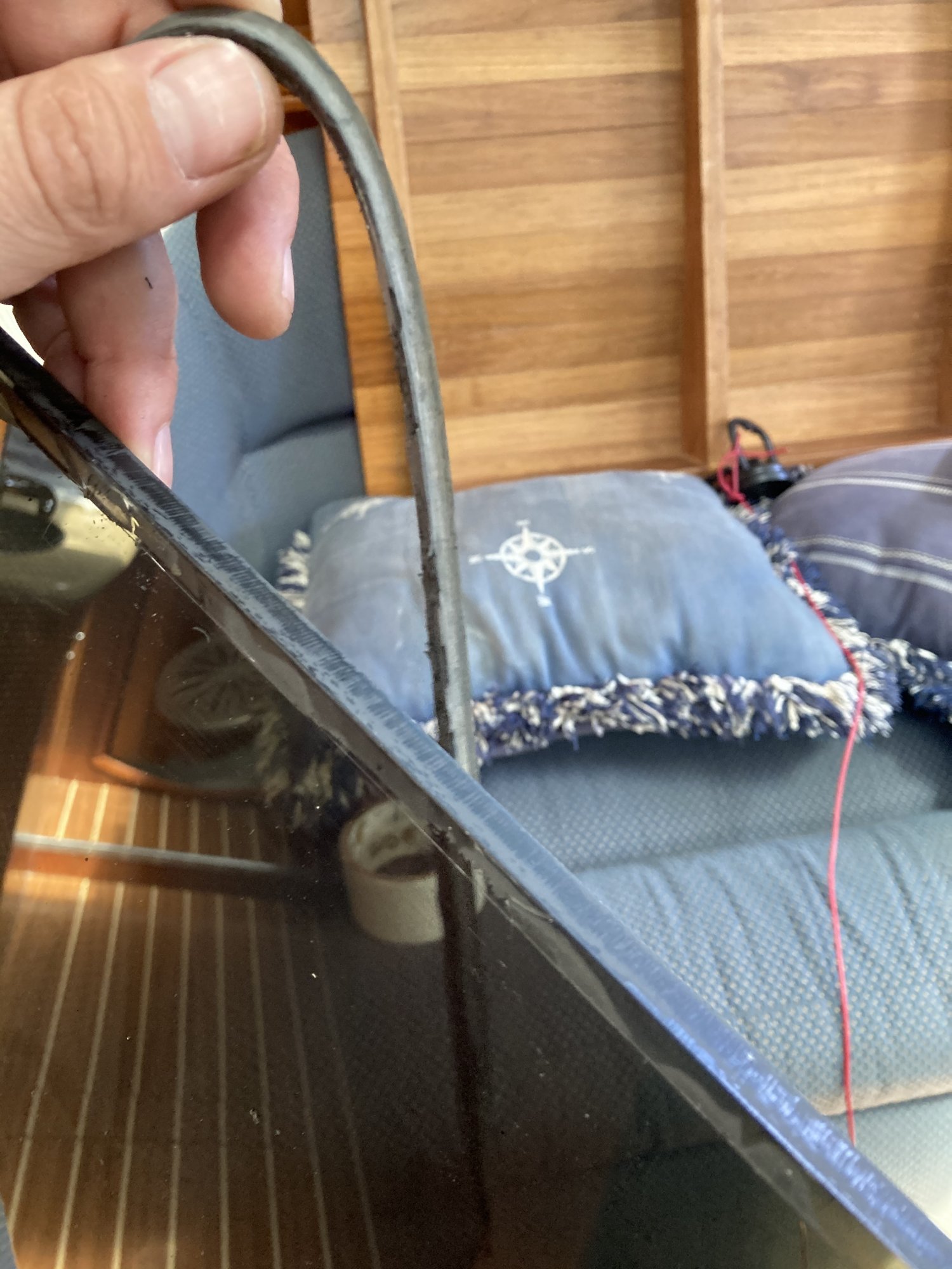

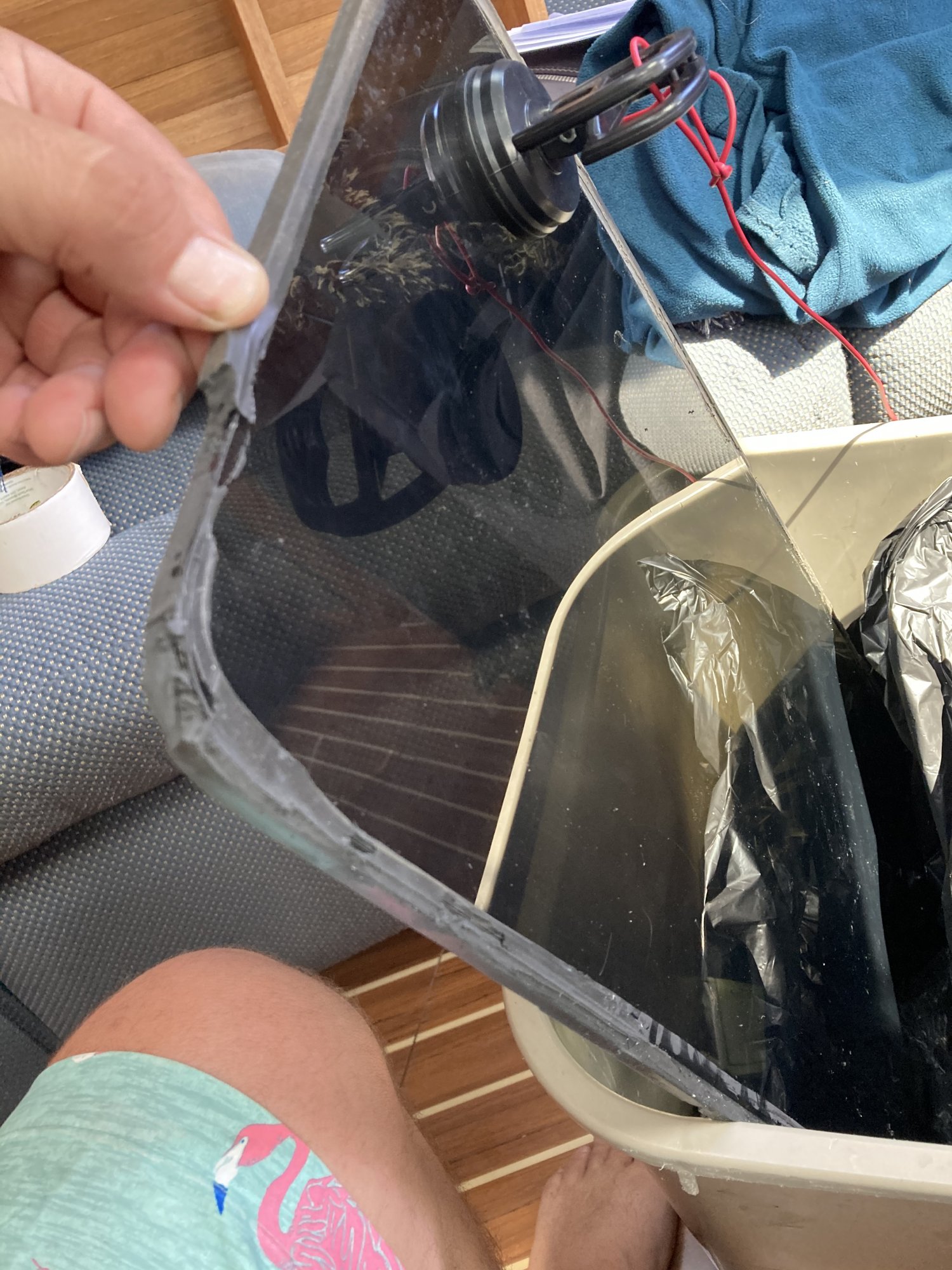

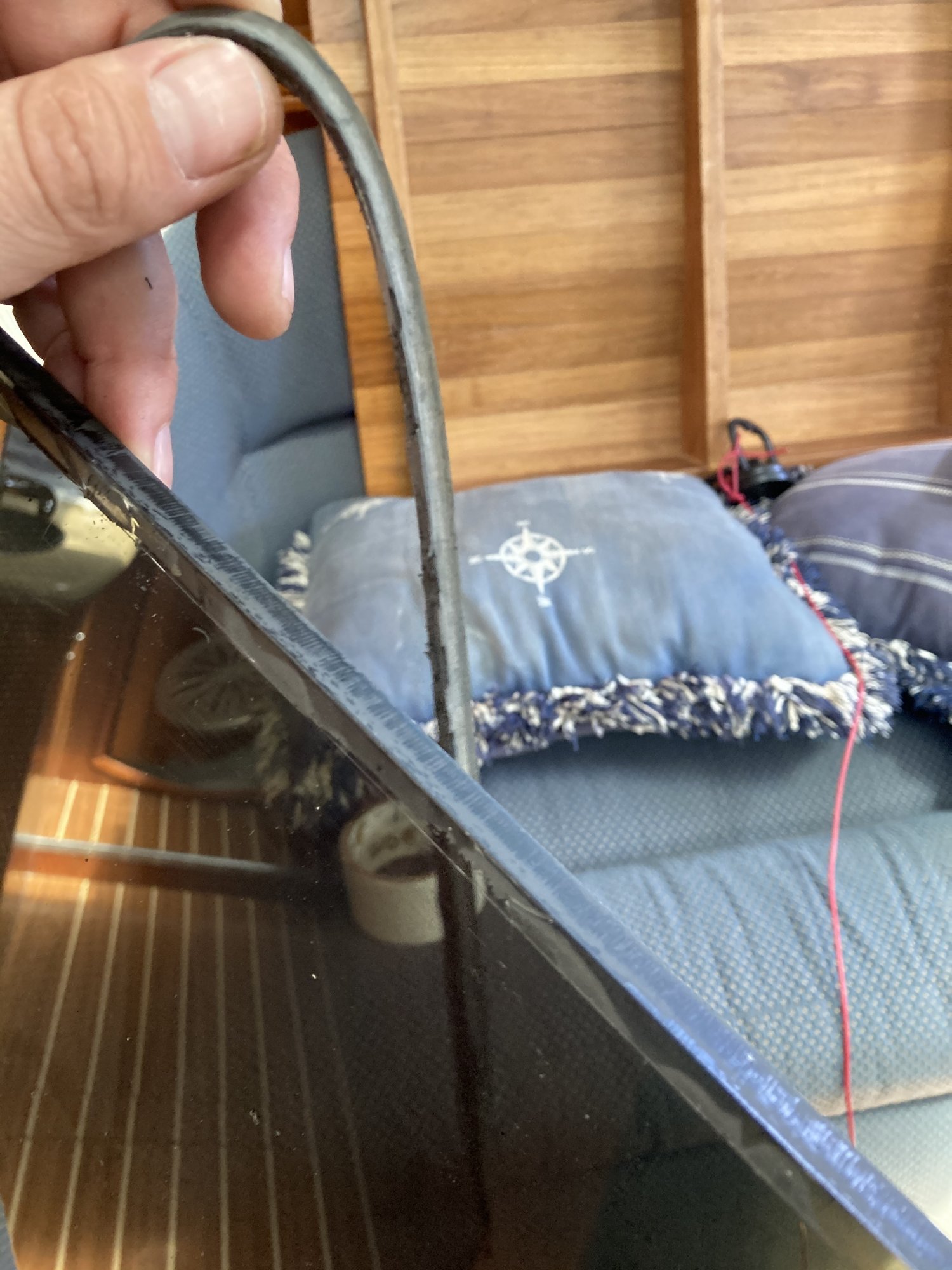

Mar 16, 2021
93
hunter 41 DS tacoma

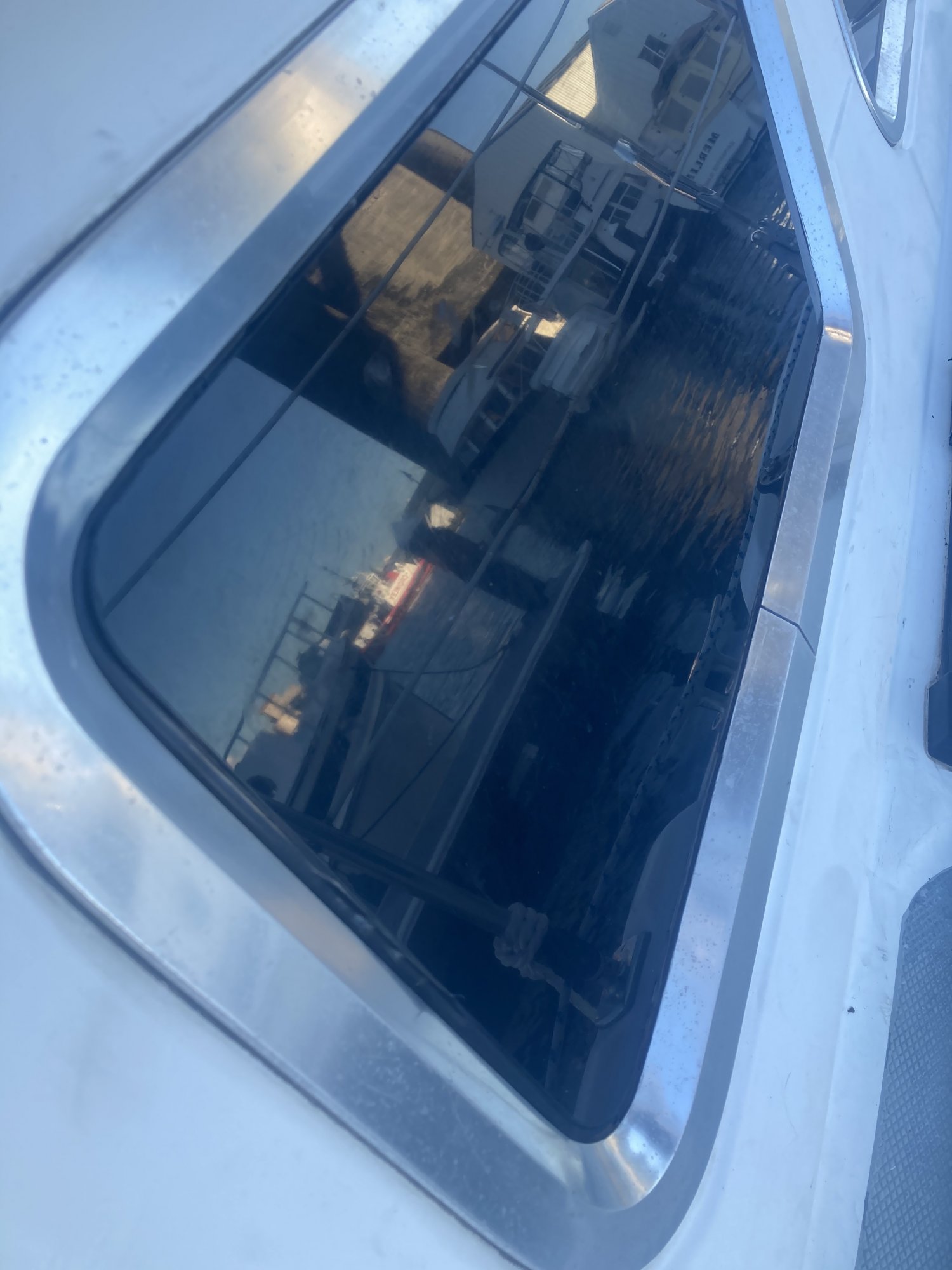

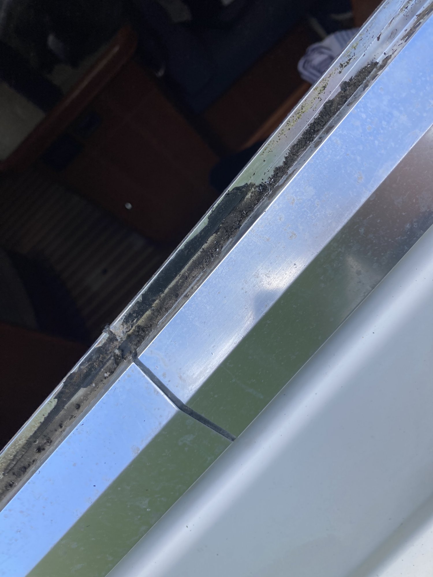

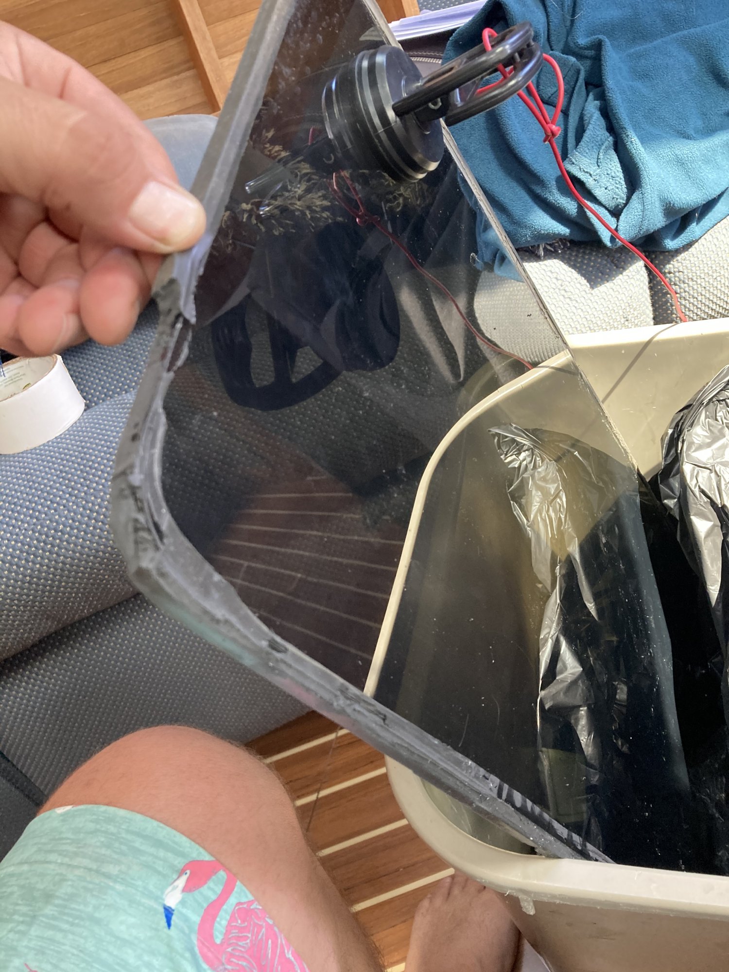

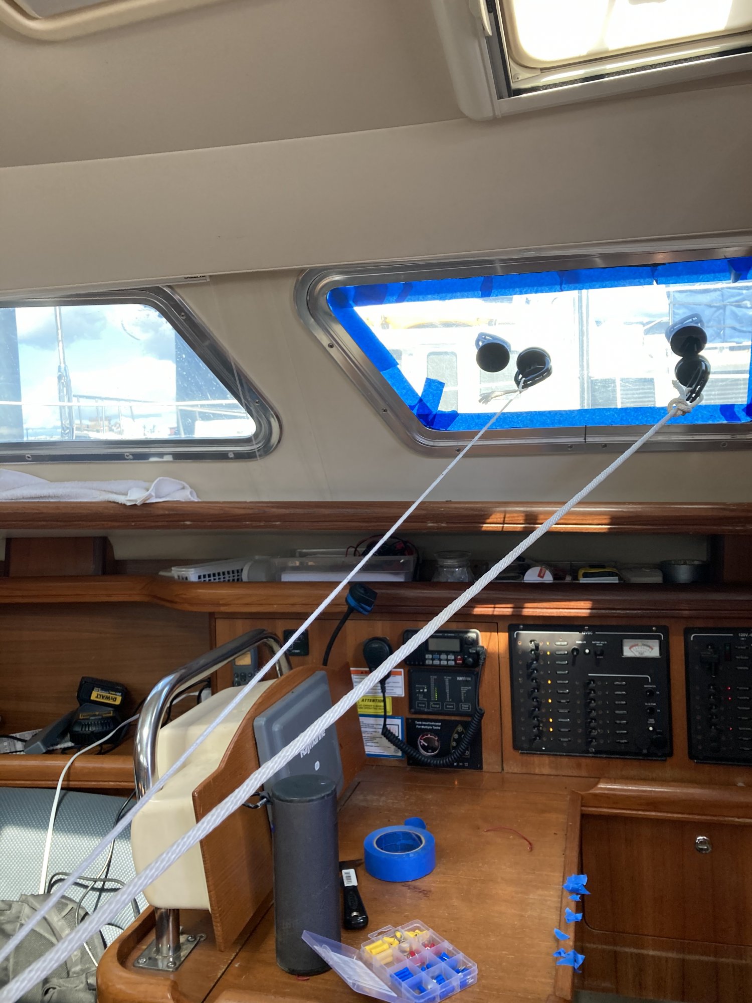

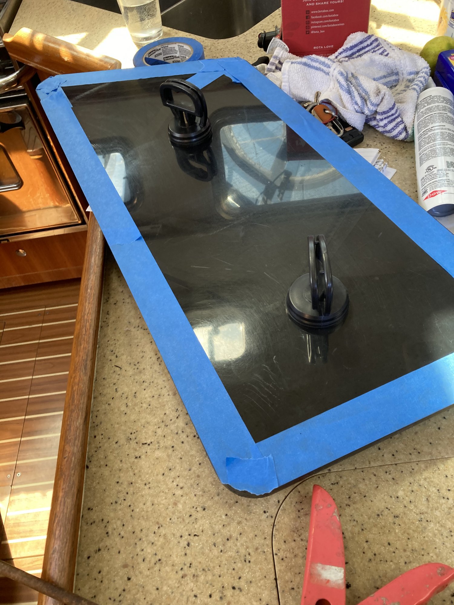

Adding some pics & a tip. I couldn’t find 795 locally & was about to give up. Then I stumbled onto the Dow Corning website, which has a link to regional distributors. Ended up in some obscure warehouse in an industrial park one town over from me.
