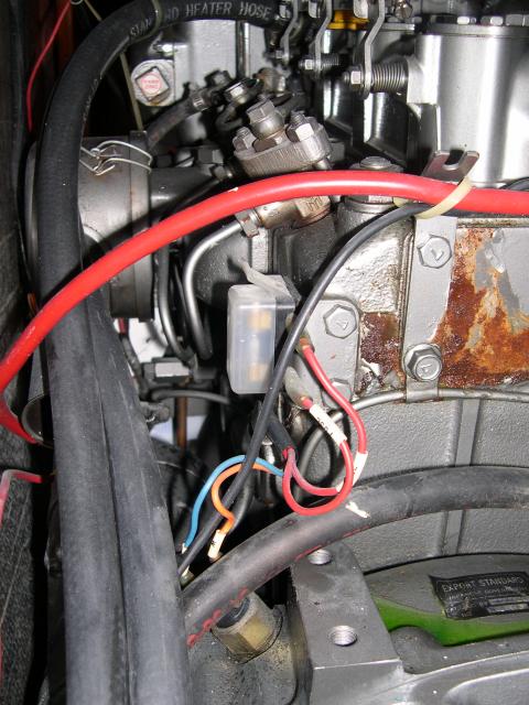

Another note, if you have the F model 3QM, is to check for a coolant leak at the upper-back of the engine. I have a square plate there with a gasket that needs to be periodically changed. Not sure if this is normal, but thats what the PO told me, and after 2 years, its leaking again. (in the picture, the dirty-spot, square plate middle-right )
