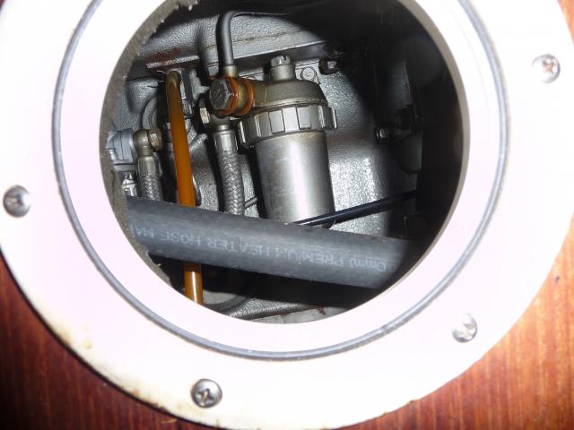

Interesting, Dan.. I am looking at the hose from the pump to the filter on mine right now and it is a gray braided hose that has a "U" bend so that it dips down past the oil dipstick.. Pretty sure it is original.. Much easier to line up.. but the one from the filter to the inj pump is a hard pipe.. Can't get a useful picture of it through the oil dipstick access port..
10,257
Leaky Fuel line
OK, I will try to post a shot .. ya can see the braid line back there in the stuff..

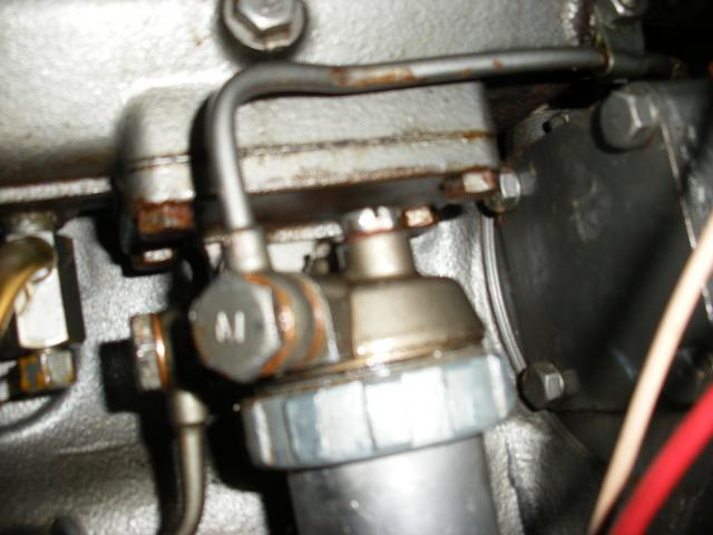

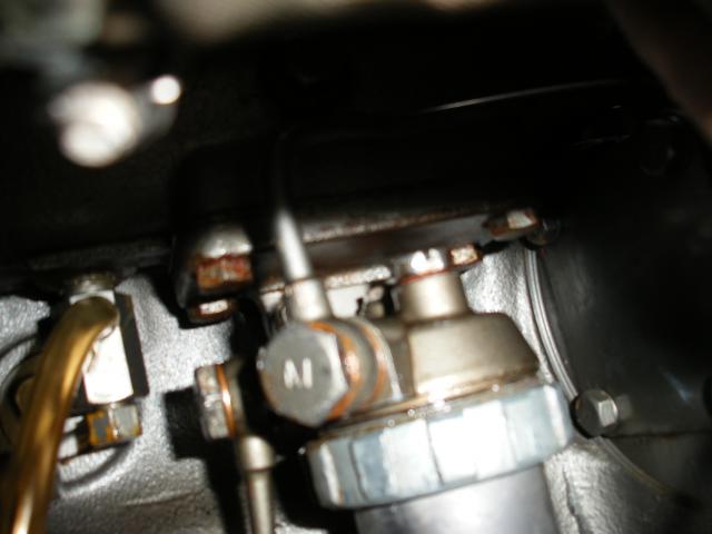

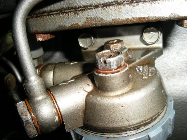

Leaky Fuel Line Update...
Attached are several pics I was finally able (and remembered!) to take of the yanny fuel filter assembly. Note that both input and output lines are solid metal tubes.
Flexible tubing such as Claude's would make it easier to make up the banjoe connection and not have it leak due to misalignment.
