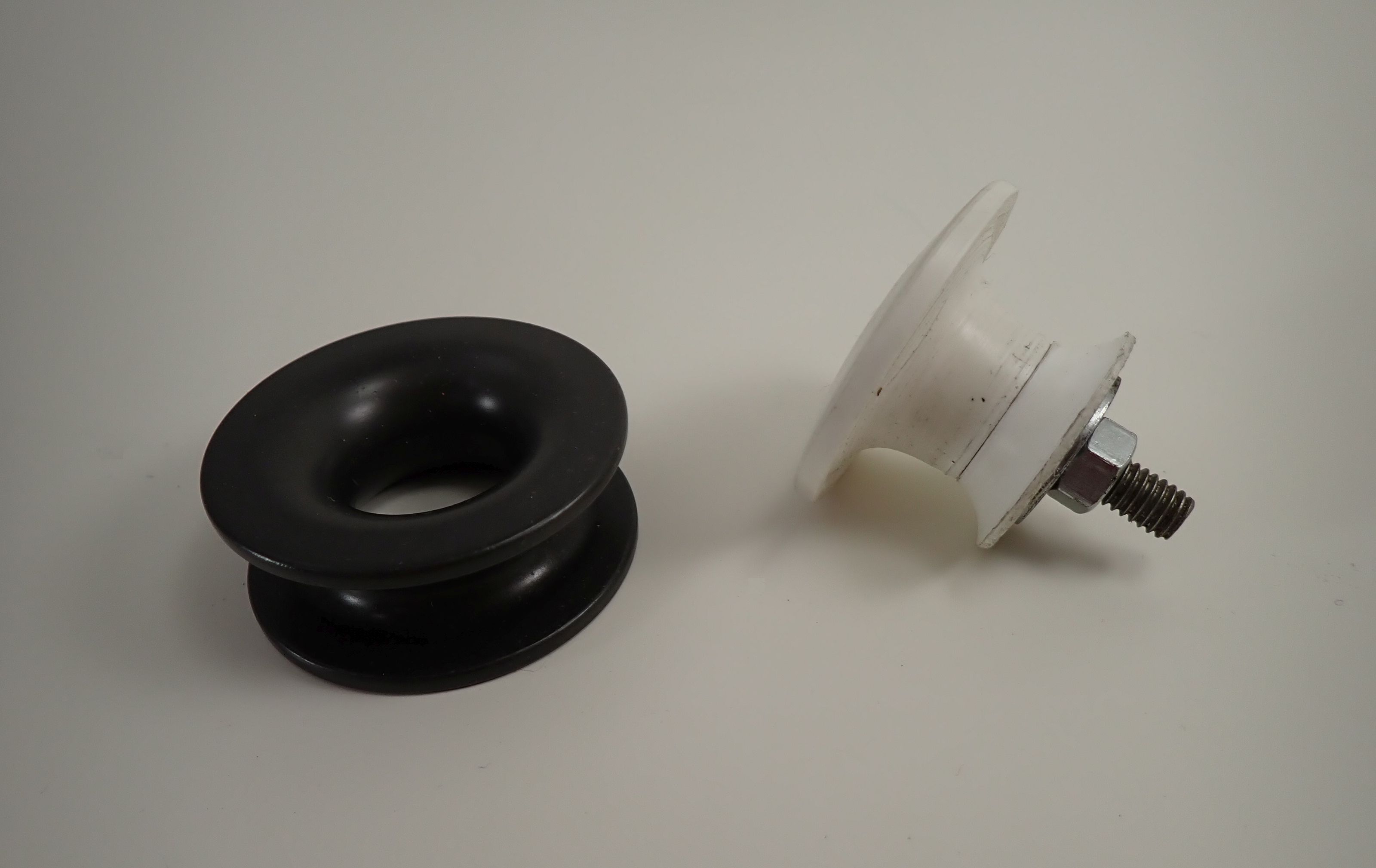

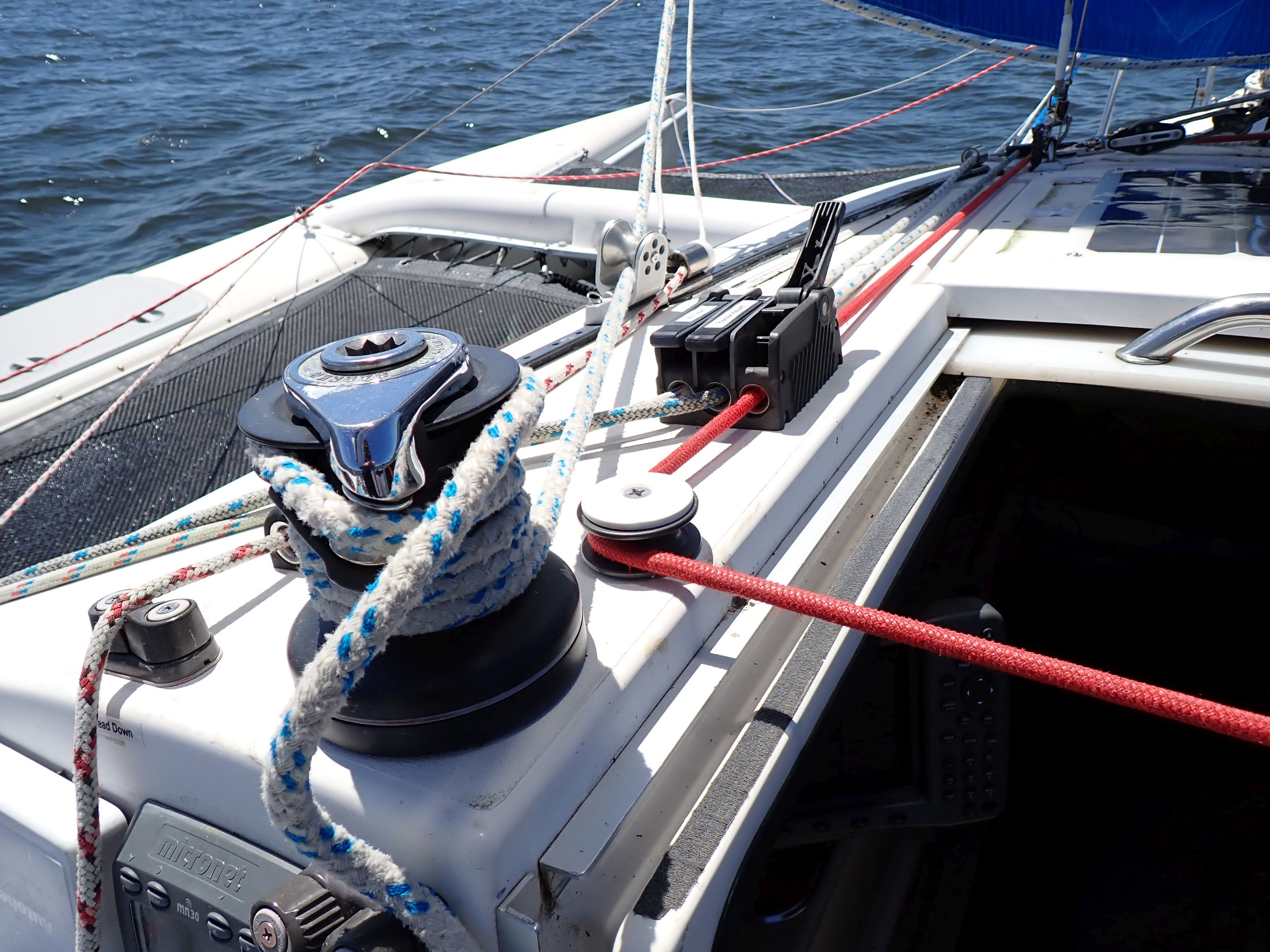

Here is a sailor-specific example of something that can be made on either a lathe or 3-D printed. I needed a winch feeding block and I had a large low friction ring with exactly the size and flare I had in mind. I turned the core from two disks of HDPE, but it could be printed in two pieces, and the plastic strength is not that critical because the hub is so large. The friction of HDPE on a low friction ring is so low it's like ball bearings, maybe less at high load. I only needed one, so I grabbed a scrap sheet and turned this out in about 30 minutes. You cut disks with a hole saw, mount them on the lathe with an arbor, and turn using radius and taper set-ups to match the LFR. A single bolt holds it together. The lathe is probably faster for one-off, if you have the jigs and the practice, but the printer wins hands down if you need several. The lathe allows more material choices. For example, if I had not had an LFR to start with, I could have turned something from aluminum. But you can just buy the LFR. Different thought processes.
I would love to see someone come up with a 3-D file for winch feeder blocks from LFRs; it really worked great and is very simple. Compact, strong, and silky smooth. The idea would be far more accessible as a 3-D file than as a lathe project.

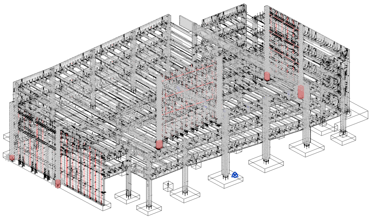

I just retired and closed my one-man structural engineering consulting company and have spent the last several decades 3d modeling buildings, so this was a natural outlet for my creative juices.

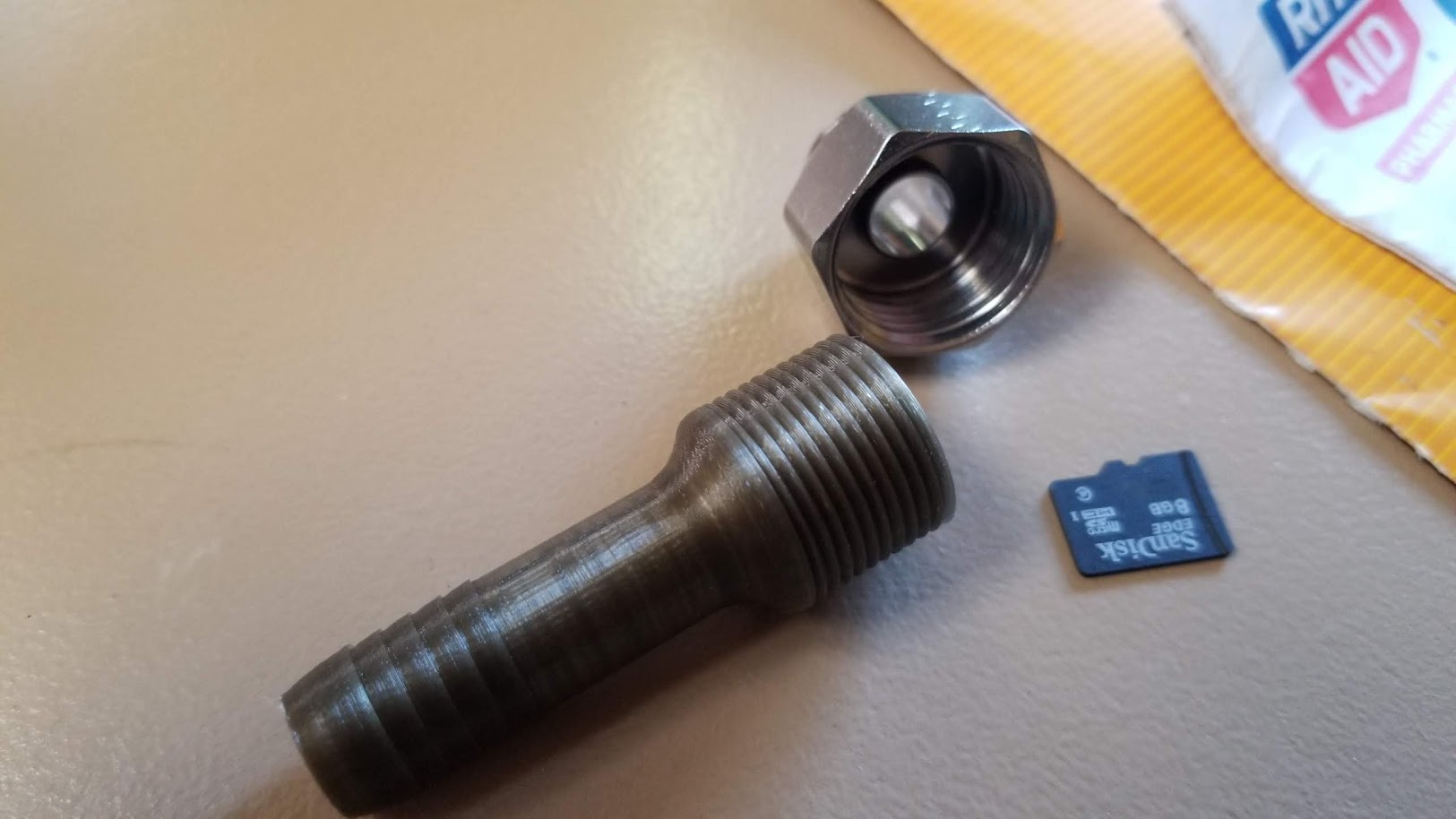

I think that the strength issue is something that gets more attention with experience.
When I was relatively new to 3D printing, we had a plumbing fitting fail and there was no hardware store open within a reasonable drive. I was excited because I could simply design and print a replacement for pennies. That was true. I did design and print this part:
And, it did fit and work ... I think for a day or two. What I did not appreciate, at the time, was that a part is weakest along the layer separation. And, in order to print clean threads, I needed to print in that orientation. And, I could not really print the part any bulkier to compensate for that because if I did, it would no longer fit and/or it would restrict water flow.
Still, it was a good immediate/temporary fix.

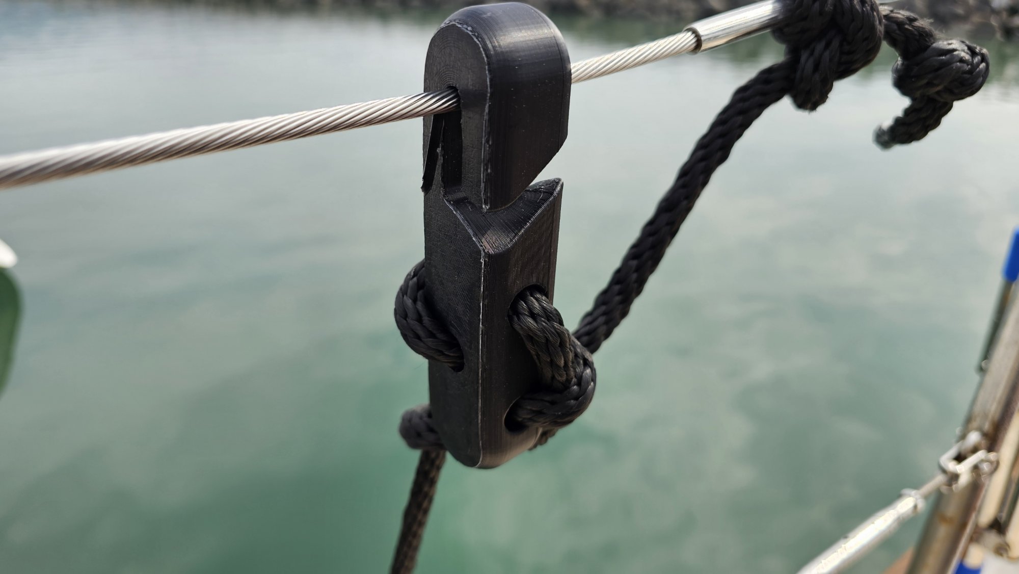

Over time, you learn what you can and can't get away with. I just designed and printed a lifeline fender hanger (just came off the printer this morning, in fact). I oriented the print and altered my print settings for optimal strength. And, the item was designed specifically to be printed - with those benefits and drawbacks in mind. I think that you just need to experience some failures to start to approach projects with that in mind.

Here's that fender hanger (prototype). I printed in super low-quality with a 0.8 nozzle, just to verify the design. And, the completed part will be annealed and polished. But, it should be amply strong so I'm leaving it in place on a non-critical fender for a bit. Pretty happy with the design. (The line leading off to the right is just the bitter end secured to the lifeline as a backup until I'm confident it won't come off.)

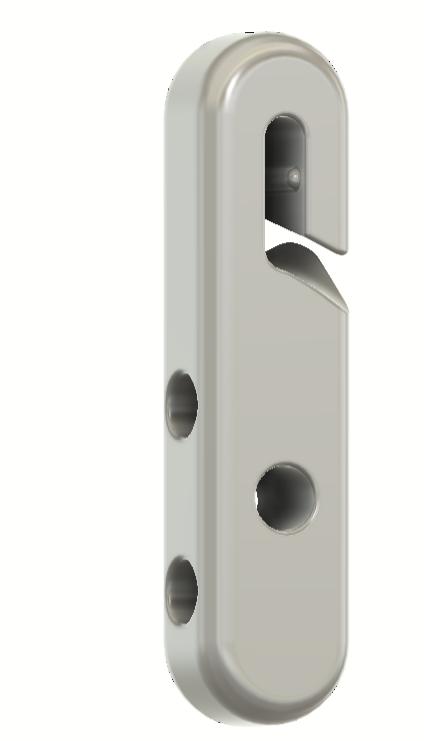

It's a little hard to see, so here's the design. The whip weaves through the holes and locks off on a loop. I'm pretty pleased with it. Very easy to adjust and super easy to hang and remove, but doesn't seem to want to accidentally come off. We'll see how it goes after a week or two of cruising:

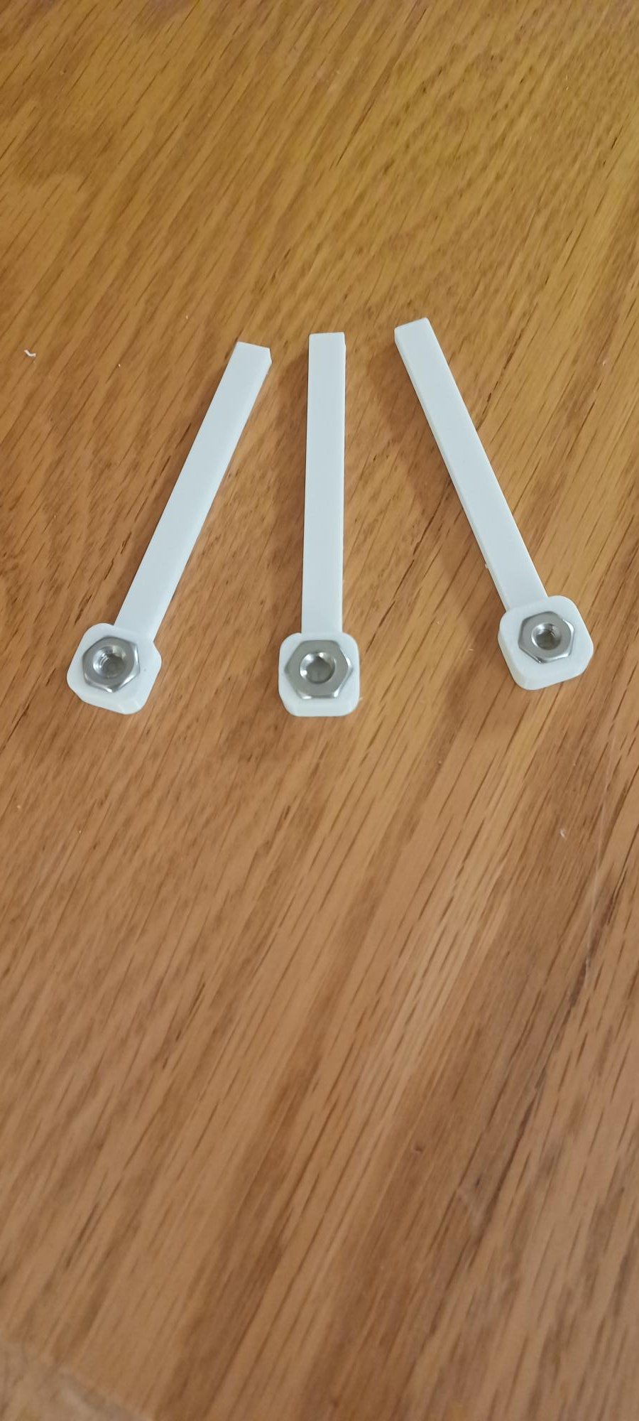

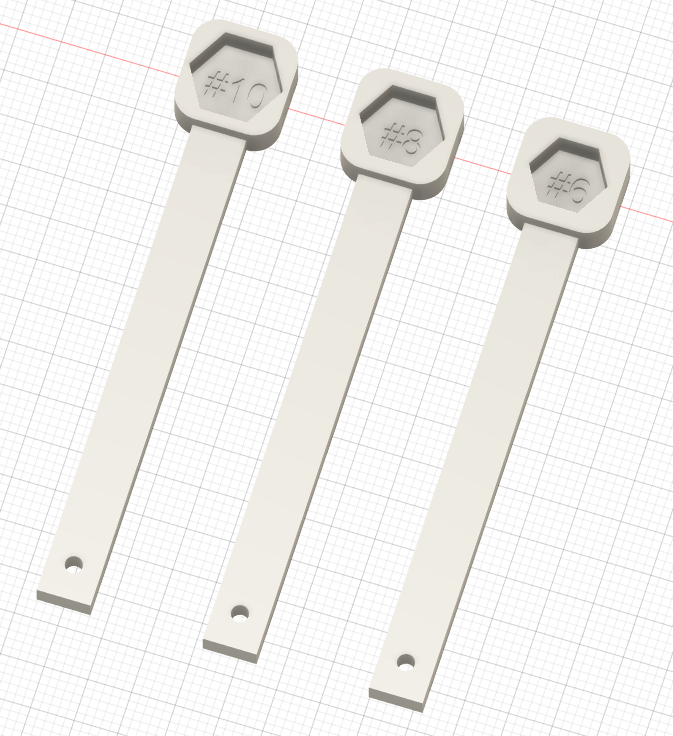

I have not decided if they should be called Nutsets or Nutters.
Anyone who had gone through the ordeal of rebedding the stanchions on a mk2 Catalina 30 will likely agree with me that it is the most frustrating endeavor to be undertaken on a C30. Tiny little nuts that need to be placed in a small gap beyond the reach of a fingertip.
These are captive nut holders with a short handle. The nut pocket is blind so that once the screw is threaded onto the nut, it will be pushed off so that you can then use a box end wrench to firmly hold the nut to finish tightening the screw. I have modified the print to have a hole in the handle so that you can tie it to your wrist for all of those times it will slip out of your hand before the nut is finally secured.
