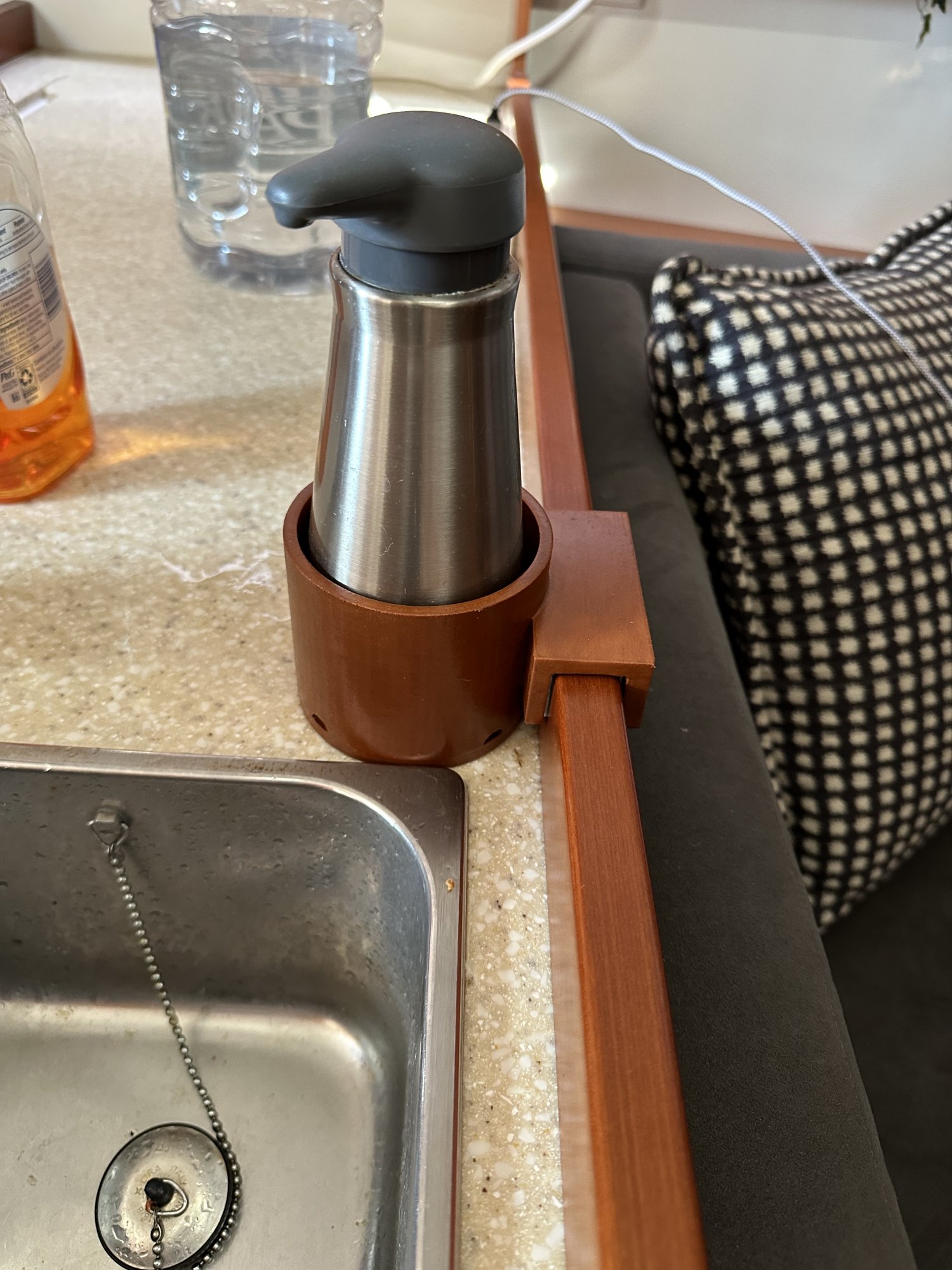

Have fun! I like making little projects with mine. Boat stuff I’ve made includes:

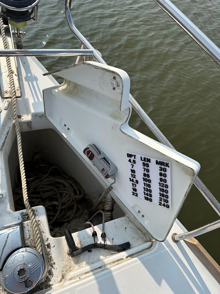

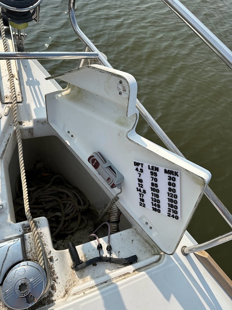

Placards: When a label maker won't quite cut it, even a very modest 3D printer can make some pretty detailed placards. This usually takes a bit of hand-finishing to not look like a cheap 3D-printed plastic part, but the result can look pretty good. I have some bronze-looking panels.
Yes, I forgot about that one, but I also did make a handy placard to remember which rode marker to let my anchor rode out to based on my depth reading. (Neither the depth reading nor the rode markers are exact amounts for reasons I don't need to go into here).

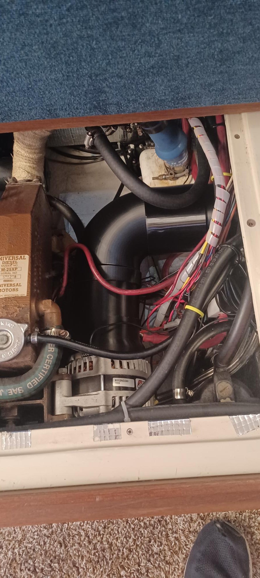

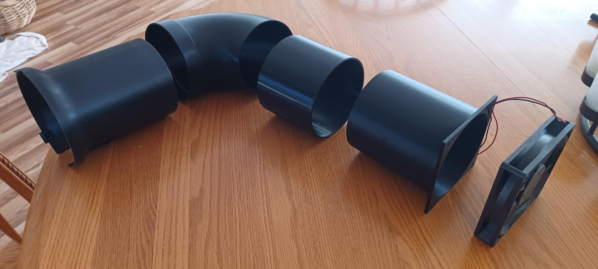

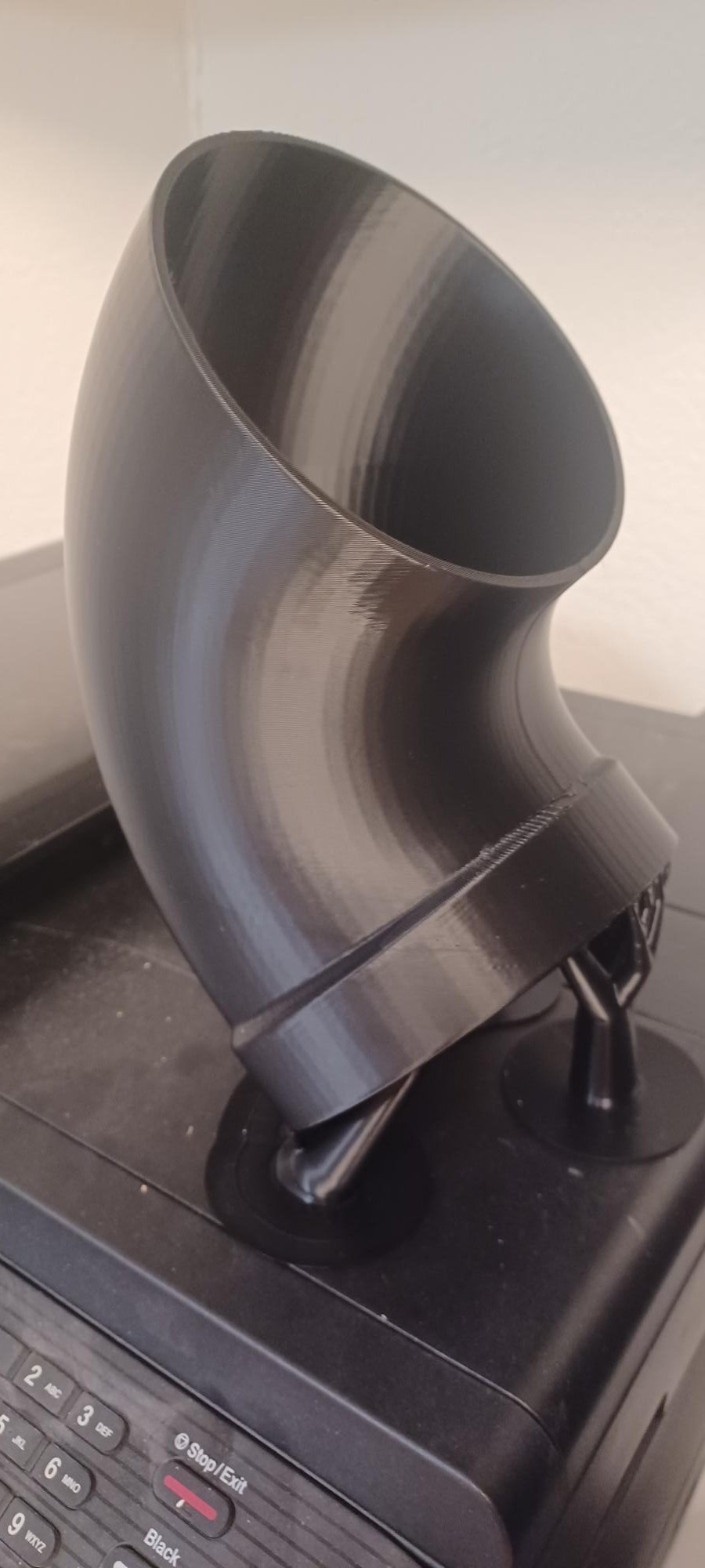

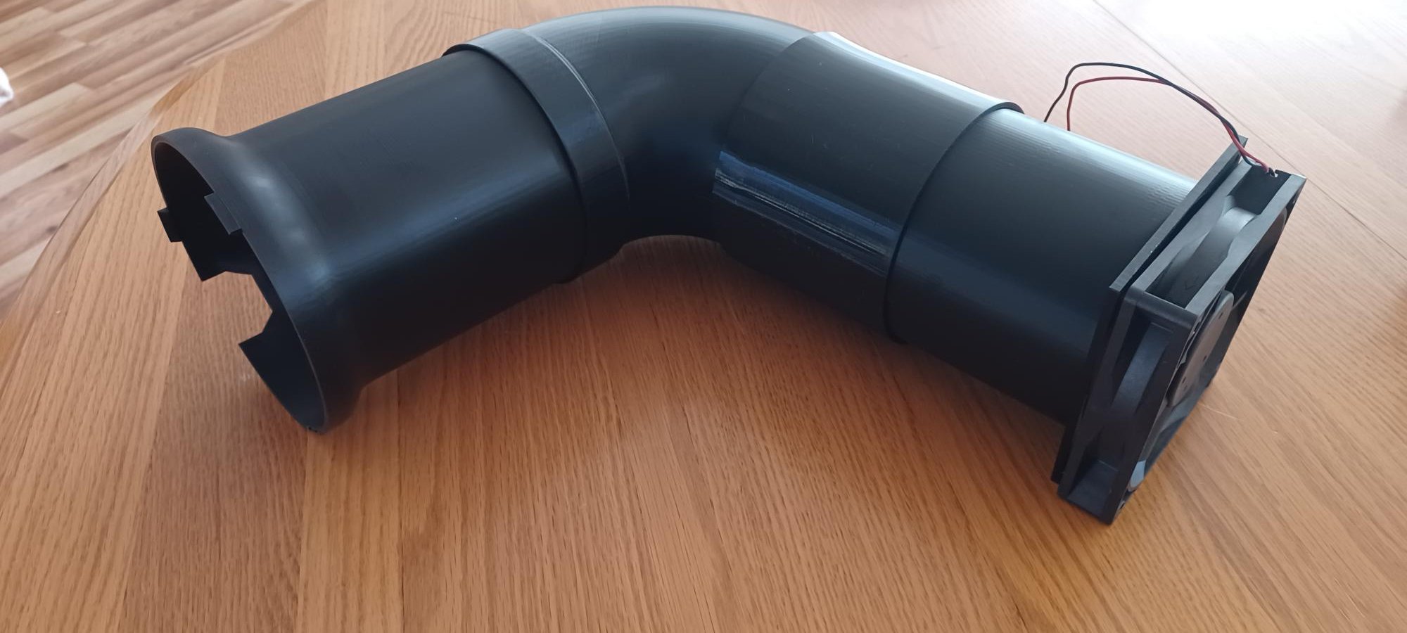

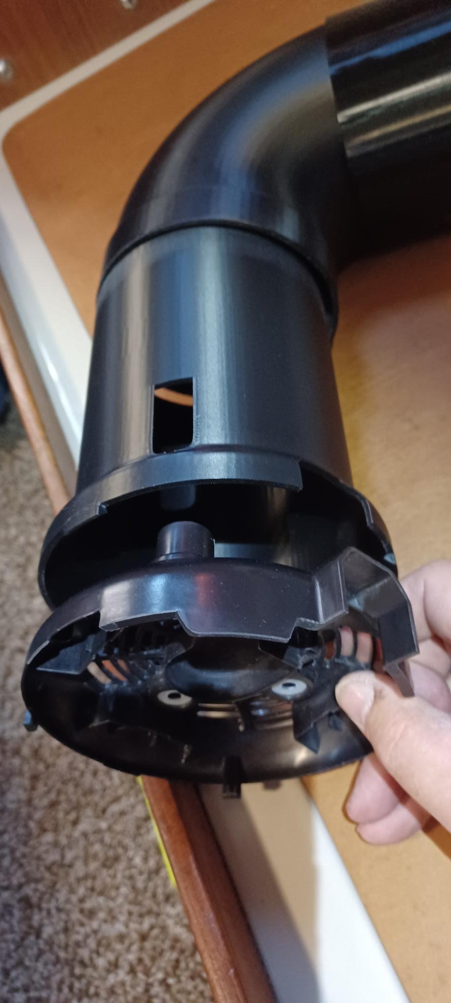

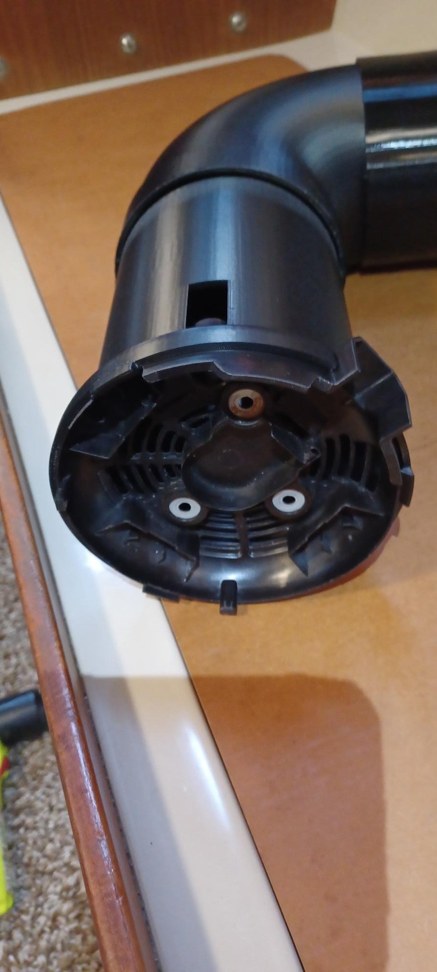

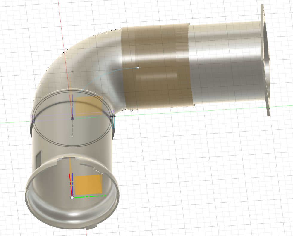

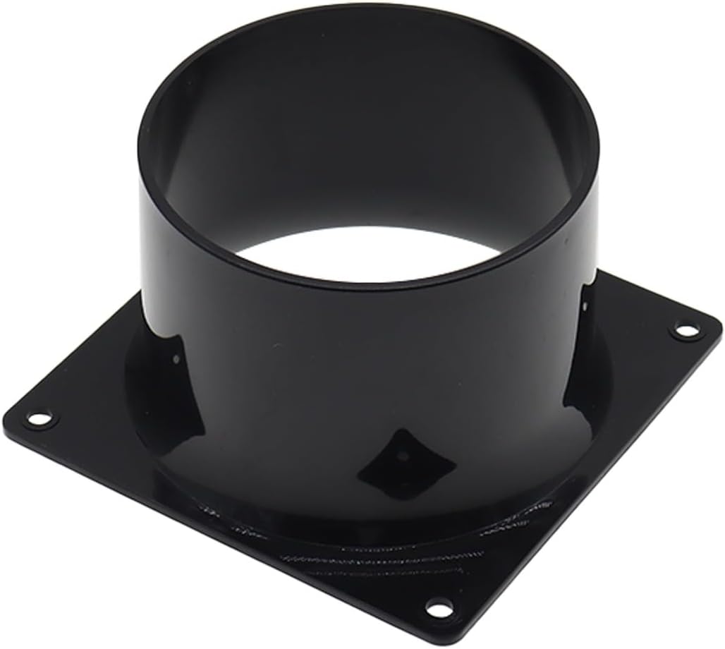

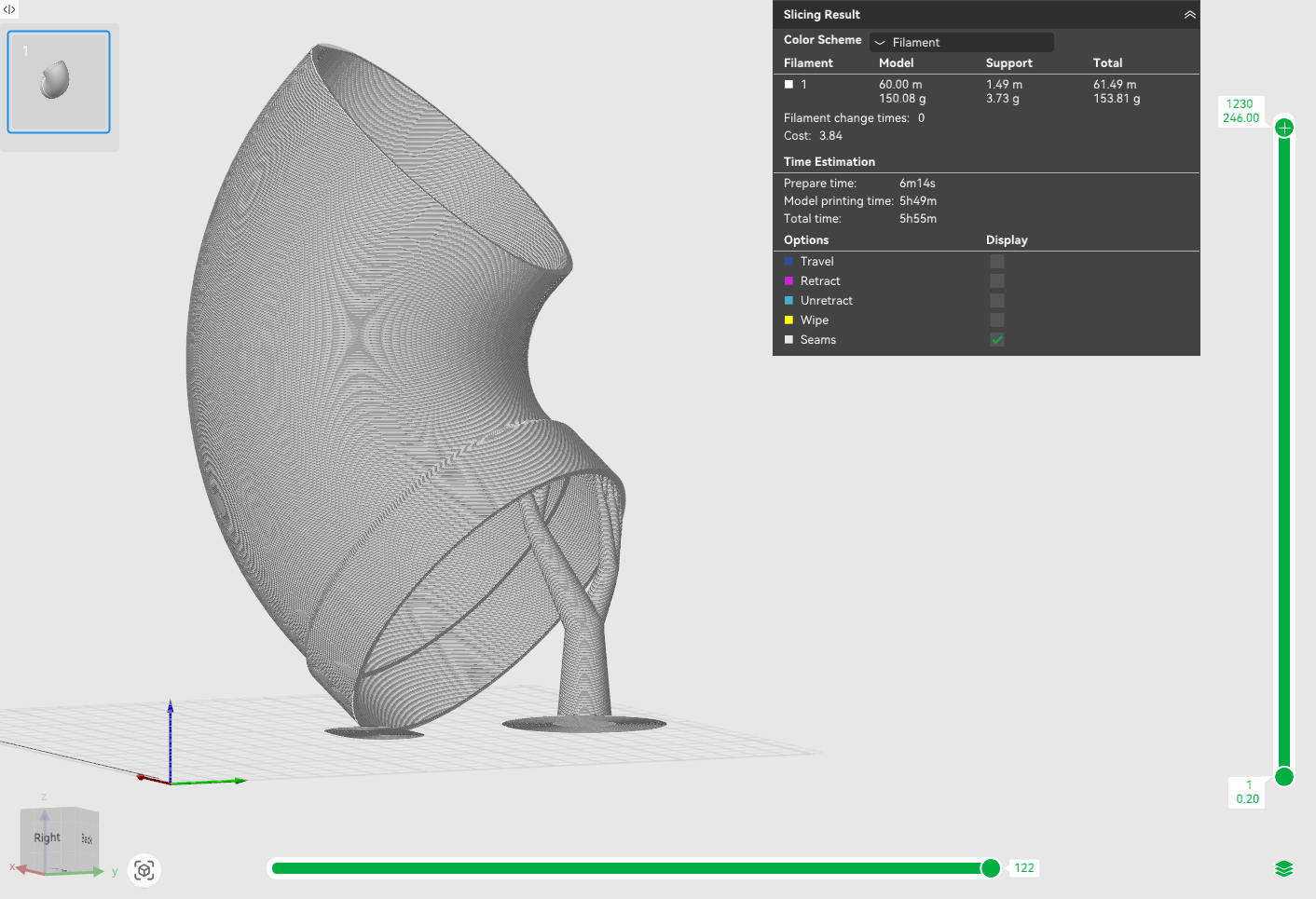

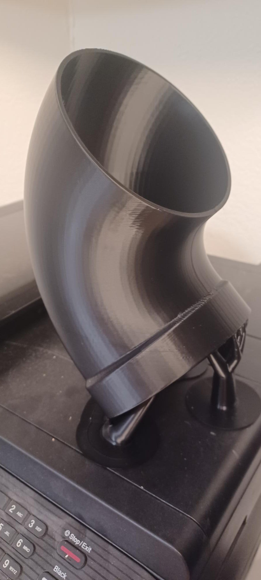

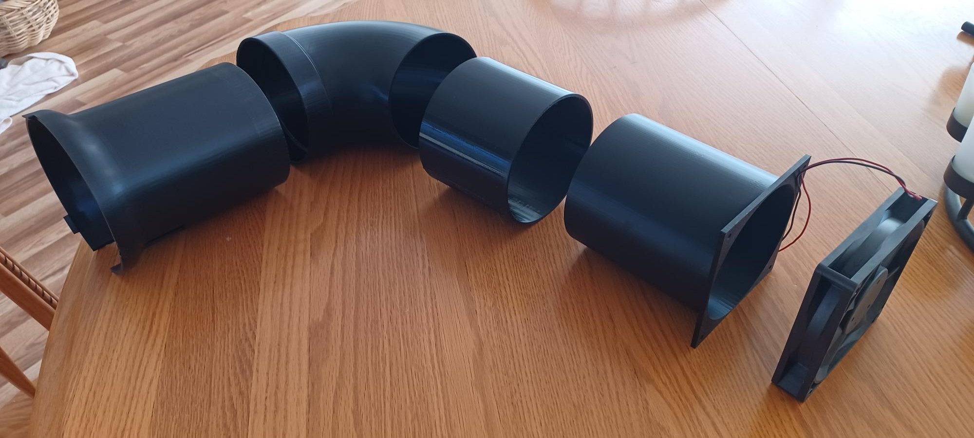

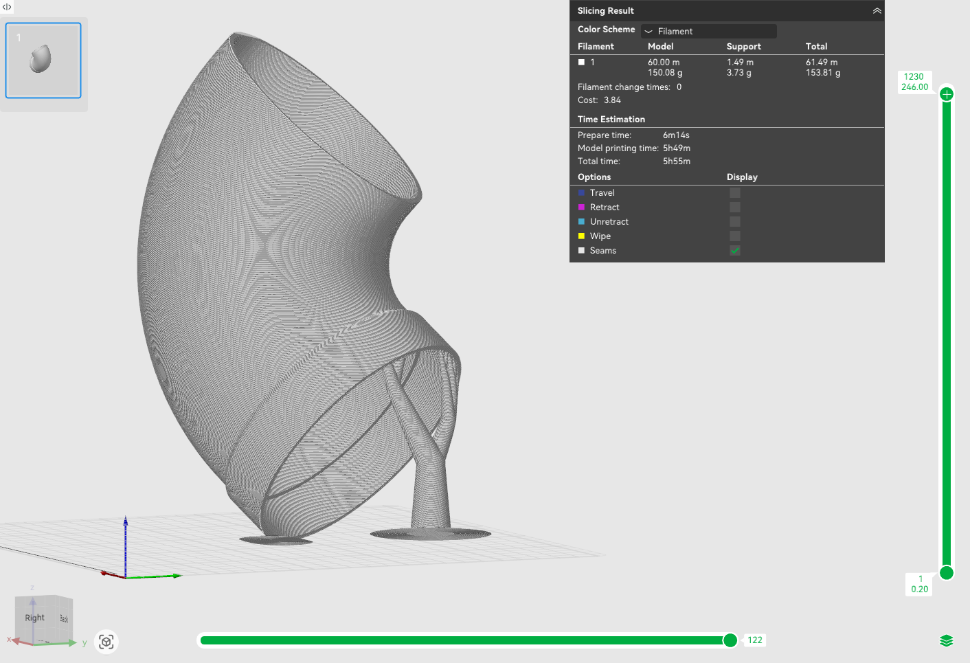

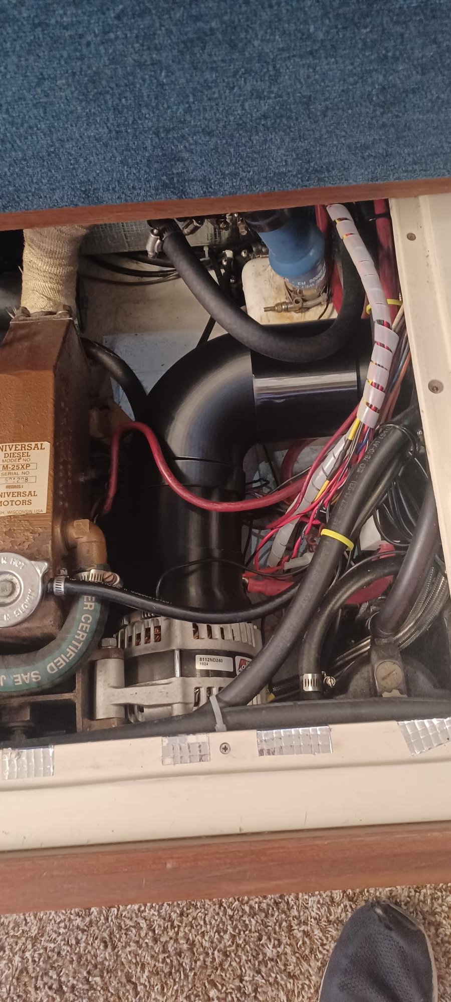

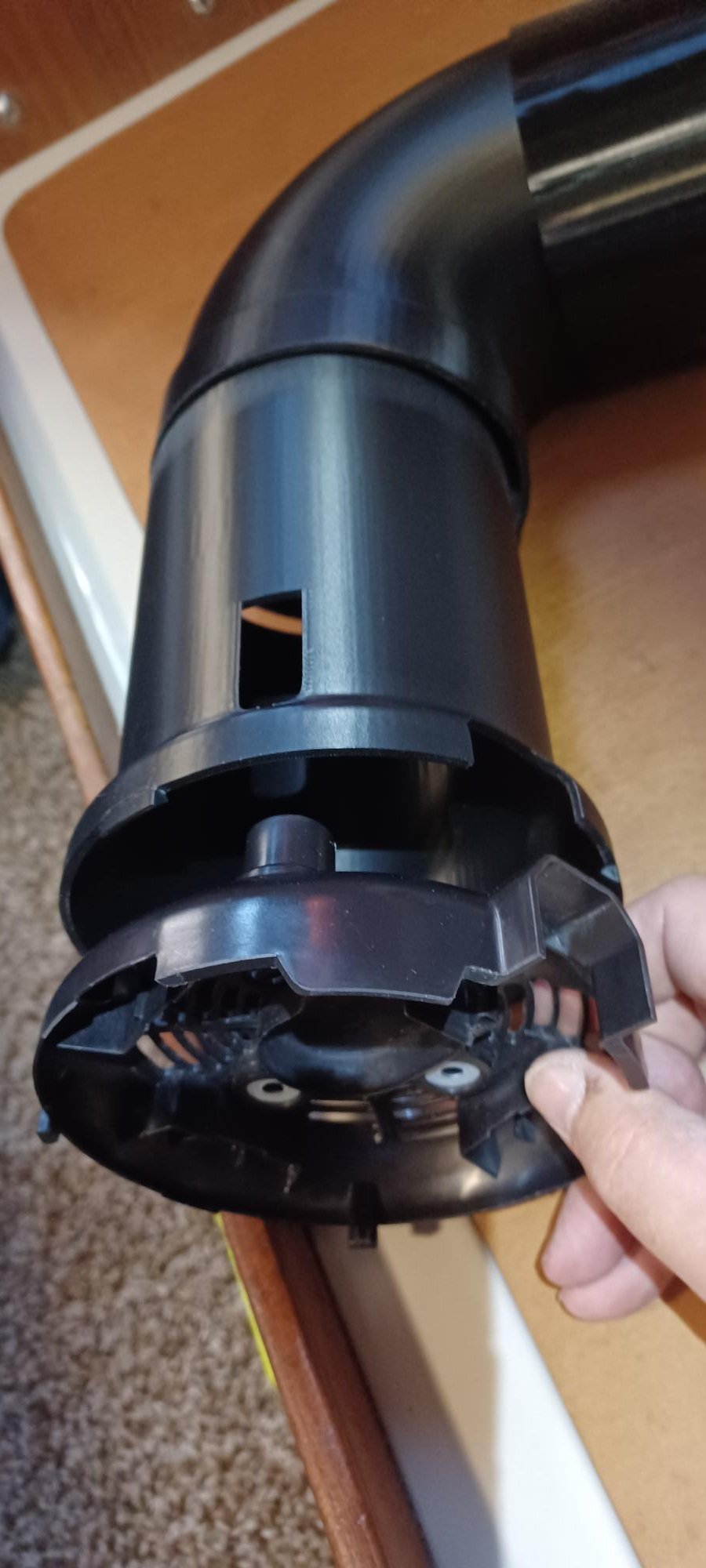

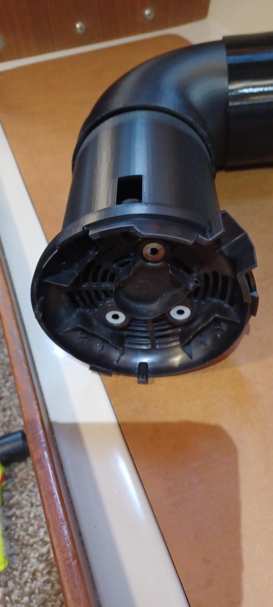

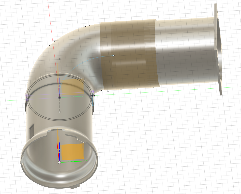

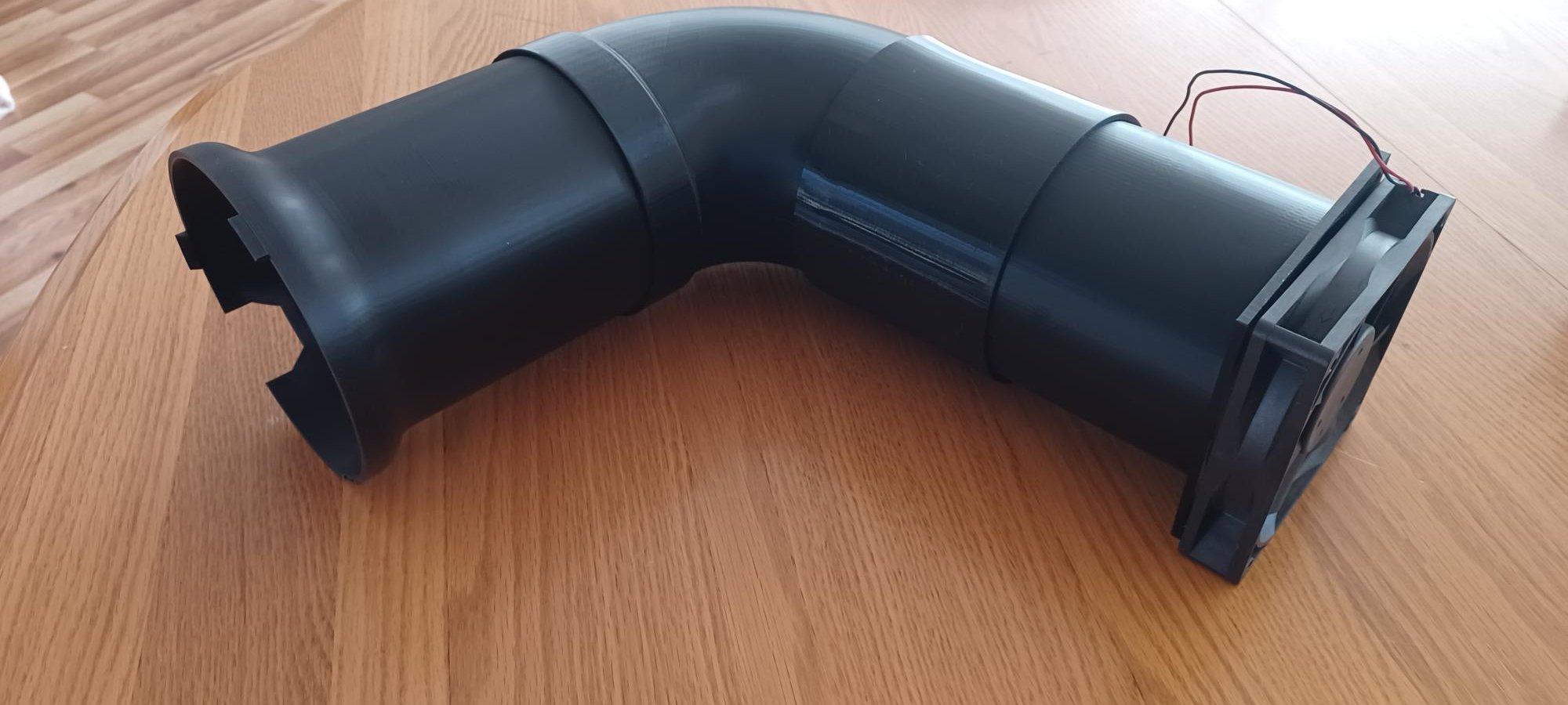

Well, I finished my first "real" 3d printing project and am happy with the results. Last year I installed a 250A alternator in Papillon for recharging a 560Ah LFP battery bank, but it runs very hot in the fully sound insulated engine space. I have built a ducting system to pull the cool 60º air from the bilge outside of the insulation and deliver it directly into the alternator.
Fusion 360 model of complete duct system
Final assembled duct system with 120mm case fan.
Exploded view
End cap of alternator and adapter duct which is designed to fit over it and confining incoming cool air into the intake ports.
End cap and adapter plate assembly.
Slicer file of elbow
Final print of elbow.
Final system installed in boat.
23,938
Nice project Hayden. Way to put those retired engineer brain cells to work for the good of sailing. :beer:
