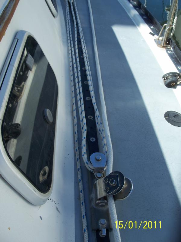

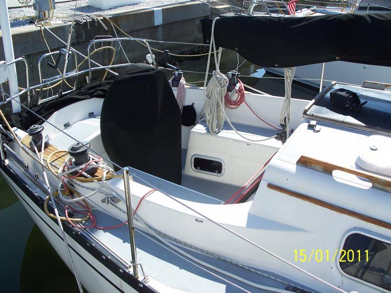

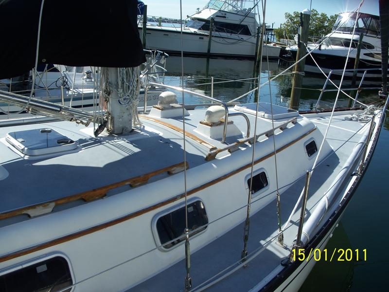

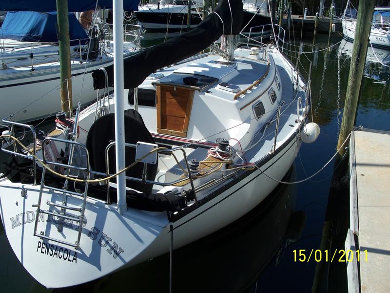

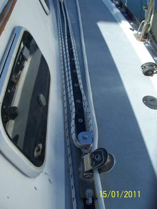

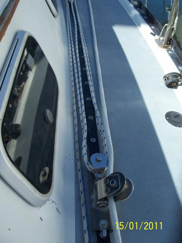

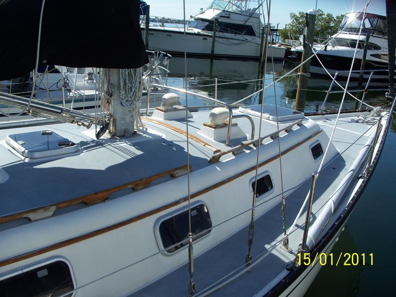

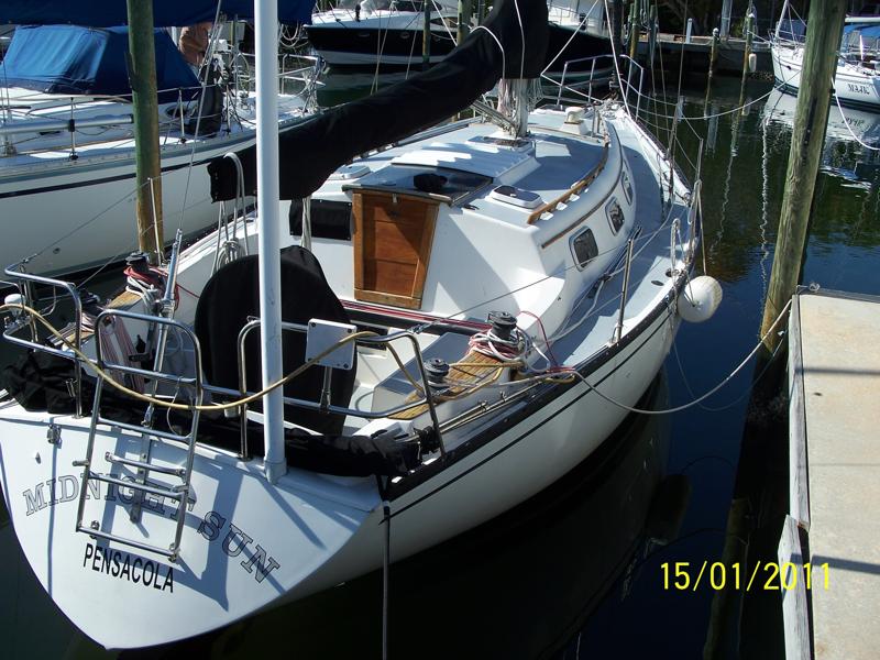

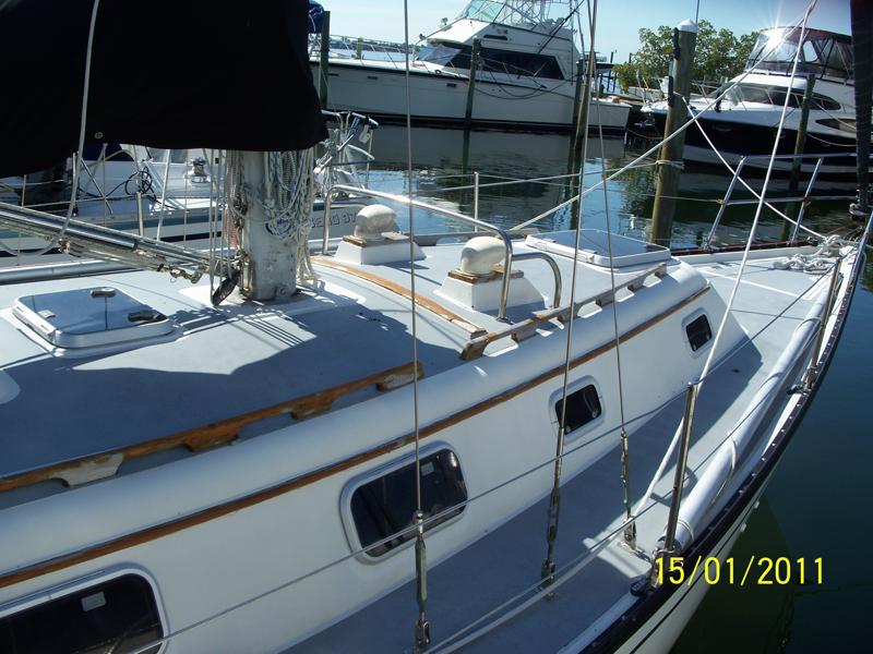

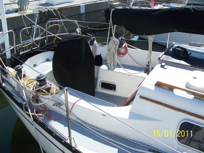

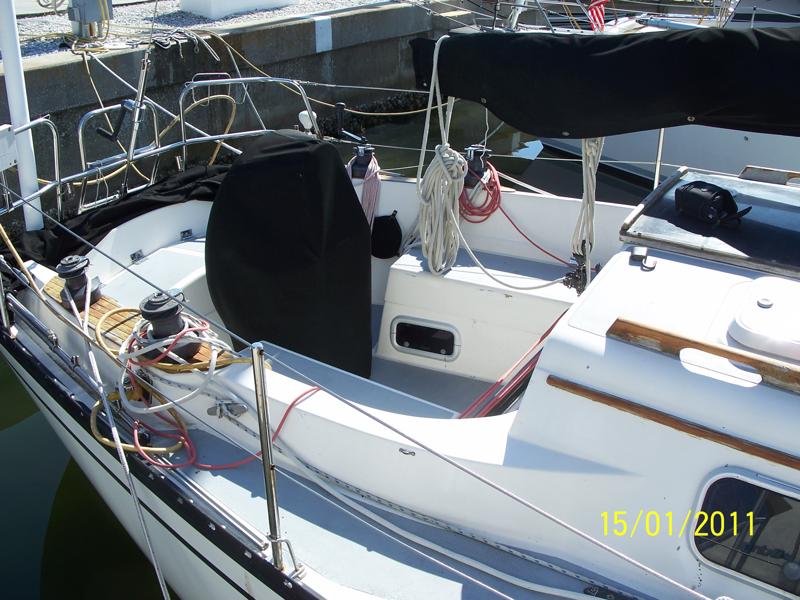

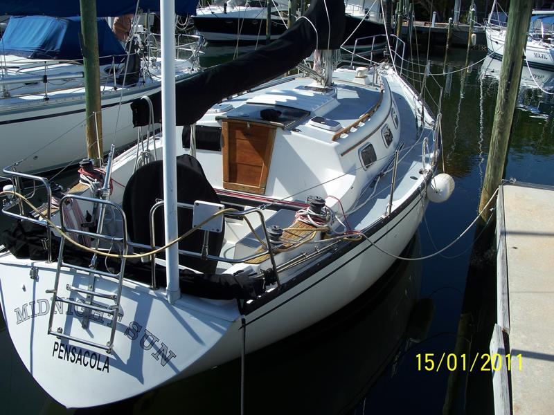

Are you thinking INSIDE the shrouds? I forgot that I have these pictures from Blaise's boat. You can see his jib tracks and that he sheets between the shrouds and lifelines.100_2895.jpg 100_2896.jpg 100_2897.jpg 100_2899.jpg

Are you thinking INSIDE the shrouds? I forgot that I have these pictures from Blaise's boat. You can see his jib tracks and that he sheets between the shrouds and lifelines.View attachment 129530 View attachment 129531 View attachment 129532 View attachment 129533
For Ed:

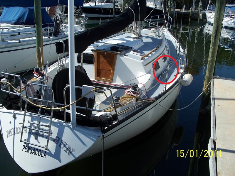

Thank you so much for posting the pictures. (I presume that Blaise doesn't mind too much!) Yes, as inside the red circle area that I added to one of your posted photos, (attached) that is exactly my project vision. As on the Midnight Sun, my sheets will be routed outside of the shrouds.
For now, however, I am not planning to add the fore/aft "from the cockpit" adjustment system that Blaise has installed. Since I sail in protected waters, rather than open ocean, when I want to move the car fore or aft, I can carefully go on deck when the sheet is on the lazy side and move the car along the track. Much the same as I do now with the OEM snatch block toe rail sheeting.
For BLAISE:
If you are following this thread:
1) Was your addition of the track next to the cabin house an improvement for close haul sailing compared to toe rail sheeting?

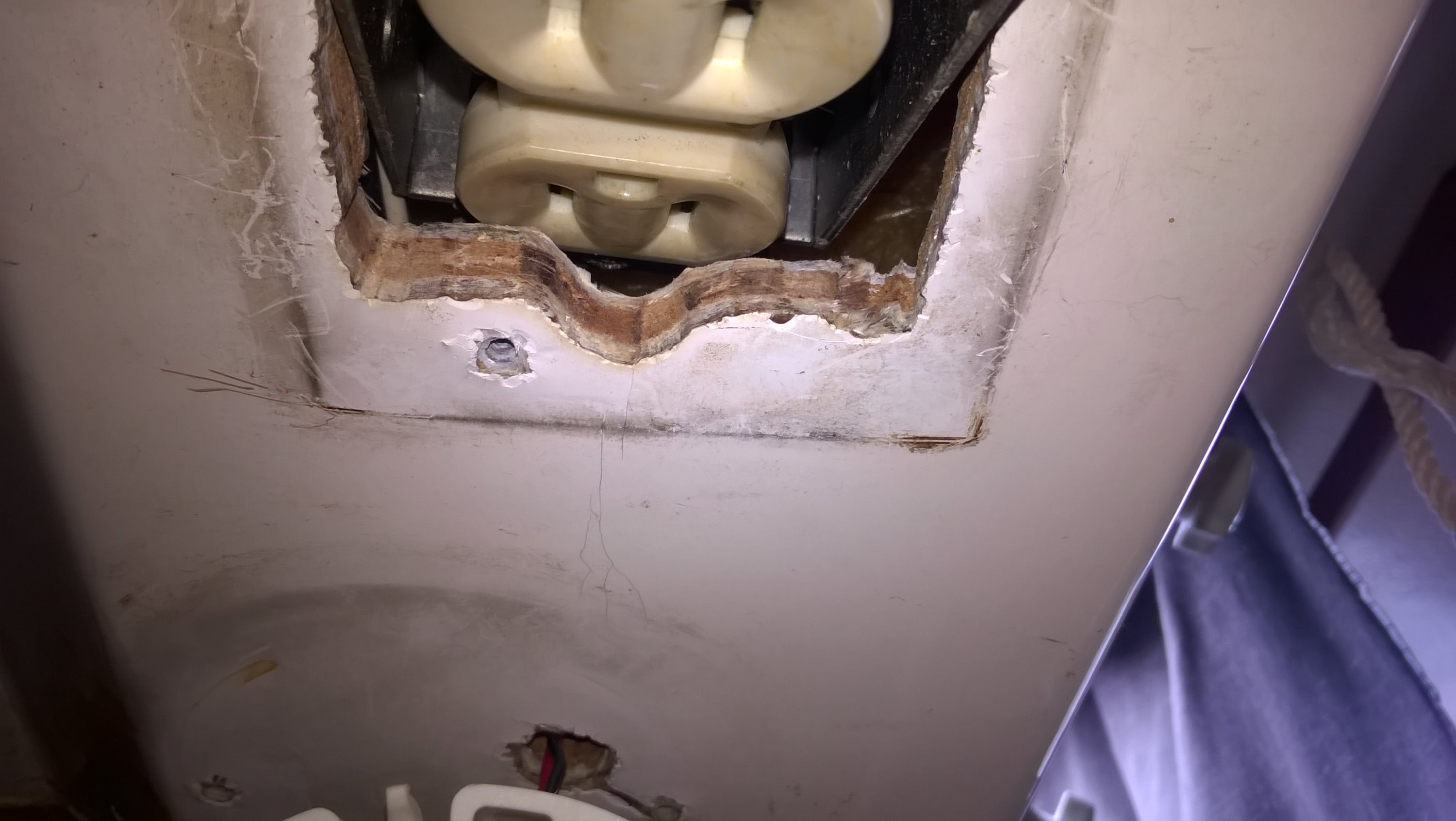

2) Have you found any stress/structural issues along the after market t-track? On my 1980 Cherubini Hunter 36, all I have for the deck that close to the cabin housing is ~1/4" -5/16" single layer of FRP. NO WOOD CORE . When I drill through the deck layer from the top at this location, I go into a 1.5" void space (where Hunter routed the 110v wiring) then the interior ceiling liner which at that location is is 1/8" FRP + 3/8" plywood core + 1/8" FRP. (See the other picture I have attached). My previous plan, now definitely reinforced by the pictures Ed posted of Midnight Sun, is to install the track close to the cabin housing. Combining with the segment of the interior liner shown in my photo, I have figured out a way to make the bolt-through very rigid to minimize flex. But just to ask: After you mounted your t-tracks, have you seen any cracking of the FRP? Also any added flexing in the area that might break the caulk seal around the ports? Many thanks for any impressions.
