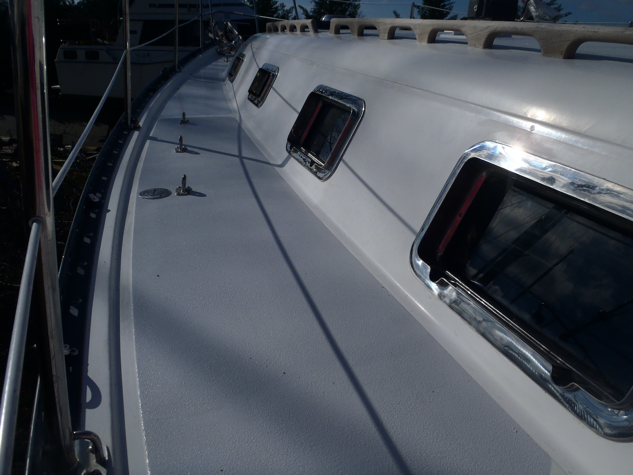

I went with their full SS portlights. I’ve slowly been replacing them, and in the process fixing core rot.

Ventuse - definitely handsome windows and nice installation. I am still curious about the Tri Matrix.

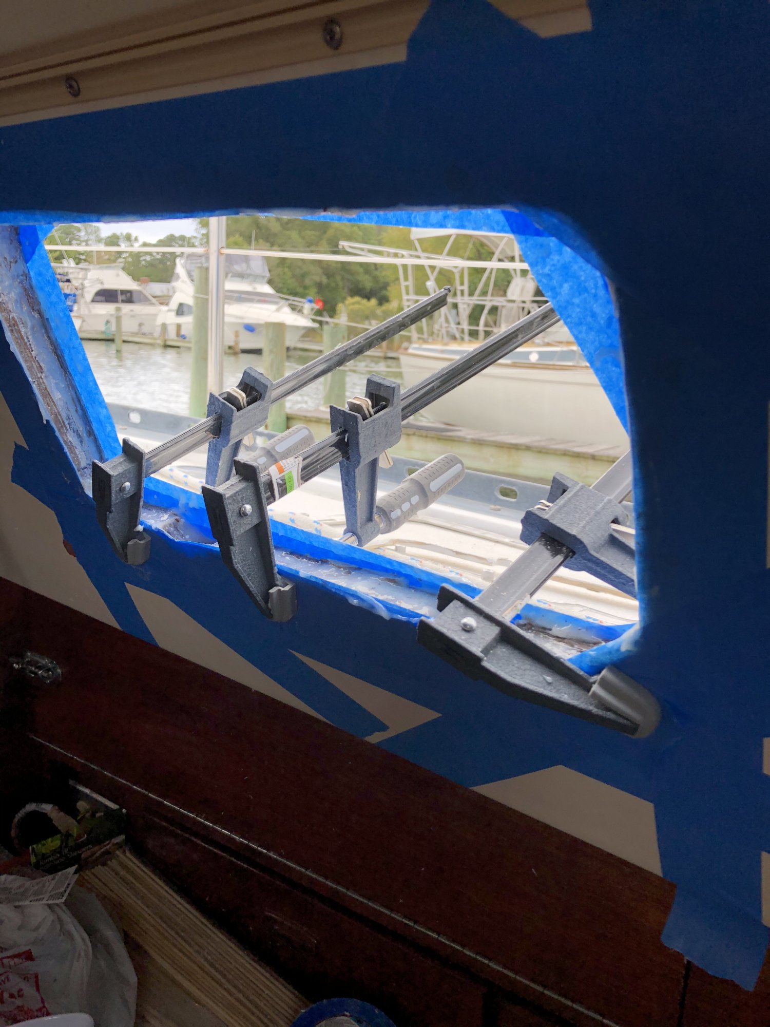

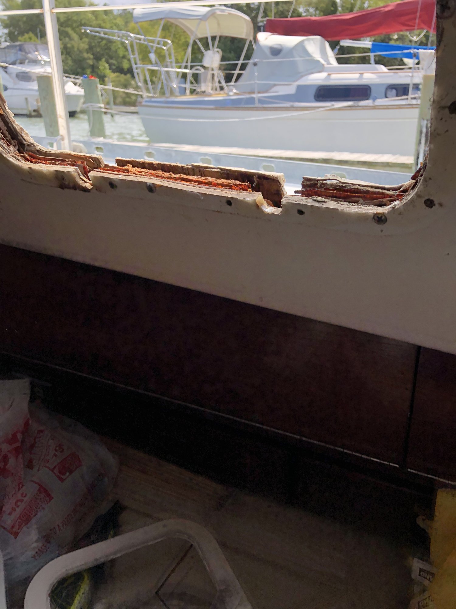

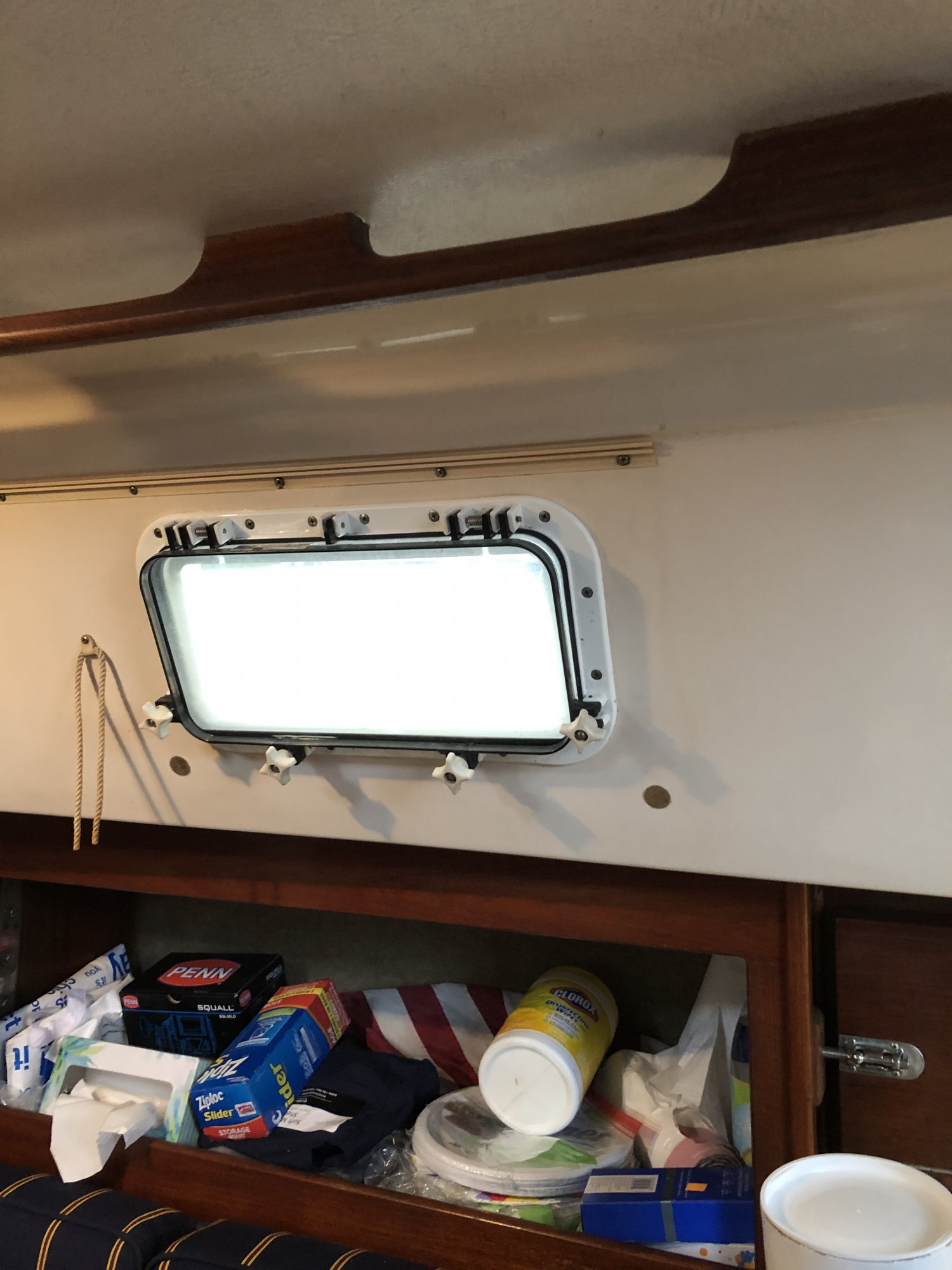

Hi @sandpiper10471 - thanks for the pictures here. I'm replacing portlights in my 37c. I'm told there's a step by step guide somewhere, but I can't find in the forums. Do you have any guidance?
First time replacing. When I bought the boat the owner had bought a full set of the old grays plastic portlights new, so I'm using those - though I'd prefer the metal.

From memory, since this is my second Cherubini, I suspect that guide comes from Grey Enterprises. My first I replaced with all new. The current vessel came with newly installed but badly done. New portlights installed over rotted core is never going to work!

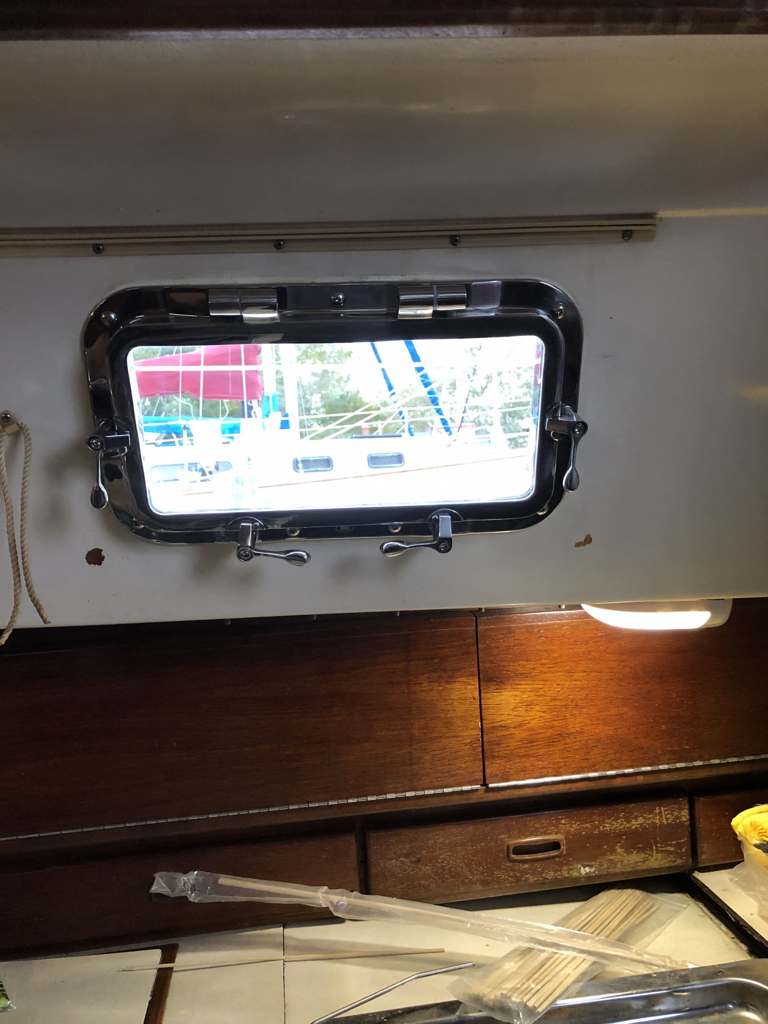

We used NFM a handful of years ago as replacements for all the port lights. They function and last much better then the original, and really transform the look of the boat. Quick to open and close/secure. They do take some adjustments to get them "right". However we are in the process of re-bedding them because the yard that installed them (I was deployed at the time so had a yard take care of it while the boat was on the hard and getting some deck rot repaired) didn't use butyl tape and they pretty much all leaked. They tried to make it right but never really fixed it. They are heavy and need a solid/good core to mount properly - I think the problem was much of the core is bad in the port openings and these can't seat very well. I re-bedded one with butyl tape and it doesn't leak Iuckily it was one of the few ports that had sound core though). So I need to take the time and re-do the rest and build up the core. I plan to use closed cell foam pieces soaked in polyester resin as a new core material. My father used wood but said it was a painful process of shaping it to fit, plus it may rot again....so it'll take a lot fo work time to do it - but I recommend them.
