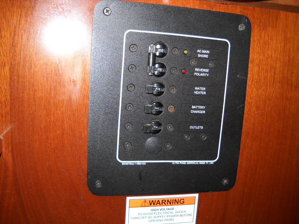

On my 2002 361, the main AC elec panel was mounted below the chart table. I am sure it was more than 10 ft from the shore power receptacle. But I installed an ELCI breaker and galvanic isolator in the port lazarette close by the two shore power receptacles a year after I bought the boat.

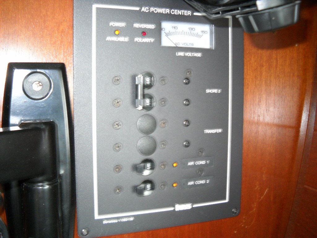

There was also a separate breaker panel for the air conditioning, forward of the chart table on the port side in the recess area:
