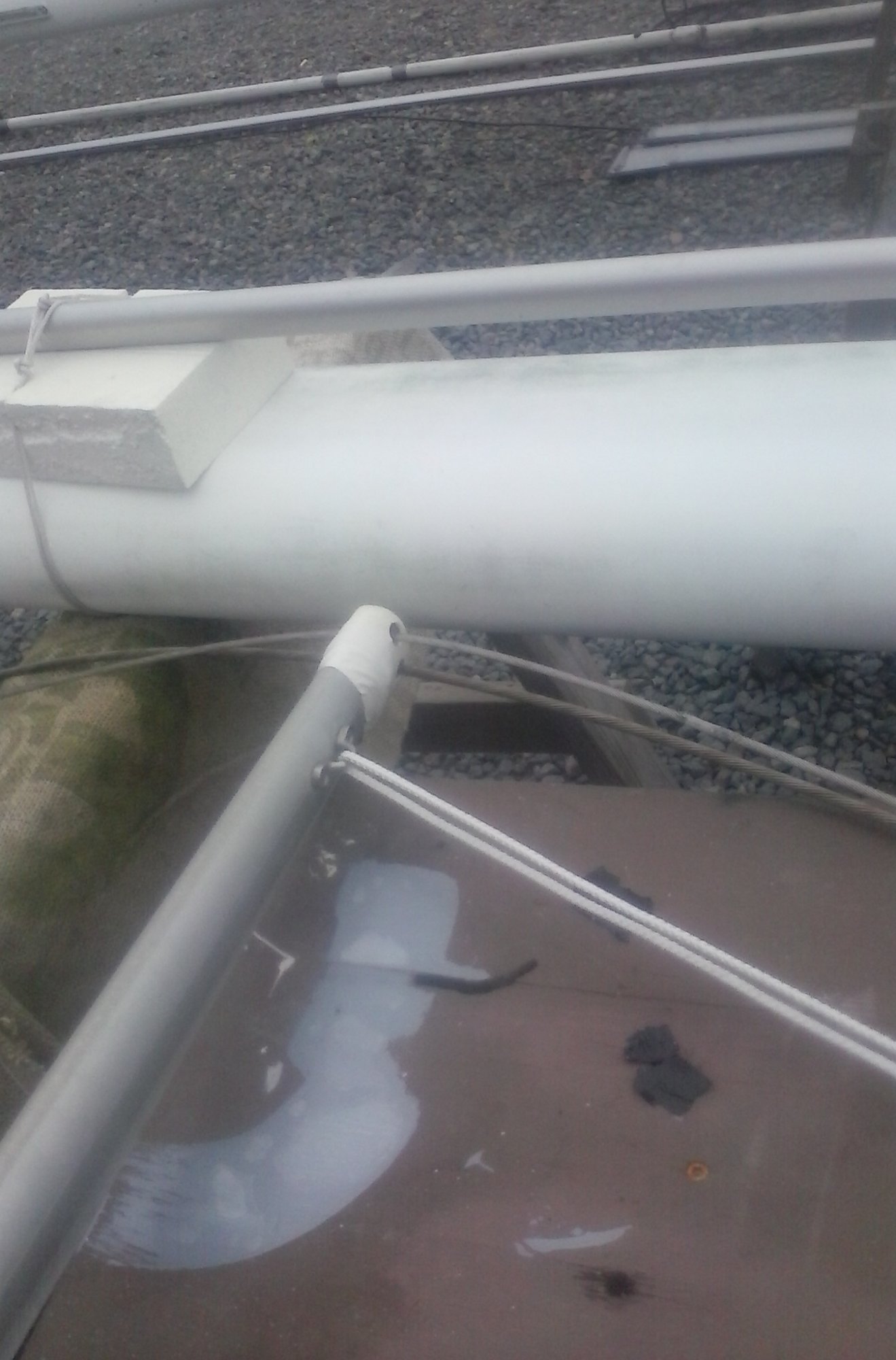

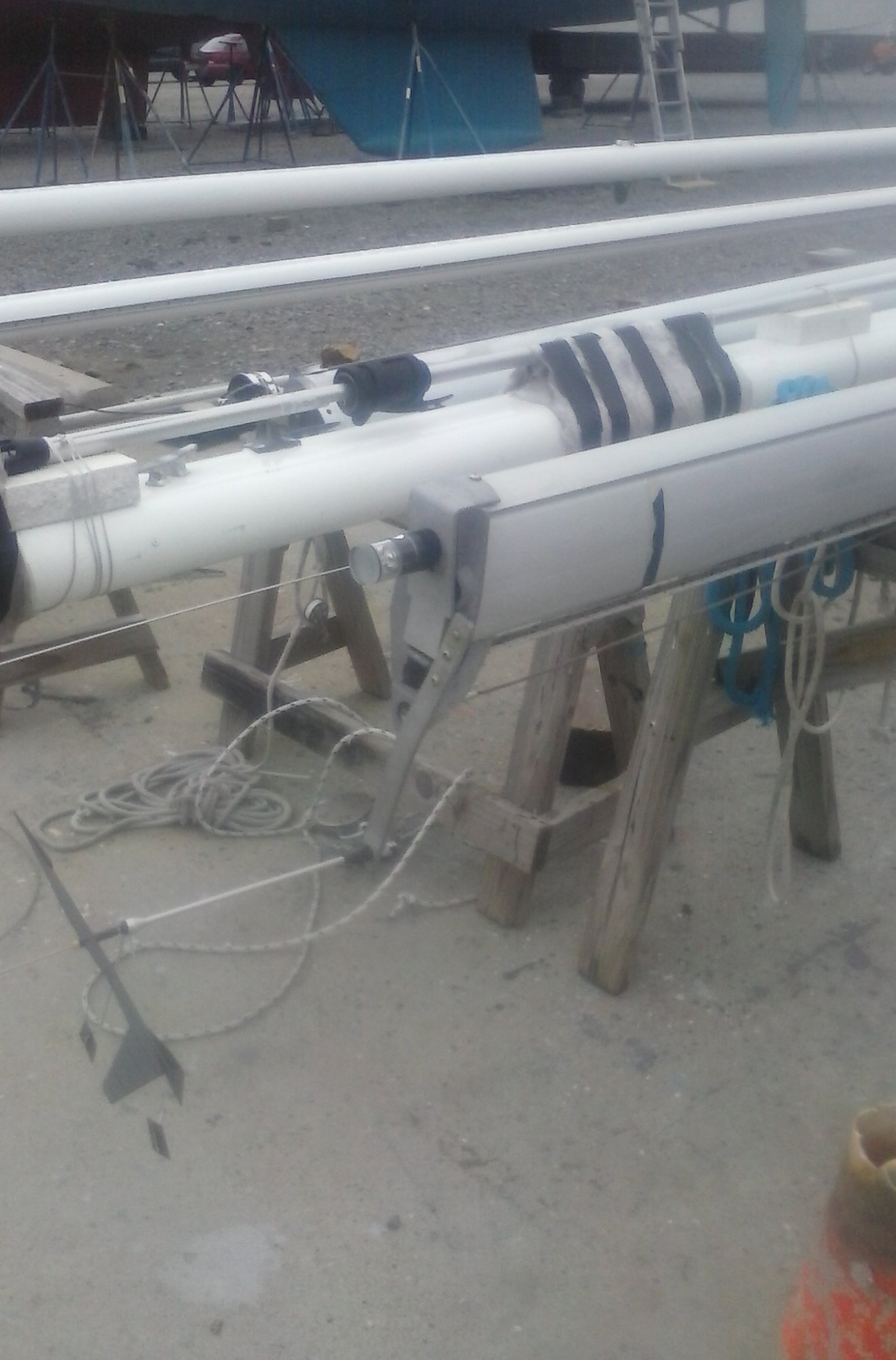

I pulled the mast $300 Had a rigger inspection and replaced 3 stays Headstay 10 year old 2 upper sides of unknown age and replaced all led lighting and new vhf antenna for maybe $1500 with mast back up. O and replaced all shives too. Also. My brother laughed when I text him a picture with "I waxed my mast" . But did that too
