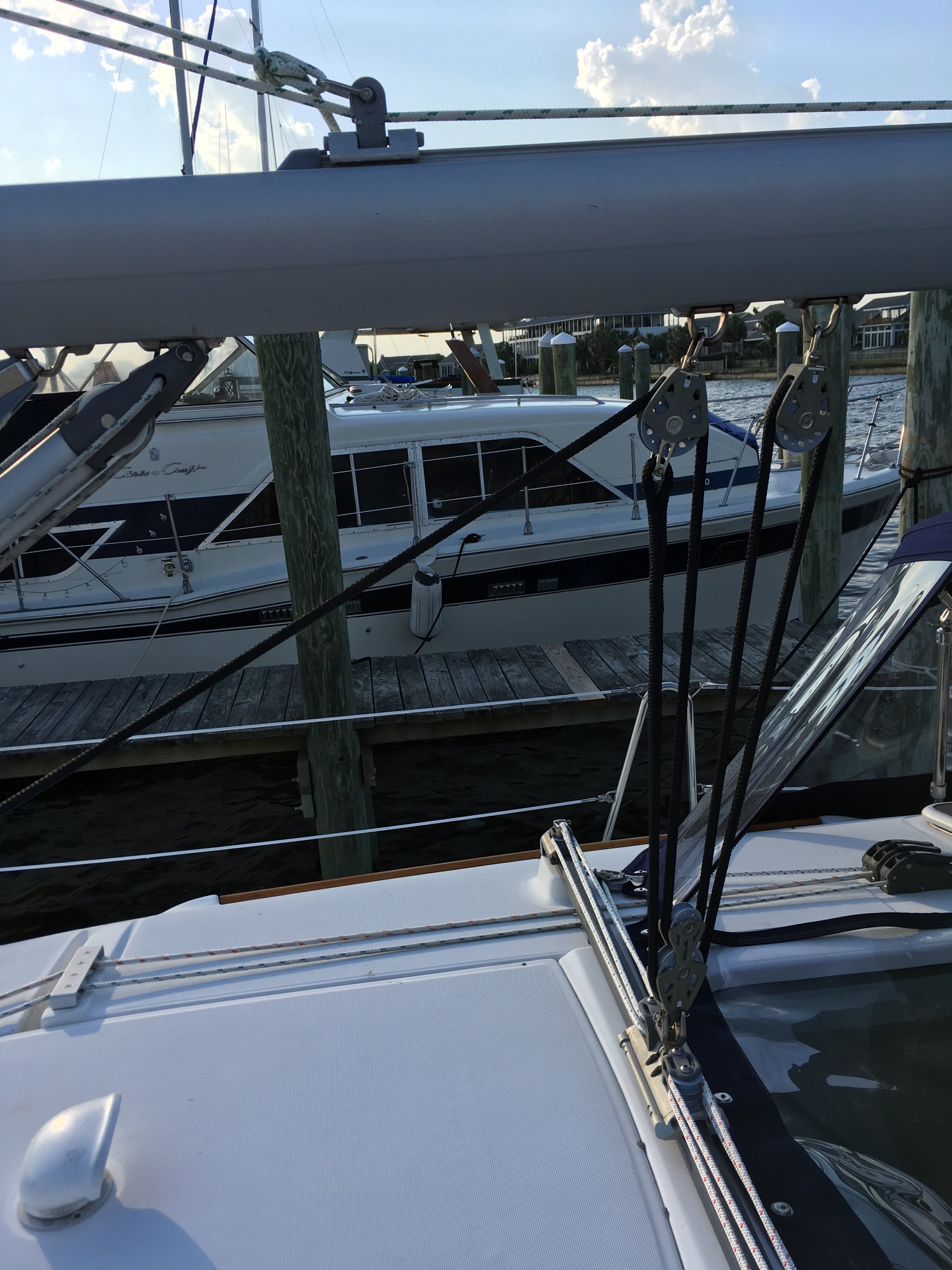

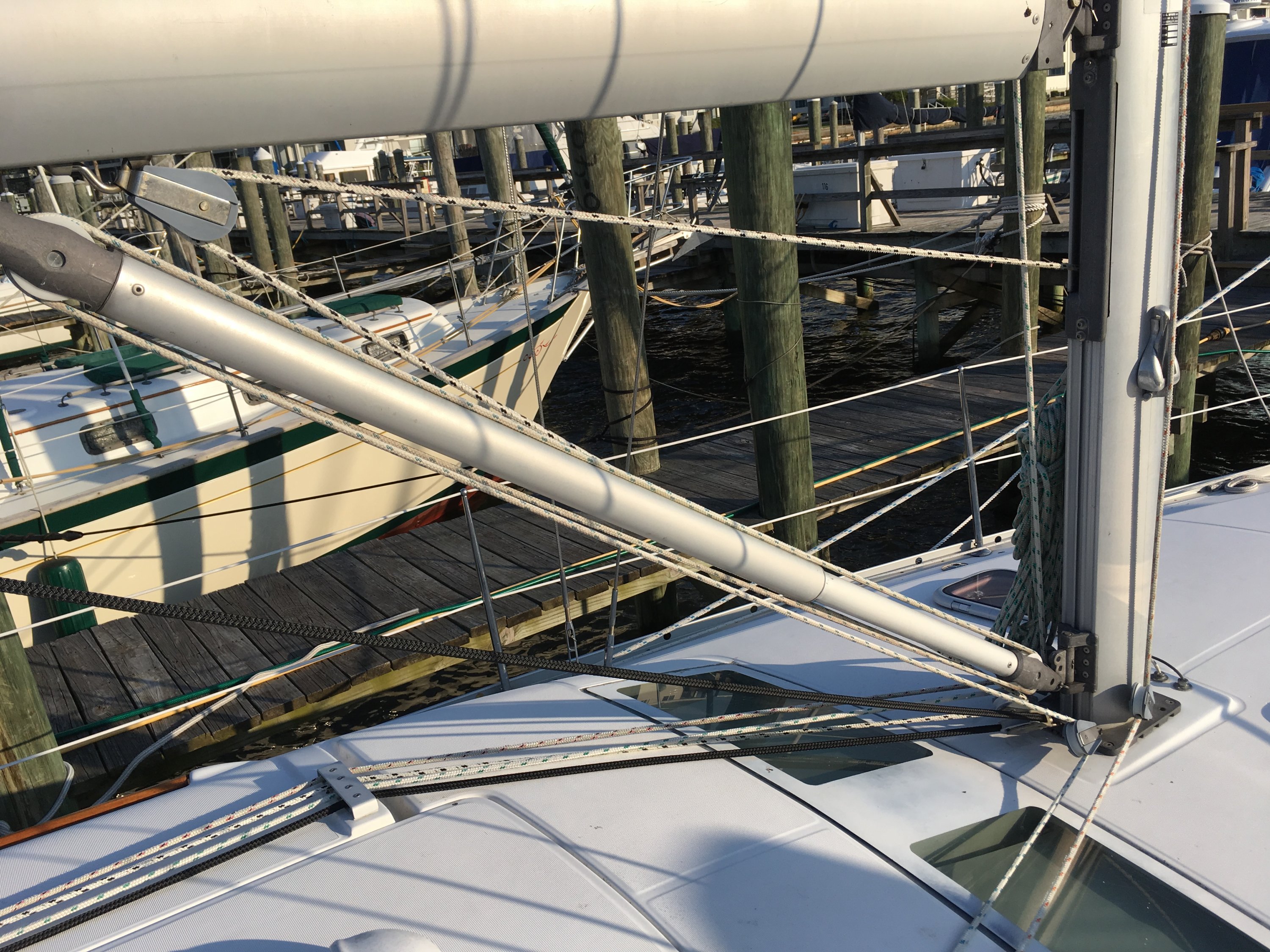

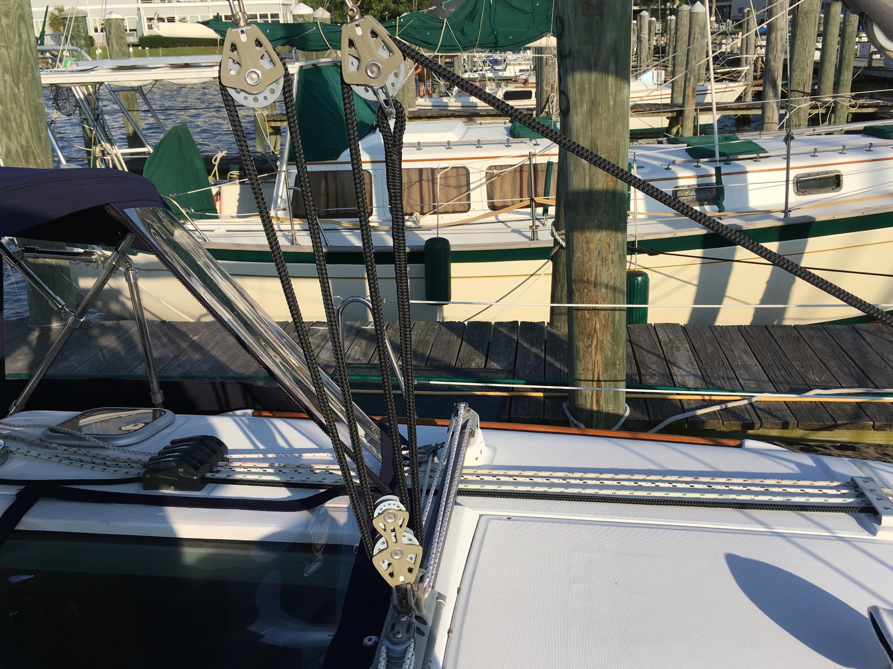

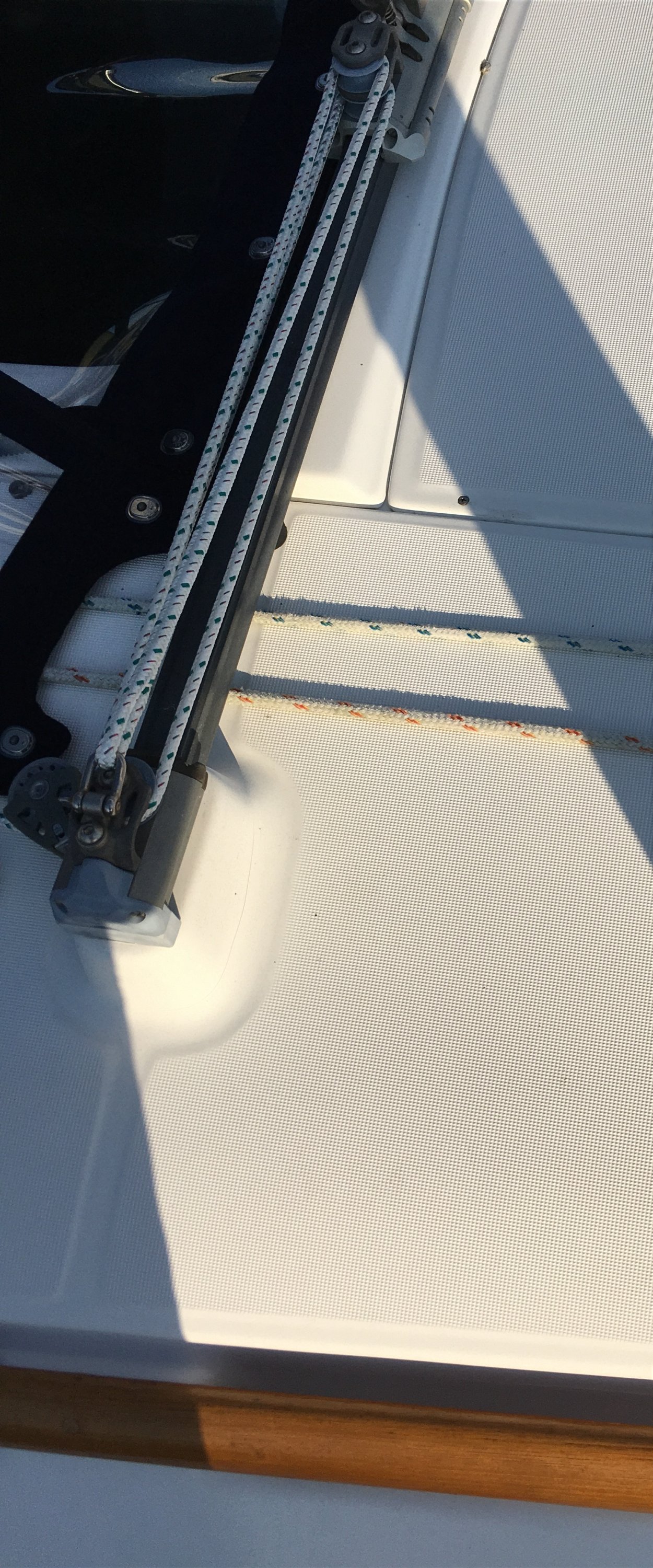

Jun 21, 2004
3,214
Beneteau 343 Slidell, LA
OK, Here are some pics of the traveler, mainsheet, and vang on my 343. Hope this helps.
