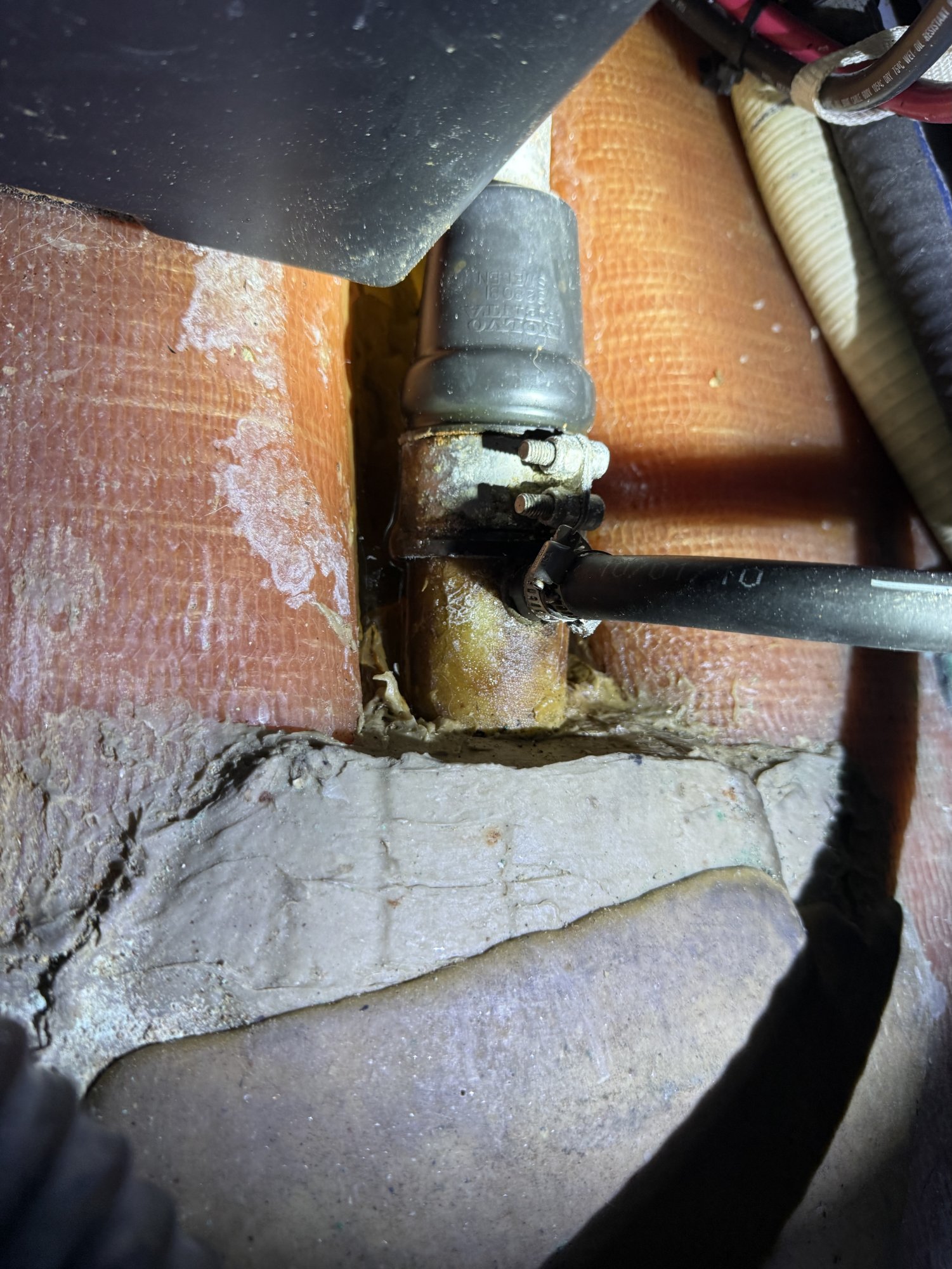

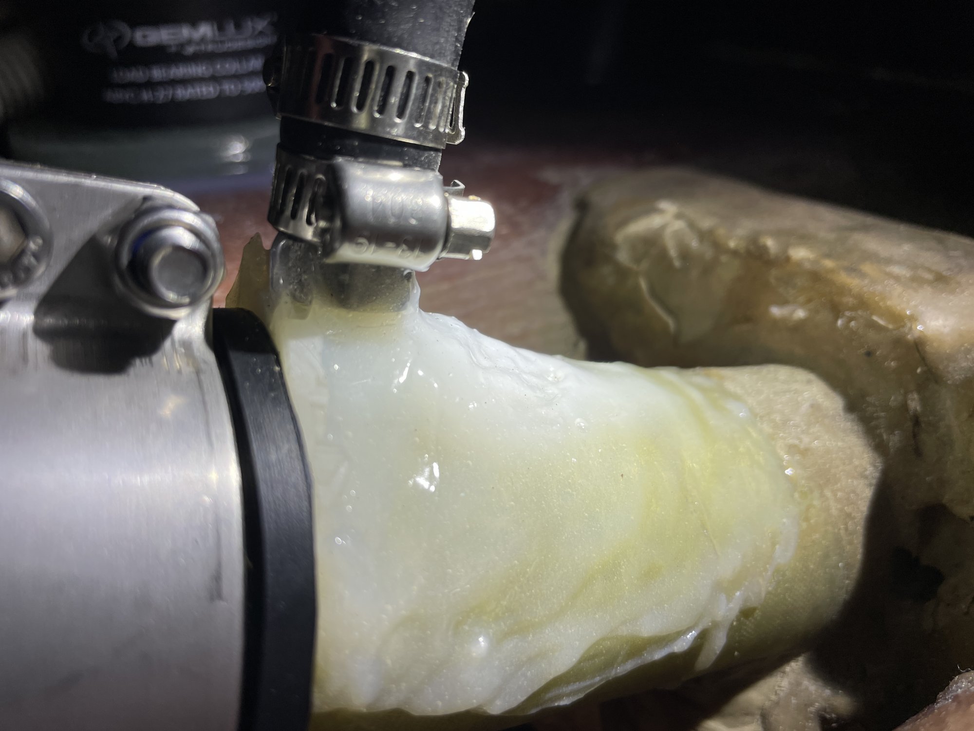

Sorry to bring up an old thread here.. can anyone with a Beneteau 323 tell me if this stern tube area looks factory or of this is some kind of repair? It just looks odd to me..

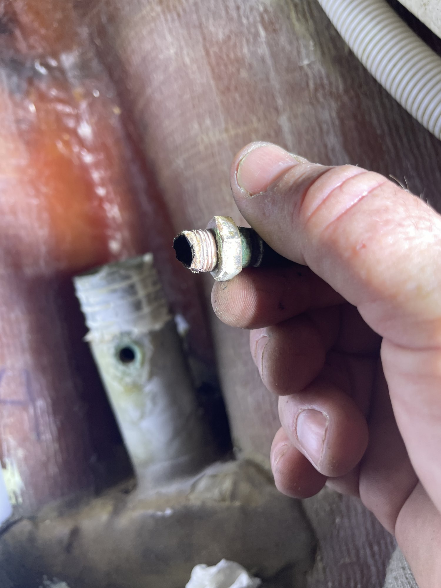

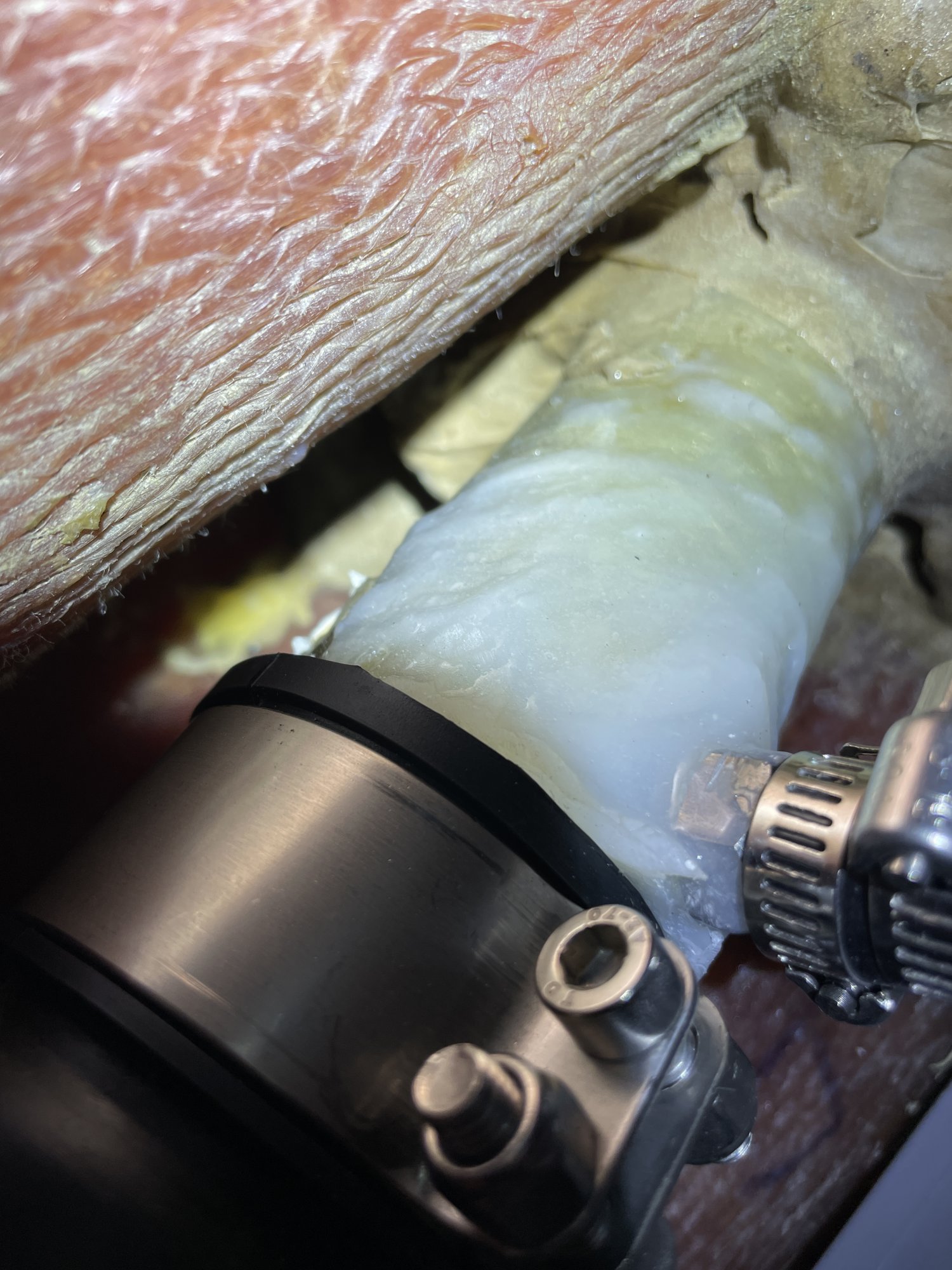

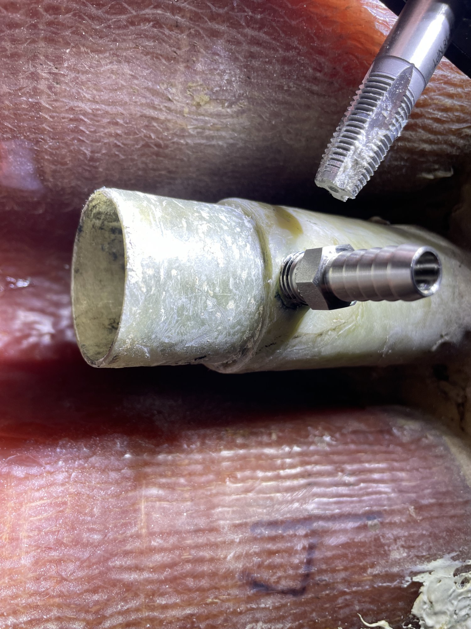

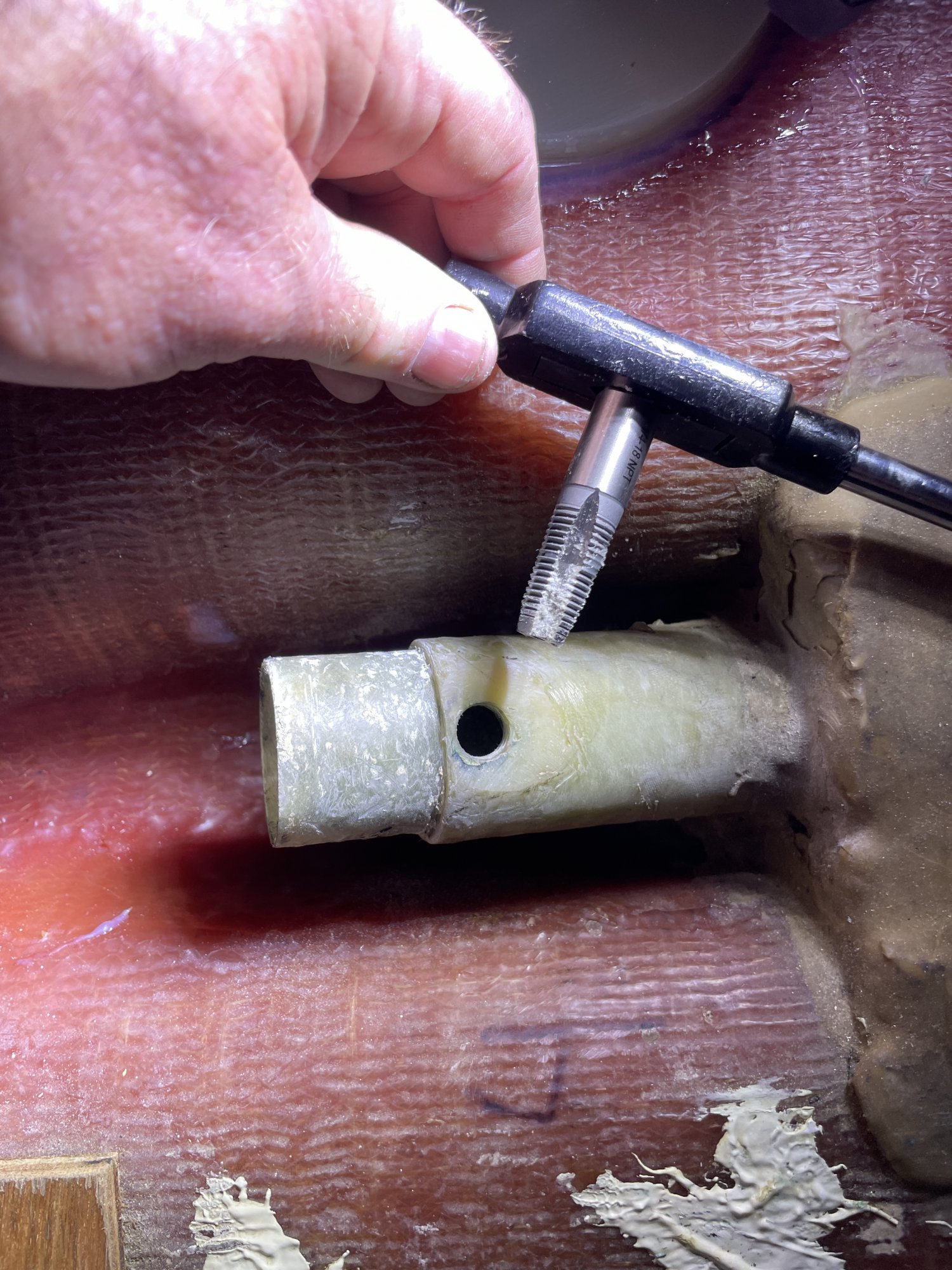

Looks factory. See pics below of the old fitting and upgrade I made when hauling out earlier in the year... I retapped the hole to a larger size (3/8" IIRC), used a 316 stainless (not brass) fitting, and built up the area surrounding the fitting with thickened epoxy.
