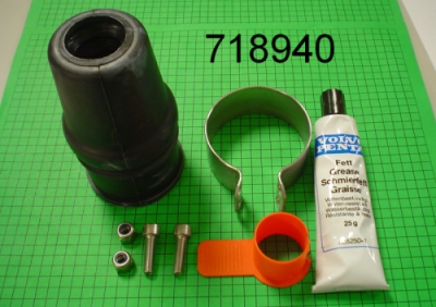

This is the Volvo seal. Right end with the two sealing rings is where you grease. Also, you need to burp the seal after launch to remove air trapped.

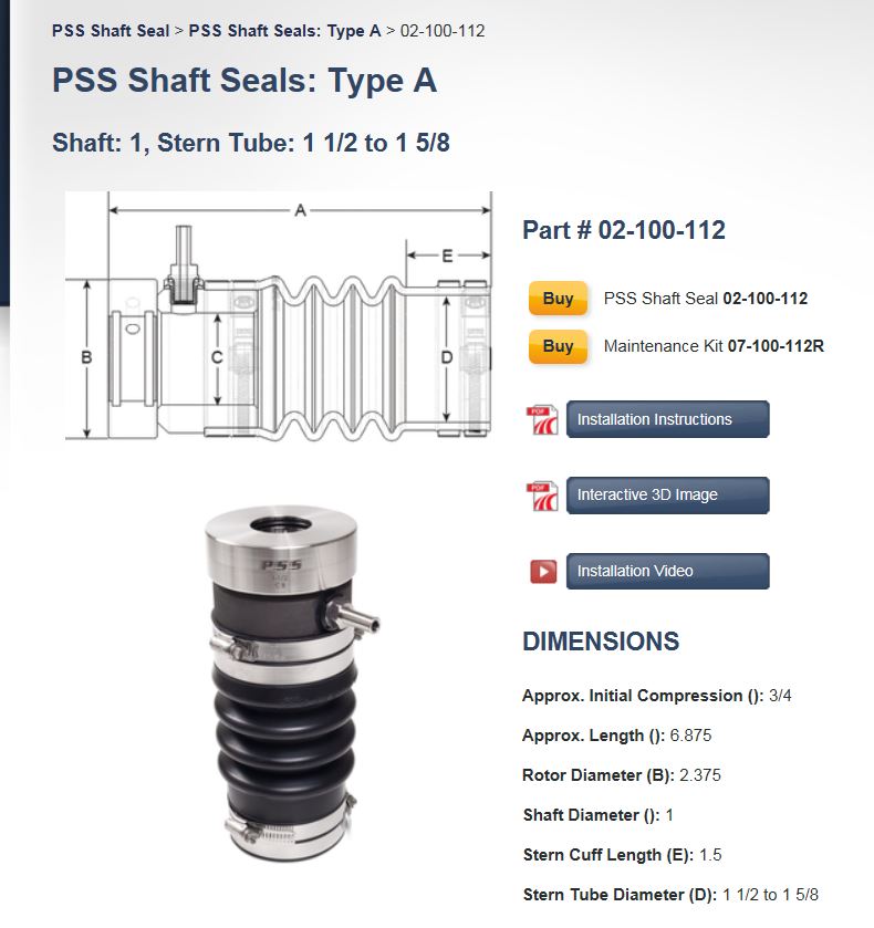

Stuffing Box.JPG Capture.JPG Stuffing Box.JPG Thanks Bob and Doug (are you the McKinzie brothers?) :). I had a quote to replace the current seal with the PYI PSS Seal thus the lead down the rabbit hole. Here is a picture of the PSS seal and the one I have. It cetainly appears to be different than the Volvo one. We just bought the boat in June of last year so I do not know the maintenance history.

My pic is the same seal as your pic - just a cross section. Sorry I didn't clarify that.
You can buy Volvo grease and the best way to grease is with a straw filled grease under the lip of the seal. Details are on this site.

Thank you to everyone.. I spoke with the folks at PYI (and also read the installation instructions) and it appears the small "zert" looking appendage is a vent only to be plumbed in boats that exceed 12 knots under power. However, Kenneth at PYI suggested plumbing it anyway due to the rare occasion when the cutlass bearing prevents water from reaching the PSS seal face. This is accomplished by a "tee" fitting off the stern tube water intake. On another note, I looked for a new Volvo seal and couldn't find one online (West Marine, Fawcetts, etc...). Thanks again!

Hey Doug. I bought the PSS Dripless shaft seal which has a "shaft collar"...pretty exacting at this piece thus the 0.015" concern. I agree had it been the "volvo" seal likely not an issue.

You are not to use the grease with the PSS. Make sure you read ALL INSTRUCTIONS. Water is the lube for the PSS.
