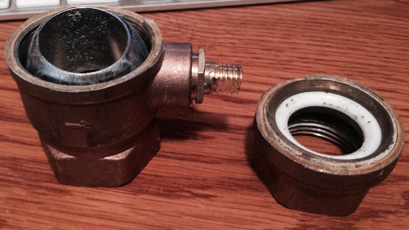

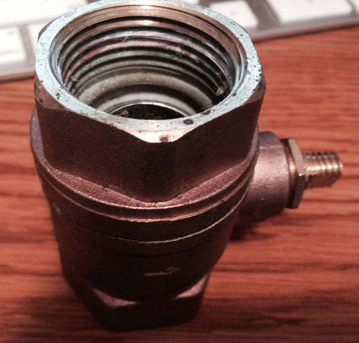

I replaced the ball cocks on a couple of the intakes two years ago. This year, while opening one, I noticed a bit of wet. Closing the valve again, the top part of the assembly came off in my hand.
There was a hairline fracture in the assembly that allowed a tiny bit of water to come through. What isn't stated here is that if the assembly had been installed such that the flange was on the bottom, ie; the ball assembly was contained in the top portion of the body, there would have instantly been nothing stopping the ingress of water.
Subsequent inspection revealed that it was indeed a manufacturing defect, the crack was 2/3 the way around the part, and there was no way whatsoever to have seen it prior.
Please pay attention to any water coming in, it could be a harbinger, and the one thing that is apparent, the stuff isn't made the way it was 20 years ago!

They should be Marelon, should be available down your way. They should NOT be like the ones in meriachee's photos, which appear to be bronze, and while even on a Catalina, bronze was definitely NOT a Catalina OEM part. :)

...snip.. They should NOT be like the ones in meriachee's photos, which appear to be bronze, and while even on a Catalina, bronze was definitely NOT a Catalina OEM part. :)
These were definitely not oem
