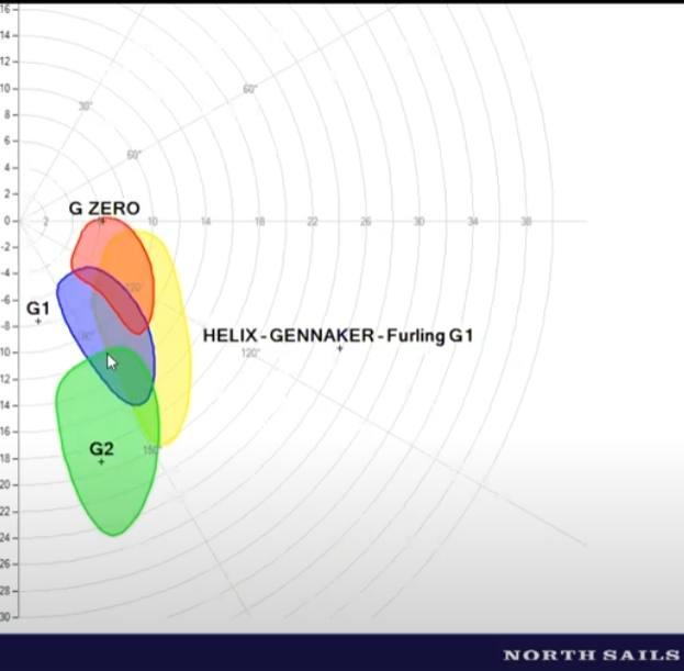

I ended up choosing the "Easy Furling Gennaker" from North Sails with a top-down furler and the lines run back to the cockpit.
I met Jack Orr, of North Sails, at the Newport Boat Show. He gave a presentation on the different furling systems. He gave me quotes for their Code 0 with UV panel (called the G0), the "Helix Furling" Gennaker with UV panel , a G2 with a sock, and the "easy furling" Gennaker (EFG). These are significantly different size sails with corresponding different cloth weights.
I felt the EFG would give me the best downwind performance, without having to go to a G2 with a sock or Spinnaker.
For my 315 the EFG is about 54.6 m^2 (~600 sqft) of lightweight 0.75oz nylon. That's more than 2x my 135% Genoa.
I didn't want to go with the smaller size and heavier weight construction of the G0 (2.0 oz) and Helix (1.2 oz) and risk them not being as effective in really light air.
I really struggles with the choice between the Helix Furling and EFG. I just felt the whole point was very light air, and the lighter weight EFG should be less likely to deflate in bouncy waters. Jack did say the EFG will fly deeper downwind than the Helix, and this was also mentioned in one of their YouTube videos on sails, at around 48:30

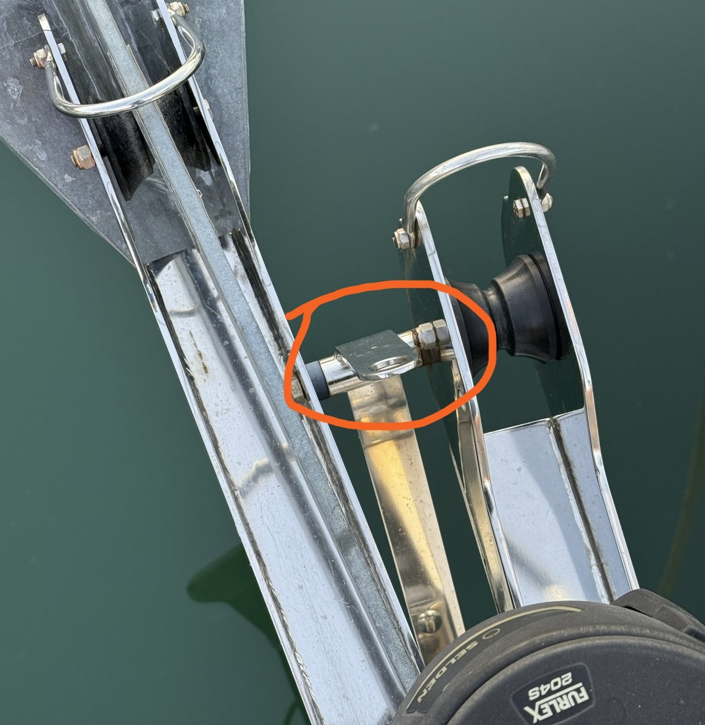

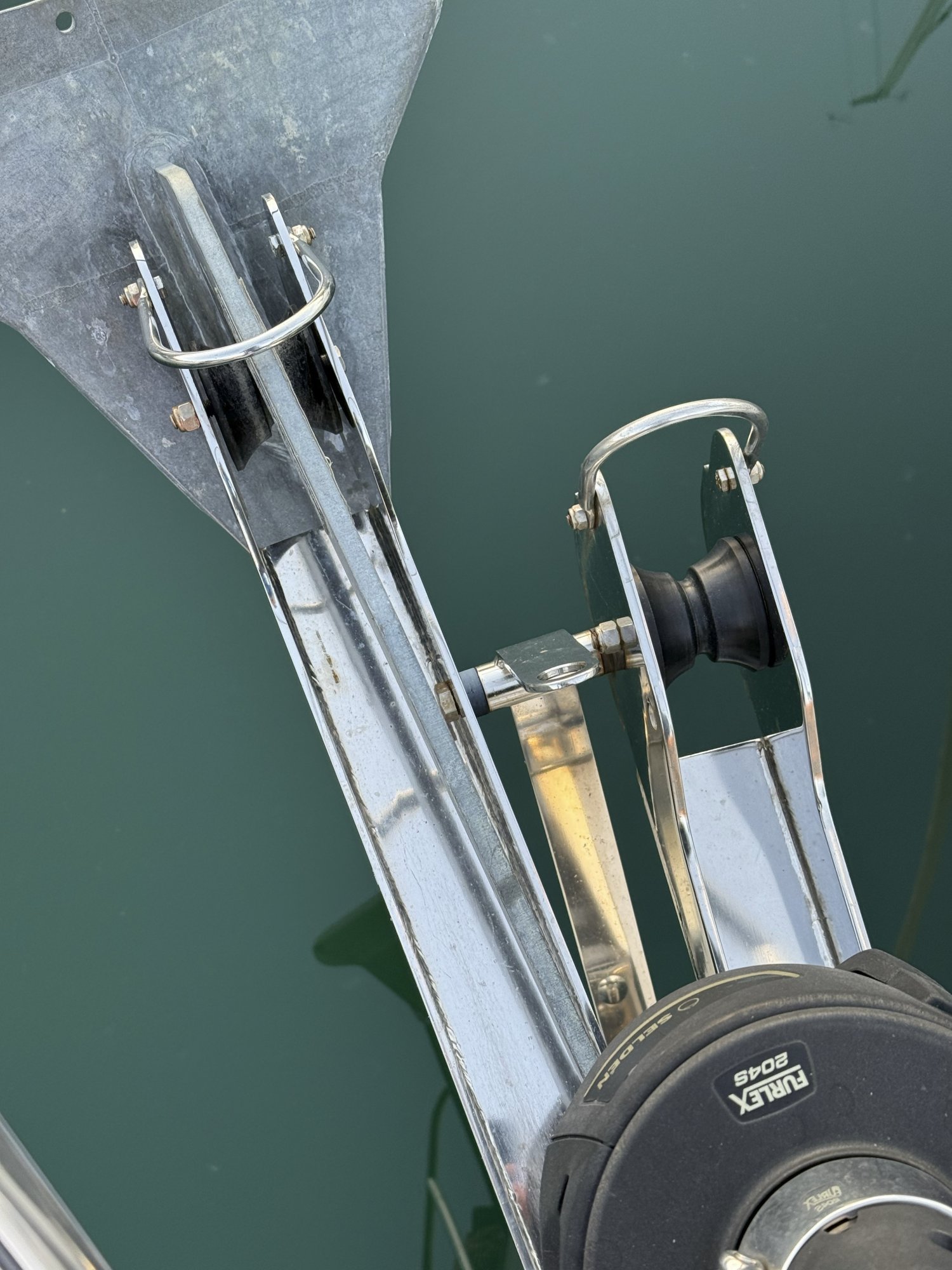

Thanks for the info I appreciate it . One more question how is it attached to the bow is it on the existing d ring l attached a photo of my anchor bow spirit or did you install a Bow spirit pole?
VFR750
Oct 18, 2021
61
Catalina 315 Noank
The furler attaches to this strap. It is the load path in the bow sprit
The tricky part is the furler, spinnaker halyard attachment and the sail itself must be in front of the pulpit railing.
It's a bit of a stretch to reach that hole in the sprit through the gap between the headsail and the pulpit stanchions.
I added a big snap shackle onto the furler, and use that to attach to the strap. It makes it easier to lock it in place and remove when my arms are extended through that gap.
