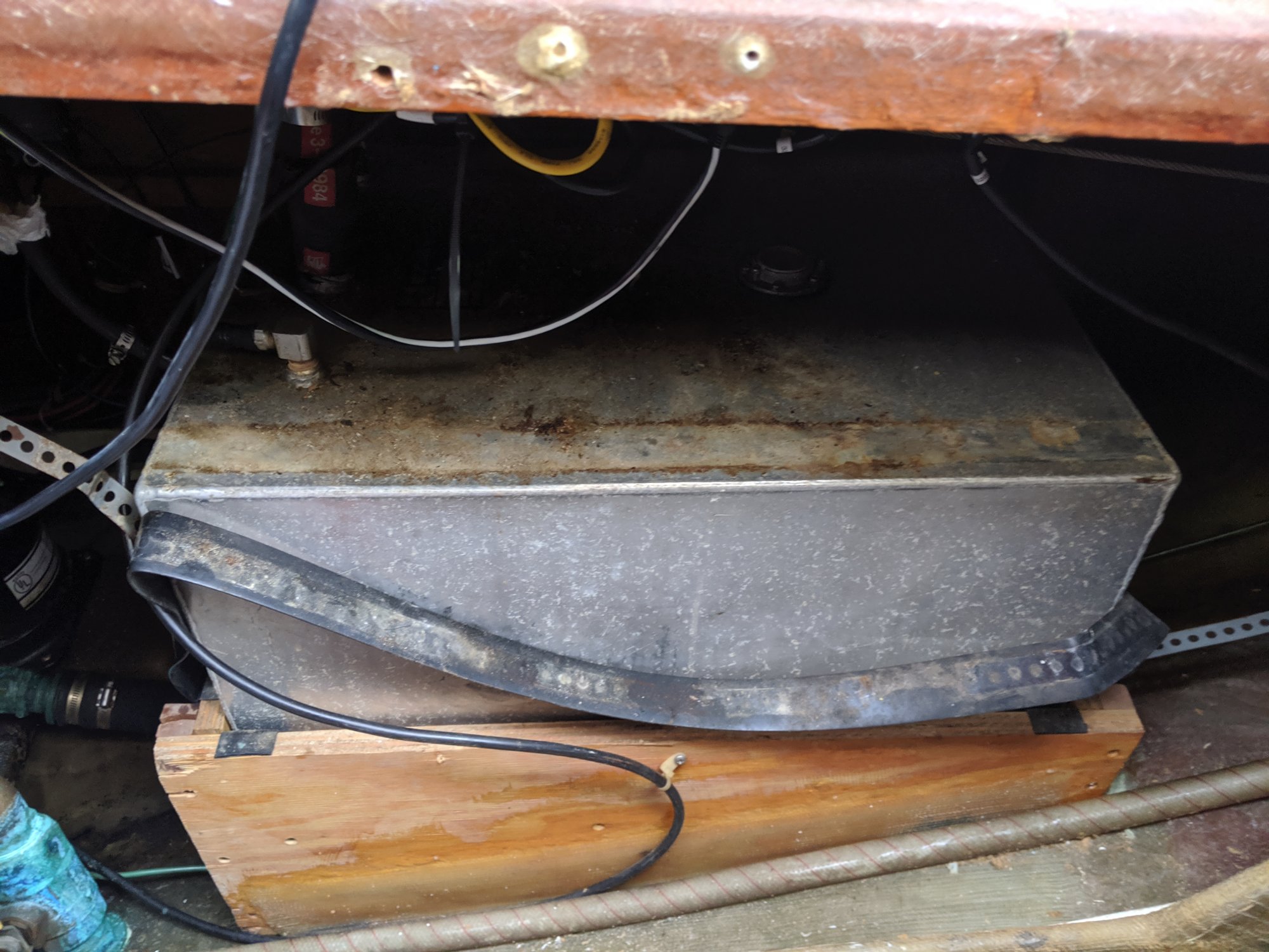

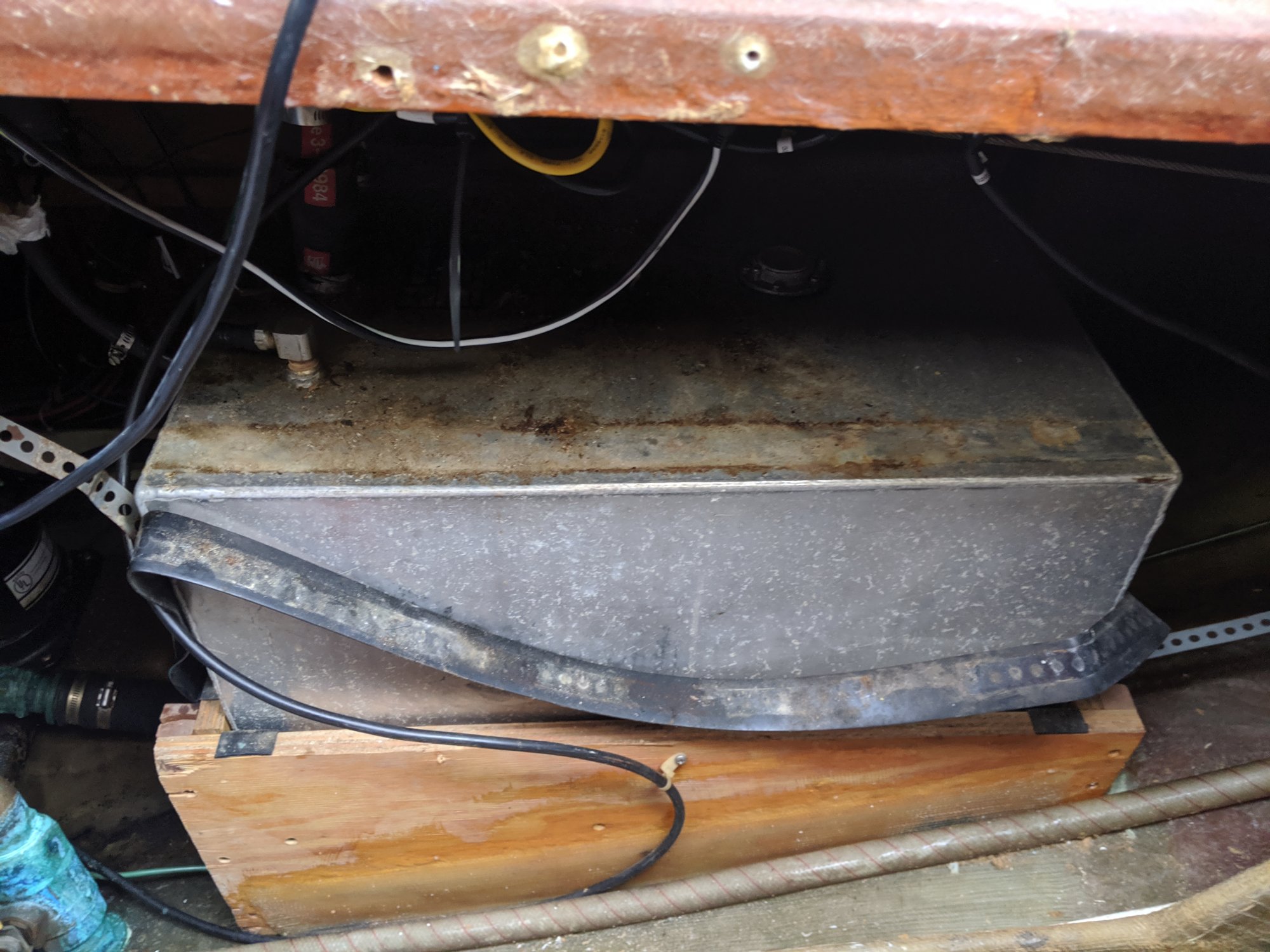

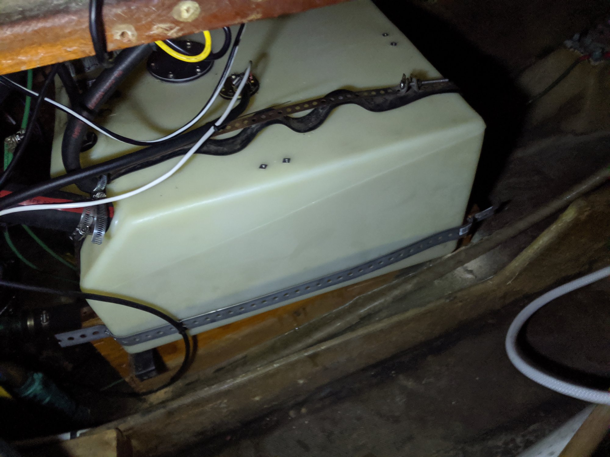

For anyone coming back to this thread, I put in (with minor modifications) this Moeller tank 032623 which add 1-2 gallon of capacity. It's 24x20x14 according to its spec sheet which was 1 inch too wide so I had to remove one side of the wooden cradle but besides that it was a perfect snug fit.
Old tank came out without any hickups or issues, new one was easy to place and fix after I used an oscillating saw to cut some of the cradle out to allow for the extra width.
Moeller has a fuel sender with return line which was an easy drop in. All in all the process took me about a day, but a good chunk of that was running to west marine for parts and borrowing tools around the marina.
Ran all new lines to/from tank, but old original lines would've fit, not a bad project at all.
Old:
New:
