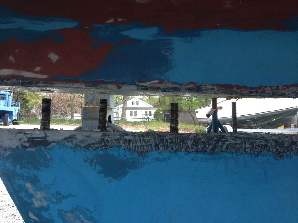

I dropped my keel on Friday afternoon and it seemed pretty straight forward. In talking with Rudy (formally with Oday), he said that the keels were originally sealed with 5283, which was a version of 5200 that was never marketed to the public. I didn't find that to be the case. My keel had a polysulfide-like product sealing it as you can see from this video when we actually dropped it which leads me to believe that somewhere in the past this keel was dropped before. The actual drop was a lot easier than I had anticipated.
http://vid1295.photobucket.com/albums/b623/ice5c4tl/Oday%20302%20Refit/IMG_8595_zpscng1war5.mp4
Just after I dropped it:
I didn't take any close up pictures of the bolts, but they are not corroded. This is before I cleaned them up:
I will take some closer up photos later which show them after all the gunk is off of them. But, my worries that the bolts were corroded were unfounded. What I did find as we prepared the keel to come off was that the bolts were no where near tightened to the specified torque. Not even close.

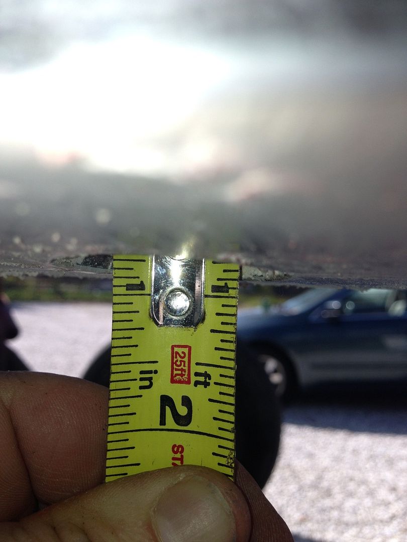

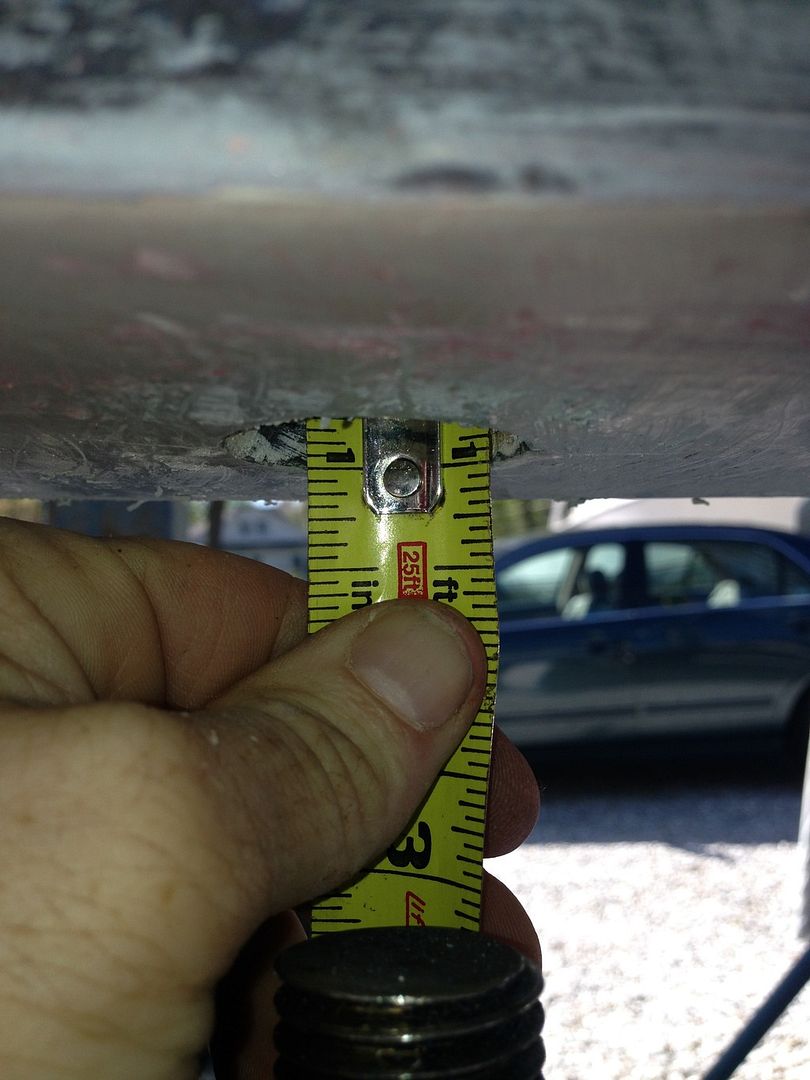

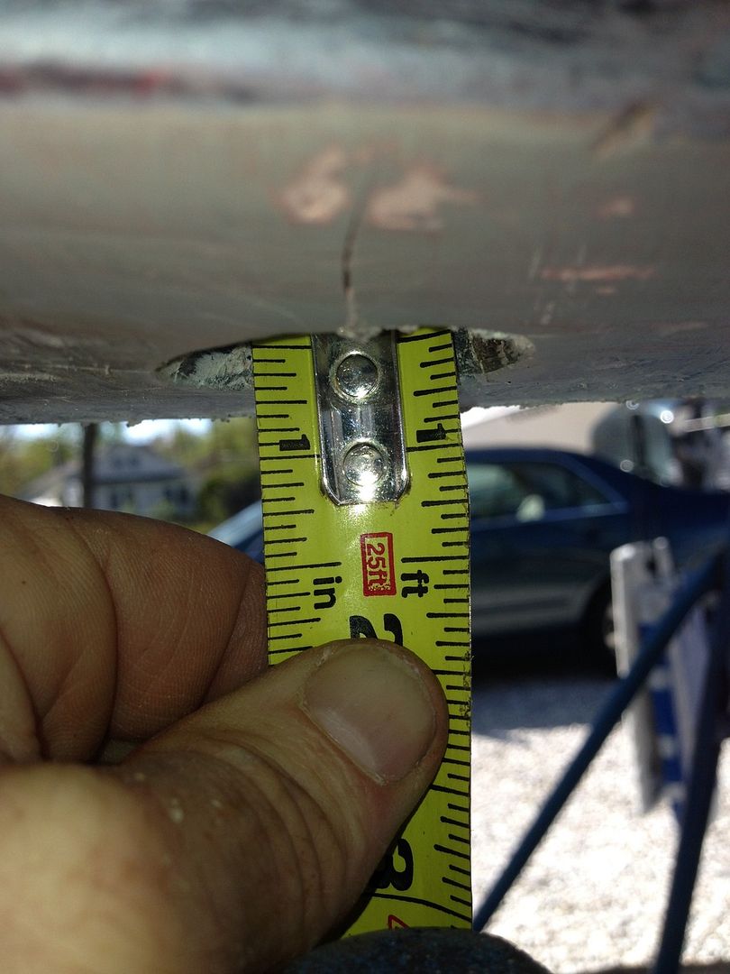

As promised, I have taken some pictures of the thickness of the keel stub and have them here to show you. As a disclaimer, you can add at least 1/8 inch to each of these measurements as there was that much play in the metal tab of my tape measure and where the measuring tape has actually starts:
EDIT: The measurements are between 3/4-7/8 inches (closer to 7/8) for all three holes. I didn't realize I had a washer on the forward bolt when I took the photo. I will update photos soon....the ones I took to update it were not of decent quality.
Here is the forward large bolt hole:
Here is the middle bolt hole:
Here is the aft large bolt hole:
My tape measure was too large to fit in the aft small bolt hole, so I don't have that measurement.

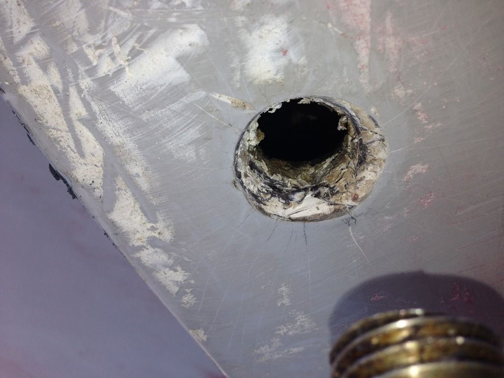

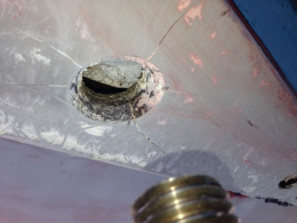

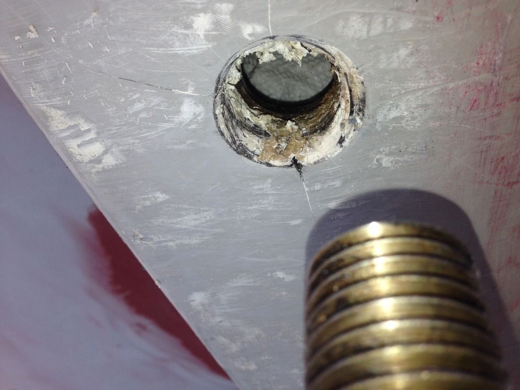

What I did find that I don't like after I cleaned some of the sealant off was that there are cracks emanating from the actual holes, some deeper than others.
Forward bolt hole:
Middle bolt hole:
Aft bolt hole:
The aft bolt hole seems to be the worst. Not sure how I am going to fix this just yet. It would be nice if I could just fill it with epoxy, but I know it needs to hold 280 psi so it needs to be strong. I wouldn't mind advice on how to fix this.

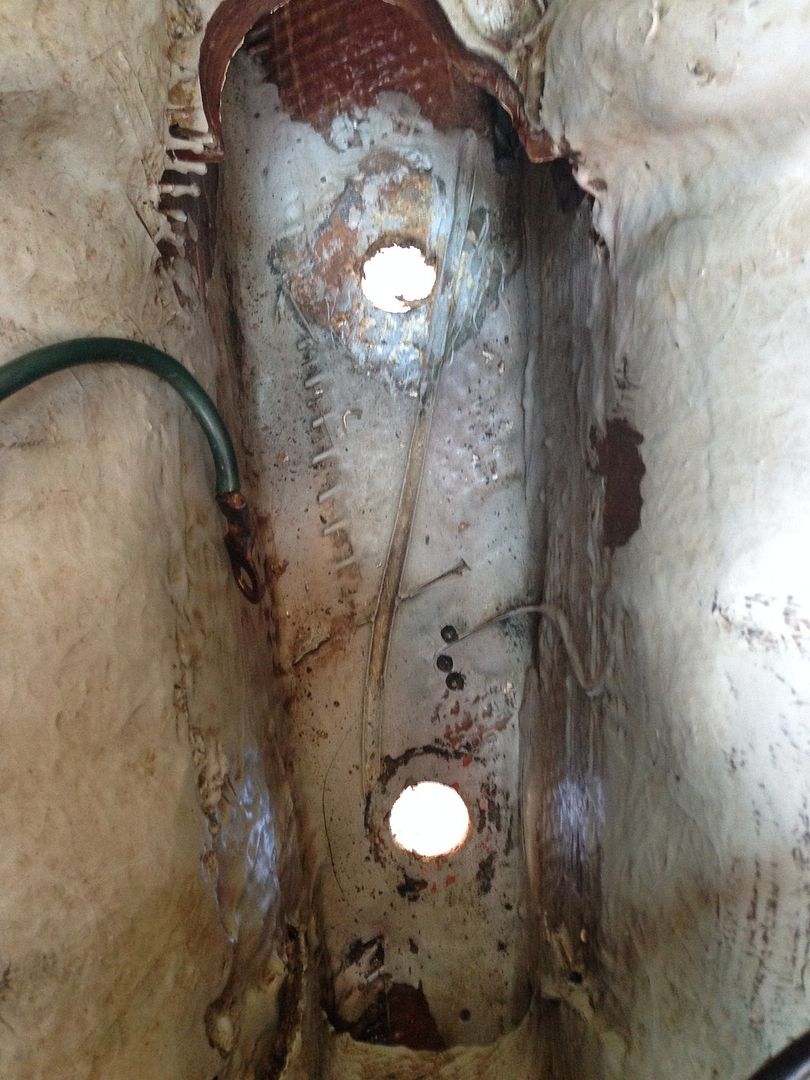

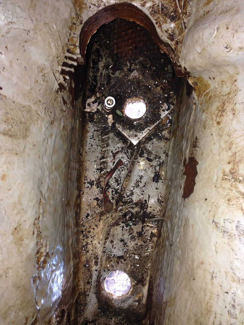

I also noticed that the bolt forward and aft bolt holes seem to be drilled oversize. I neglected to measure this, but will do so this afternoon when I return to the boat. I know it is still filthy, but you can see without a tape measure the difference:
Each of the bolts had just a washer instead of a backing plate with the exception of the middle bolt, which you can see here has a 4" x 4" (ish- didn't measure) backing plate with a connection point for the bonding wire. I had planned on building a backing plate from 3/8 stainless that covered all three bolts, which was a suggestion that Rudy gave. However, the one plate shown here seems to be glassed to the bilge and I am not sure how to get it out without destroying some glass. I guess I could always just make two more backing plates instead of one for all three bolts.

Great info thank you much. I'd use an oscillating tool to get the backing plate out. Then for each hole make a backing plate and put mold release on it. Then put some epoxy thickened with glass fibers where each backing plate is going. Use a bolt to clamp down the backing plate while it cures. Now you'll have a flat surface in the bilge to spread the load. Now look into some spherical washers to put under the nuts to allow for misalignment of the keel bolts if you can get them in stainless. As far as the fracturing is it just the gel coat or in the laminate? If the bolts are long enough add some laminate in the bilge but ask an expert about the fracturing, they might recommend grinding it out and new laminate.

Thanks for the update. This is now a question of some boats being built with thick stubs and some leaving the factory with paper thin stubs. Scary stuff if you don't know which one you have a Monday or a Friday boat.....
This image is also cause for concern as some of those cracks seem to go all the way through. I would get a fiberglass structural guy in to see what they say. I would not be putting the keel back on until those cracks are know to be safe.

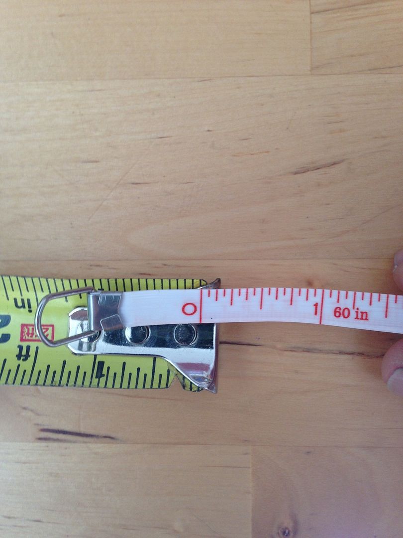

Your tape measure is SUPPOSED to have that "play", I originally thought mine was loose, then found out that the tab is meant to move. This allows both inside and outside measurements to be taken (slide tab towards rest of tape means that dimension starts at outer edge of tab, slide out away from rest of tape to get acurate measurement with tab hooked over end of what you are measuring)
In other words, that "hook" on the end of the yellow tape measure should move enough that the outside edge when slid towards tape should line up with where hte inner edge of that tab would be if slid away from tape.

Thanks for the update and extensive pictures and video of the process, while I've read quite a bit about it, it's good to see the information.
At first the cracks looked like (or I wanted them to be) surface, but it does look like at least one of the cracks is several layers into the laminate, which is unsettling. Particularly, the one that Mainsail points out. Perhaps by now you've had a chance to clean up the holes and resolved that the cracks are not that significant.
