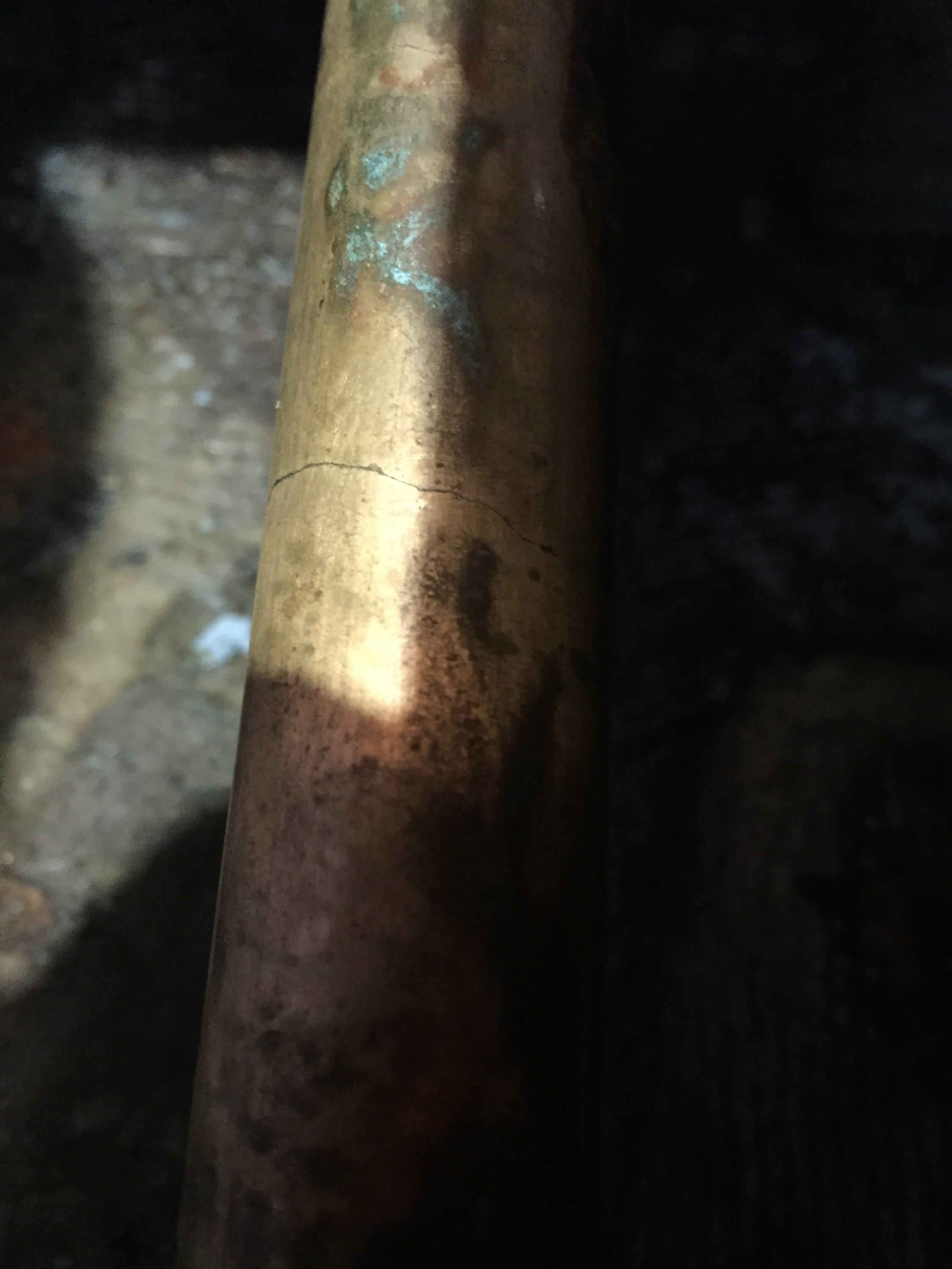

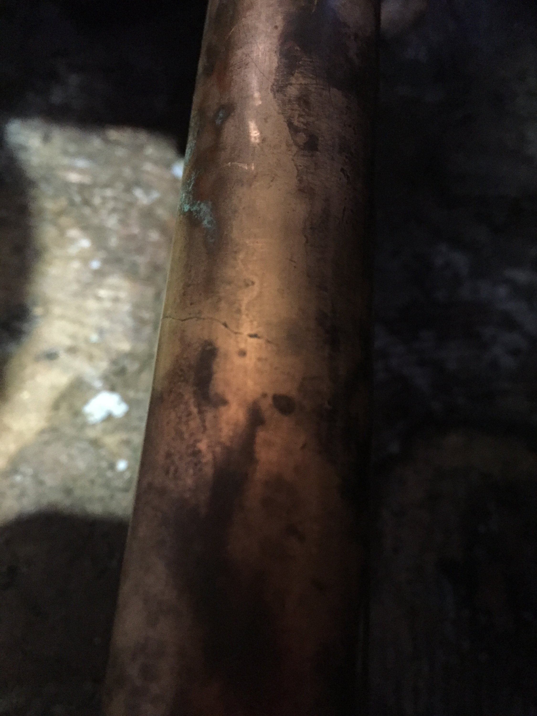

I don't know, but am very interested in the answer. While inspecting the shaft on my O'Day 322, I noticed this crack, that does not look good. If I did more than day sail, I would have pulled the shaft already. But looking at options to reshaft and how to get the shaft out without cutting it.
The photos look pretty scary, but I can't really tell that is some sort of scratch (doesn't really look like it) or a serious fracture. I am going to try to remove the coupling using my strut bearing removal setup, and see if I can get the shaft past the rudder. It will be a while before I try this though.(it is getting damned cold in the Chicago area).

Looks like crack. Looks like you used some abrasive and its still there. If it doesn't polish out you mostly likely have a crack that will only get worse. In a former life I spent a lot of time around machine shops and associated QC. What is the price of a new shaft? I assume it is some sort of Nickel/Copper based alloy like Monel. Very pricey. The right machine shop can us a dye penetrant and black light to see how big the crack is. You could check and see if it can be ground out, welded and reground and straighten. Depends on the material. All that may cost more than a new shaft.

I agree. And yes, I tried to rub it with some emery cloth to clean the shaft and see if it was indeed a crack. Not sure if something like that can be inspected with a dye penetrent or not.
I think the best course of action will be to pull the shaft and send it to a marine shop for inspection and possible replacement (which is why I would like to take it out intact).

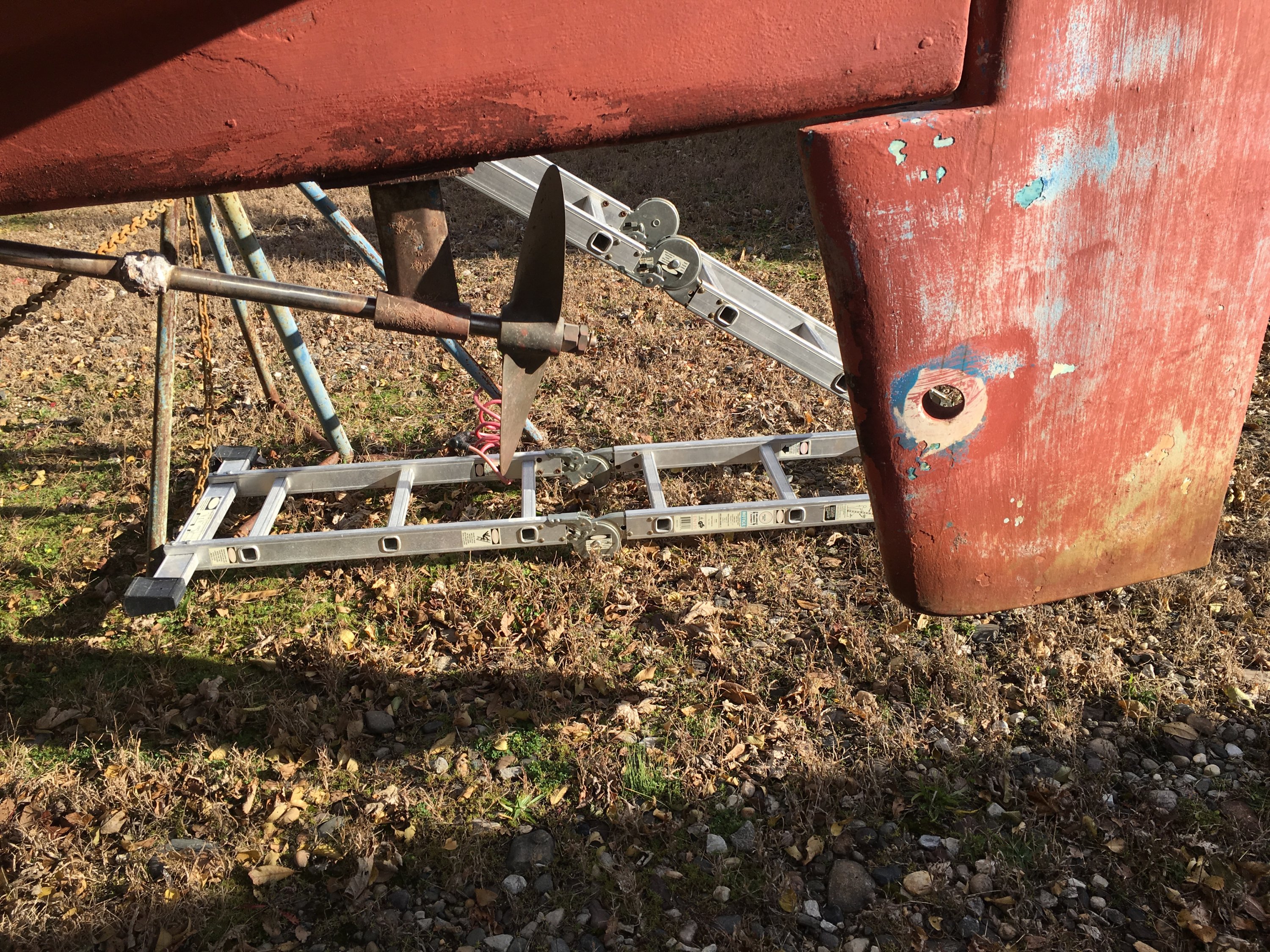

For an amusing, yet functional solution to the problem, see the attached picture. Most folks would fill the hole in again when they are done, this owner has not done so yet, perhaps he plans to leave it for the next time.

An "A" for creativity!
I guess if I had to pull my rudder, I would be tempted

I like to tinker and come up with fixes but I would not have thought of that.
10,246
Very creative, but I guess you'd just cross ya fingers and hope that ya don't hit the stainless metal frame parts..

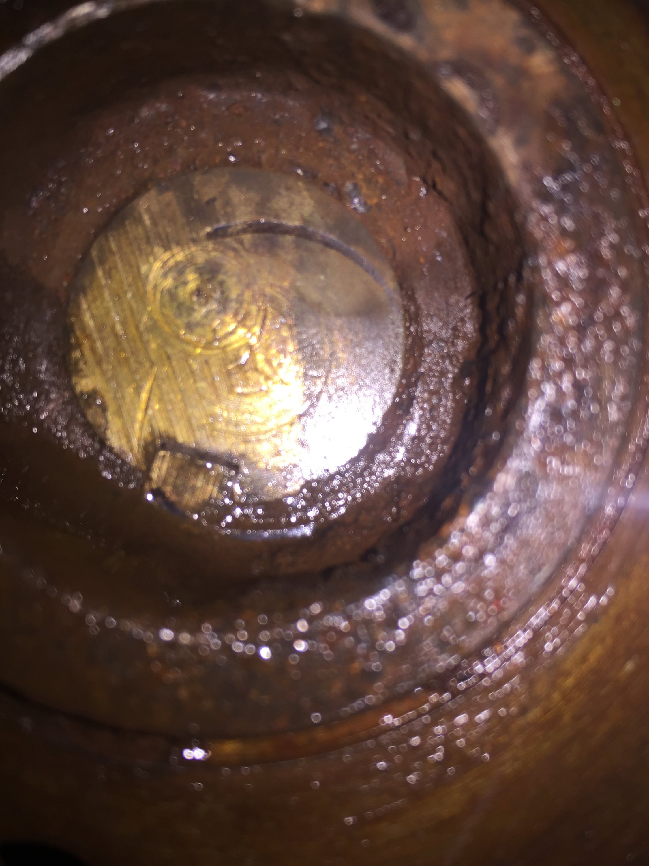

So, the good news is that I was able to press the coupling off the shaft using my cutlass bearing / prop removal tool. Took 2 days with some adjustments to tooling and approach on day 2, but the coupling came off clean. Terrible, cramped place to work. Took lots of muscle.
IMG_1023.JPG I placed a socket in the end of the coupling, sort of blind as it was up against the transmission . I forgot an inspection mirror. I could not budge the shaft on day 1. But I snapped this photo to try and see what was going on. Looks like 1) the socket was too large diameter, and 2) not centered ...so it was pushing on the key as well as the rim of the coupling. On day 2, I used a much smaller diameter socket to ensure it was not hitting the key or the rim of the coupling.
