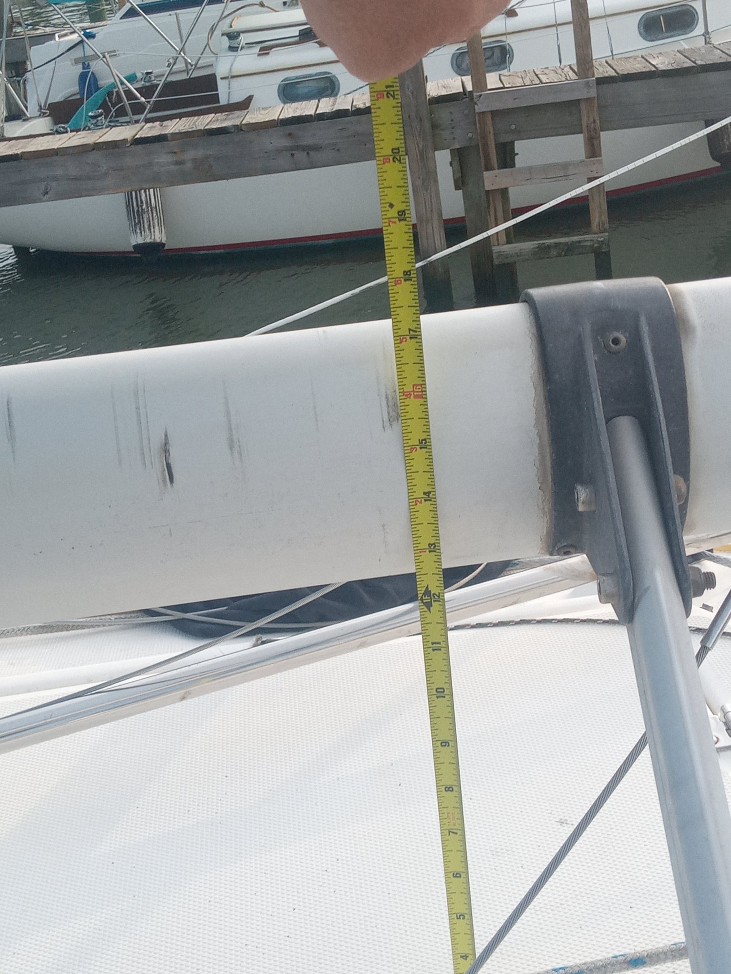

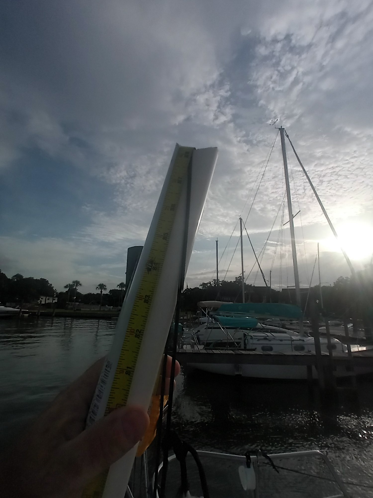

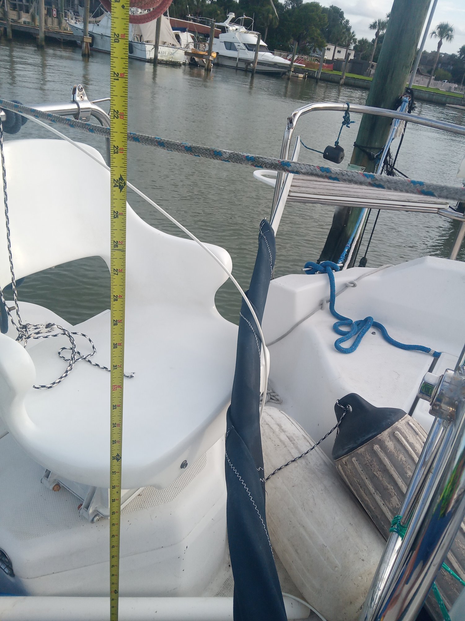

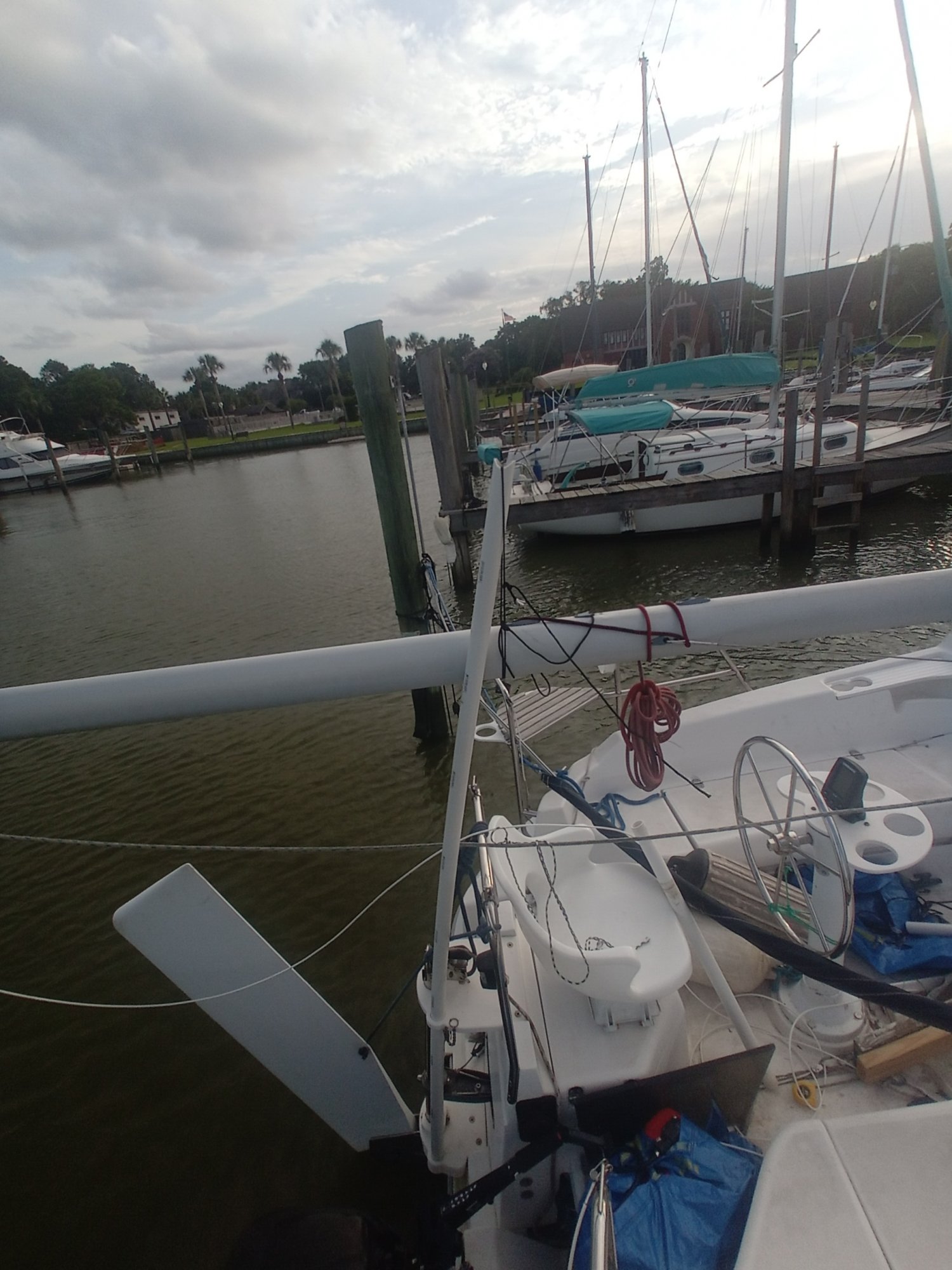

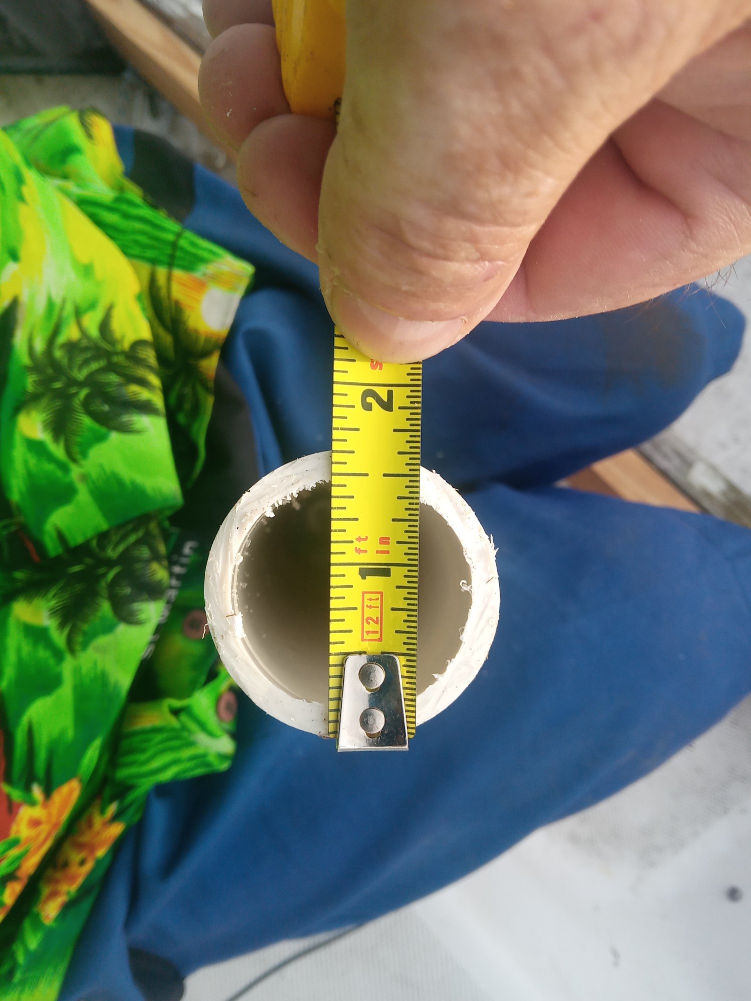

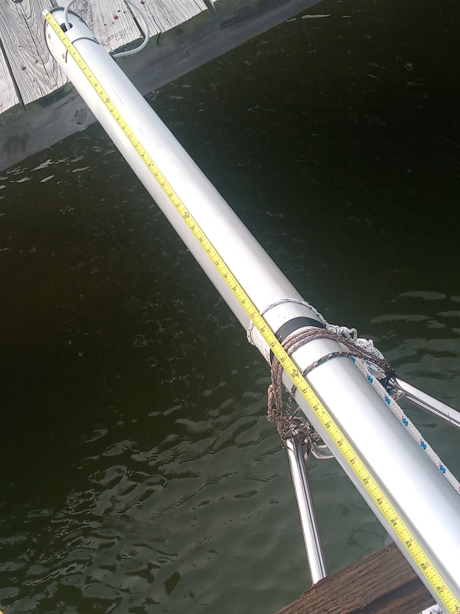

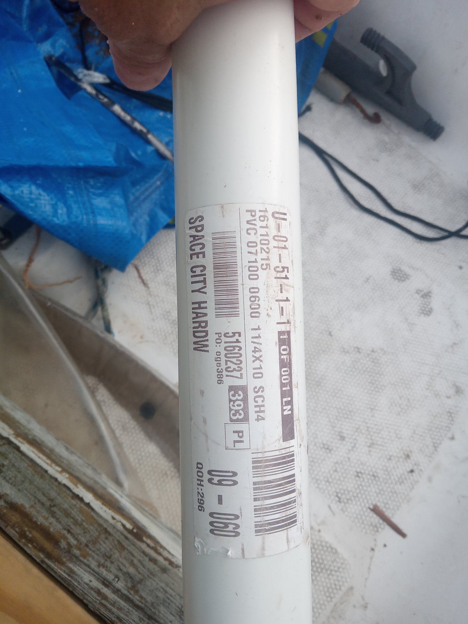

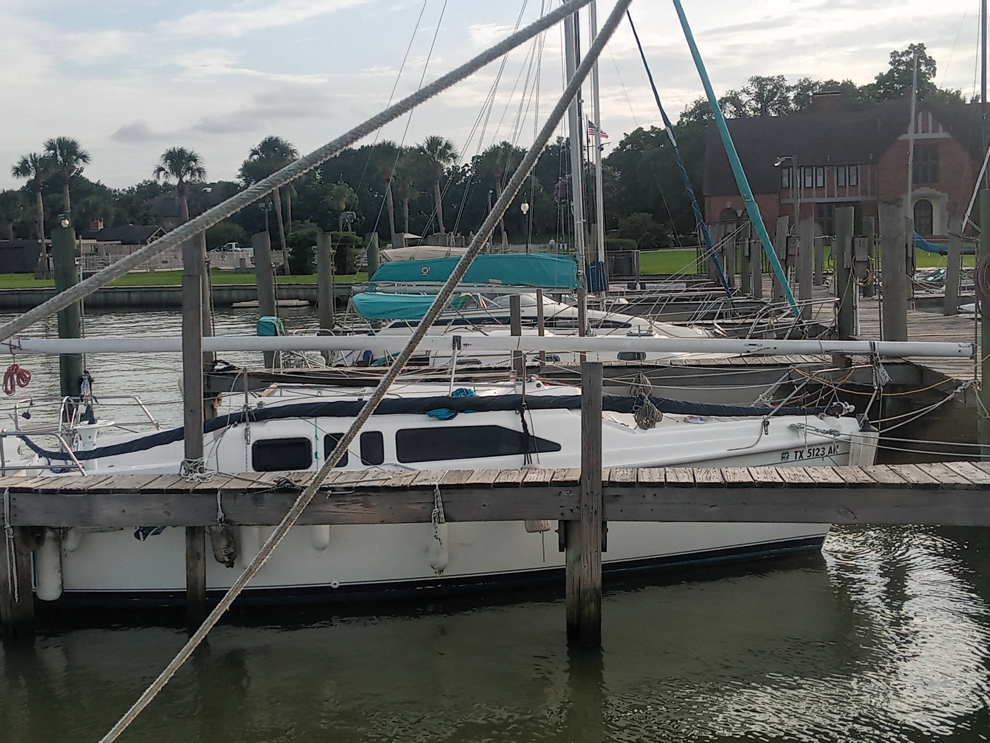

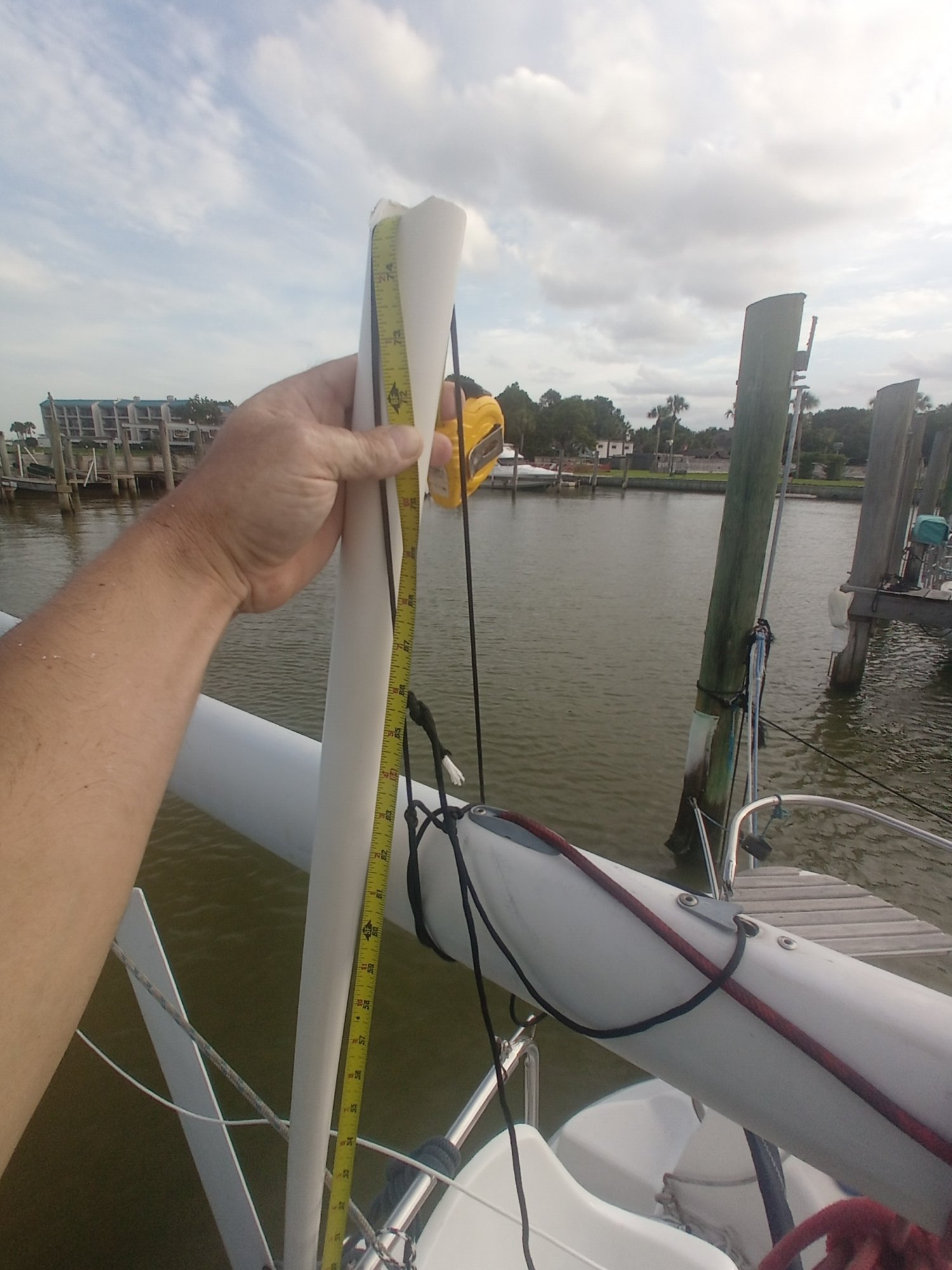

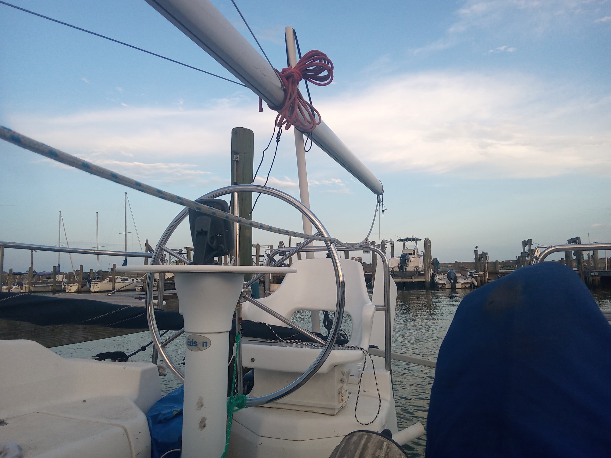

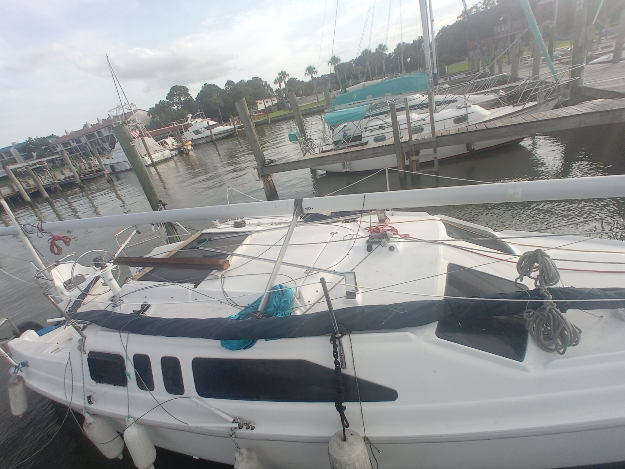

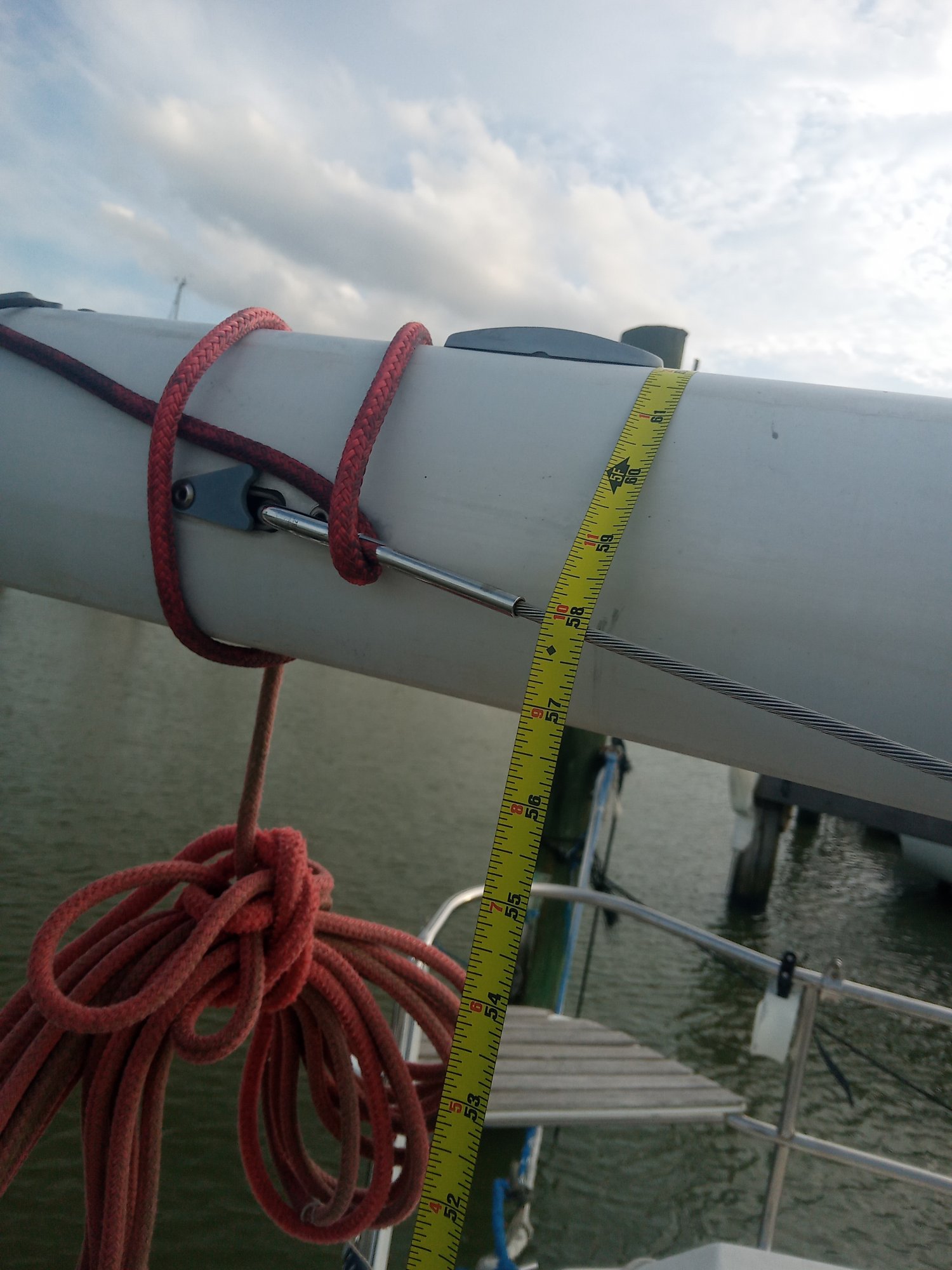

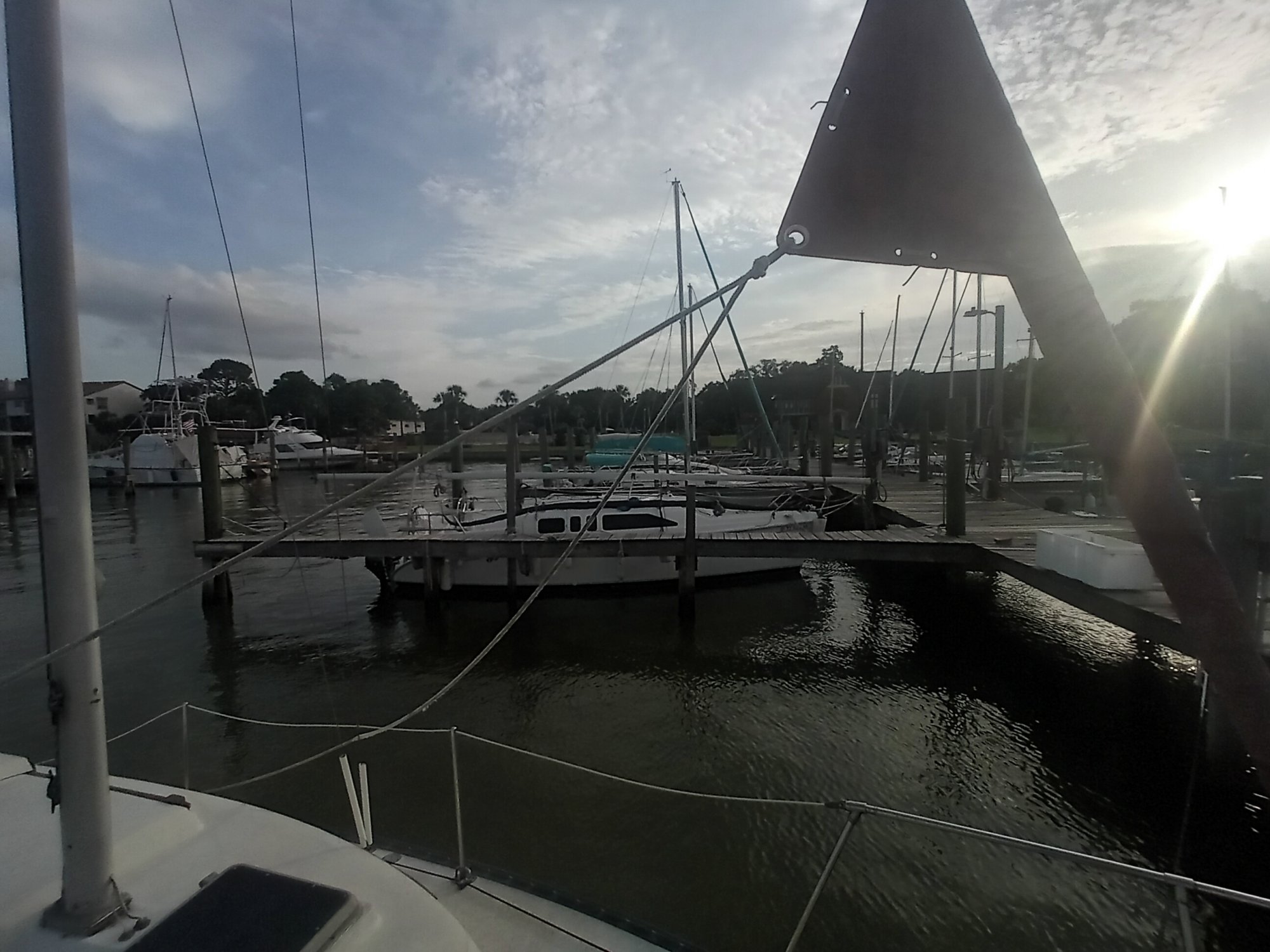

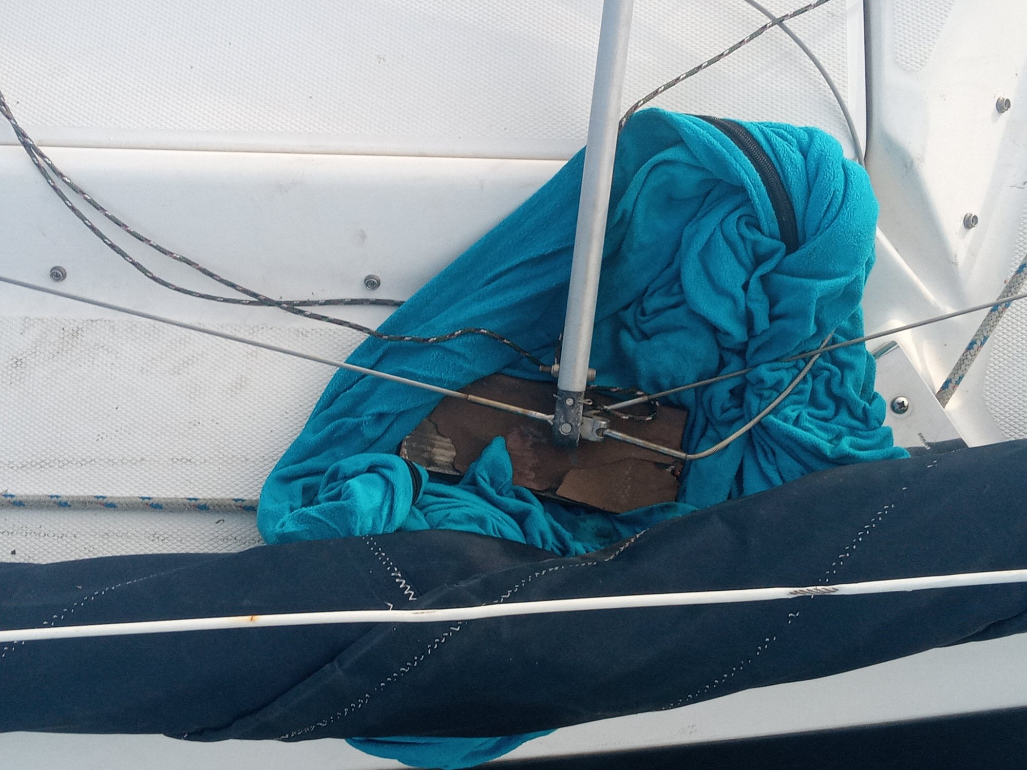

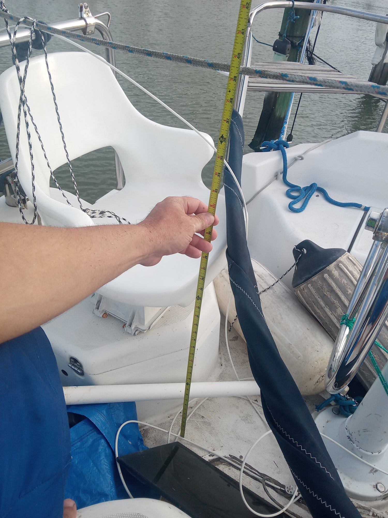

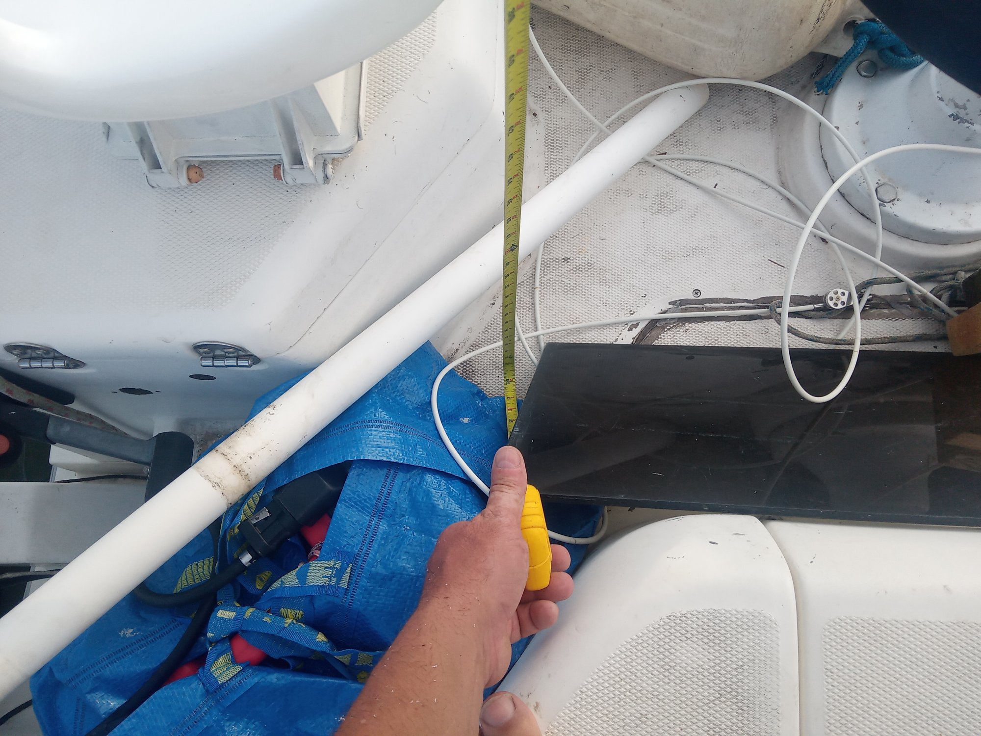

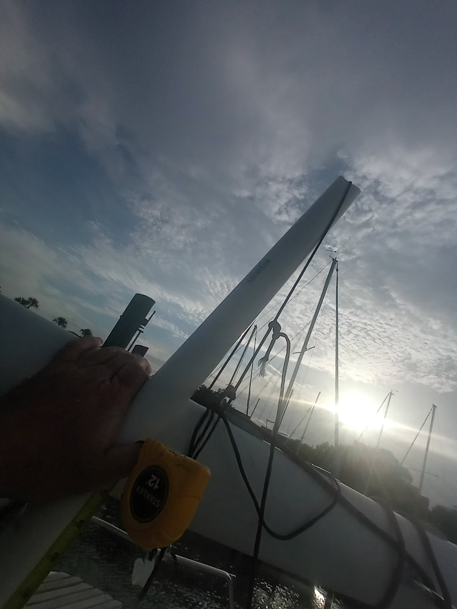

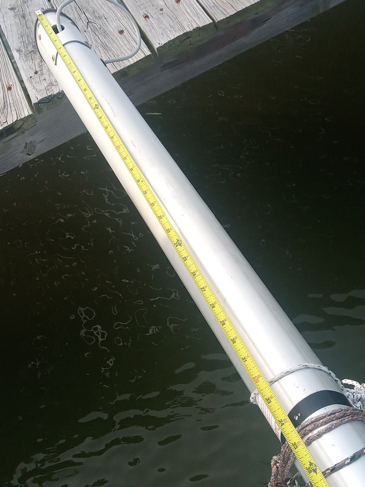

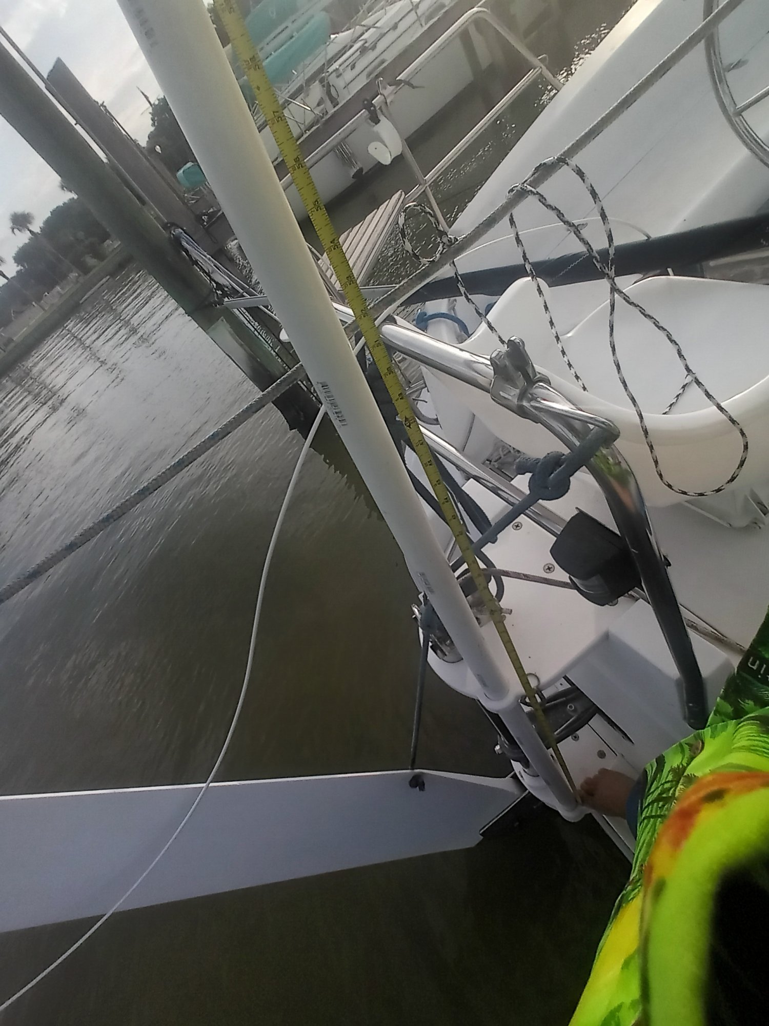

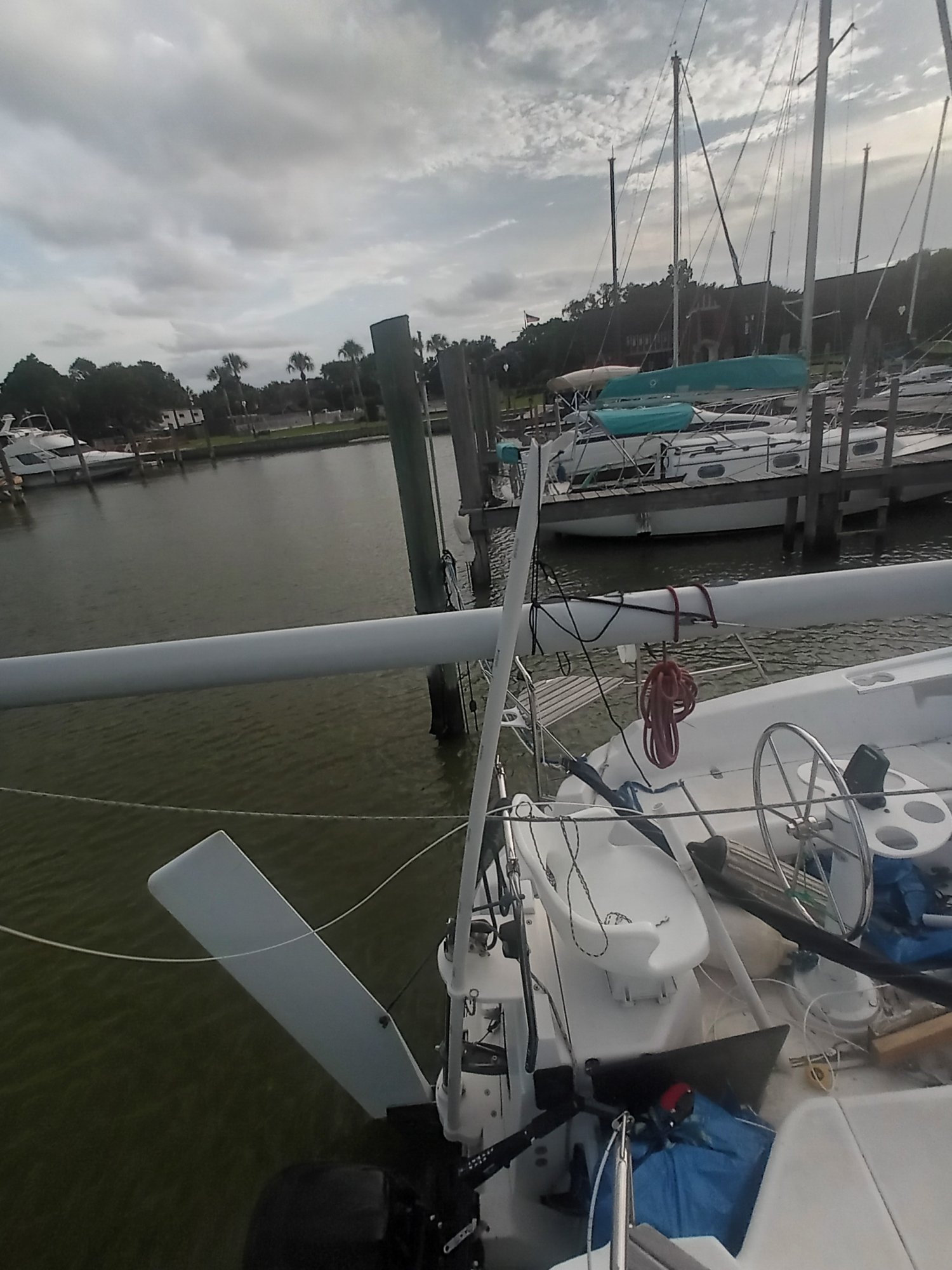

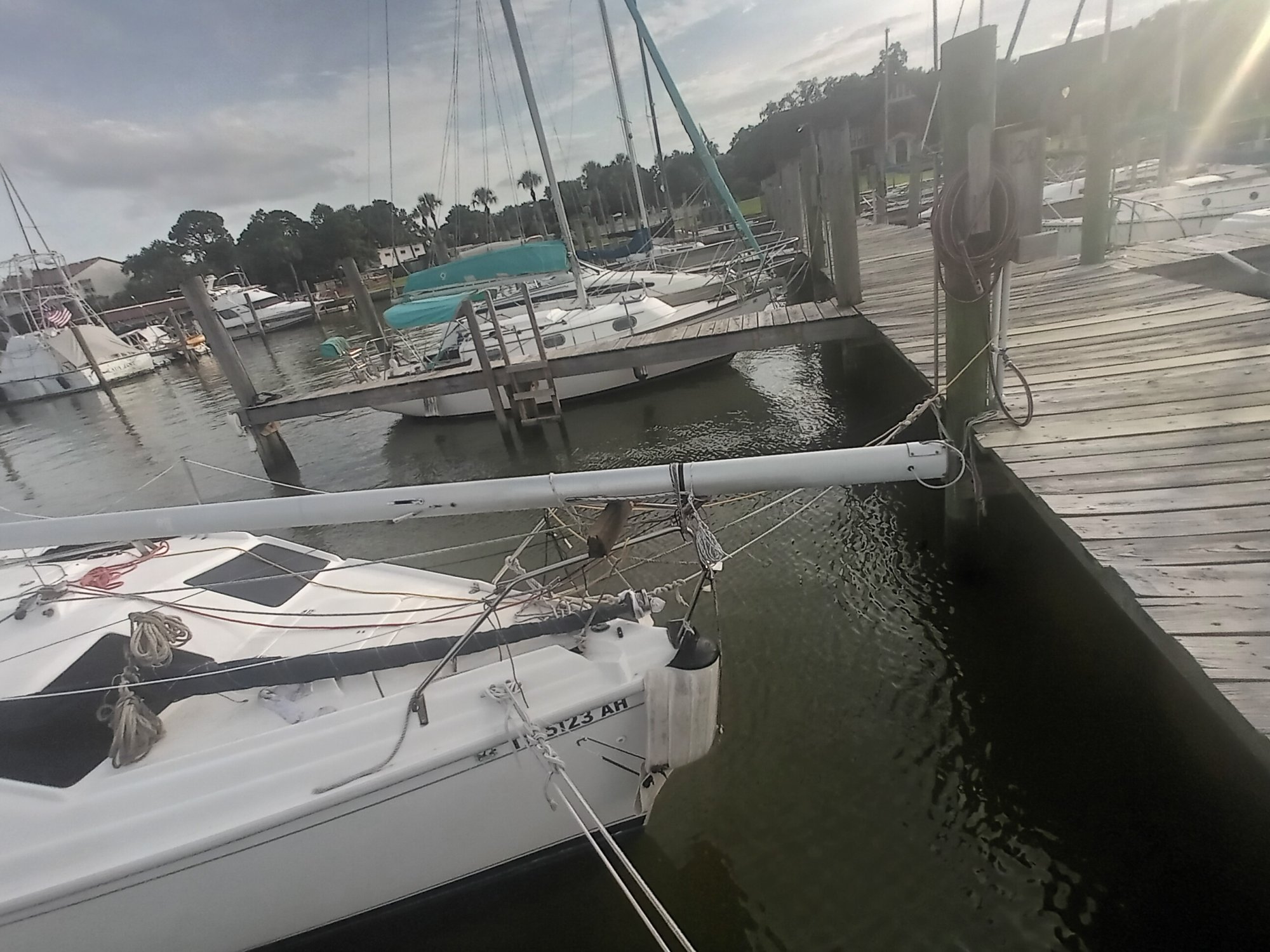

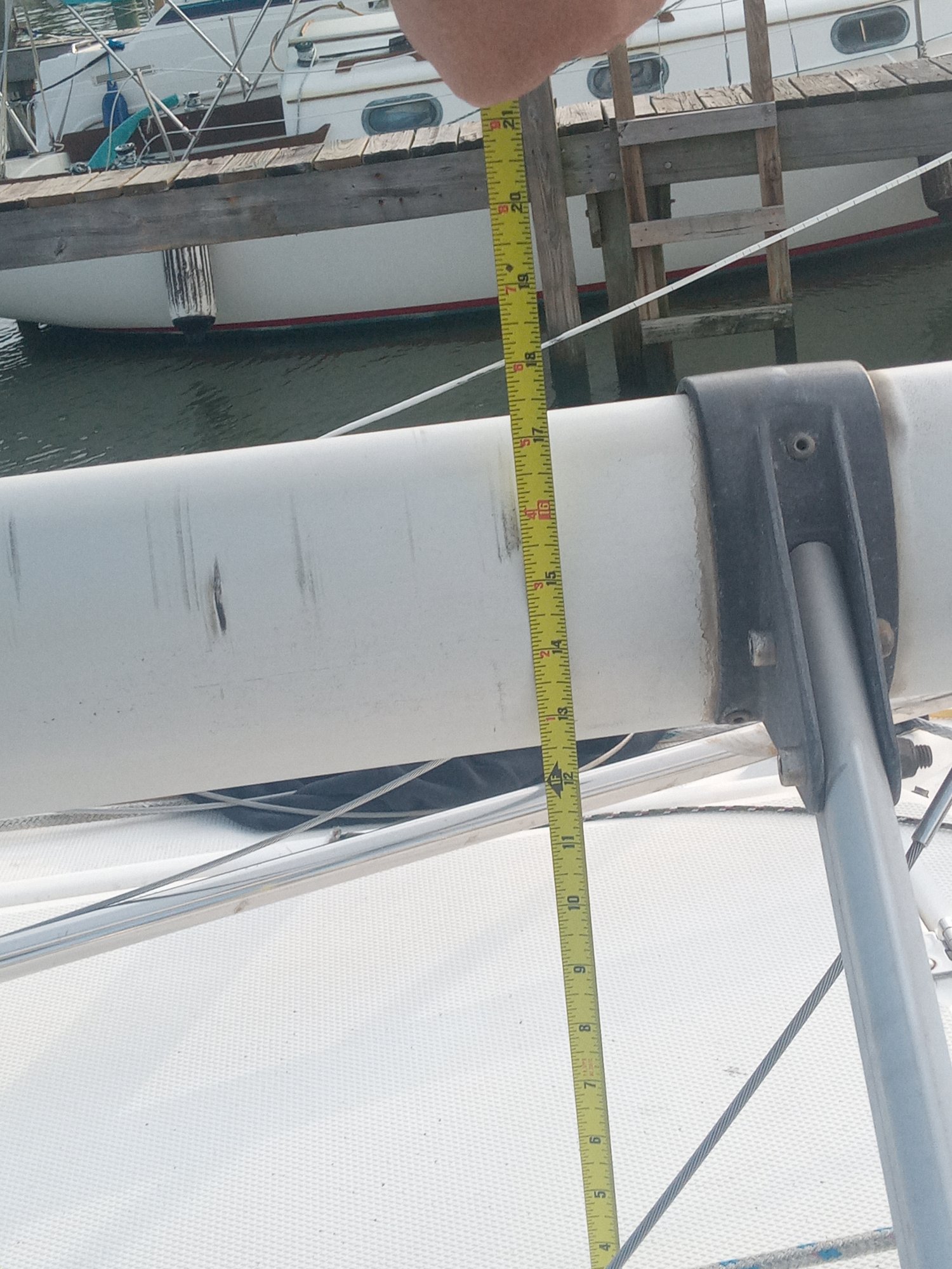

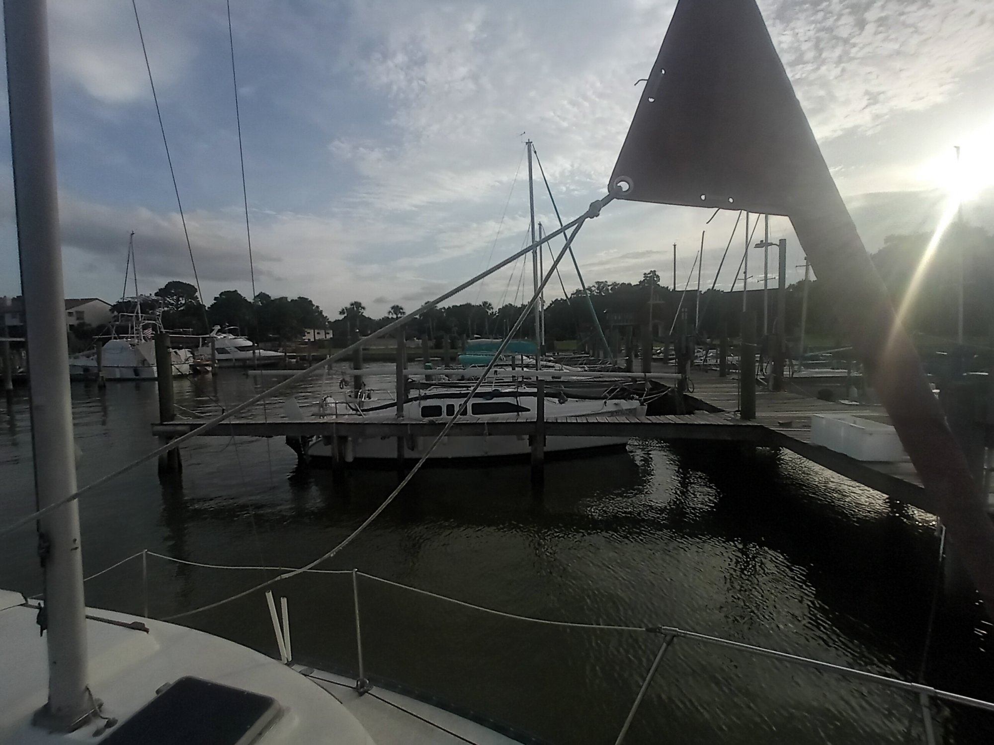

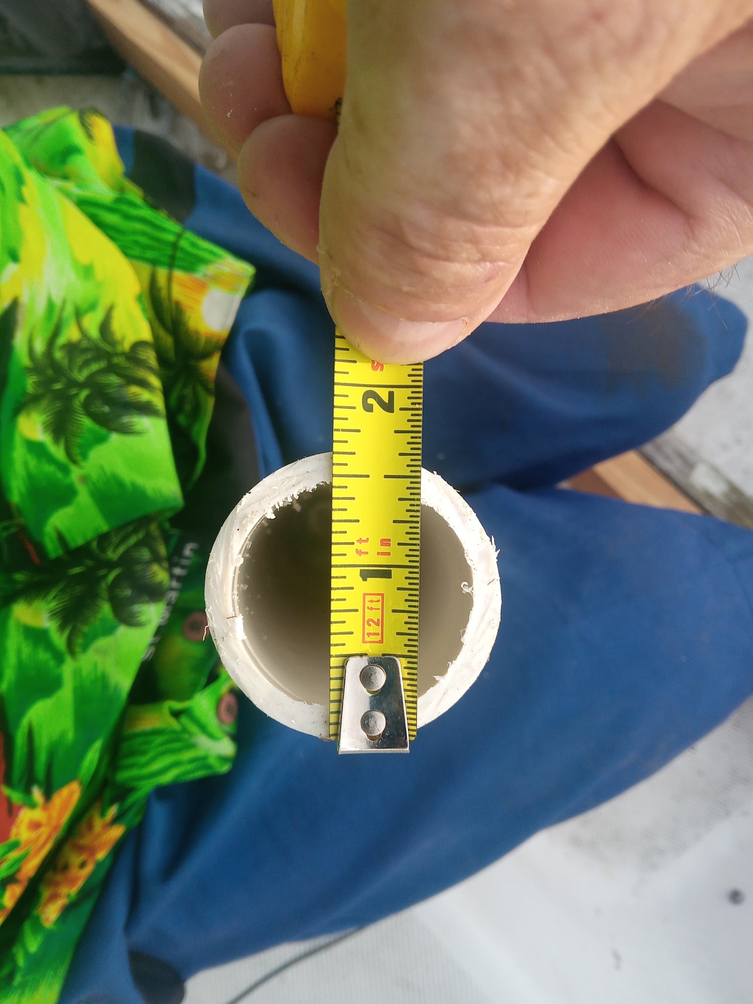

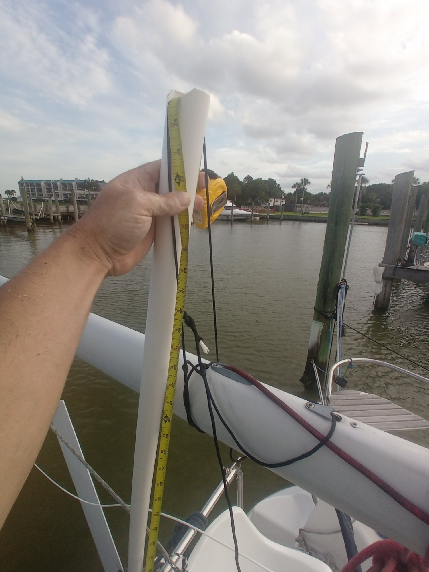

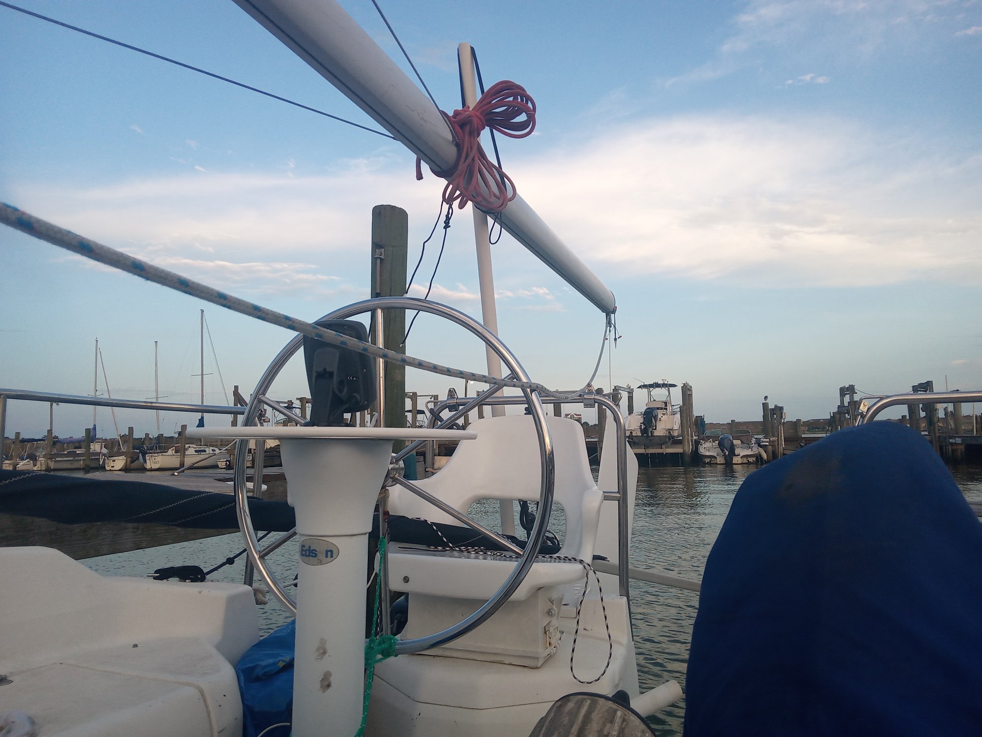

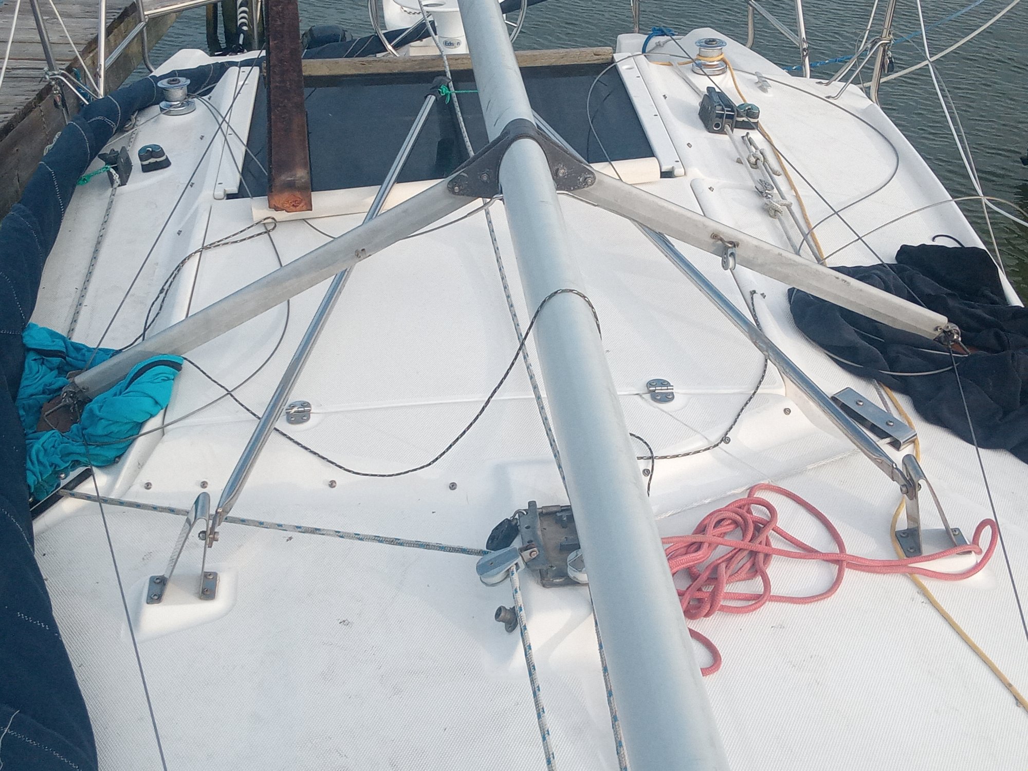

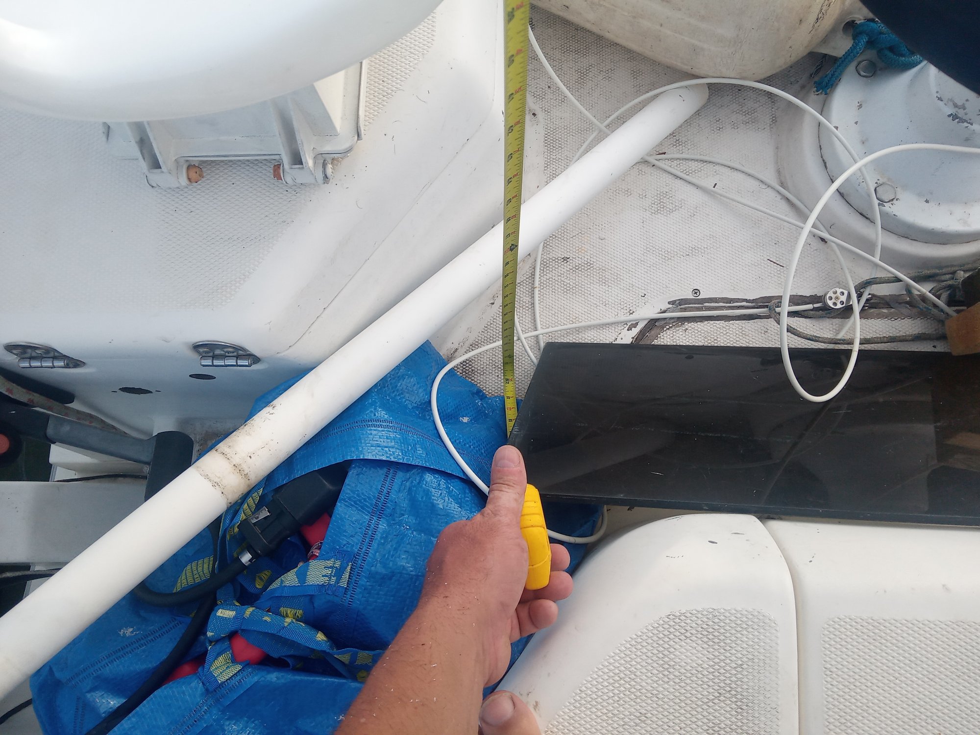

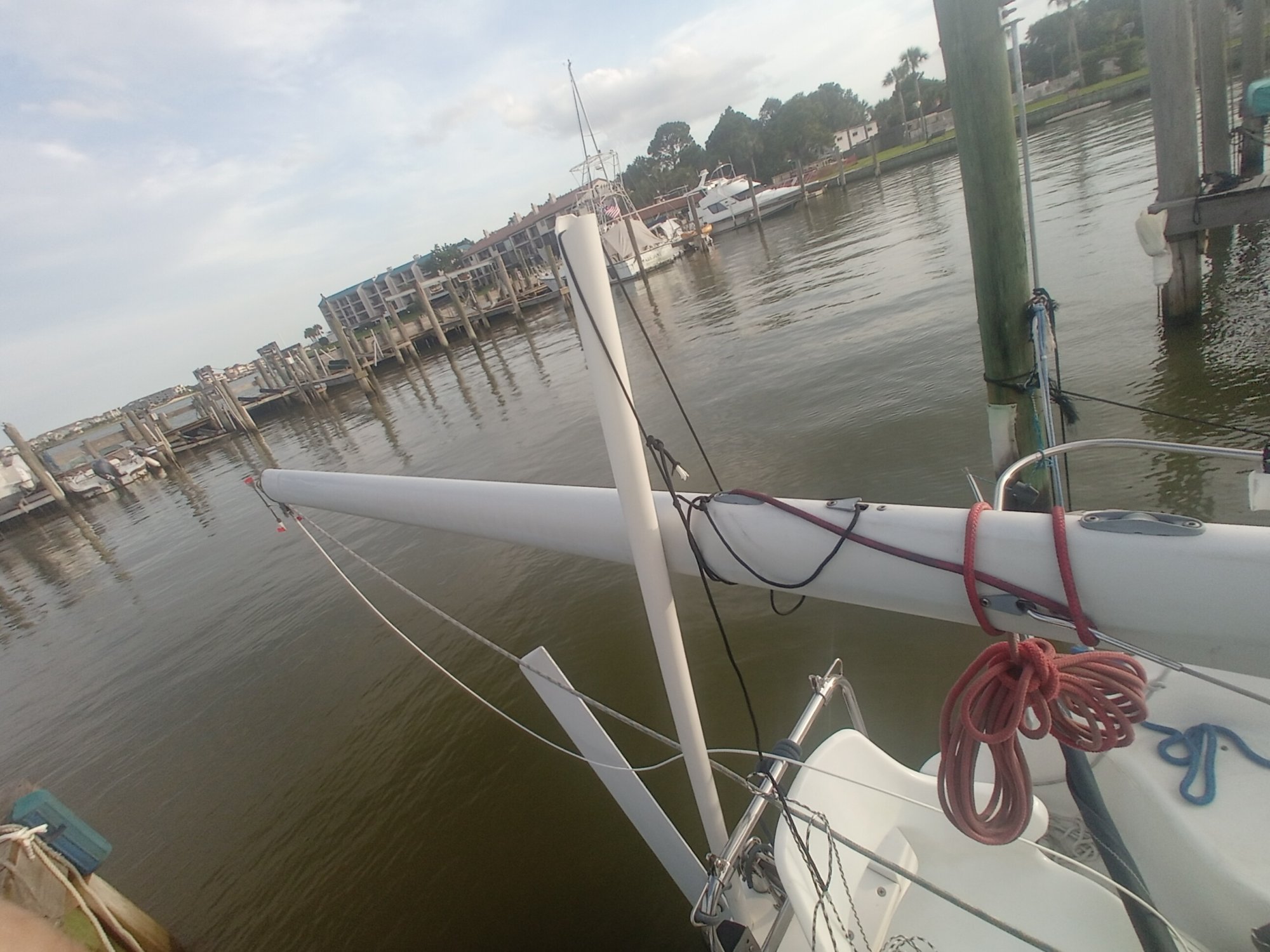

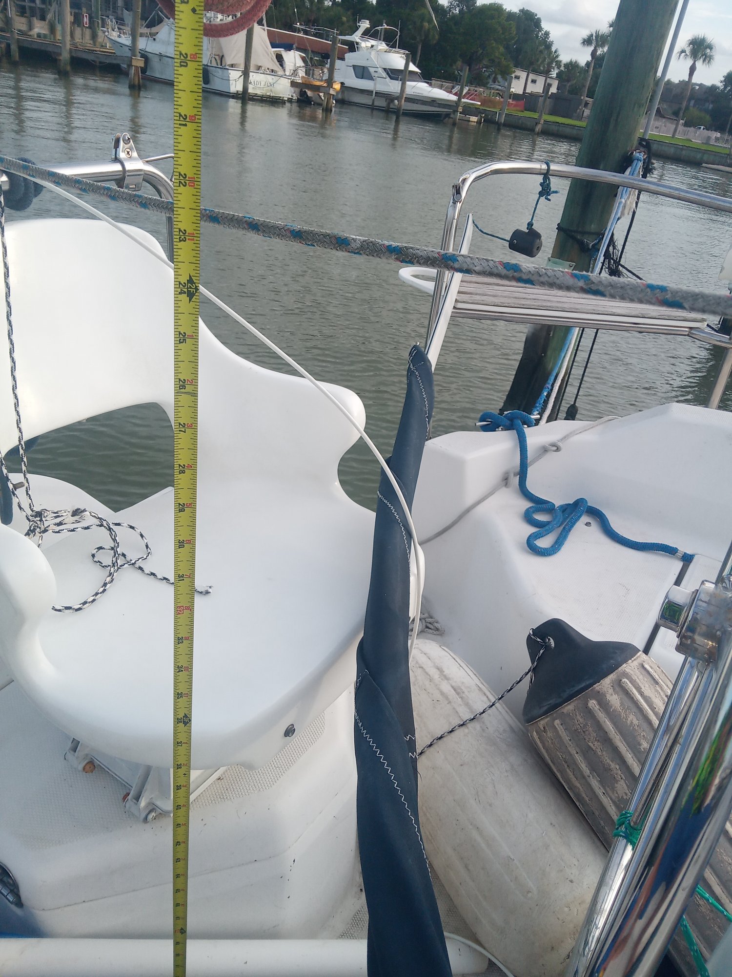

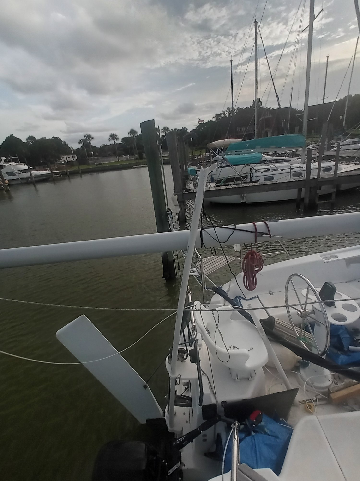

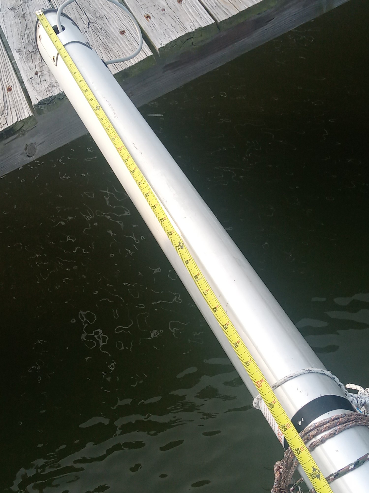

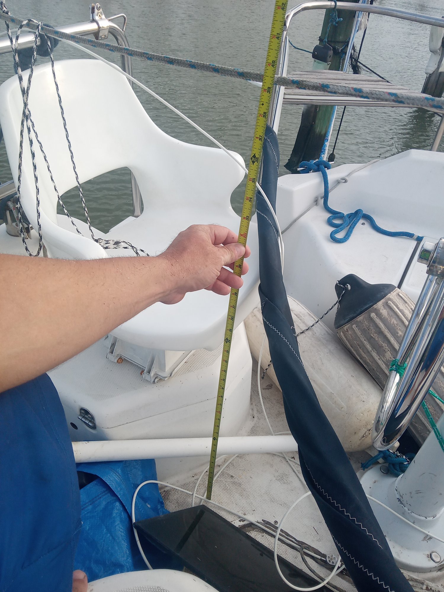

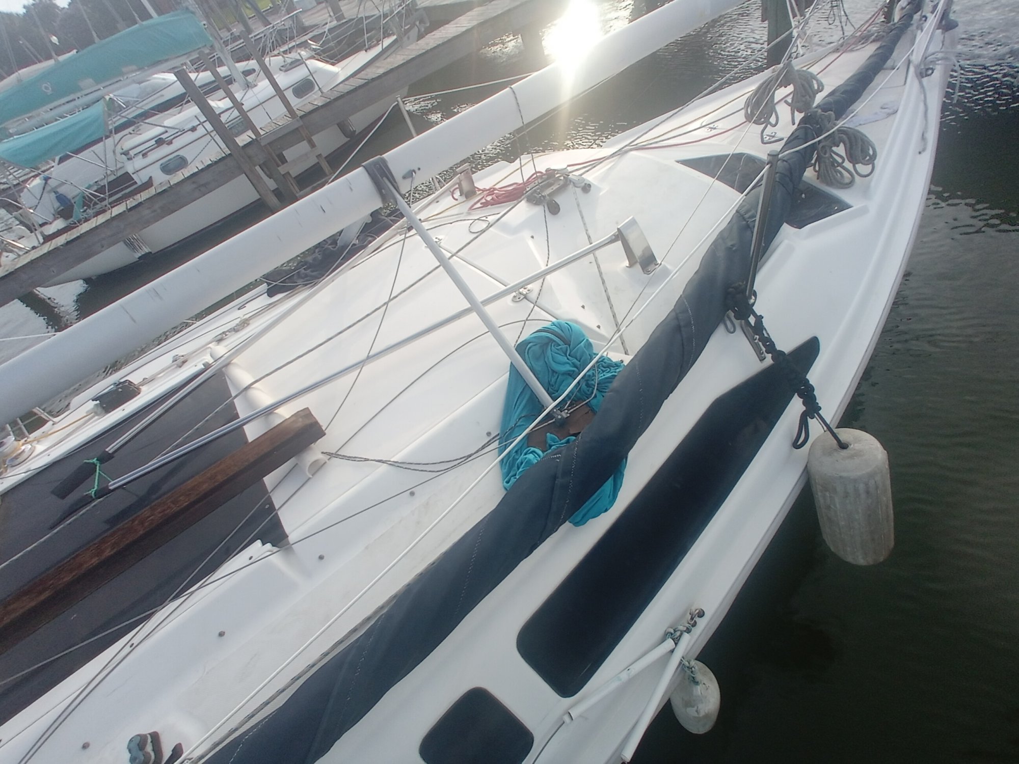

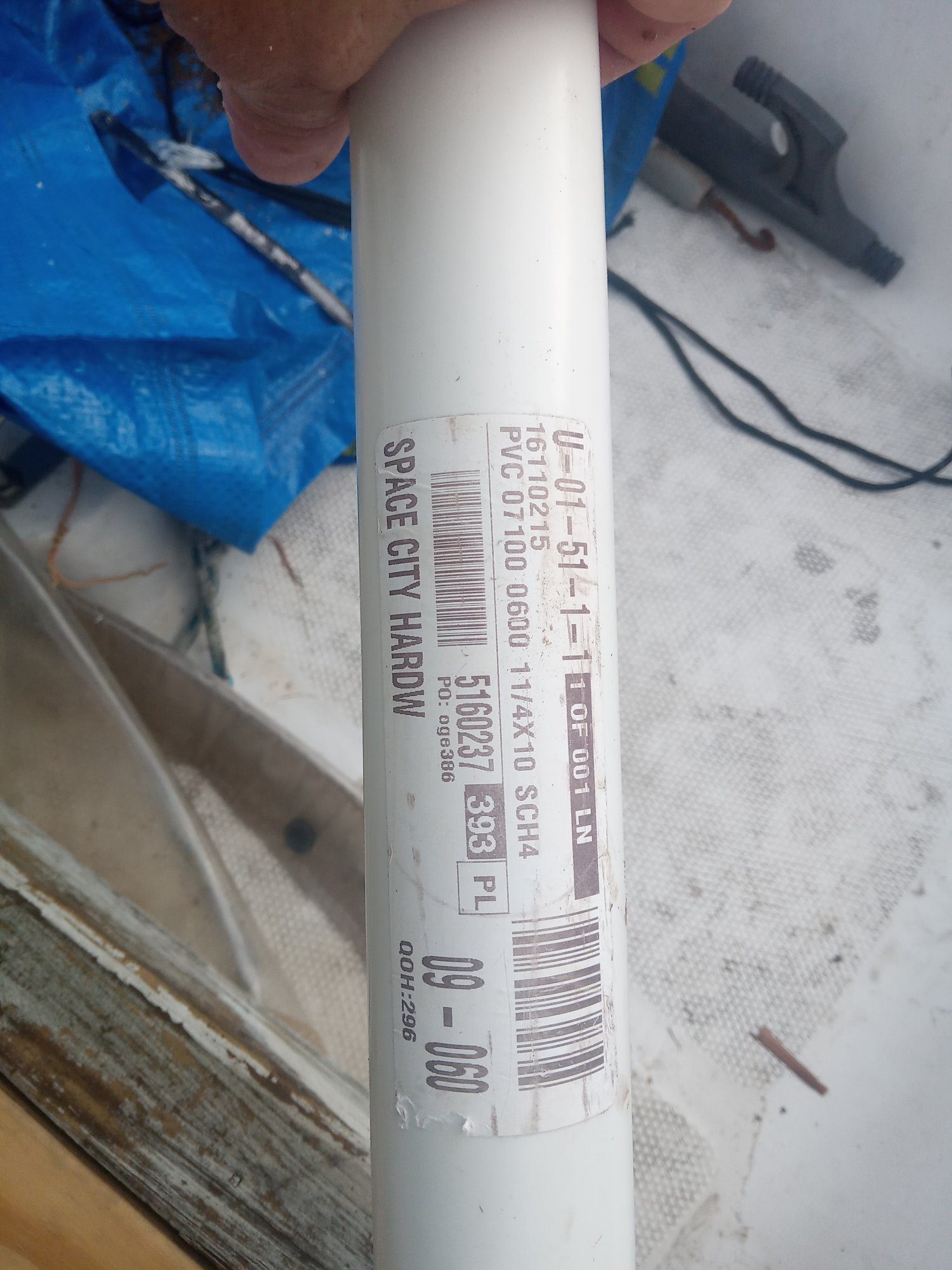

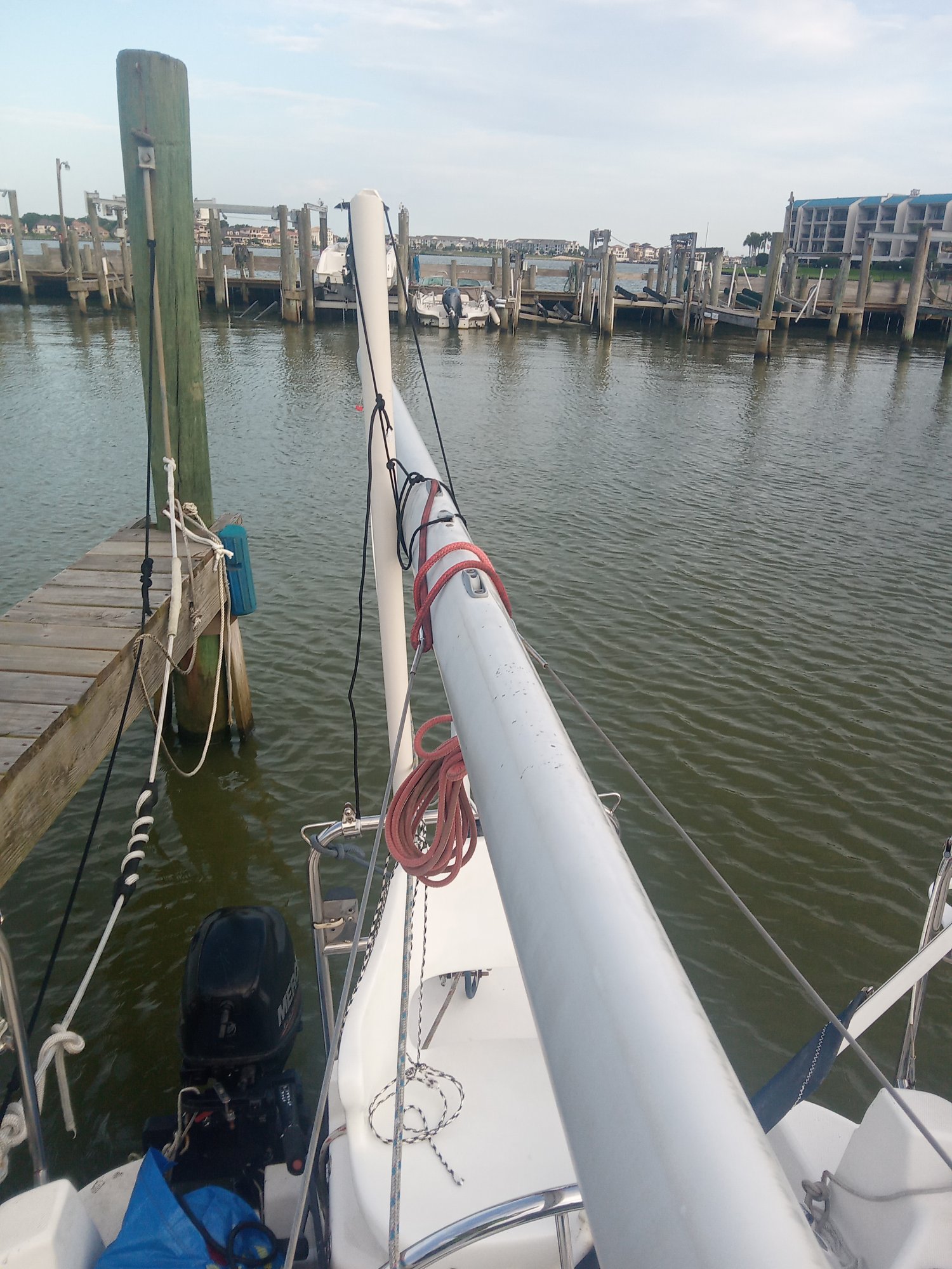

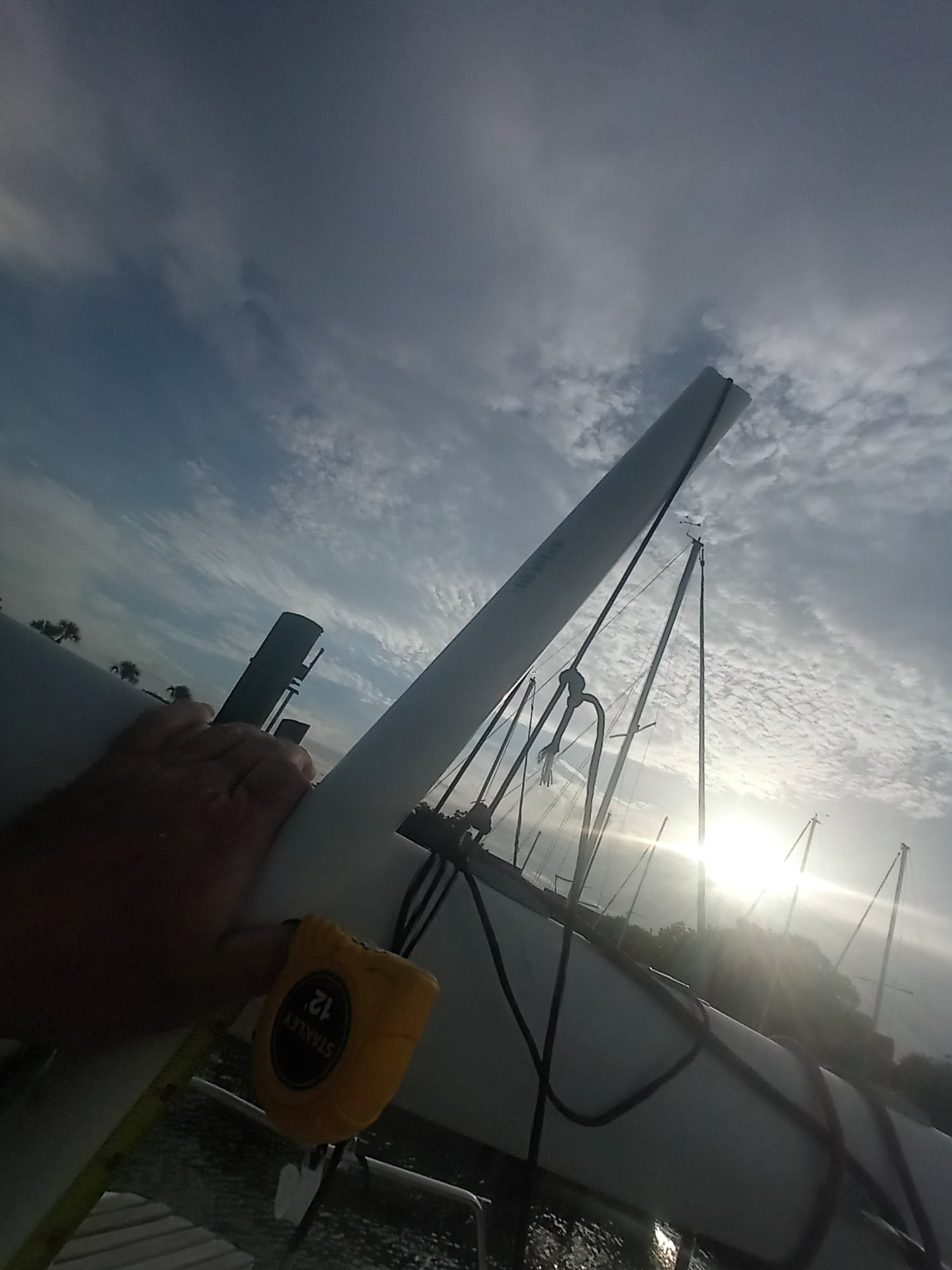

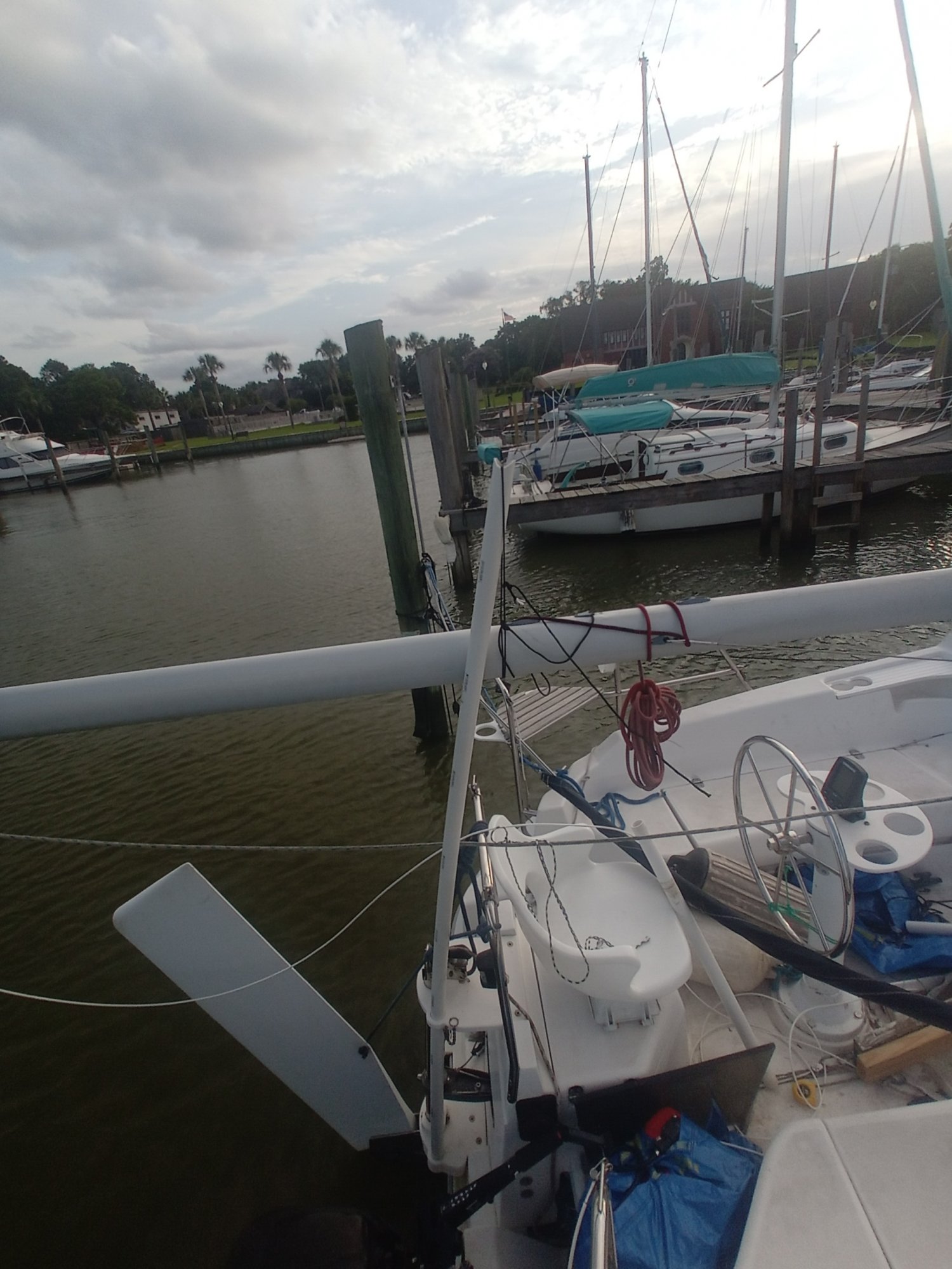

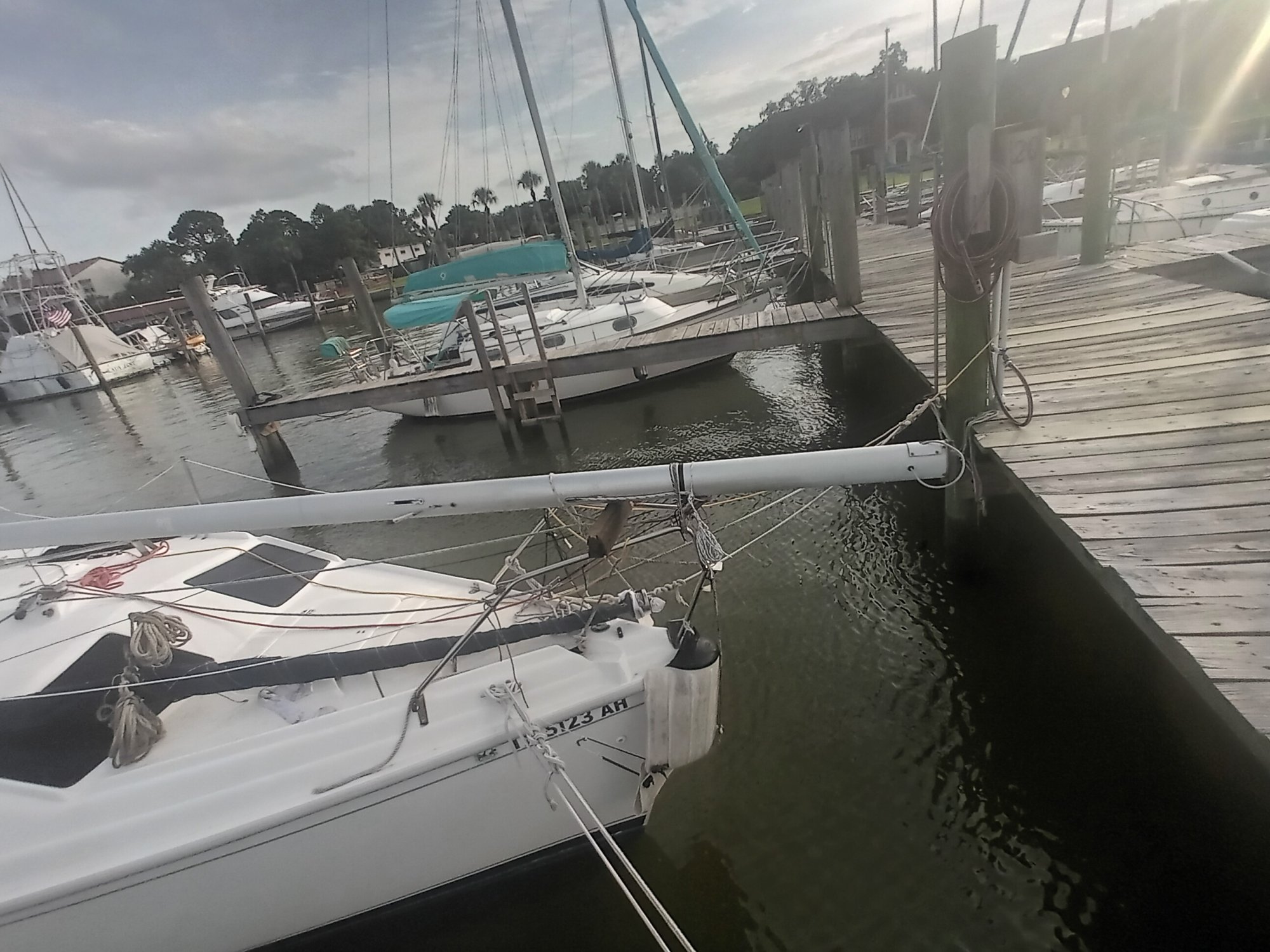

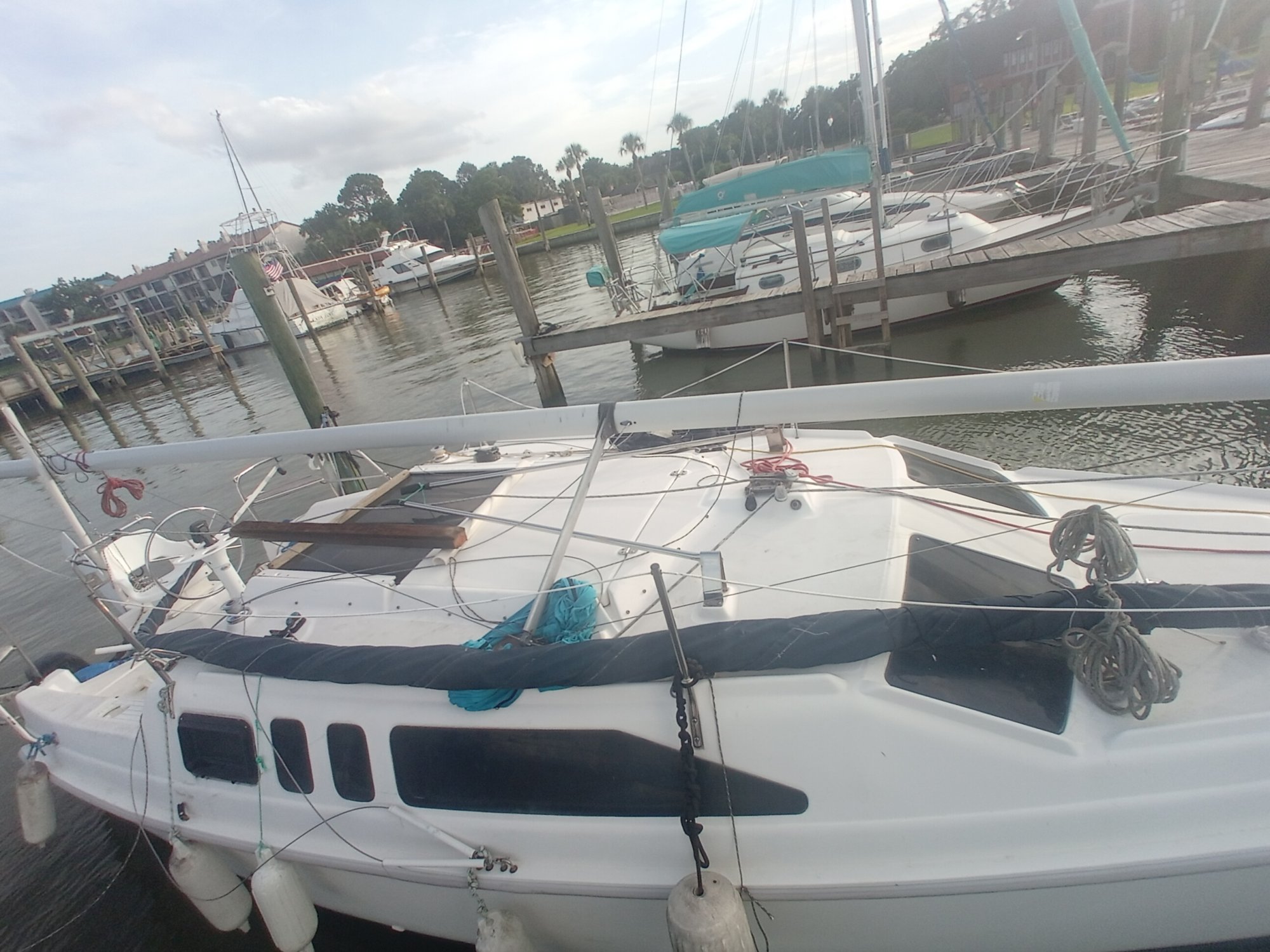

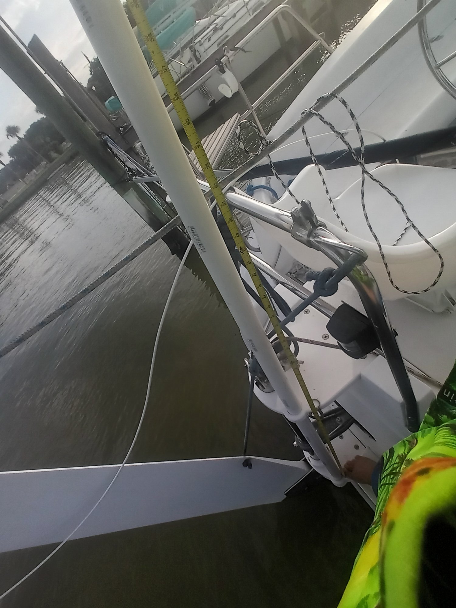

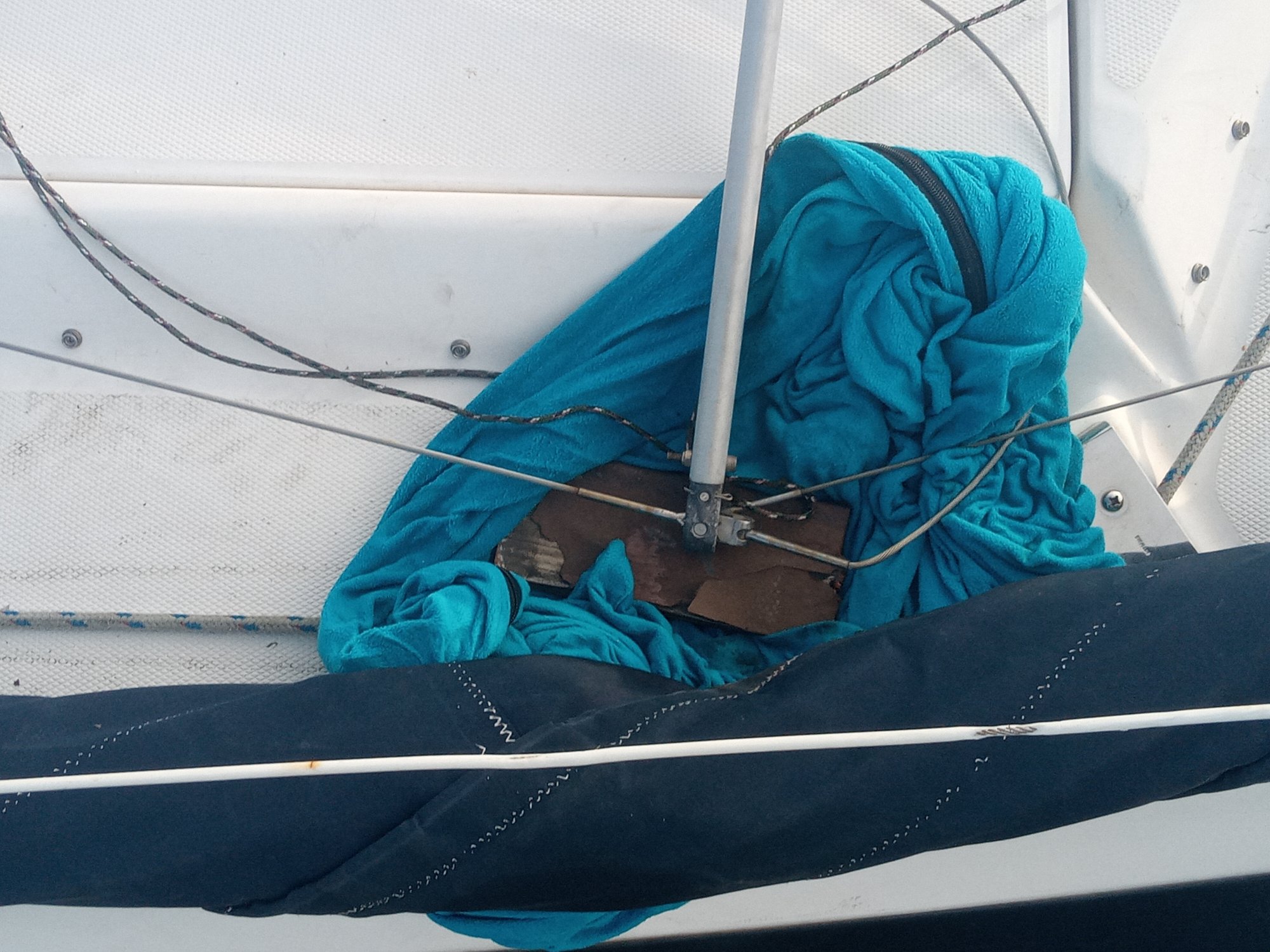

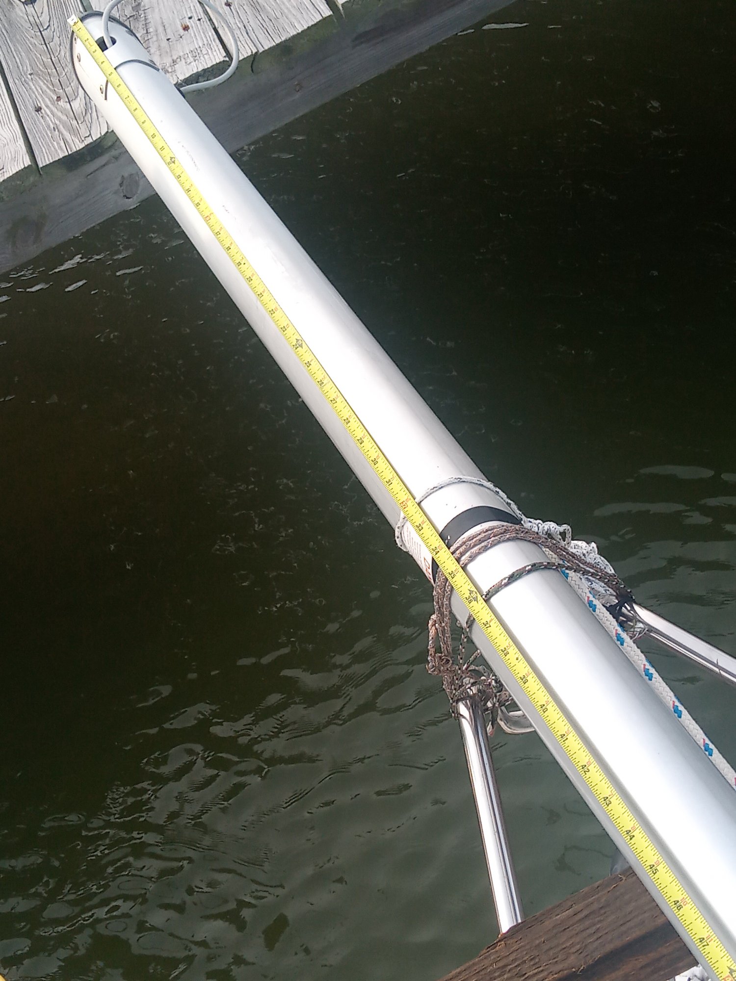

Ok. In a rush I've thrown together a low way to store the h260 mast, with 95% of weight split between bow and a PVC rear mast crutch, and 5% on the spreaders. Spreaders just are kissing some plywood put to spread out any touch. I admit involving the mast braces would be better but I'm tired. I need to stiffen the mast crutch so less bend: maybe insert a 2nd pipe, add post hole foam, switch to metal. I need to also strap down all before hurricanes. I think this "LowRider H260" is ok option, I'm sure others did this before. Crutch is 90" of pvc. I'm almost 6ft and can sit in chair and my head don't touch mast. See Pics. THANKS. - Davenport
Oct 8, 2023
116
Hunter 260 Kemah

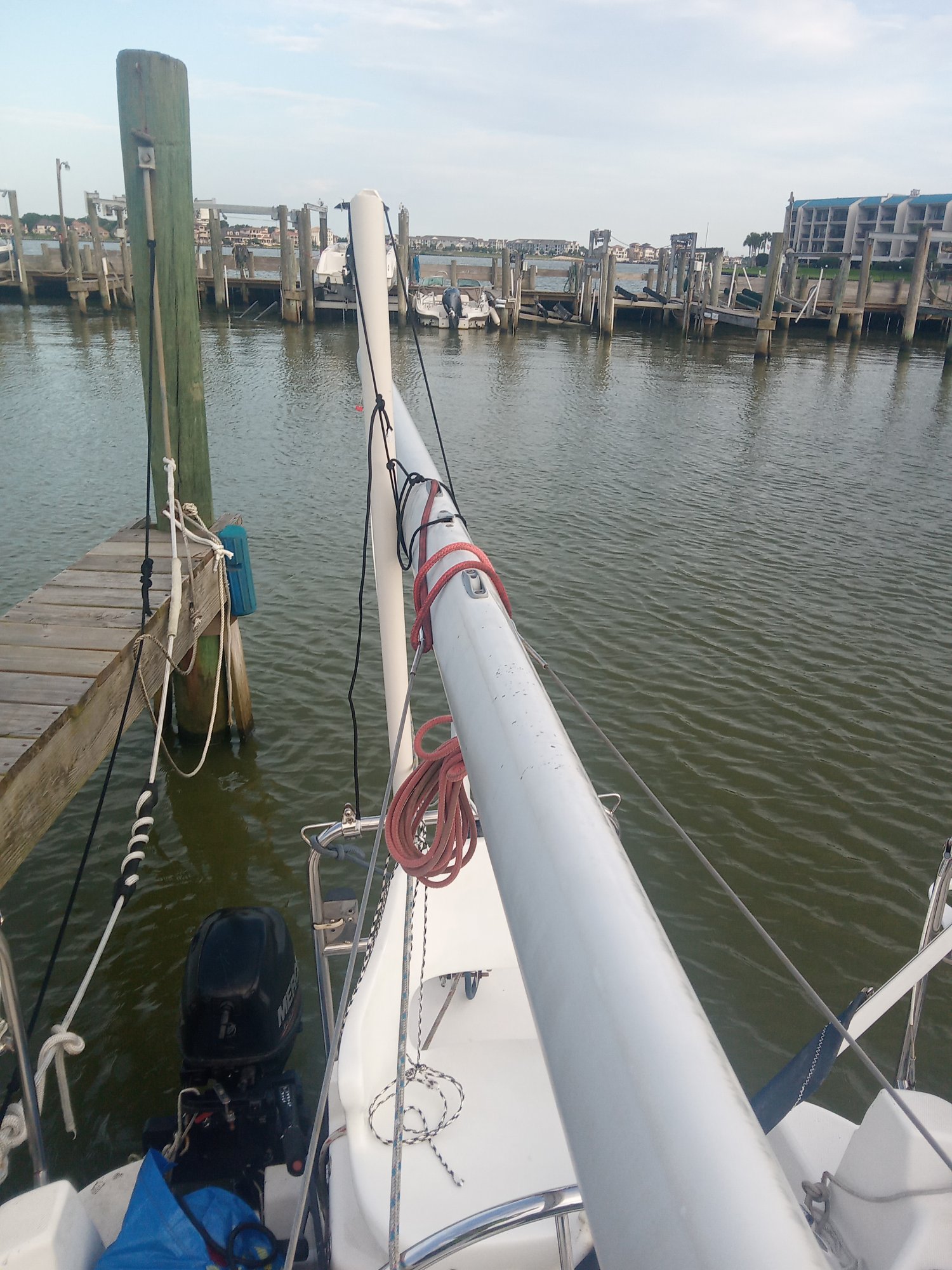

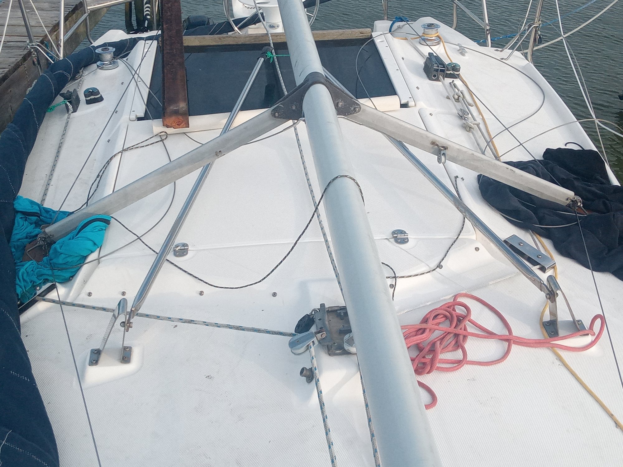

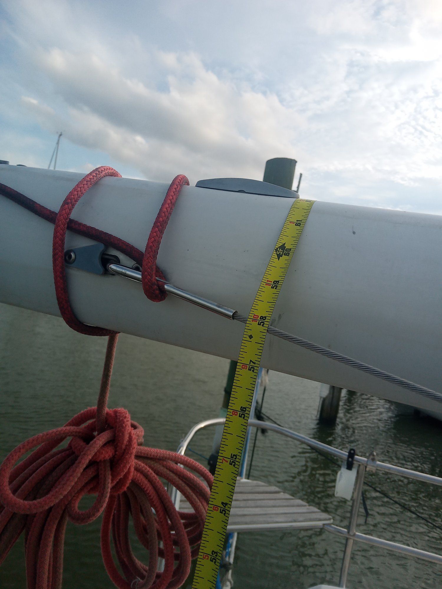

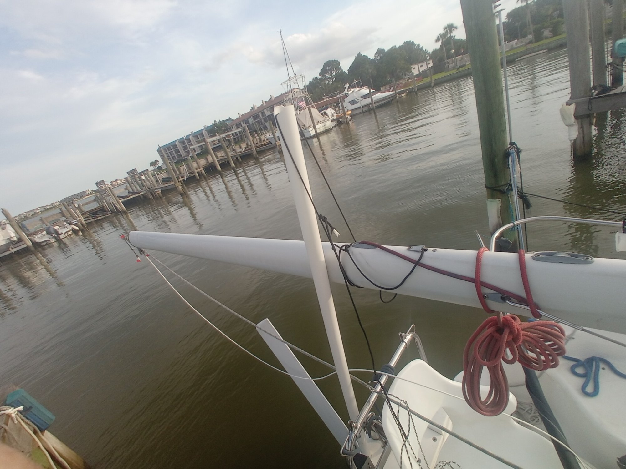

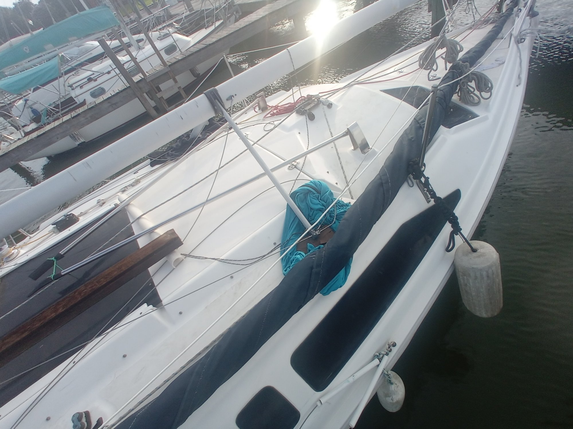

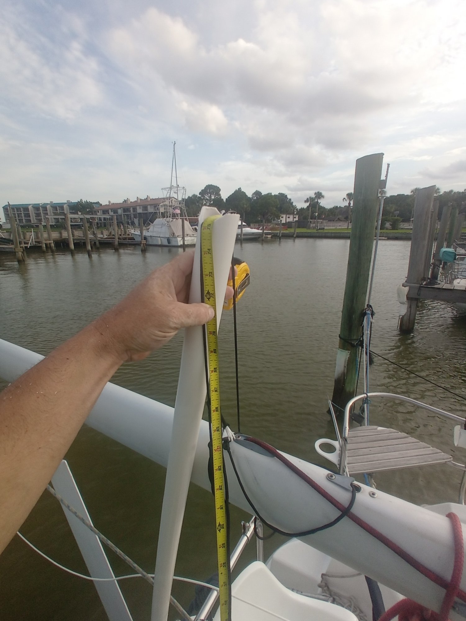

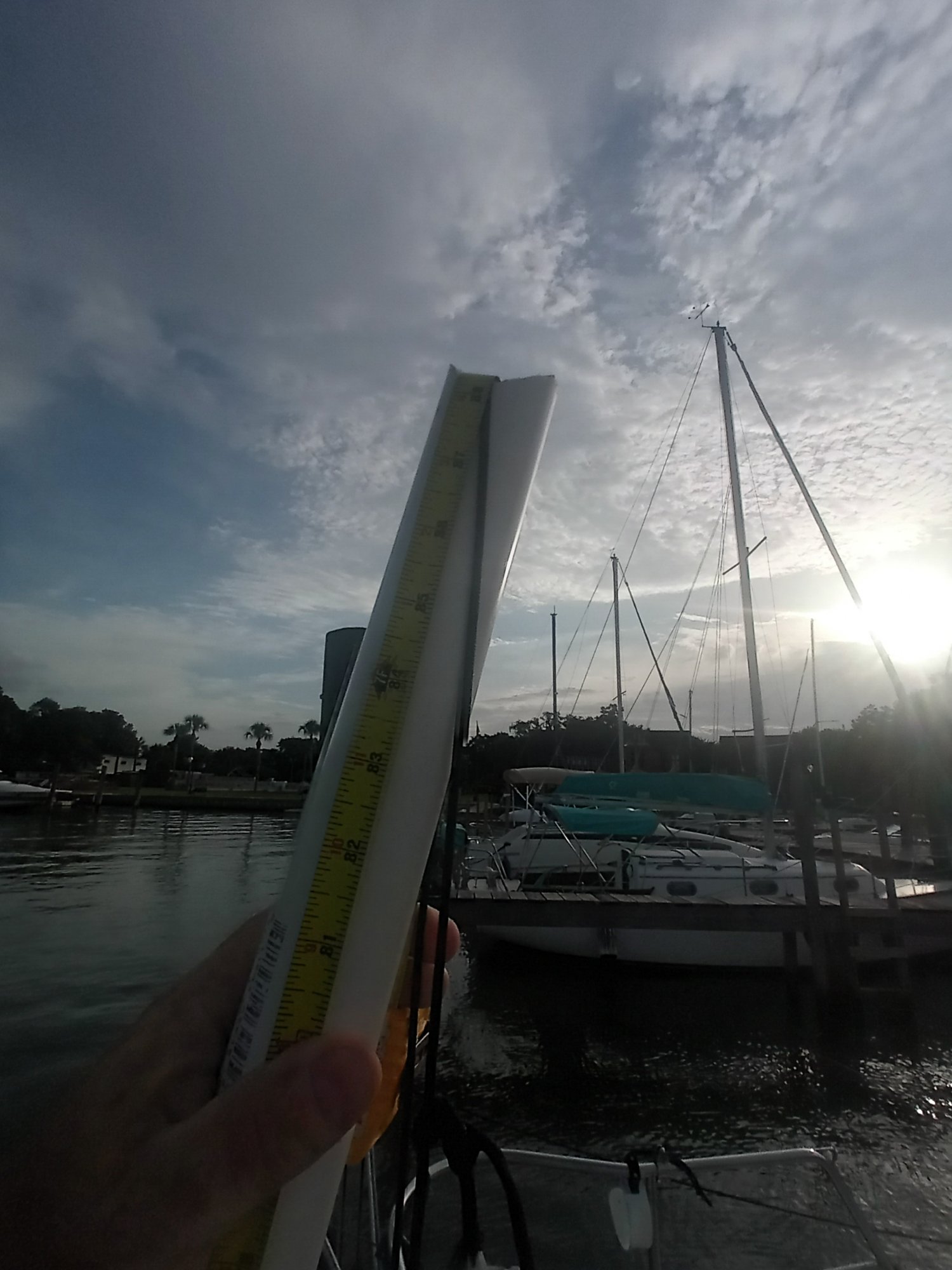

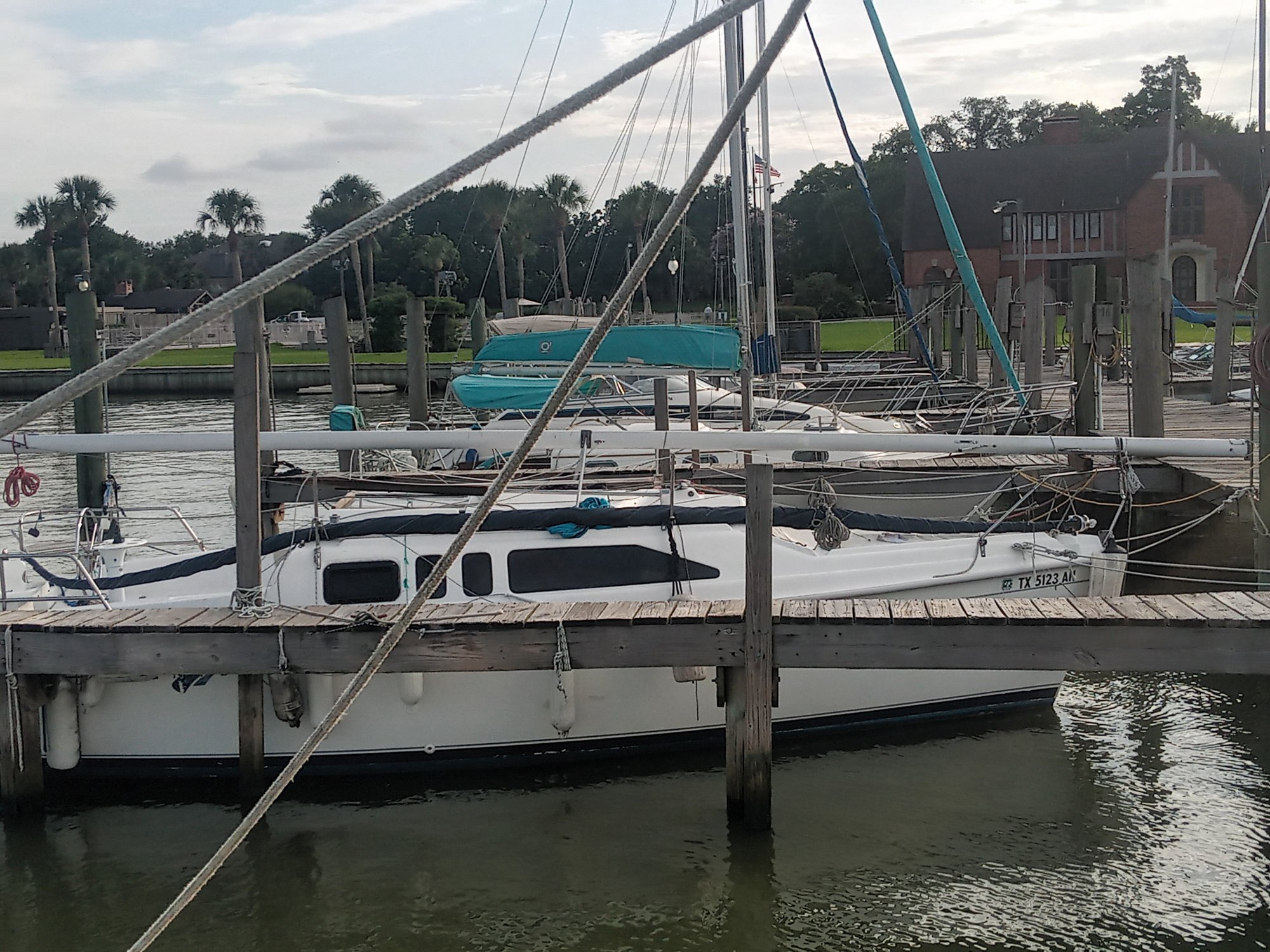

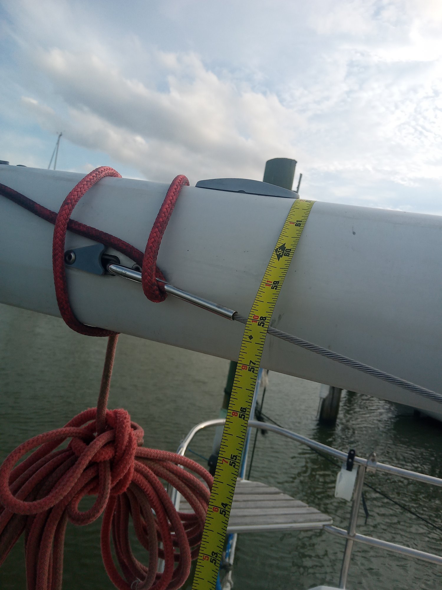

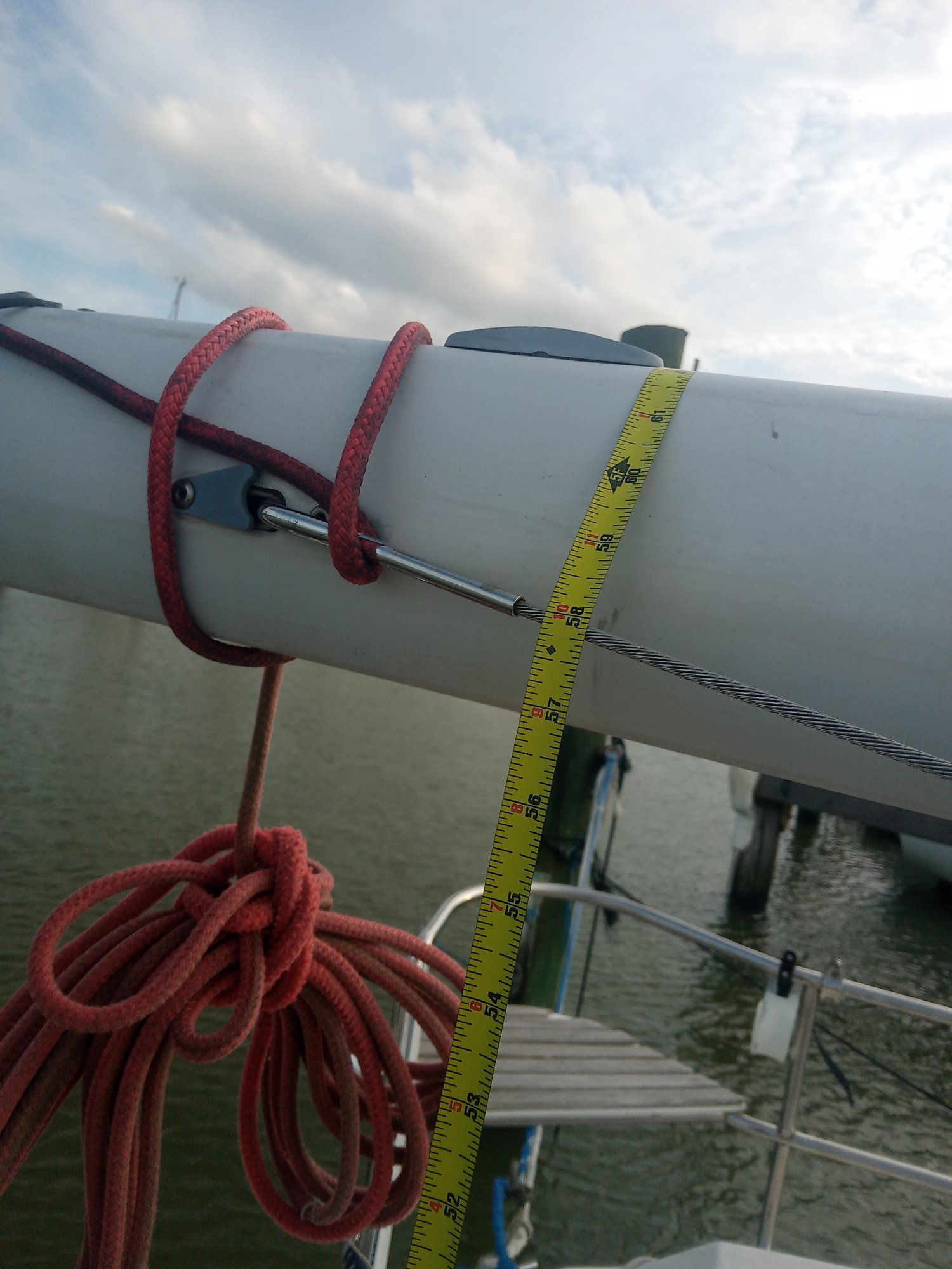

More pics of LowRider H260 option. .. See pics
Oct 8, 2023
116
Hunter 260 Kemah

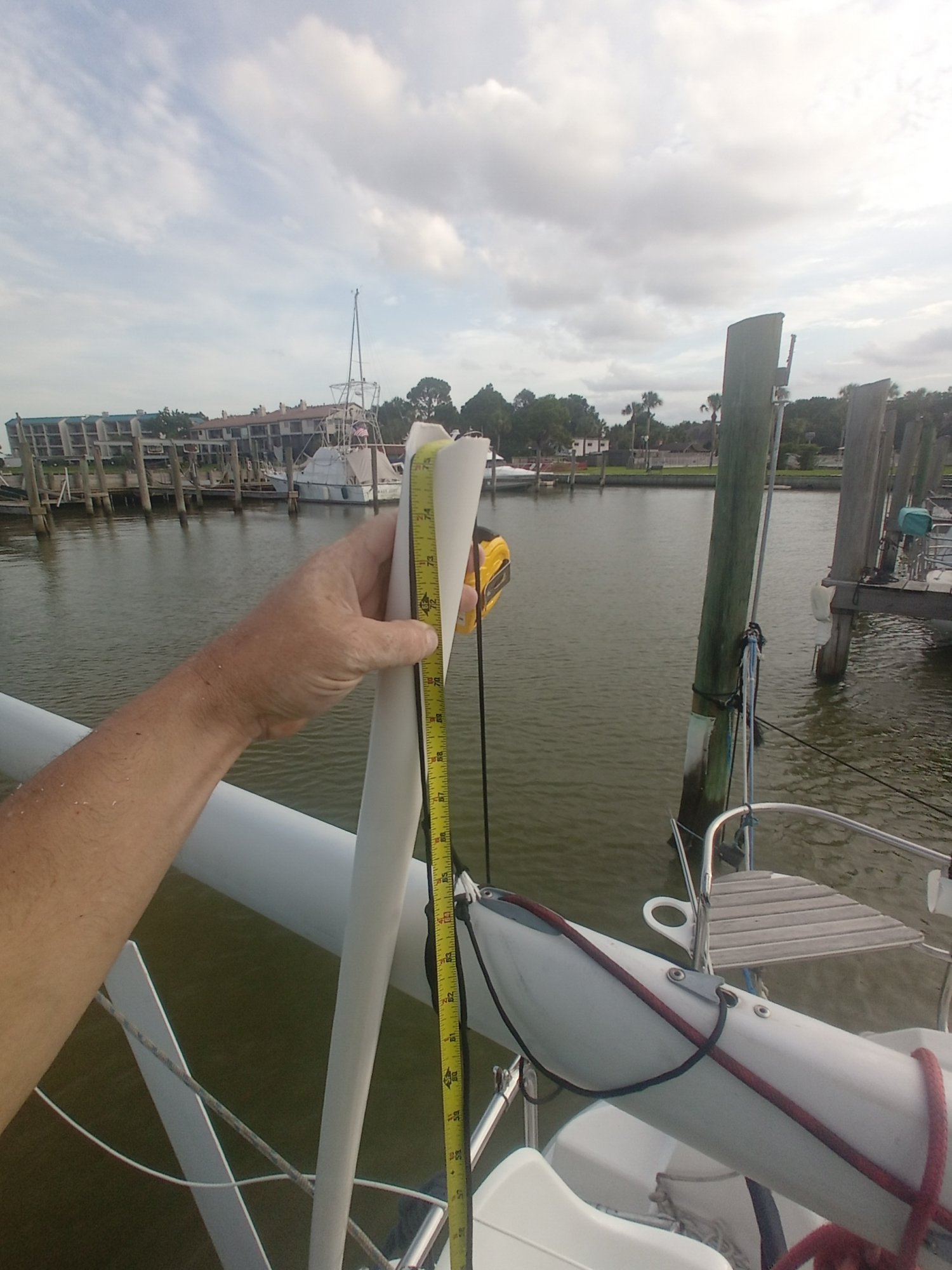

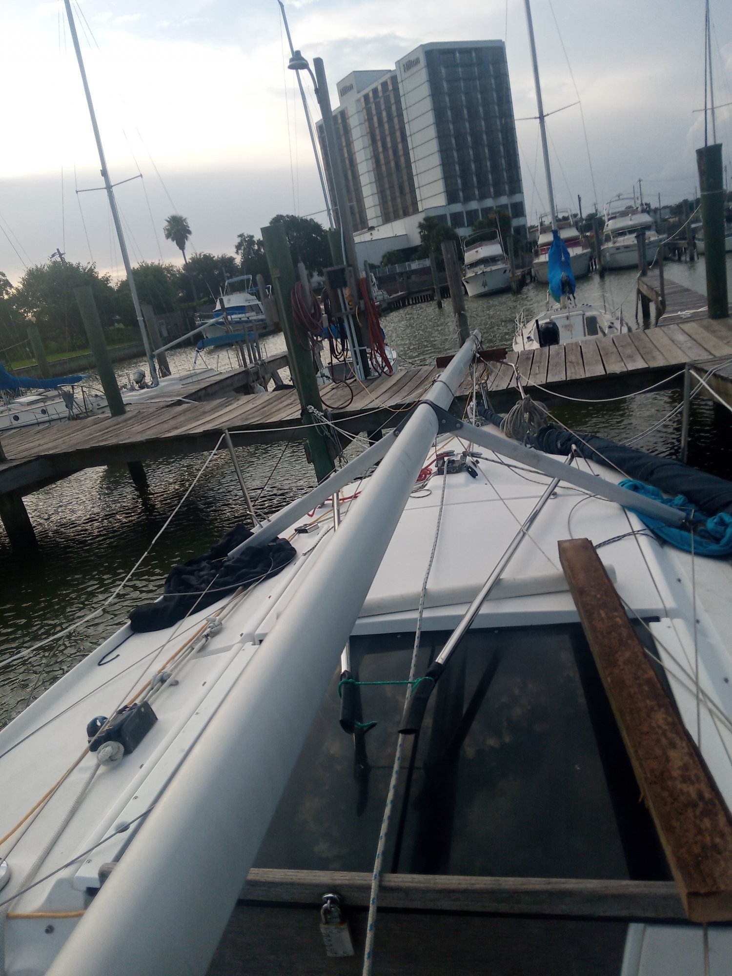

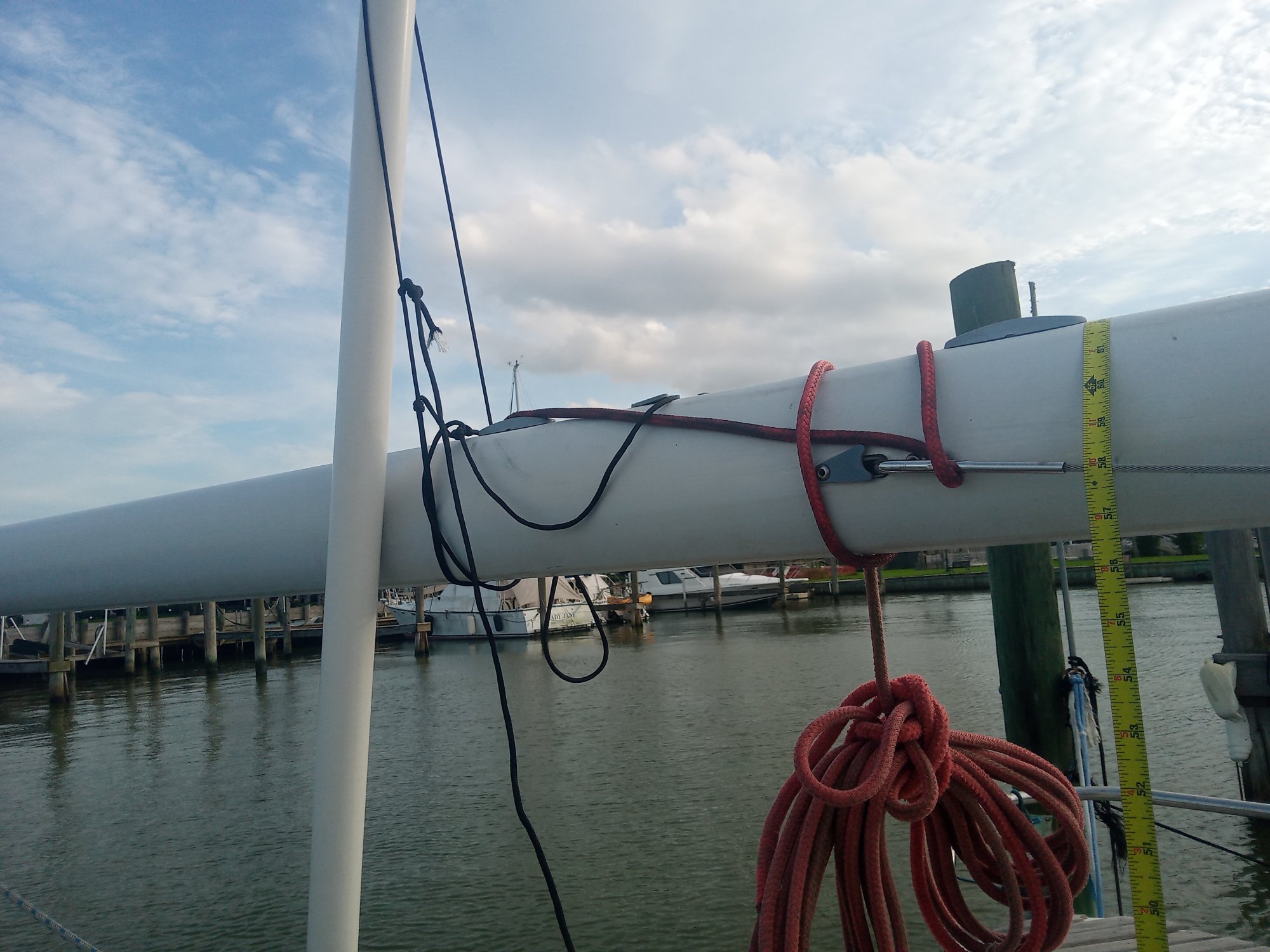

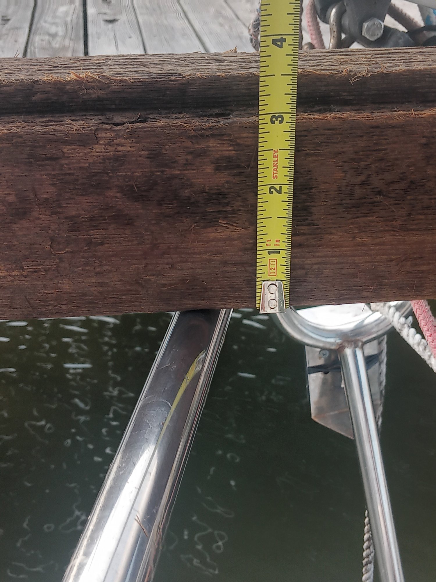

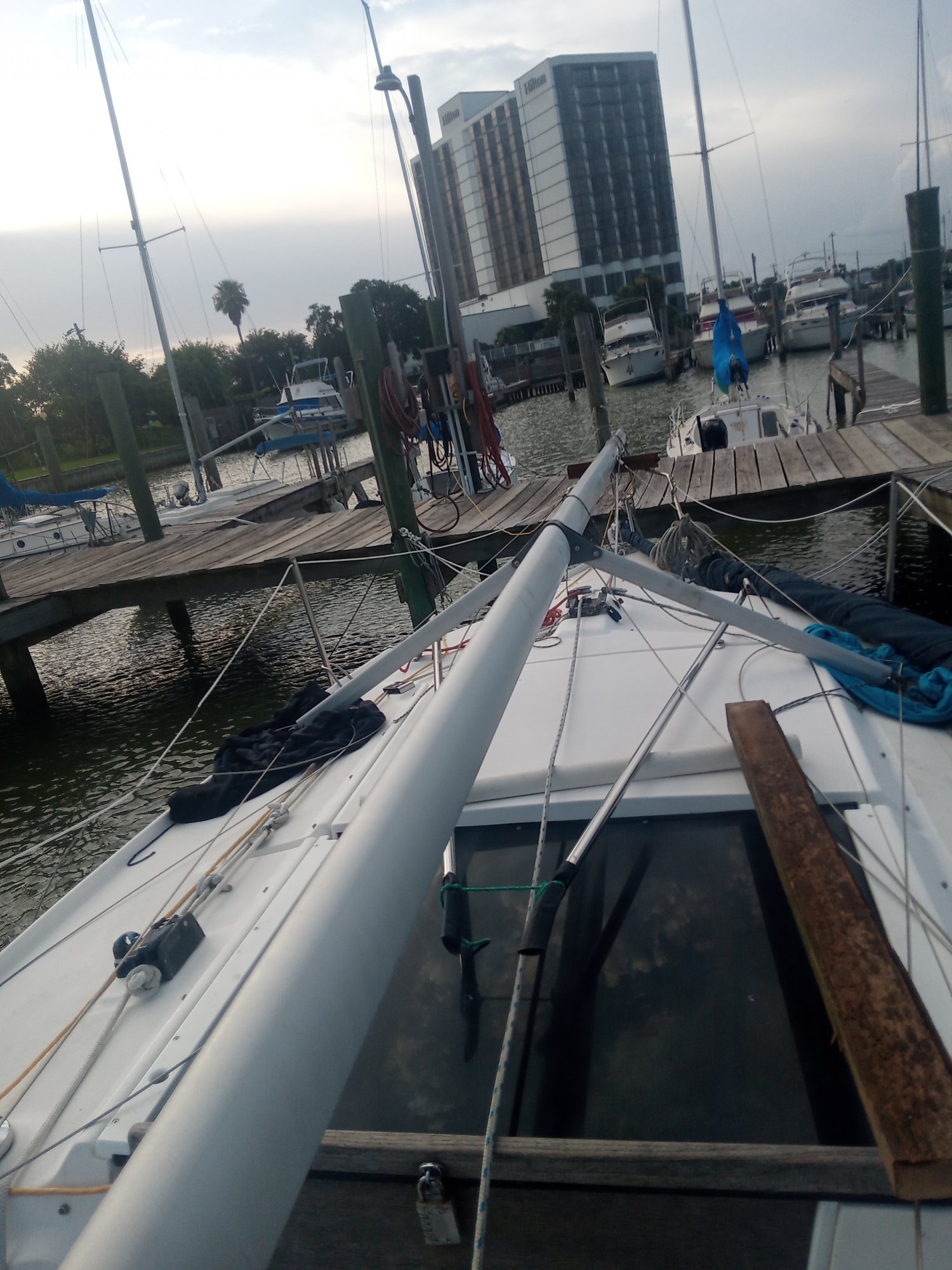

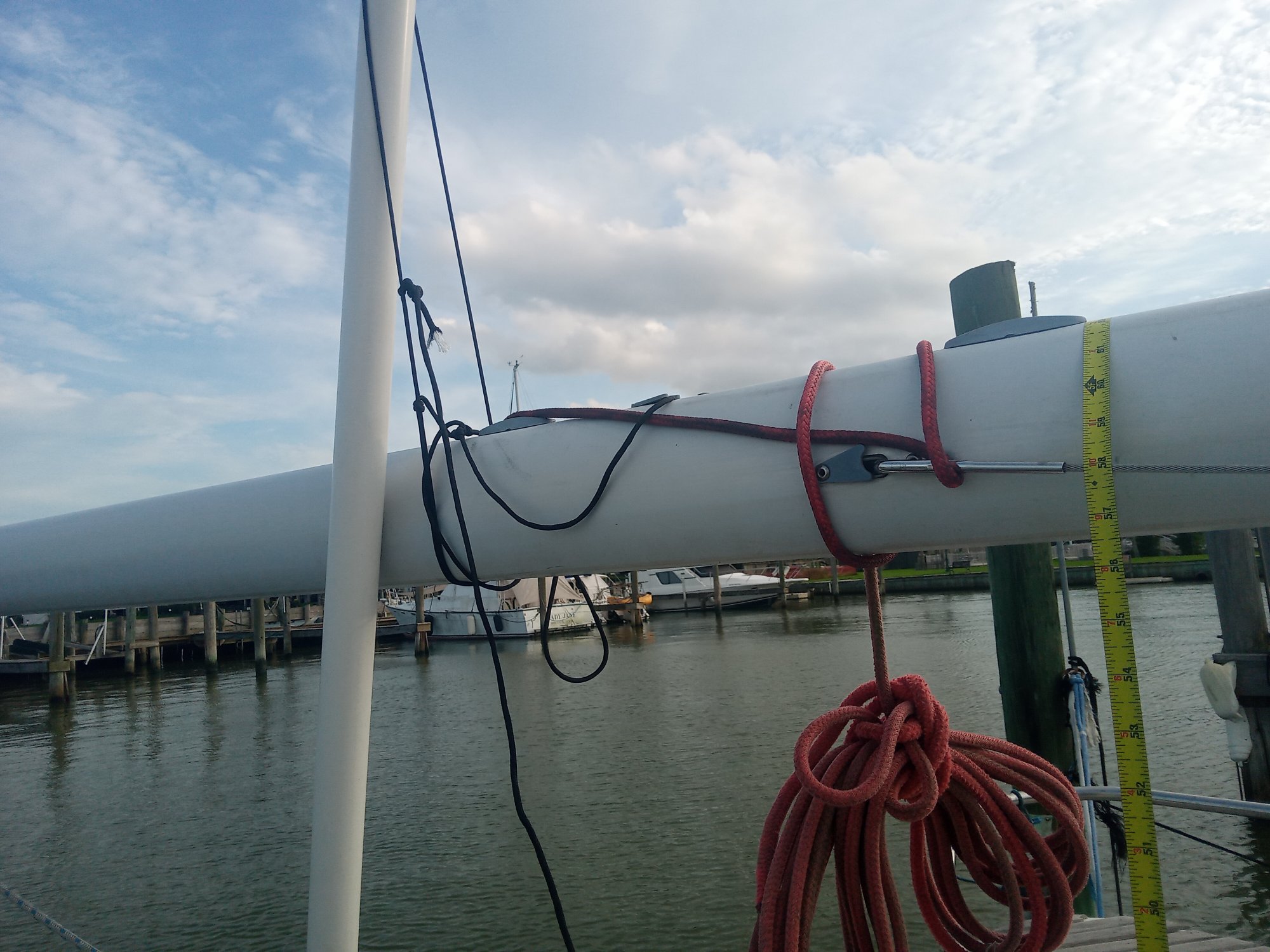

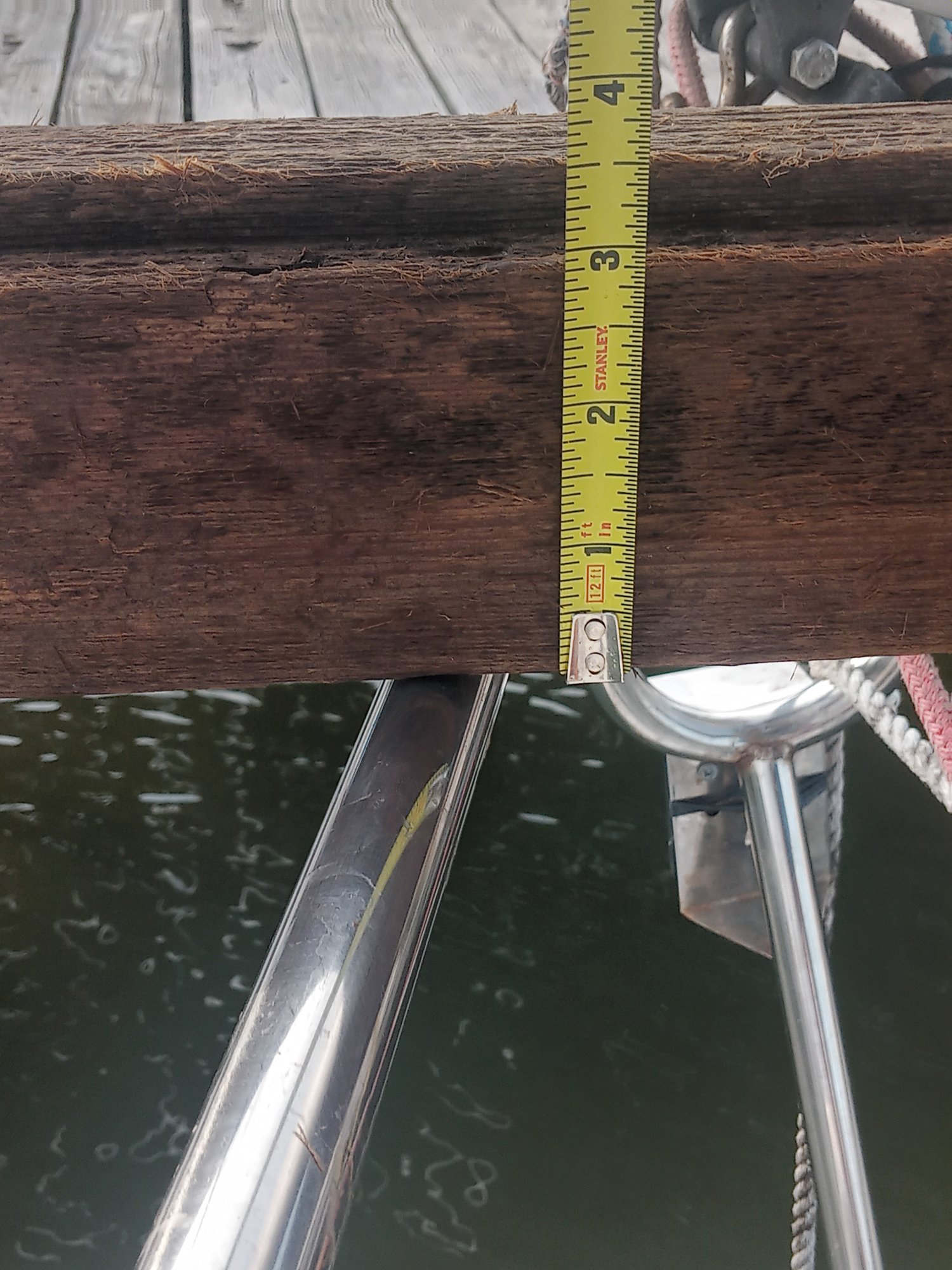

Yet more pics of LowRider h260 option.... That's all. Hmmmm. If I raise the front with another 4x4 the rear would drop 3 more inches... Mast crutch with notch is 90 inches.
