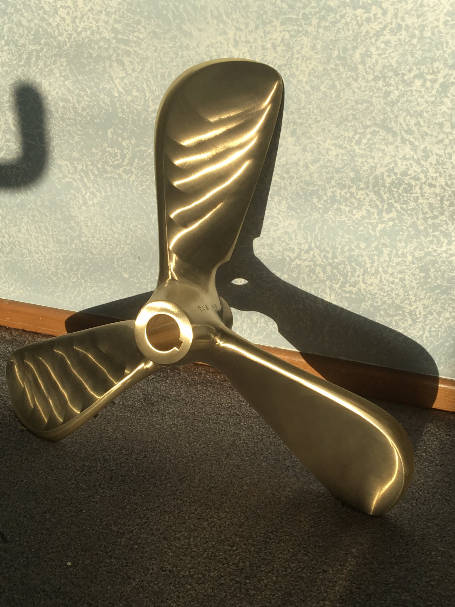

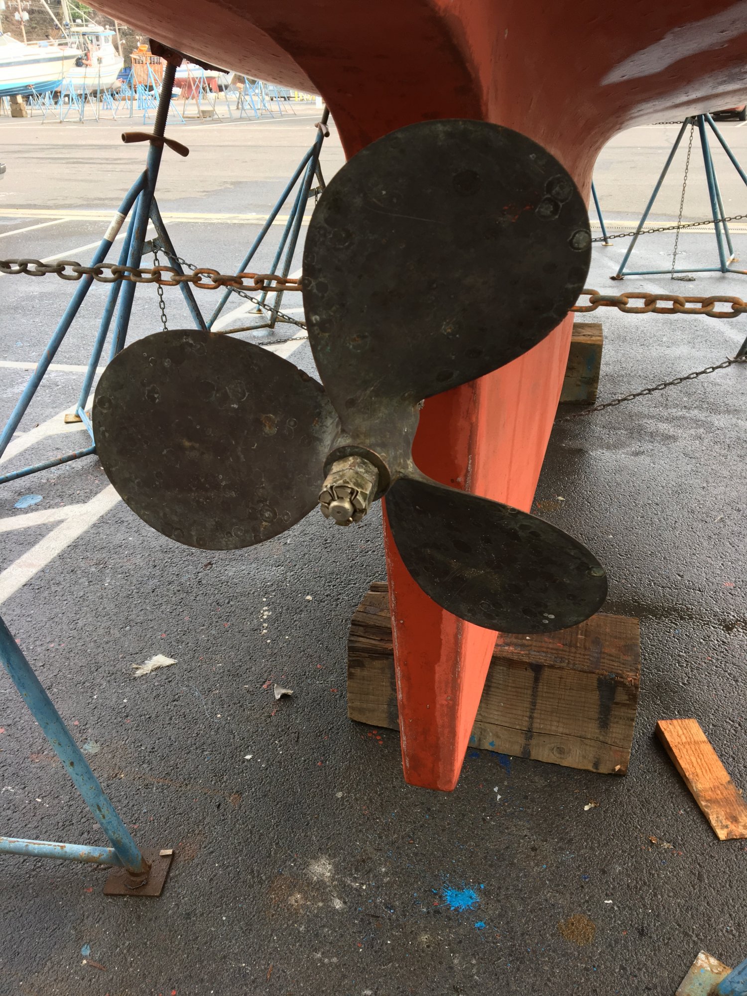

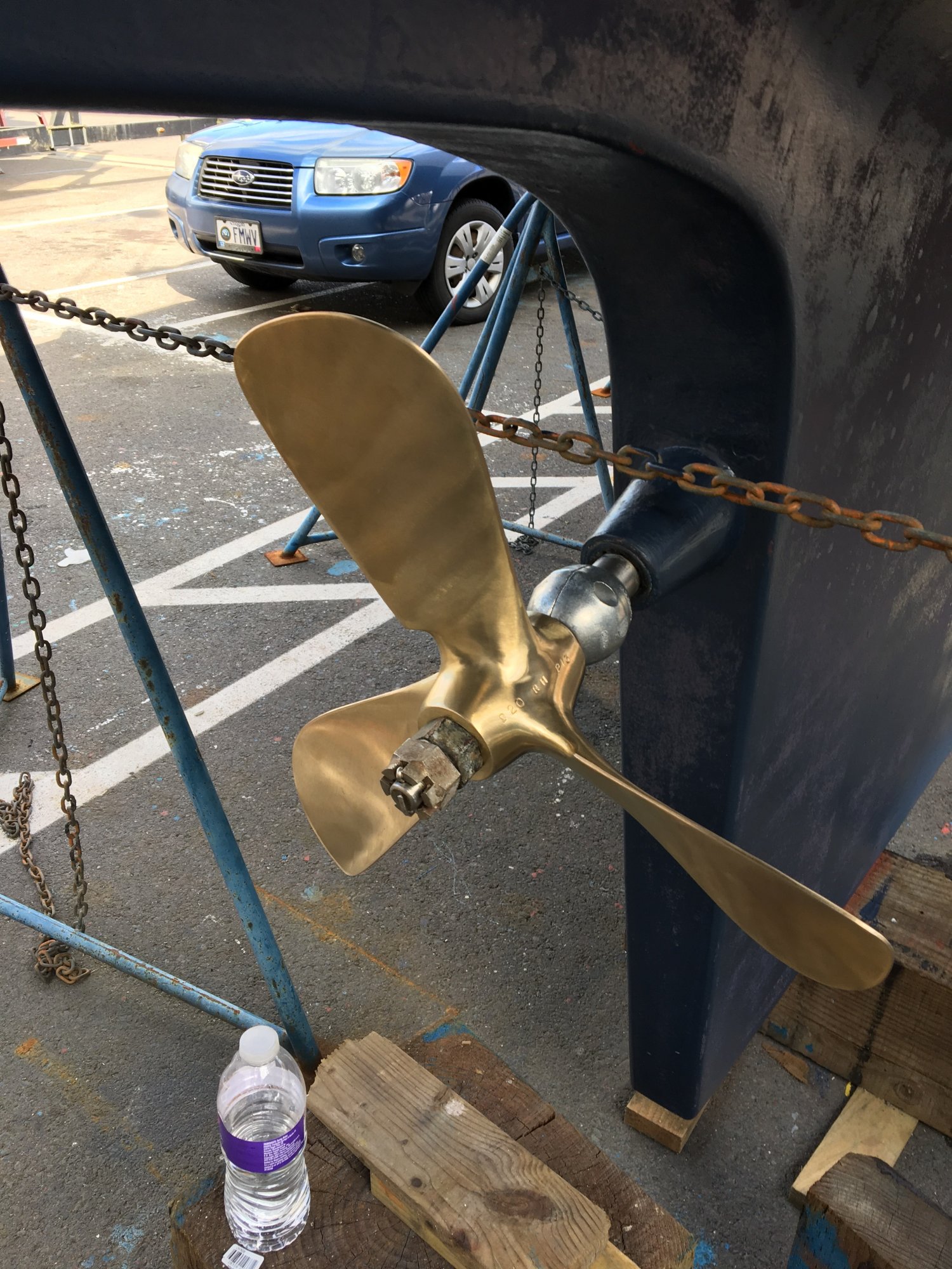

Your question was one I faced in the refitting my boat. I selected a Campbell Sailor 3 bladed prop from West by North. ( Home - West By North )They are located in British Columbia. It greatly improved my boat performance under auxiliary power and did not greatly reduce my sailing performance (when compared to no prop on the boat).
Here are the old and new. It is all about design, size and pitch to match your engine/transmission.
