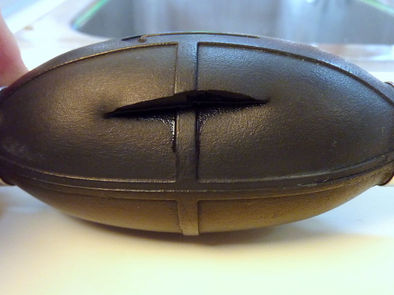

Just be aware that there are no fuel priming bulbs that meet the minimum USCG or ABYC safety standards for below deck use, unless one came out just recently that I missed. I have seen one split, on a customers trawler, and the stench was so bad & so permeated into everything he finally had to sell the boat at a huge loss. Beautiful boat other than the stench of diesel..
This was the actual bulb. Over a few week period it leaked nearly 75 gallons of fuel into the boat.....
Scratch that idea on the primer bulb! I had one on my previous boat for about 7 years without a problem & it definitely made priming / bleeding filters easier. Got the idea from a sailing rag about 20 years ago; however, if the bulbs are not compliant for below deck use, don’t use it. Thanks Maine for making that point.
