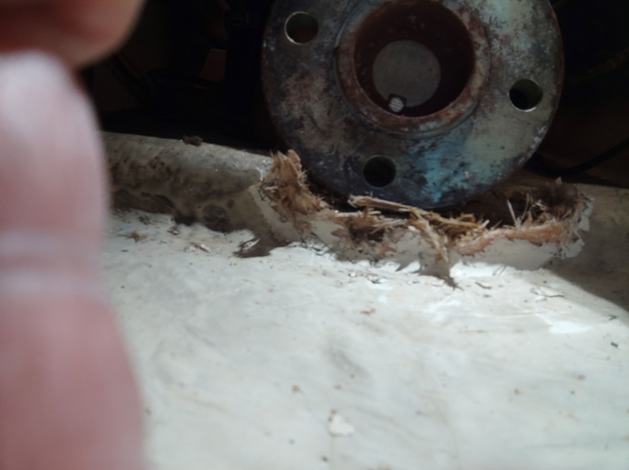

Mechanic took away my gearbox for repair 2 days ago. Had to chip away the engine bay fibreglass ridge in-order to move the shaft couple back enough to remove gearbox. Now there's exposed balsa core in the fibreglass. What can I use to water-proof the balsa core and epoxy up the ridge?
Jan 4, 2006
7,264
Hi Ken,
System three is what I have always used from glass repairs to waterproofing balsa core material. I think they're all just about the same but this one has an excellent instruction book that goes along with the material.
I've cut several holes in the hull and cabin structure. Any thru hulls are soaked with thinned epoxy to saturate the balsa before the SS thru-hull in installed.
See page 11 and do a search for "thinner" which is up to 10% lacquer thinner which gives the epoxy the viscosity of water. After the balsa is soaked, eliminate the thinner and the viscous epoxy can be used with glass cloth to build up the ridge.
The Cliff's Notes of the manual says to keep adding coats of epoxy once the under coat is sticky to the touch so you can move fairly quickly when it's warm outside.

Had to chisel off the ridge to move the shaft flange back so that gearbox could be be removed. I should have loosen the engine mounts and lifted the engine some instead but what's done is done :facepalm:
@Ken13559 , if you haven't started the repairs on the little dam, use a glue gun to set up a temporary retainer around the chiselled wood for the thinned epoxy and then pour the thinned epoxy to it. DON'T build up the original dam to its original height as who knows, someday you may be doing the same thing again and it's best to leave the engine alone once it's aligned.
Thanks for this idea. :thumbup:
