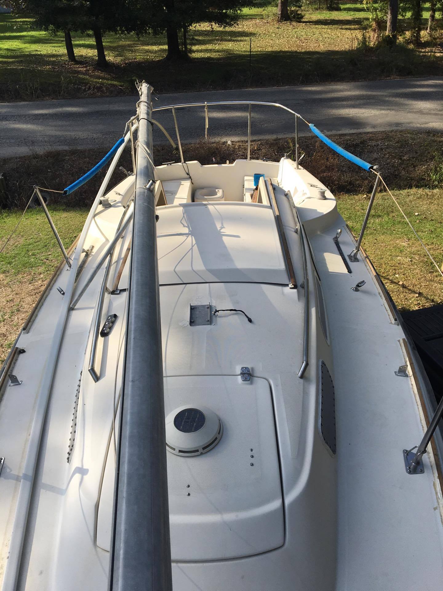

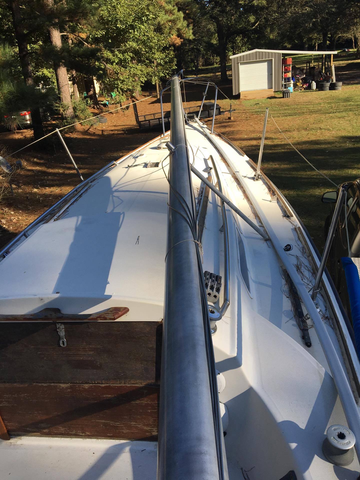

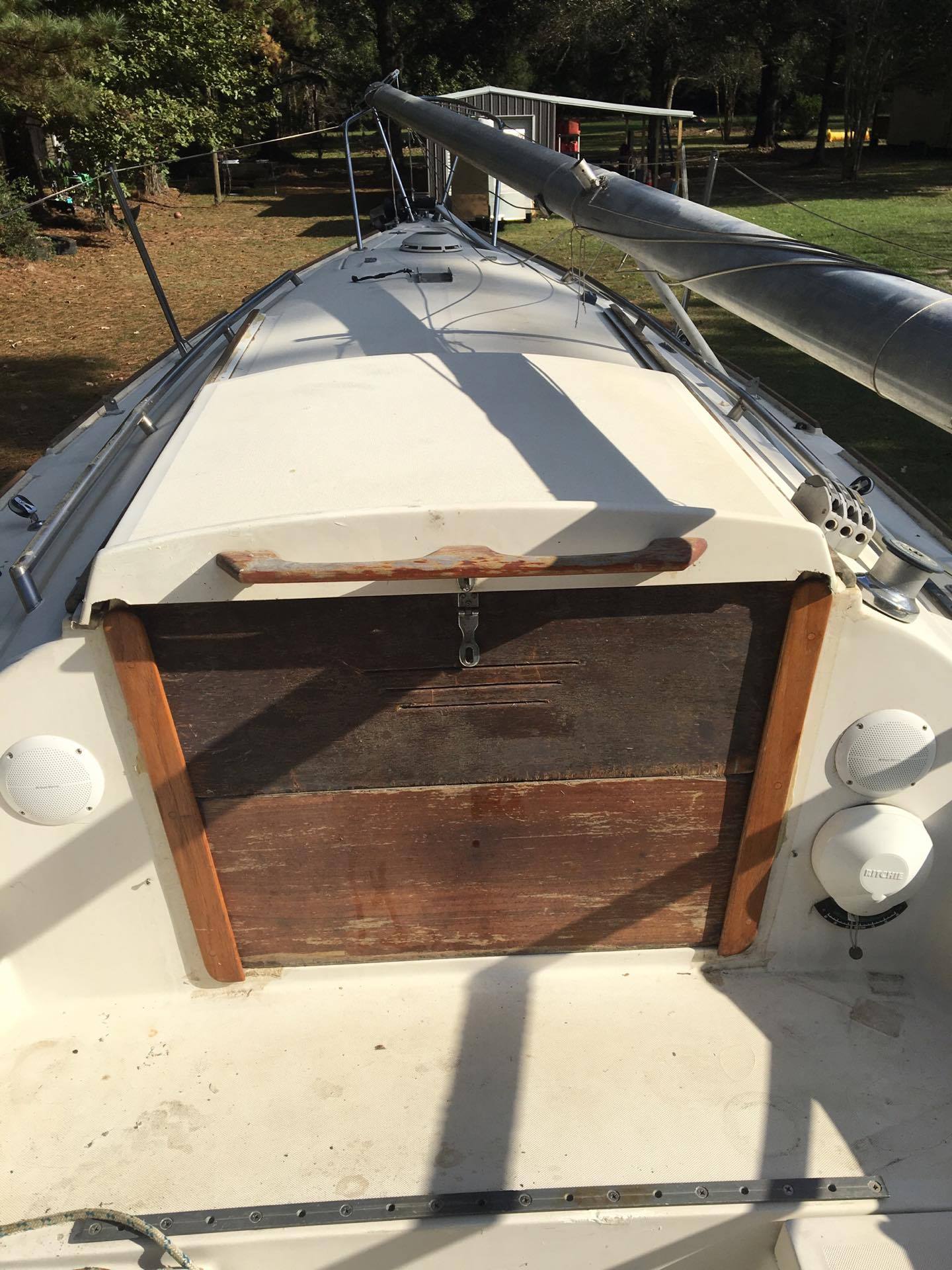

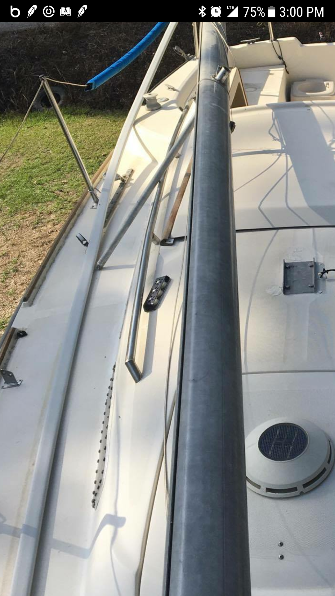

Im new to sailing going pick up a 79 oday 28 this saturday i was wondering if theres a detaild rigging diagram somewhere or a video showing how exactly to rig the boat i am also wondering weather this boat is self bailing and if not where would the bilge be located . Also in the picture i posted it looks like theres a bracket with 3 pullys can anyone tell me what they are for theres a spot directly across on the opposite side of the boat that looks like the same kind of assembly was bolted there but isnt there now. Any info is greatly appreciated

We have owned 3 Oday sailboats over quite a few years. (Actually, more years than I care to think about passing!) Never owned an Oday 28, but a 272 and an Oday 30 might be close enough to allow me to comment. The deck turning blocks in the picture are for separating the various lines that come from the mast toward the cockpit. There should be winches aft of them for use with the halyards. Halyards and perhaps reefing lines and a downhaul could go through those blocks. The lines would need to turn aft at the base of the mast. There should be some blocks there at the deck level or perhaps attached to the base of the mast. Same deal on the other side.

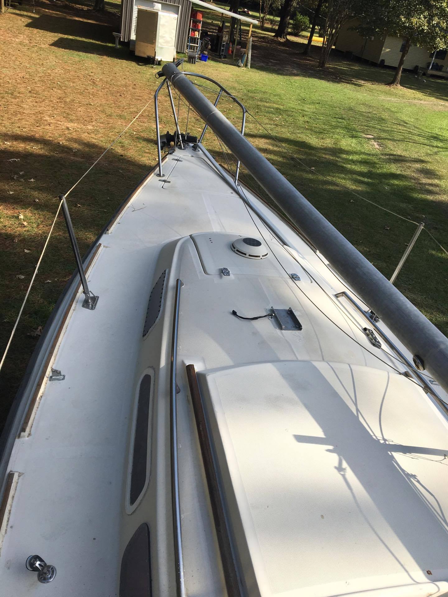

A couple of things that catch my eye in the picture you posted - (1) there seems to be some kind of irregularity in the deck around the mast step, which could mean wet core and some repairing; (2) one spreader is attached to the mast but the other isn’t in the picture - is it missing or damaged?
An O’day 28 is definitely not self-bailing. There is a bilge below the floorboards in the cabin. I don’t know if there are any videos about rigging the 28 specifically, but it’s a pretty standard rig so nothing too different from a lot of other masthead rigged single-spreader boats. 31Seahorse is right about the purpose of those turning blocks, but they’re in a strange after-market place. I don’t know how you’d be able to run a line cleanly from the mast through them to any winch.

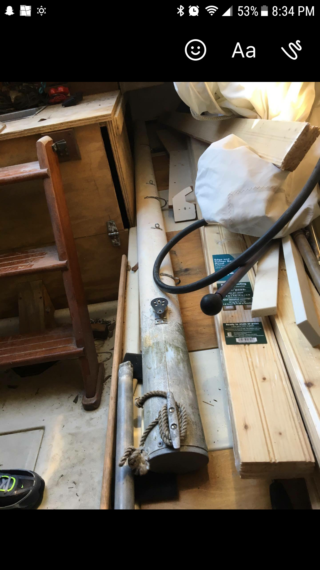

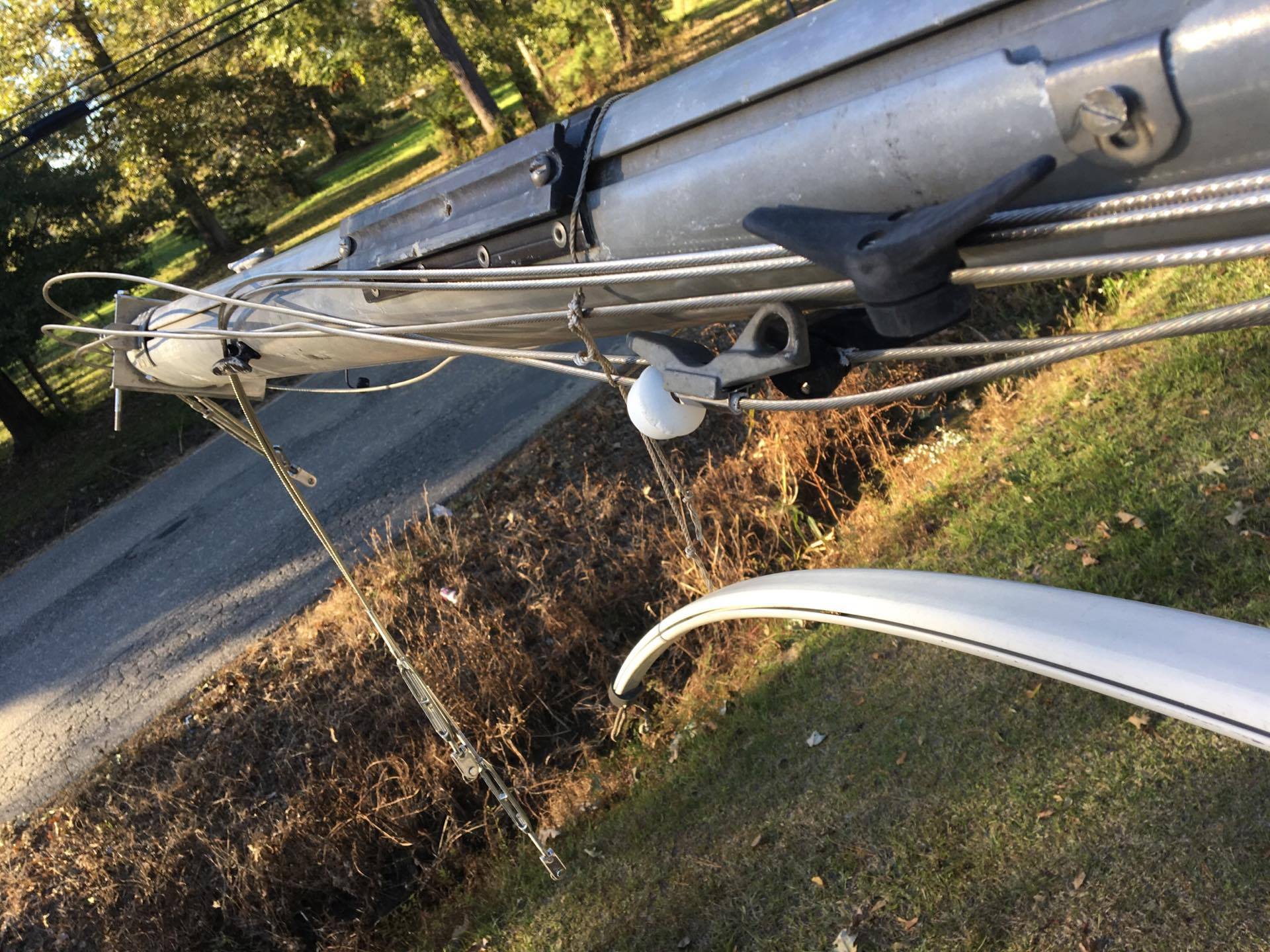

I think the other spreader comes with the boat I believe it's in this picture looks like it must be damaged is this a big issue or can I just weld it back on with a strong back and be fine? I would love to bring a sailor with me to check out the boat that would be ideal but because I live in a place where there are no sailors I won't be able to do that I will definitely check out that guy Rudy though if he knows as much as you guys say they are maybe he can fill the gaps on any other questions I may have thanks again for all the help to everyone.

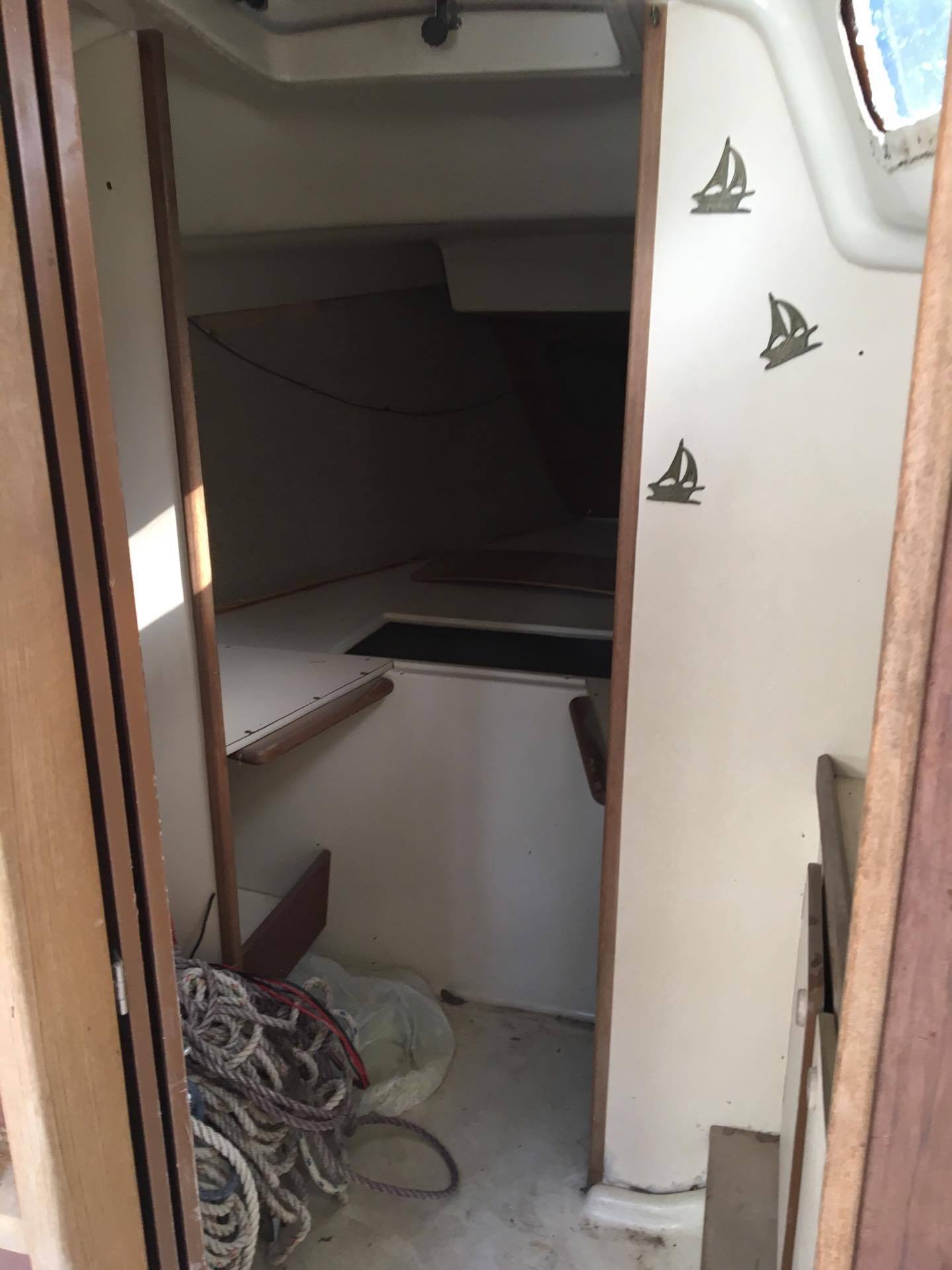

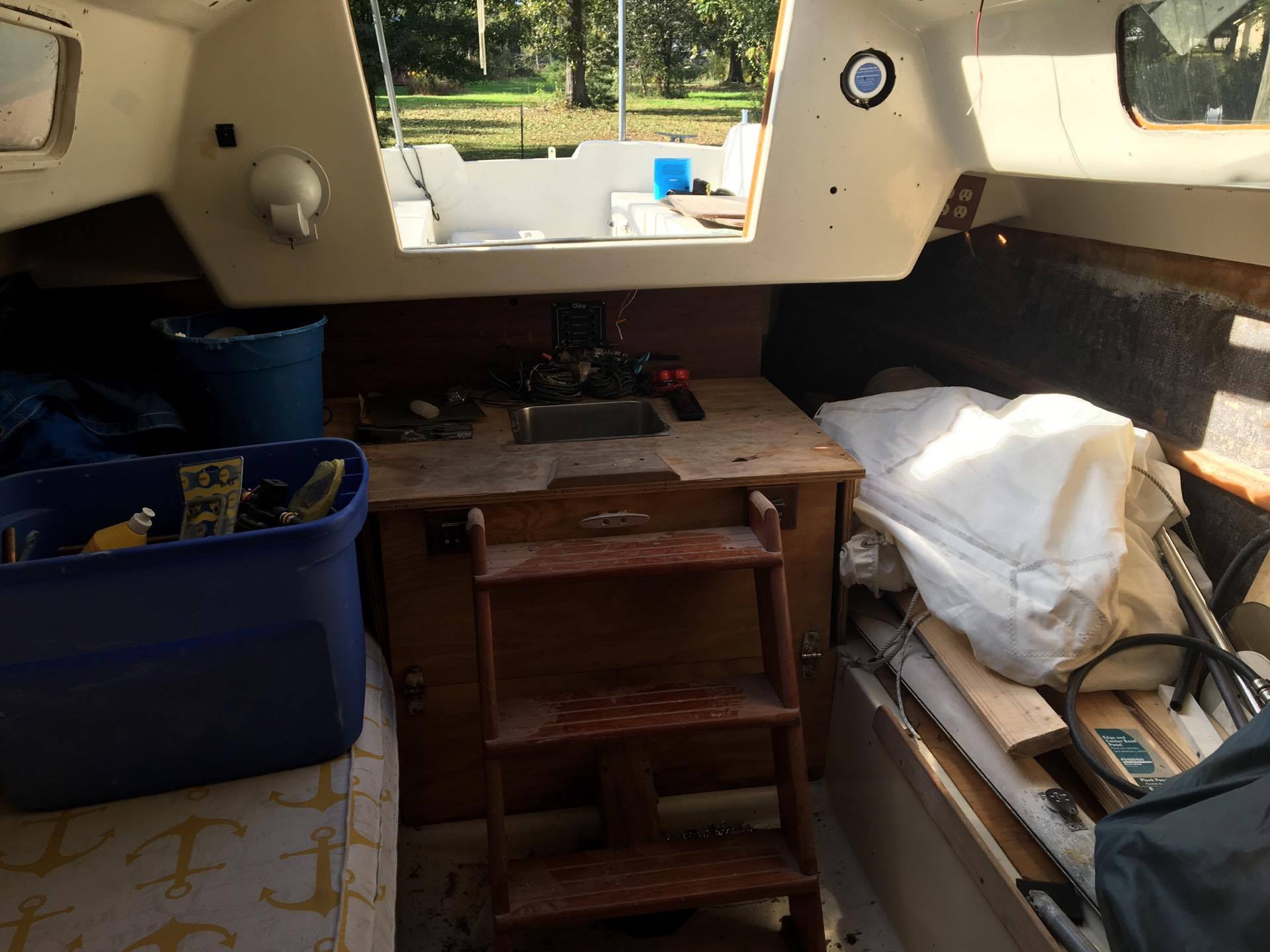

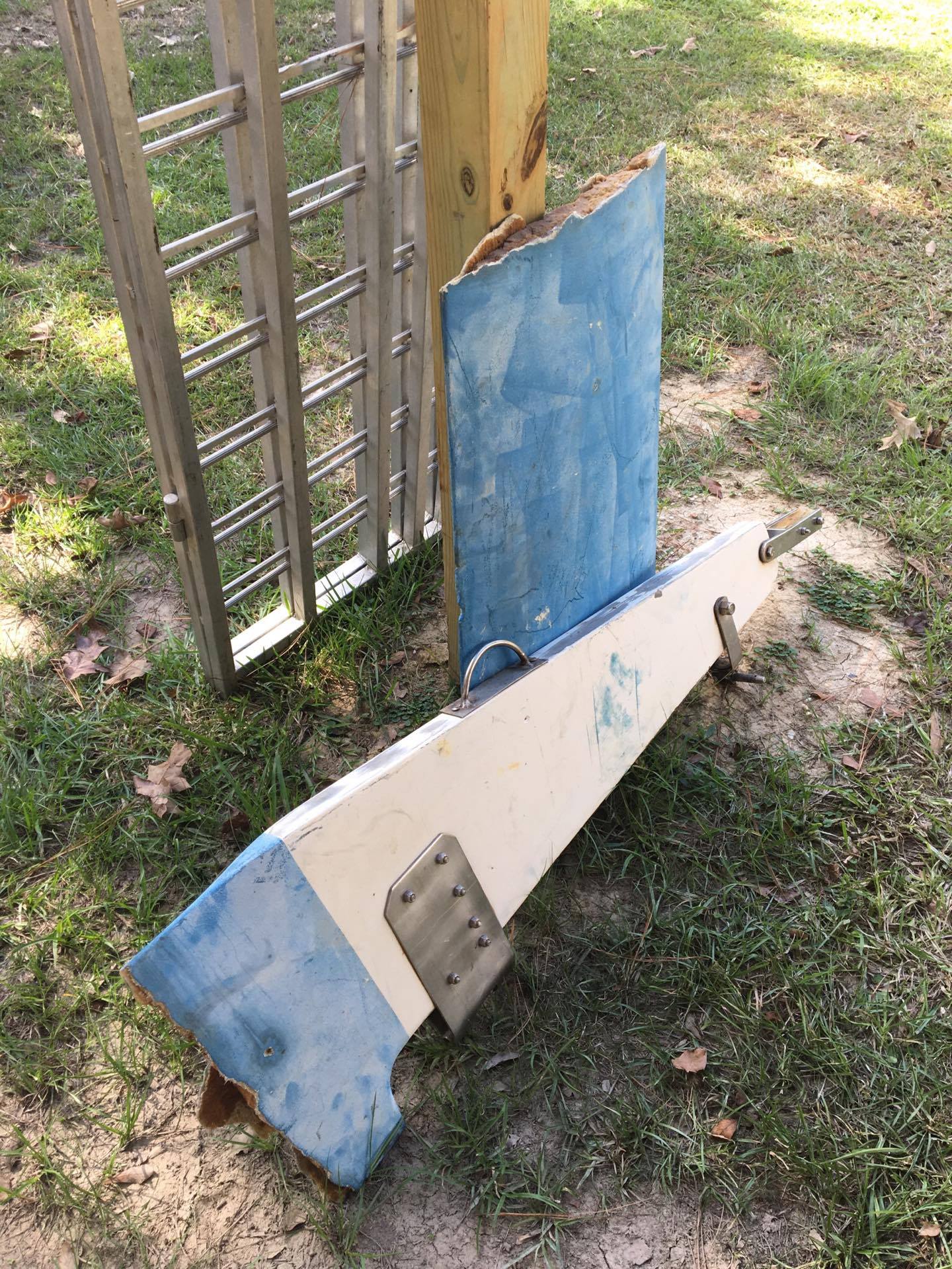

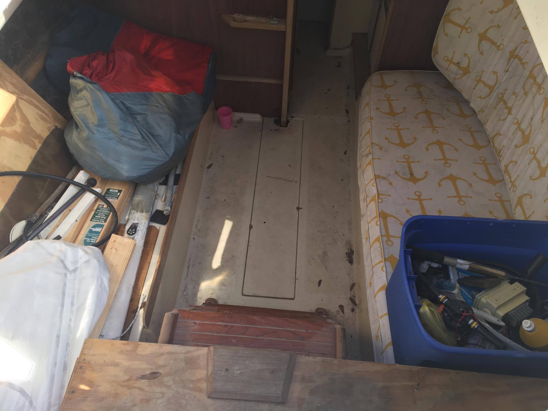

This is almost all the pictures I have of the boat feel free to let me know if you see anything that is not right. I also forgot to mention that the rudder is broken in half but he is giving me the old rudder so I was planning on taking measurements off of it and either making a wooden one or an aluminum one and using the hardware from the old rudder

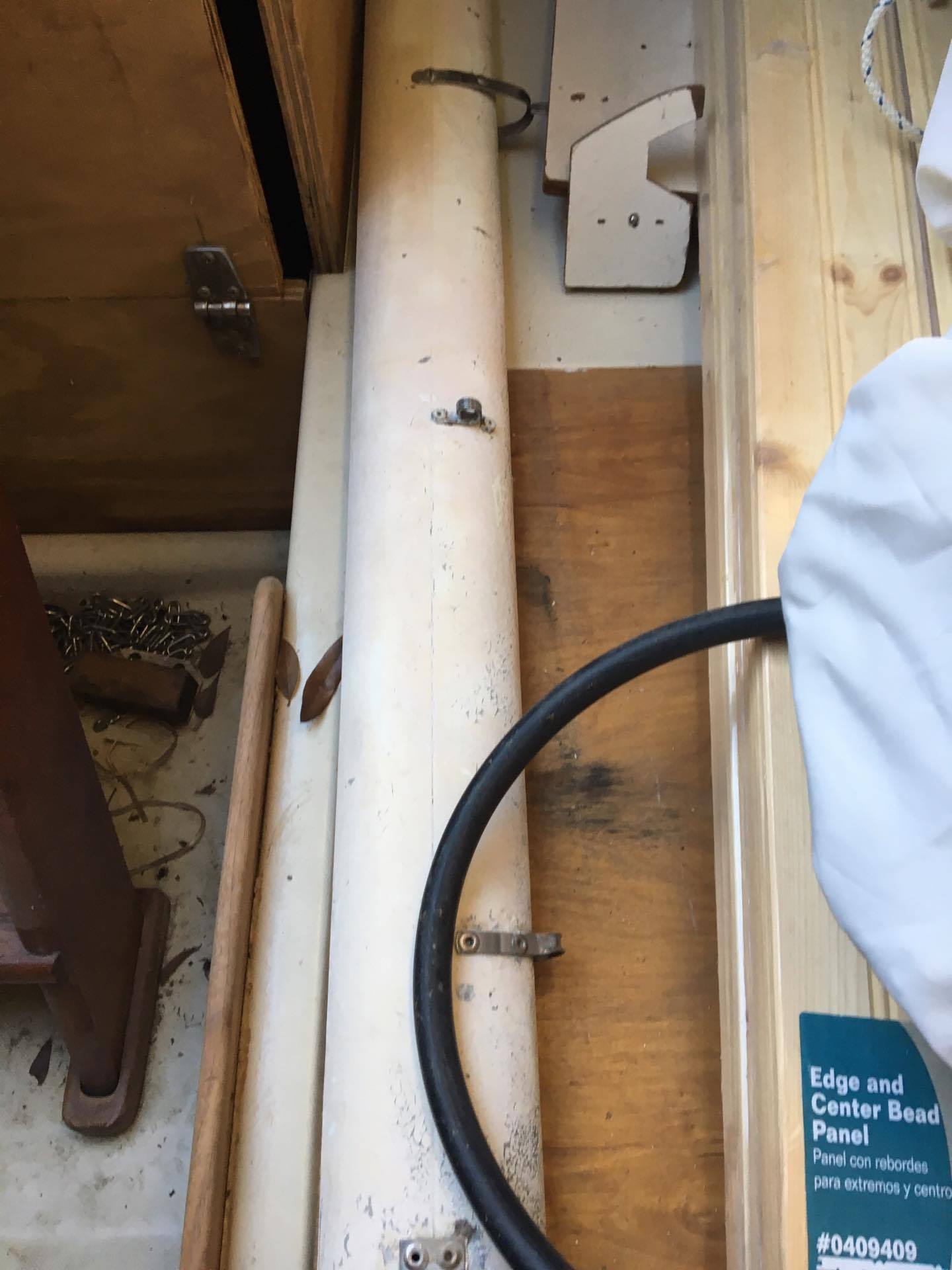

At first glance there are several (many) changes to the interior. More repairs and finish work are necessary, I believe. The boat seems to be outboard motor powered due to the motor mount on the port stern. That will limit the number of through hull fittings that might be in the hull below the waterline. Check the areas under the side bunks, the v-berth, the quarter berths, and under the galley cabinets for the location of any such fittings. Each that you find should have a ball valve type shut off just inside the hull. Gate valves with a round twist open/shut handle is not an ideal valve.
If this boat was not used by the current owner you should ask "why". There is always more work to do than you think there is at first glance or visit to the boat. Ask yourself whether you are willing and capable of the repairs and finish work. It is a project boat. (As most older boats are.) Is the trailer road capable? Tires, wheel bearings, brakes on at least one axle. It is often more difficult to stop a boat on a trailer than to pull it.

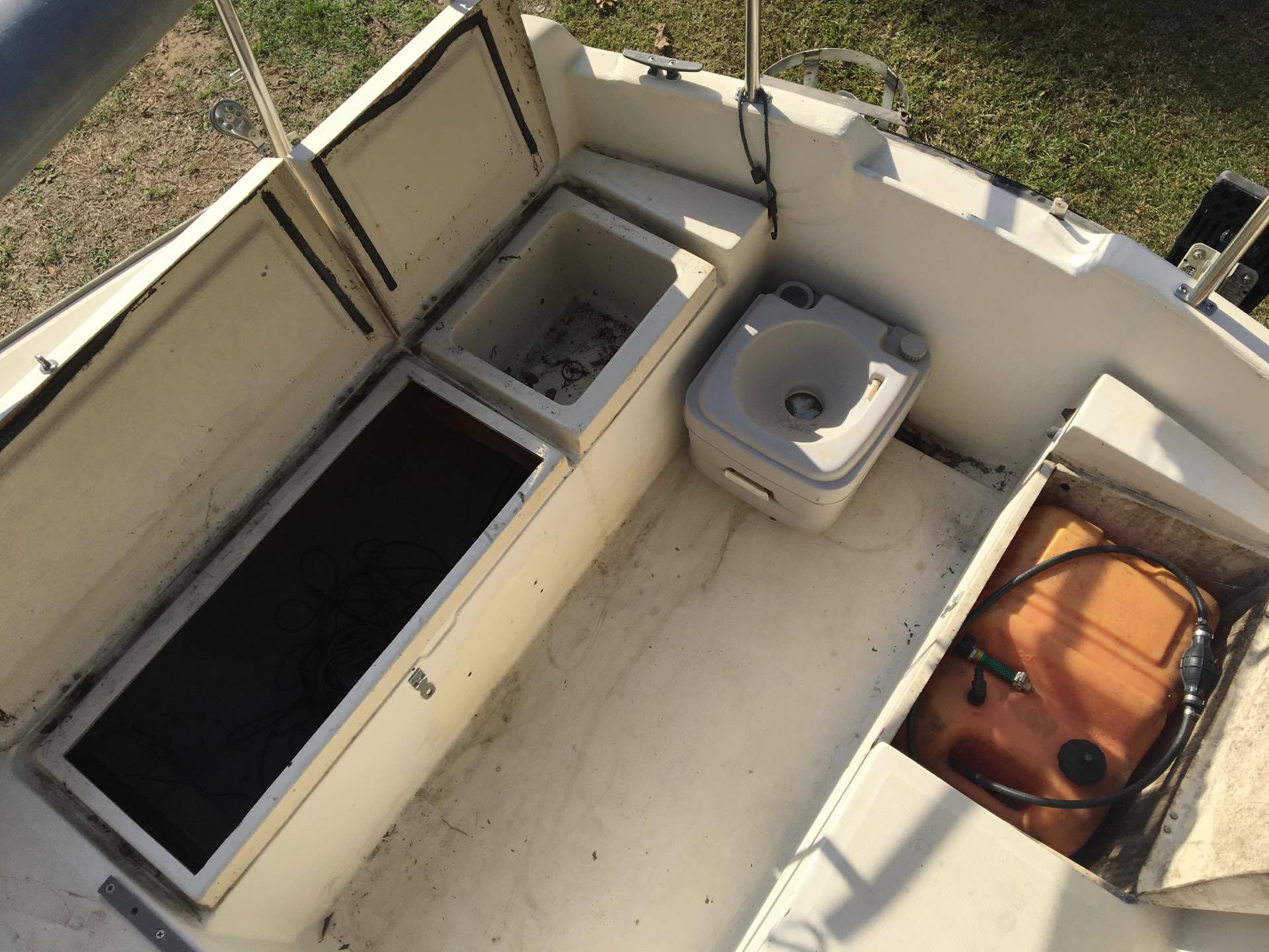

The cockpit and galley look all wrong for an O'Day 28, but look just like my 1976 O'Day 25. The rudder on the O'Day 25 is stern mounted on the O'day 28 it is keel hung with a penetration through the cockpit deck for the tiller.
The toe rail looks like it is modeled into the deck capped with teak, is that on newer O'day 25s?

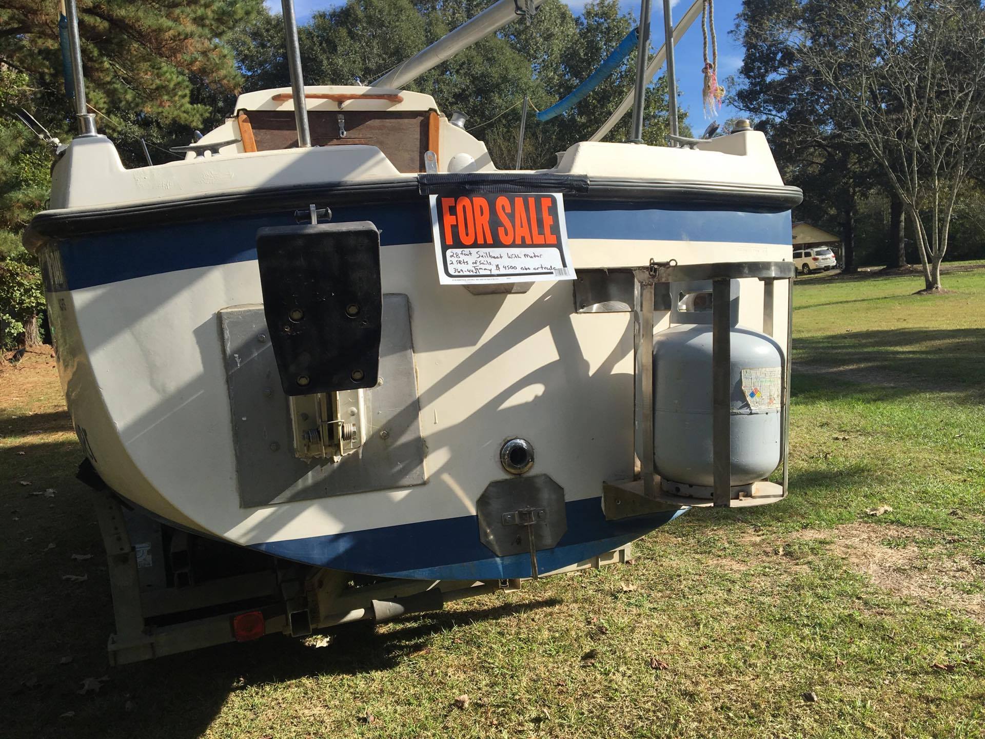

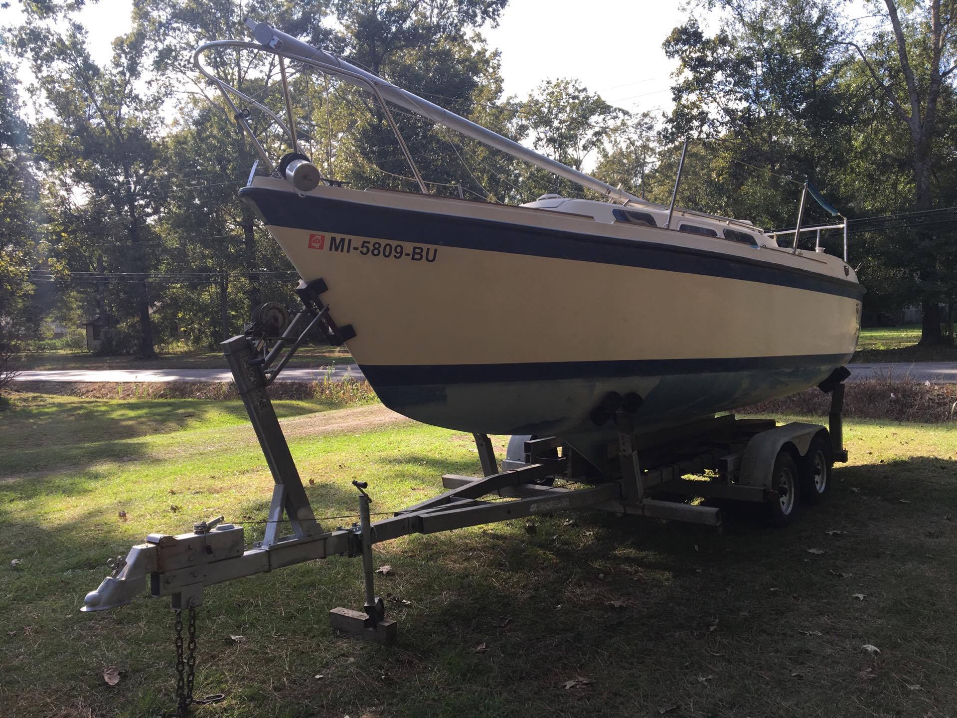

I will definitely check all those things before the papers get signed the guy says supposedly the trailer is in good shape I will check that also. Not too worried about hauling it beings I own a big truck that's not a big deal for me here's another picture of the stern if that might help identify what this boat actually is

I agree with the others that it’s not a 28. 25 looks about right. As has been said it’s definitely a “project boat”, so be sure you’re willing to put in the work and that it’s priced accordingly.

That is a 25, $4500 is an ok price but sure looks like not in ready to sail condition, especially the interior. The bulkheads are almost certainly rotted at the chain plates. What are the numbers under the blue strips at the side?
Rudy want over $1k for a new rudder, or Rudder Craft has some nice options.
http://drmarine.com/products.asp?cat=182
https://ruddercraft.com/index.php?route=product/category&path=53
I paid $2,500 for my 76 and it was ready to sail but still had projects to fix. I'd peg the trailer value at $1,500 - $2 if it has new tires, brakes and needs nothing. That said I'd be going at least a grand cheaper then his asking price, that interior is a mess, the extra plates on the stern are concerning that they were patch to fix a rotted transom as others have reported is an issue.

Yes I realize this now I spoke with the current owner and we have confirmed that it is a 25-footer
