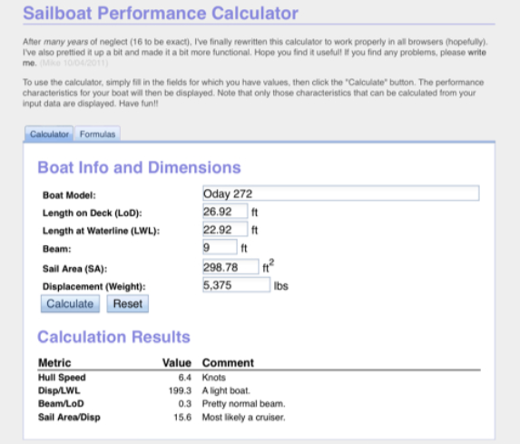

The NOAA table of distances at https://nauticalcharts.noaa.gov/publications/docs/distances.pdf puts the trip at 151 miles, more or less depending on exactly what parts of those ports you’re going between. I don’t have experience with a 272 but do with a 28 that had an inboard 10hp diesel. Though hull speed on the 272 is in the low-mid 6’s I wouldn’t figure on averaging more than the mid 5’s. So my estimate would be 25-30 hours of travel time.
