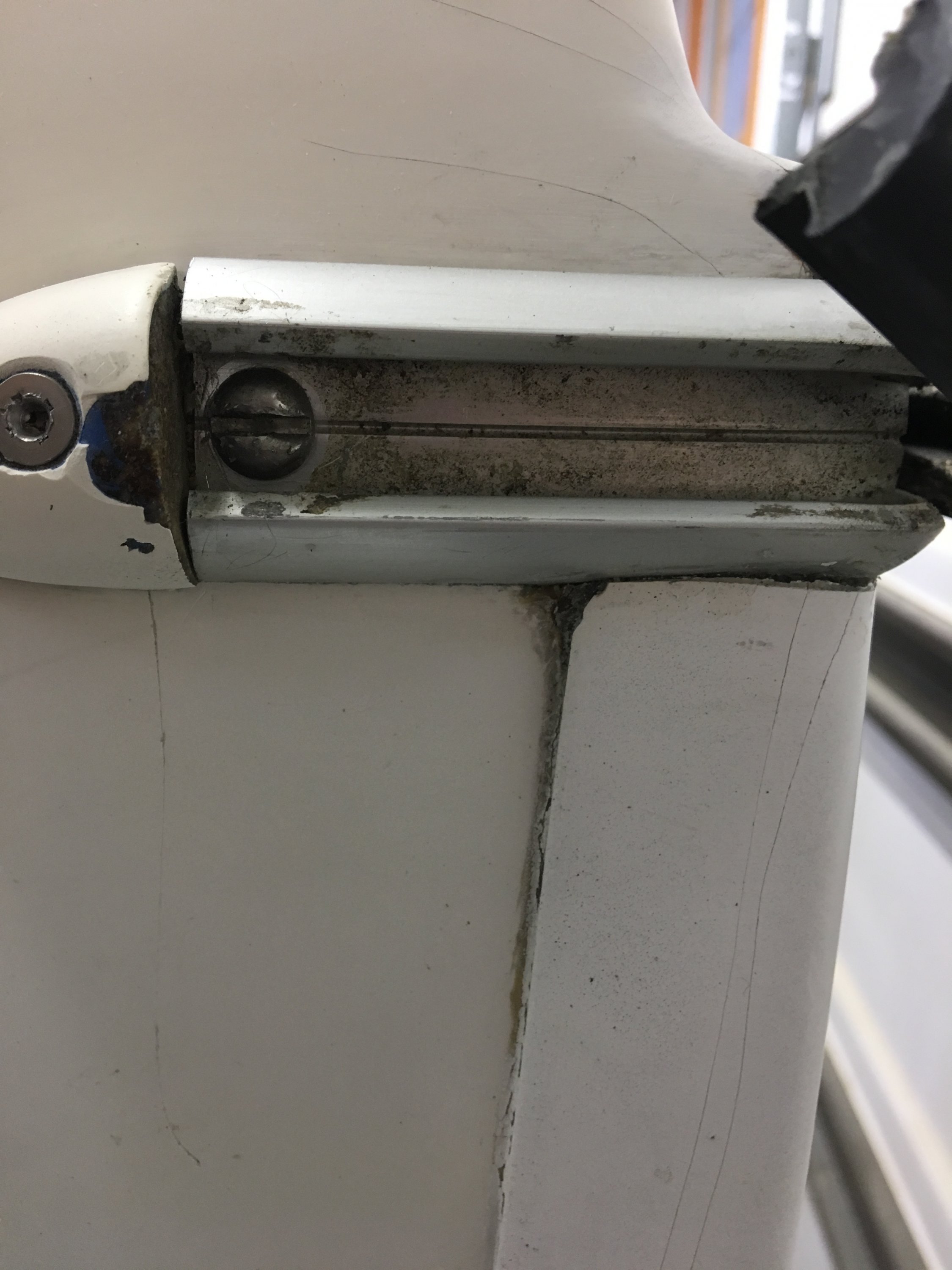

The first photo shows the stern at the motor well with the rubber insert pulled away.

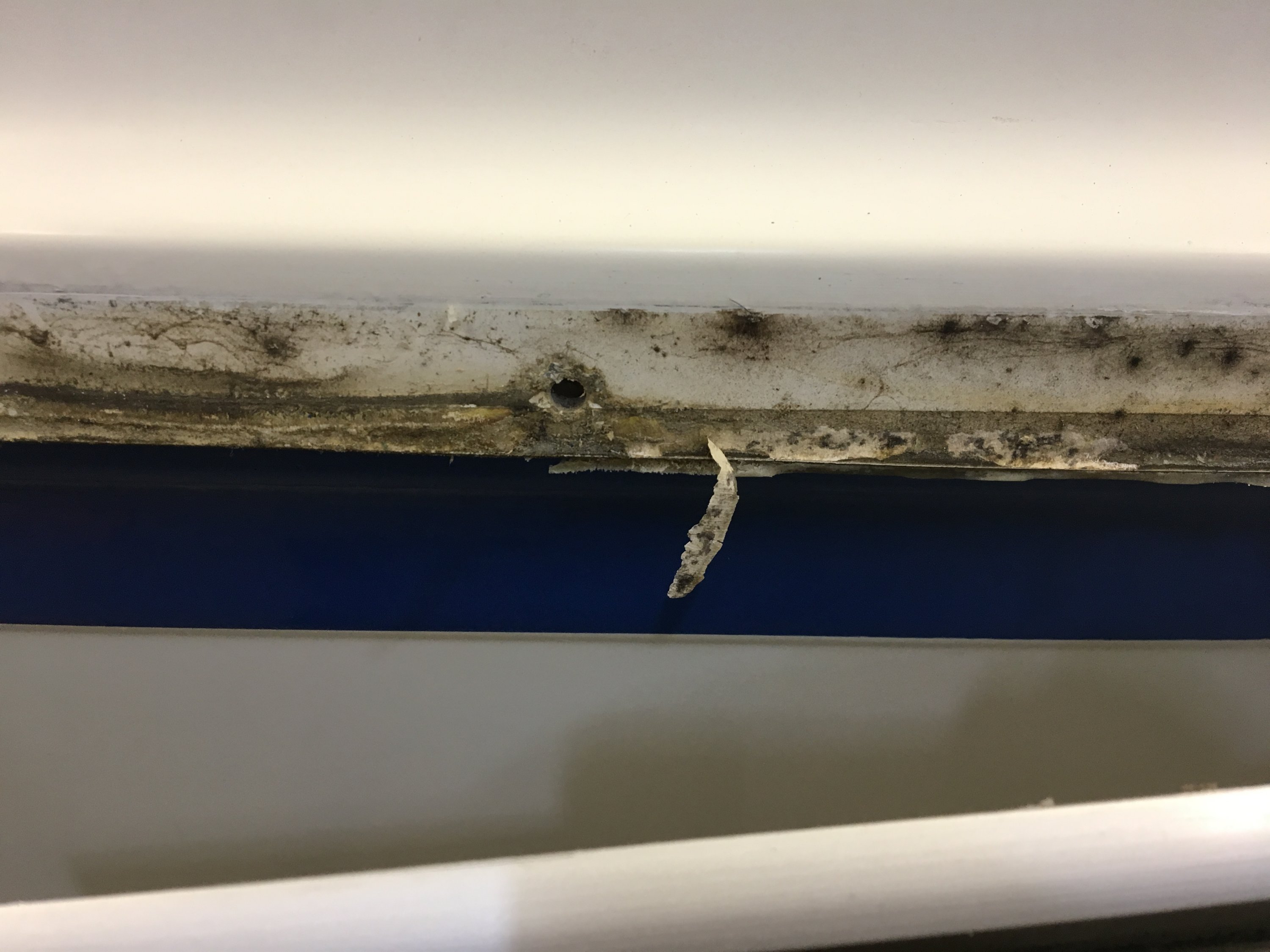

The second photo shows the aluminum rubrail extrusion pulled away showing the remnants of the original sealant and the filth that built up under the extrusion over the years. Silicone will not stick to the filth and form a seal.
I also could not find a source for the rubber insert that has age hardened.

You need to clean the 'filth' off no matter what and need a clean surface to work with. I'm not a fan of 3M 5200 as it is 'so permanent' but would use it under the trim in this case and believe others have used it also. Chances are you won't ever be pulling the aluminum off again. 5200 might of been what the factory used in the first place???

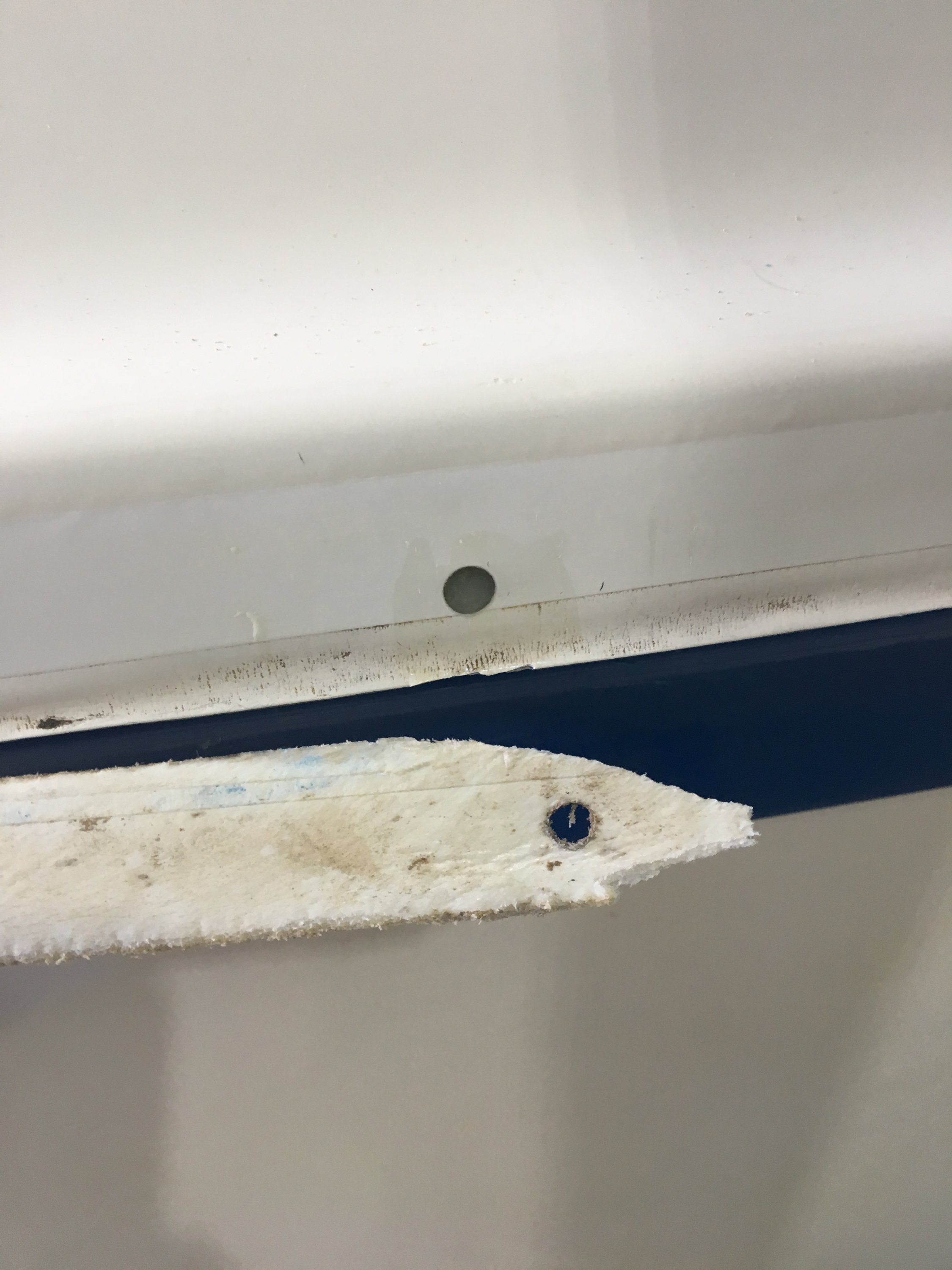

Sumner, the filth is gone from from the area where the rub rail attaches. I have also filled the holes in the hull where the old aluminum rubrail was bolted through with epoxy.
The white strip is the thin white foam removed from between the top and bottom hull parts where they were joined with the attachment of the rubrail.

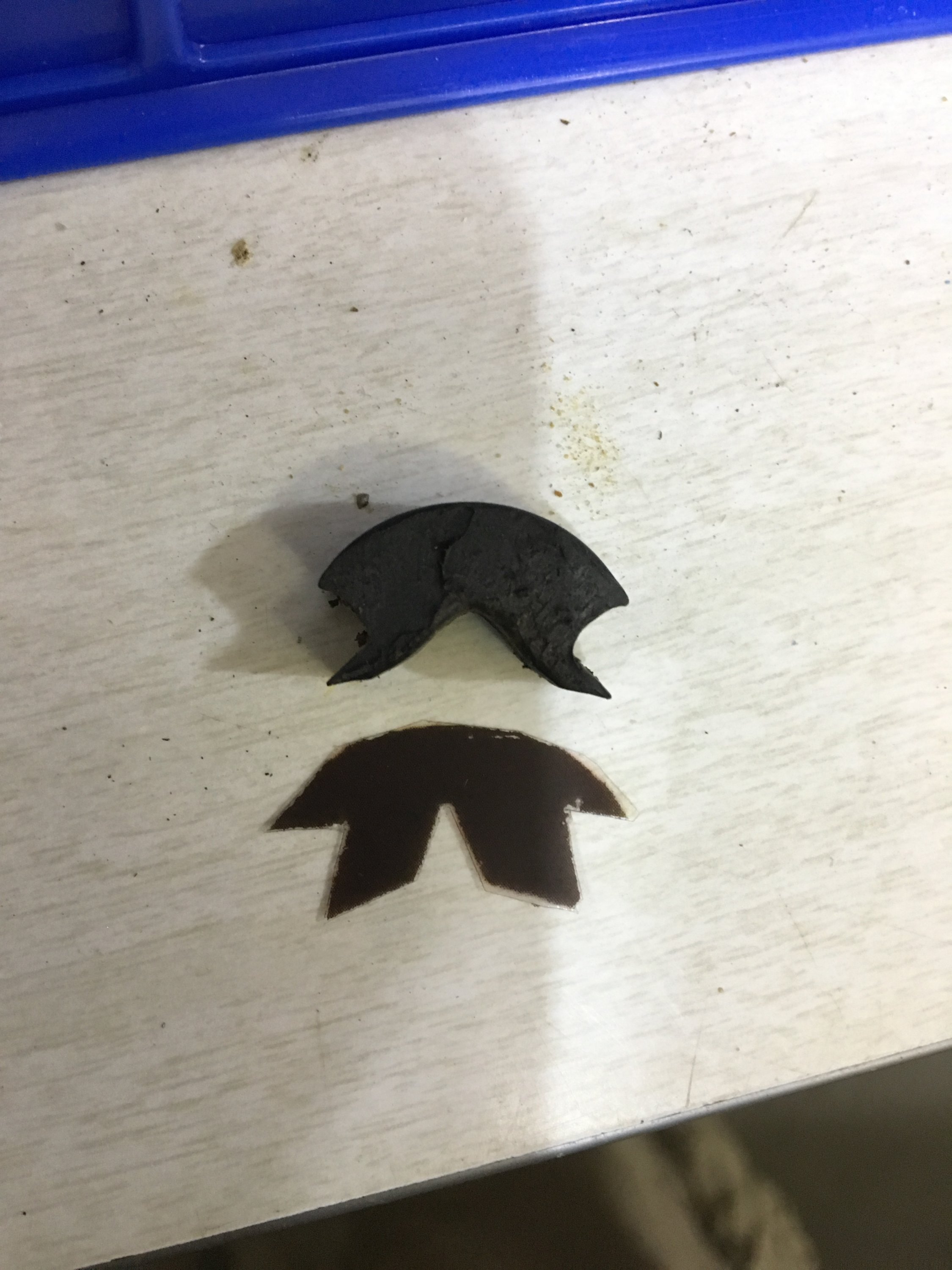

The top piece in the above photo is a section of the removed rubrail insert. The piece below it is a cutaway of a drawing from Wefco Rubber Company. This was as close of a profile as I could find for a replacement rubber insert. This profile was not close enough for me.
Blue Water Yachts only offers the "U" shaped replacement rubrail for the later model "S" and newer Macs. Nothing for a replacement for the aluminum rubrail.
