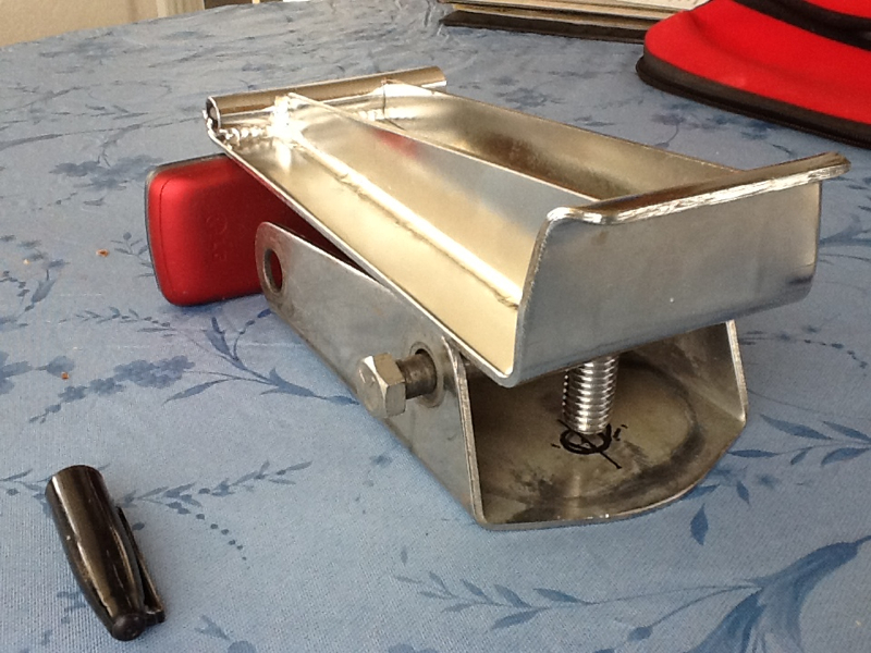

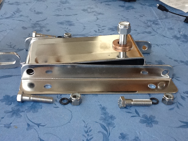

Well... you guys have convinced me to further modify this single hand C15 (it already has 200 pounds of battery and concrete just under the mast...). First picture is from sailing two days ago.
Here are some pictures of the rotating mast base. I used some bronze washers. I still have to figure out something for the rotating spreader and Ill also check out the Hobie 14 hopefully today (it may not have spreaders..).

Walt, It is towards the front. You have to miss the bolt that holds the original base plate to the mast. That is where Mike Inmon said to put it. It rotates with ease.

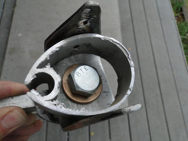

Thanks for that info - direct from the source. With my smaller mast and the large bolt I used, it ended up somewhat in the middle. If I were doing this on my Mac, I would definately buy the parts from Macgregor.

Now that's a dedicated poster, cutting his mast off to get a good picture. Doh!

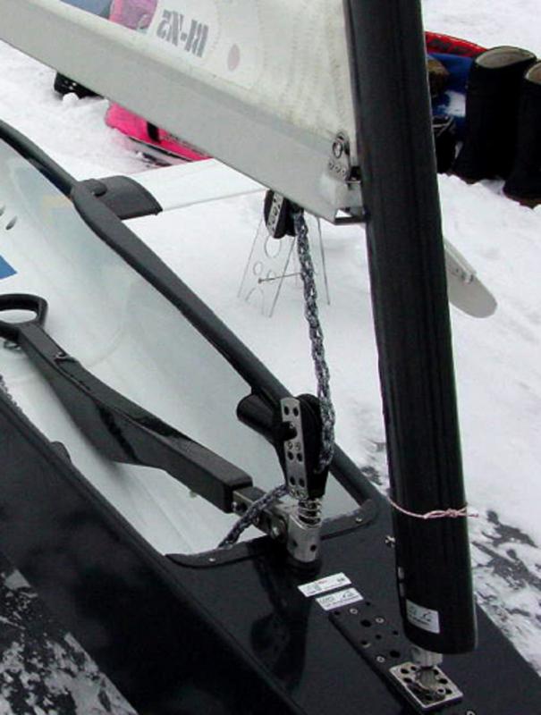

Right on, since you have a lot of experience with Hobie cats and rotating masts, I was wondering what your thoughts are on where the mast base pivot point should be.
I was looking for some pictures of DN ice boats and found several. One picture shows the pivot up towards the front but the other picture looks like the pivot is back - even towards the trailing edge??
(I see back on post 25 that you also have the pivot towards the leading edge of the mast)
Edit - I also found a picture of a Hobie Tiger - looks like the pivot is also way to the front..

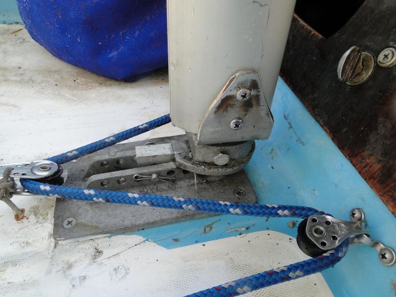

Hey Right On and R Oril:
How much did the top of your mast go back when you put the MacGregor rotating mast foot on the bottom of the mast? I guess it is called rake. So is your mast raked more now that it rotates. I ask this because the rotating part looks as if it is on an angle. I'm not sure if the cabin top of the M is on a angle too. Or why the rotation thing has an angle to it.
It looks like it is raised to get over the foot attachment to the hull part... but why lean back?
I'm going to make my mast rotate as well but, I was going to have it on the angle that it is now. (I'm guessing close to if not 90*)
I don't see any disadvantage or advantage to my idea. Am I missing some thing simple here?
Edit: Here are two photos I found. 1st. R Oril's rotating mast thing before installation. Note the right side is higher than the left.
2nd. Capt Kermie's deck top of his 26M. See the deck slope forward?

The deck slopes down. My mast is 90 degrees to the boat when level. I don,t have it raked at all. The bottom plate , when attached compensates and makes the base level .
The back stay is kept loose for ease of rotation per Mike Inmon.
I found that the new base was real close to the DB block. I centered the mast over the same location as the original.
I will have to look at the photos.

This might help. The new base plate levels the base.

Okay, I've looked at these pics and the pics in your other thread about the rotating mast...and I still have questions about the slope.
Seems to me from looking at this and pics of my mast foot that:
(1) The original mast base is sloped forward slightly due to the deck being slightly sloped forward, but the mast still stands up straight (doesn't lean forward with the slope of the base).
(2) The original mast bracket (the part attached to the bottom of the mast with one bolt) sits flat on the mast base when you step the mast, but the bottom of the mast extrusion itself essentially touches that bracket all the way around (the mast doesn't seem to rest on the bolt on my mast, but on the bracket - there's an outline where the bottom of the extrusion sits).
(3) This means that the bottom of the mast extrusion has to be cut on an angle that matches the slope of the boat deck/mast base...it can't be cut straight across. I'm really curious now, because I haven't looked at this very closely until this discussion...the bottom of the mast extrusion has always been covered up by that bracket, so I never looked at it!
(4) So if the new RM bracket that goes in the mast base on the deck (the part with the vertical pivot bolt sticking up out of it) makes the old mast bracket sit flat (the part you drilled the new hole in), then it seems to me that the mast would now lean way back due to it not being a straight cut on the bottom...but you say it is sitting straight up/down...:confused:
Now I'm wondering how I ever adjusted the mast rake...in the original mast setup, the mast extrusion itself (and thus the weight and downthrust) must rest on the two bolts (the one thru the mast and the one thru the bracket) and not the mast bracket itself in order to change angles, or else one edge of the mast extrusion would not rest on the bracket as soon as you changed the angle...everything's not touching everything else here...:snooty: BAH! Someone help please! :eek: (LOL!)
I think this is what finding41 was getting at too...and now that I've looked at all the pieces, I'm thinking the same things...don't see how you did it without it changing the angle of the mast. (not questioning that it worked for you, just trying to understand how it can work with the angles the way they are)
