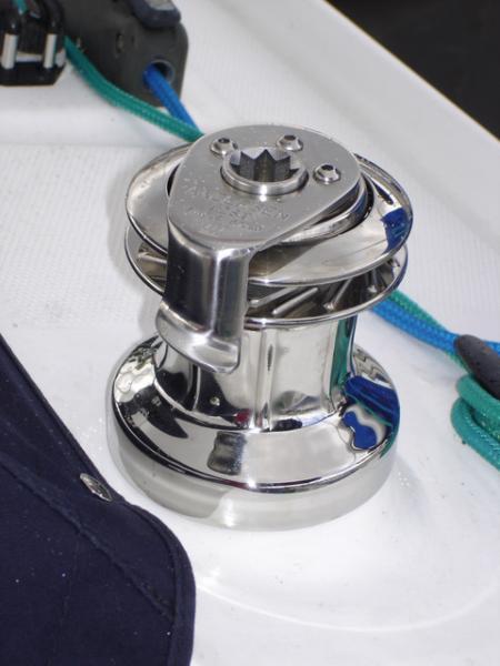

I found the factory winch and jam cleat required 3 hands to trim the jib so I installed a pair of Andersen selftailing winches on my 260.
They work well and I am quite pleased with the upgrade, they allow one handed jib trimming. I bought the all stainless steel model.
These Andersen winches bolt right on. They are a bit bigger than the original ones but they fit well and do not look oversized.
