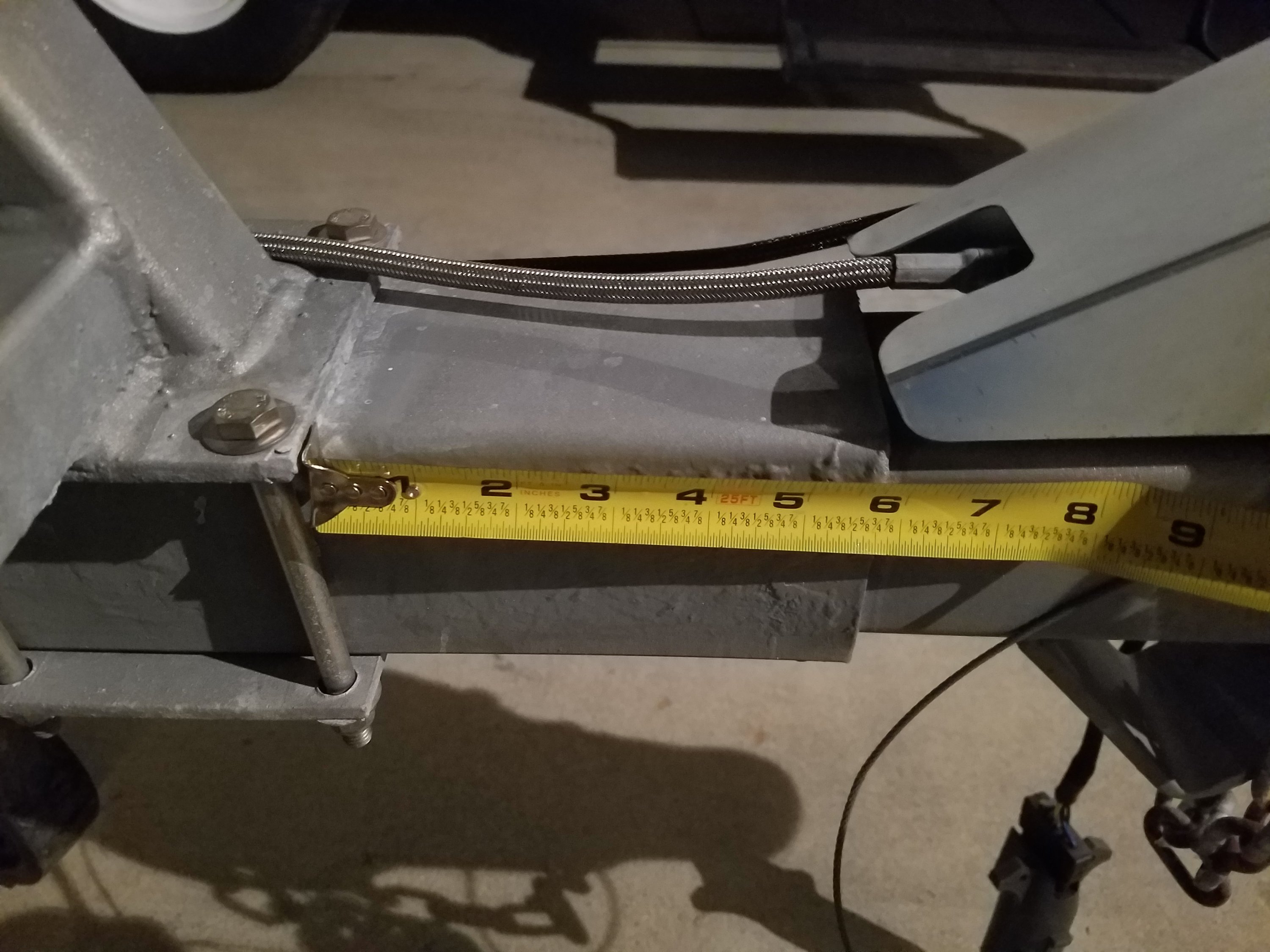

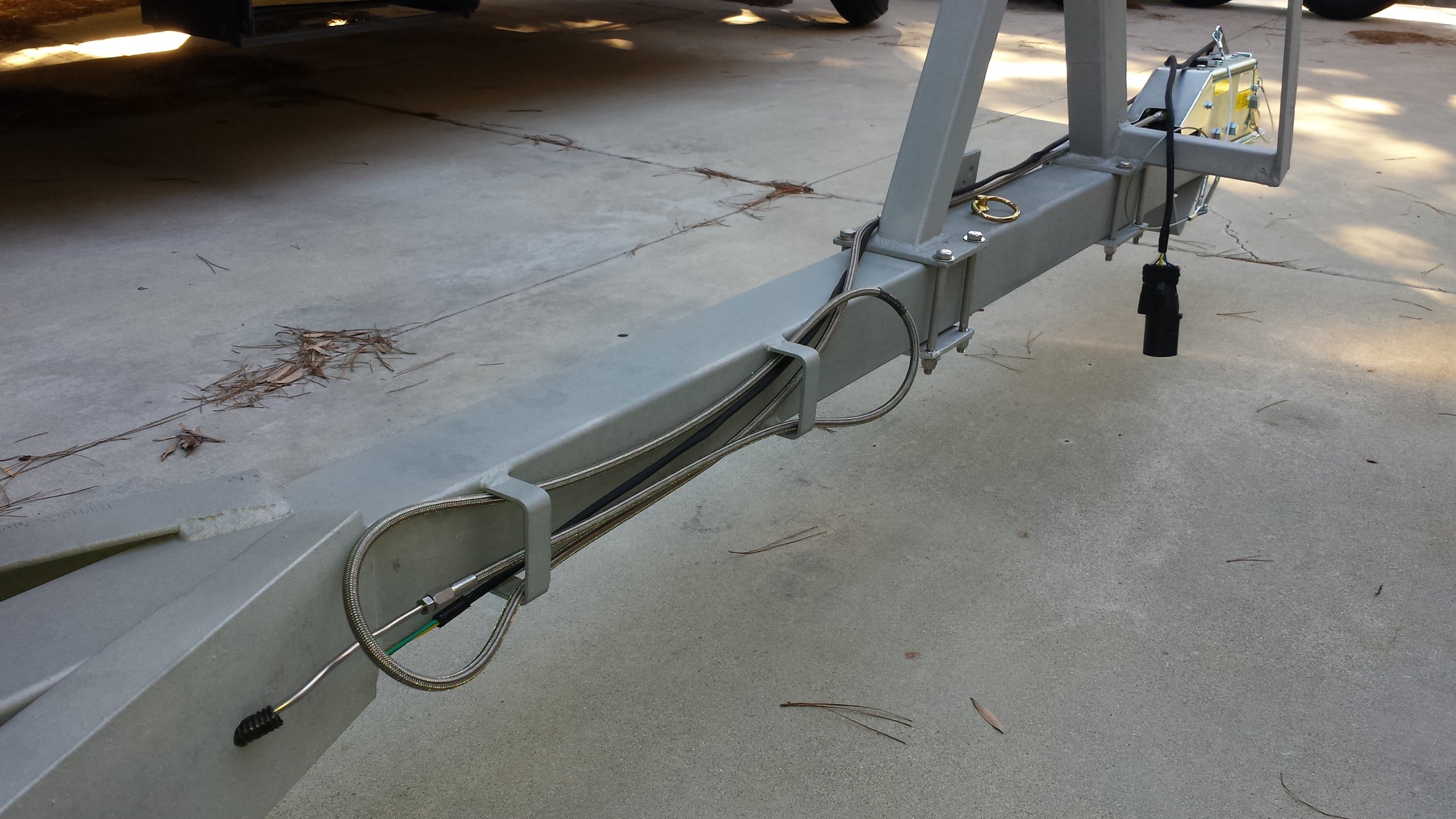

Tyler, here's a picture of my 26 trailer, the tongue should be pretty much the same as the 260 trailer. My bow stand is 5-3/4" back from the end of the square trailer tongue (not the extension) . Measure yours, see if it has been moved back. Looking at your pics it looks right, but when you say, you climb on the transom and the tongue lifts a little, that doesn't sound right at all. When I climb up the stern ladder, my rig doesn't feel like it's gonna tip at all and I weigh 220 lbs.

Doug, I haven't taken a measurement yet, but it looks exactly like that to my eye.
I don't know how much it lifts the bow and haven't ever confirmed that it actually lifts the wheel stand, but the weight of the trailer definitely shifts. I weigh 165 or so and I was a bit nervous to climb up when it wasn't attached to the truck. Now that it's attached I jump right up, but I still feel a bit of an unnerving weight shift. Maybe it's like heeling over, I just have to get used to it and know that I won't tip the boat :)

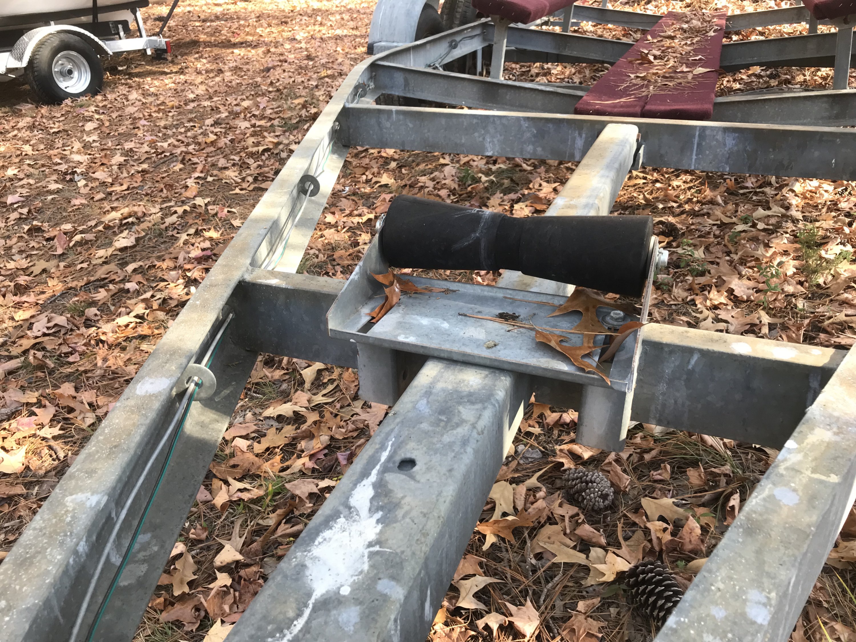

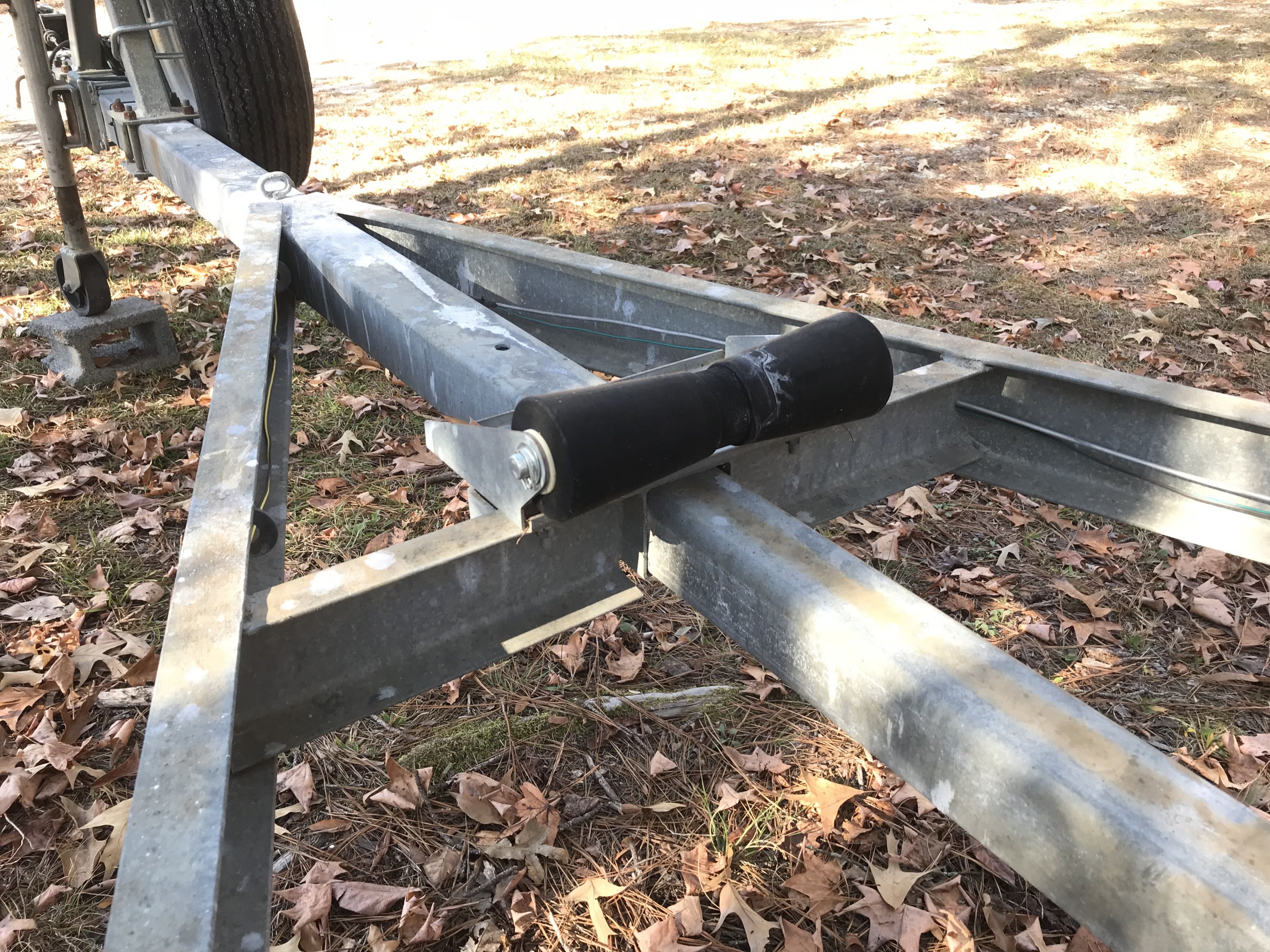

Tyler, have you tried moving the boat say two or three inches forward on the bunk boards which you will have to move the winch stand back. In addition I noticed one major issue on the trailer. Under the bow of the boat, it rests on the damn roller, suggest lowering that down all the way or removing it. You could put on what @Kermit has on his trailer. Kermit take a photo. The way it is now happens to make it harder to load the boat on and off the trailer.

I hope to take the picture tomorrow (Thursday). If I don’t go tomorrow it’ll be at least a whole nother week before I can take it.

Here you go.
