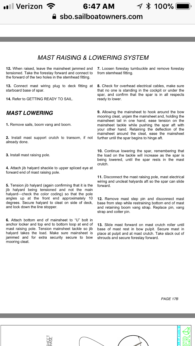

Dang, you’re right when you say the instructions are “a bit light.” Here’s a screen shot of the instruction. Step 13 is what you’re looking for. It says to slide the mast forward. Talk about an over-simplification. I searched for a video showing the process but didn’t find one. Maybe @Crazy Dave Condon, @Regular Guy, @cephius (Dave) or anyone else who trailers his boat regularly can chime in. My gift of instruction is failing me on this. Once you see it you’ll understand. Those struts are there to help. (Sorta like the government.)

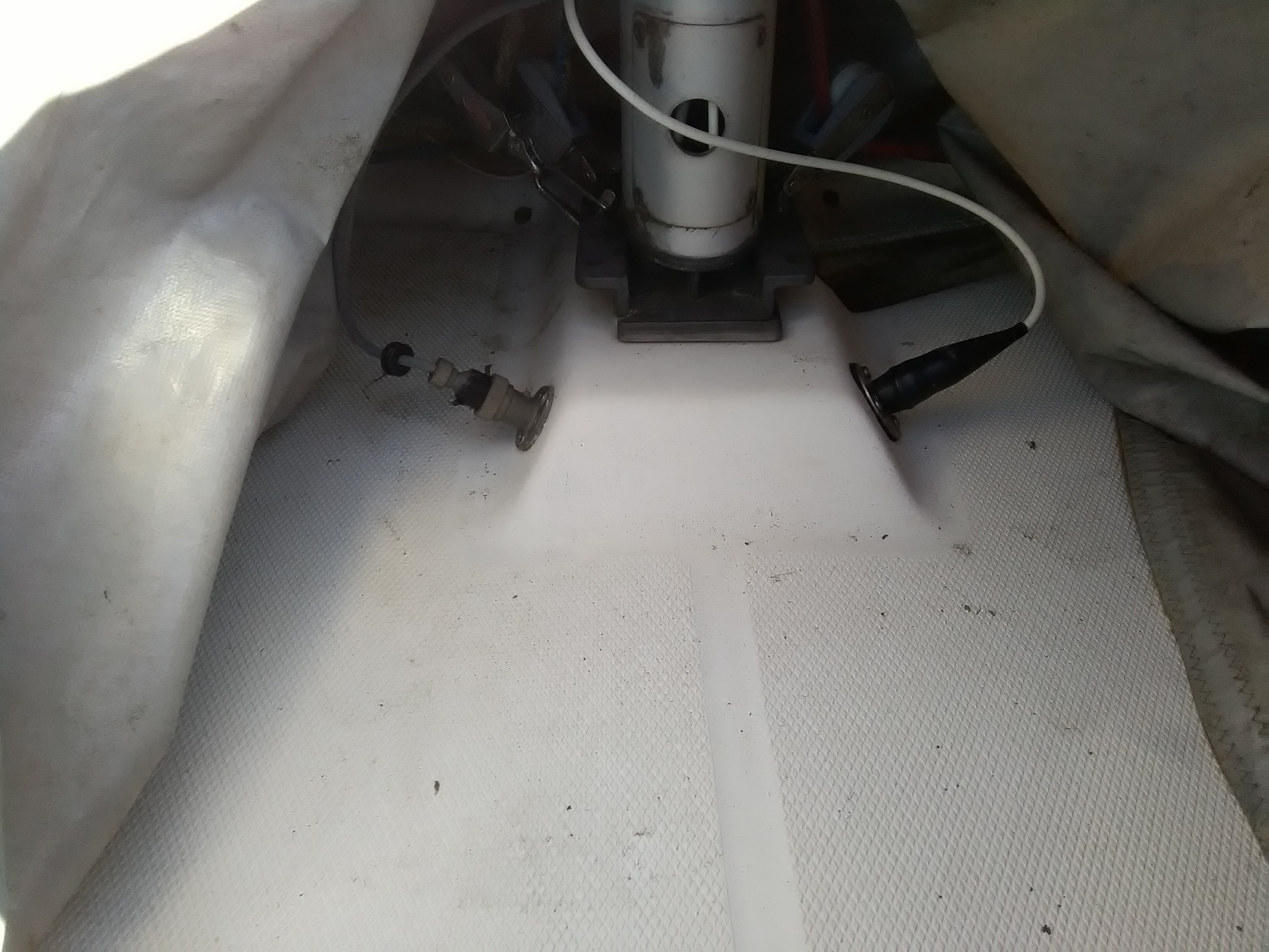

here is a pic of the mast electrics the LH has a screw cap which I unscrewed but the black core would not pull out with pliers. The RH black core doesn't screw in not sure how to get out other than unscrew the 3 flange screw that the black core pushes into.

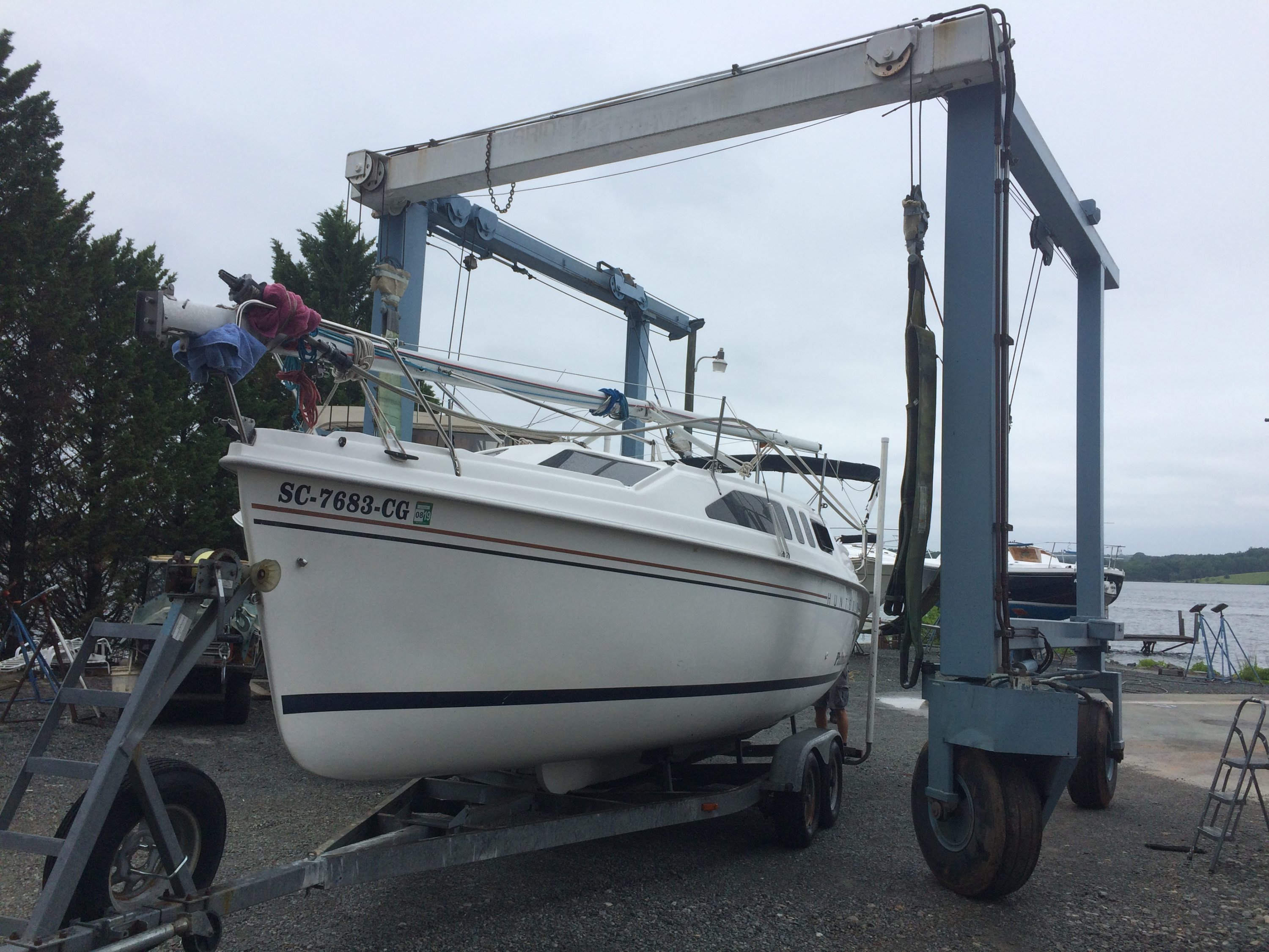

Tyler, I’d love to see pictures of the way your mast is stowed. Here’s mine. Zoom in and you can see the struts are facing forward. @iangraham the picture might help you see what I tried to describe. (I just now remembered I have this picture.)

thks for the pic and advice but pls offer opinion on the mast electric disconnect photo how are your the same how did u disconnect

I unscrew them. I know that seems like a simple answer but that’s all there is to it. I’ll try to get a picture next time I’m there but it could be a while. Does anyone else have pictures?

I just reread your post about the connectors. If soaking them in WD-40 doesn’t help get them unseized you might have to cut the wires and replace the connectors. It’s not a hard job but it can get tricky since everything is small. I would try grabbing them with channel locks to unscrew them. But I wouldn’t be surprised if you end up replacing the connectors anyway.

Looking at the cable photo are your boats the same. The right black connector with no obvious retaining screw rings just bigger piers turn anticlockwide and hope for the best. Looked at my furler should had photoed it but it loks like you release the tension on the forestay by rotating a barreal bolt on the forestay below the furler. then With the forestay loose undo the fixing not sure which on under the furler which secures the fore stay to the stemhead. Is it ok to slacken the mast support post both ends on the drop to stop rotating metal scraping? To undo one end of the posts reduce rear mast over hang which end to undo top or bottom? Thks in antipation. When I have all the tools and knowledge 1 more trip this month to drop the mast for transport. thks for talking/writing
