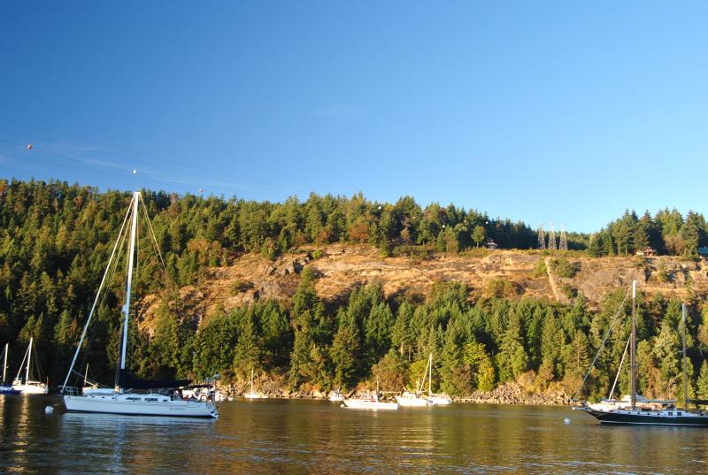

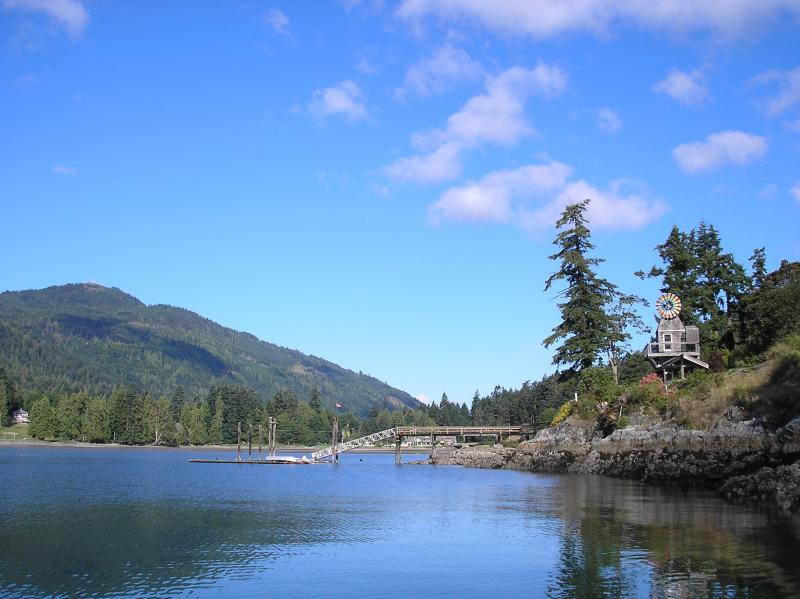

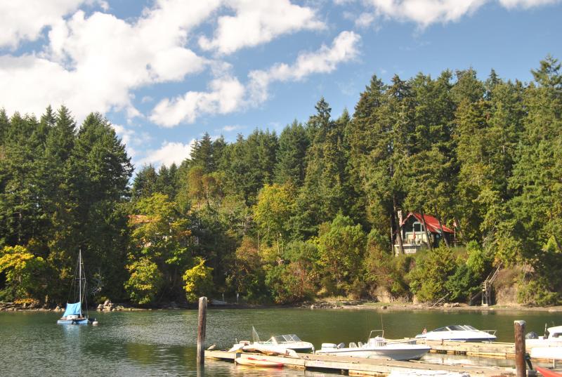

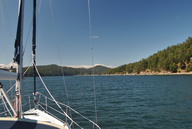

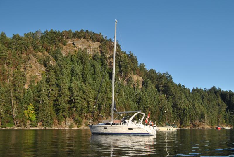

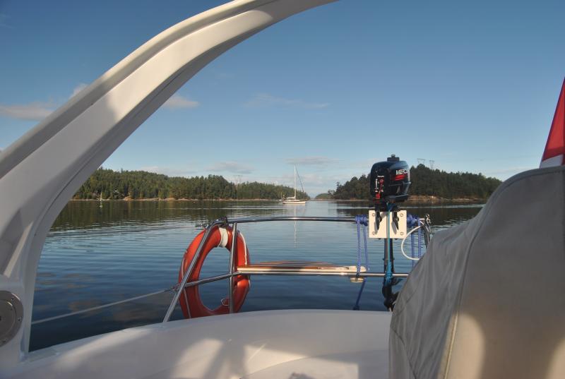

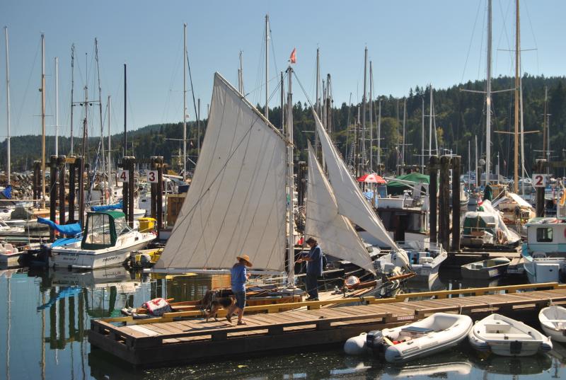

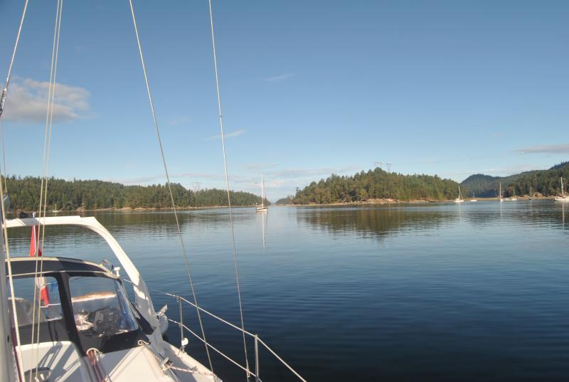

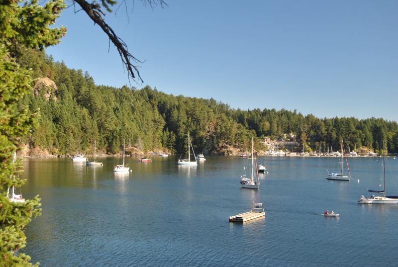

Prepare to have your mind blown by the scenery if you're here by summer.
Don't know if I can get excommunicated from SBO for posting too many pictures.

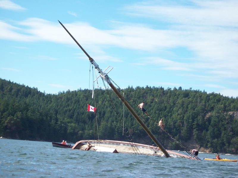

...................... when it's as crazy as this :eek:.
When it comes to narrow and often shallow passages like Gabriola, Porlier, Active and Dodd's Narrows, we ONLY go through at slack current- right to the minute. There isn't a reason in the book that would induce us to do otherwise. Alright, maybe with a one foot change in tide we might go a little sooner or later.
But other than that, watch the weather and read the bible (aka. Canadian Hydrographic Services Canadian Tide and Current Tables Volume 5) and you can't possibly go wrong ........... dagger board, fin keel, full keel, kayak, sampan, raft, rubber ducky, water wings, bathtub, or whatever you can find that floats.
