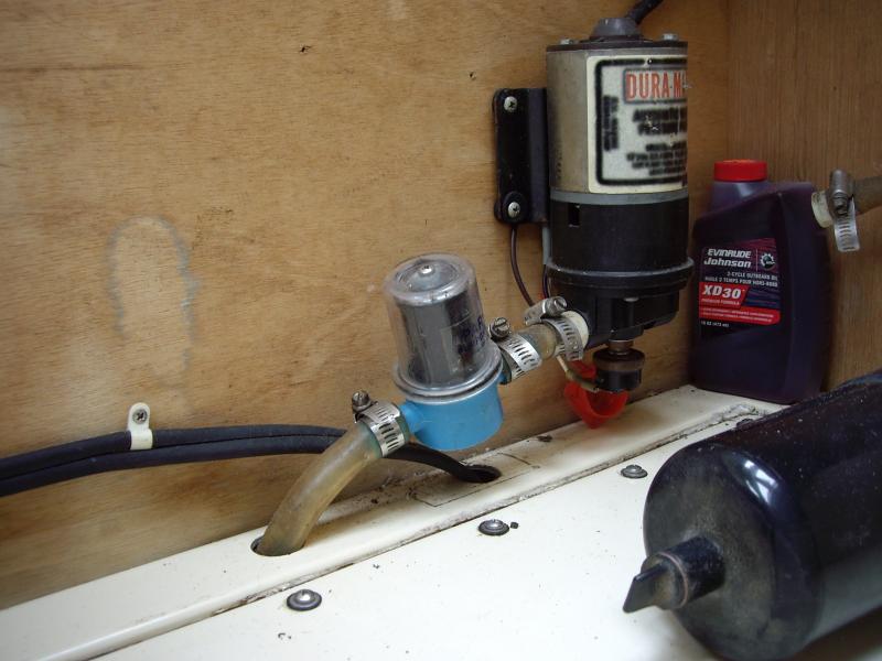

Not sure if you are interested but while I am posting pictures....I have a freshwater pump mounted under the stern berth, you can see it here:

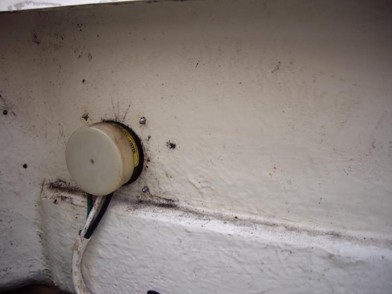

Mine actually had a switch on near the fuse panel which would turn on the pump. I also had the original attwood faucets, I believe they will work with pressurized water, you just turn them instead of pumping them. I didn't like this setup so I replaced the faucet with one that had a little button next to it that turns on the pump. I wanted to get the ATTWOOD 61425 which will switch on the pump when you turn it but didn't want to drop $100.

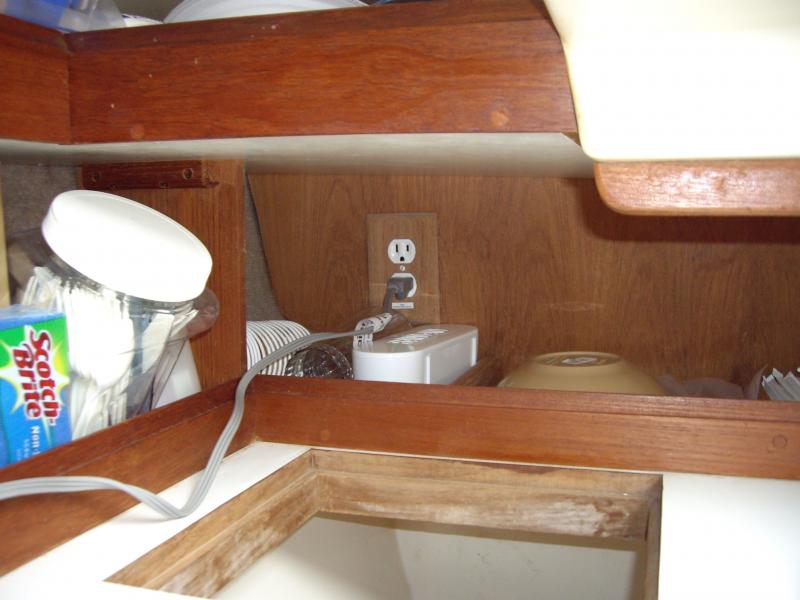

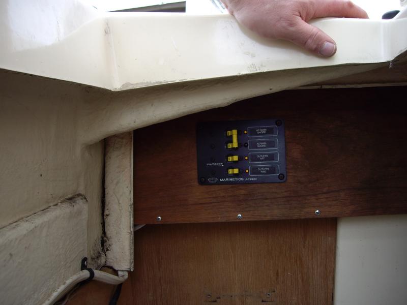

Will upload pictures of shore power set up and water pump area/units.
I spent all day on the boat fixing this that and the other, finally remembered that I had said I would take pictures. Got home and promptly fell asleep. Will upload tonight to the forum.
I pulled the accumulator, the pump and the filter off and took them home. When I woke up, I went to the workshop to take a look. The mould build up in the filter was increadible. Luckily it is the type that has a washable stainless screen. Sorted it all out and left to dry. The accumulator had some of the same. I soaked that in citric acid overnight. Will rinse out today. The pump works, but a fitting is snapped off inside. Replacement is easy, but you have to make sure the check valve is in the correct direction for flow. Once I have time I will clean out the pump to avoid any mould sludge from entering the filter or lines.
I think with all of this effort, I will replace all lines with fresh, then flush and sanitize the tank.

These pics are great. Thanks so much! When I get started on my shore power retrofit I'll take pics too. I'm setting up a breaker box to be mounted on the wooden panel facing the galley in the larger cockpit locker. I think I'll put my connector socket on the angled back of the locker facing the transom vs. having it face the foot area. Only issue I could see is making sure there is room to get the cable in and connected.
Aug 11, 2011
1,020
O'day 30 313 Georgetown MD
"Only issue I could see is making sure there is room to get the cable in and connected."
Agreed. The Shore Power Cable is fat and should have room to bend. I have my fuel line from two 6 gallon tanks coming out through a covered vent hole in the area you are considering. My guess is as long as you can plug in and get your hands in to close the cap when not in use, it really doesn't matter.
