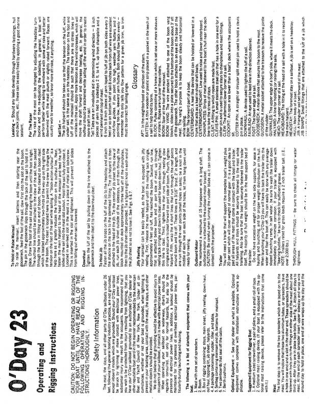

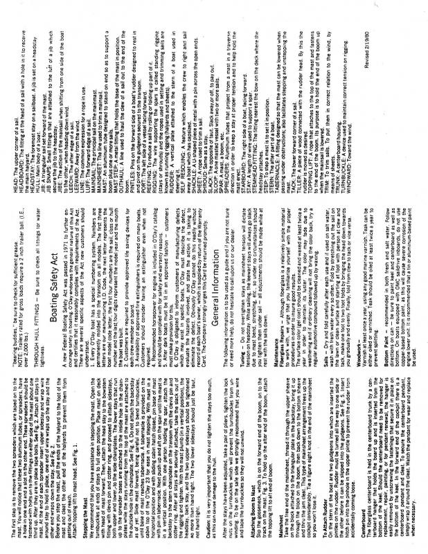

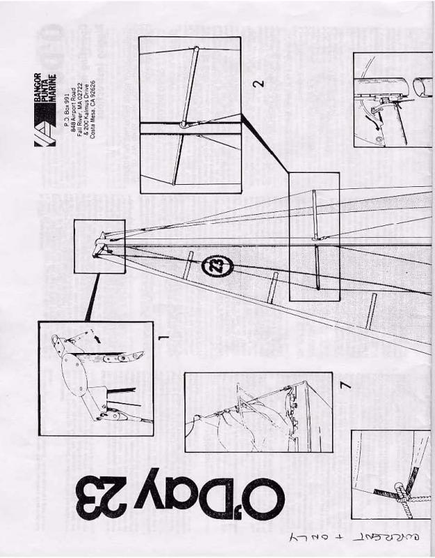

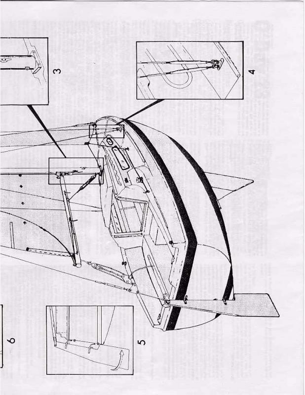

Mike: here is everything you ever wanted to know and probably all that Oday ever printed for your boat. Enjoy and welcome to the club!
btw, I've tried to upload this file to this website a number of times, and it never seems to work.
Note that because of the size of the file as a whole, I am splitting it up into several parts.

You probably want the other side of the "manual". Yes, the manual is a two-sided single sheet of paper. Simpler times...
I think this file is already uploaded to this site and is available in the Boat Info section.
