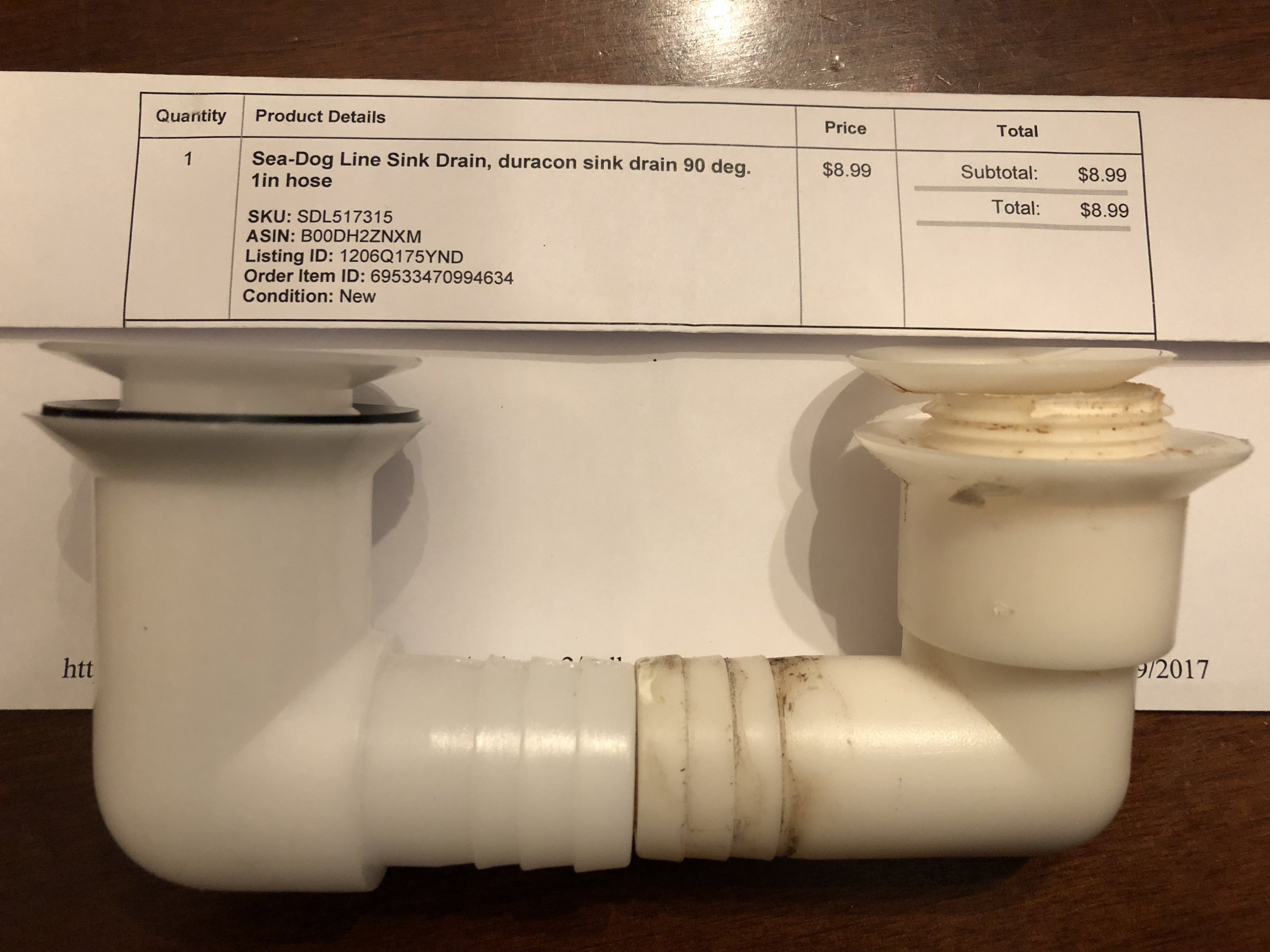

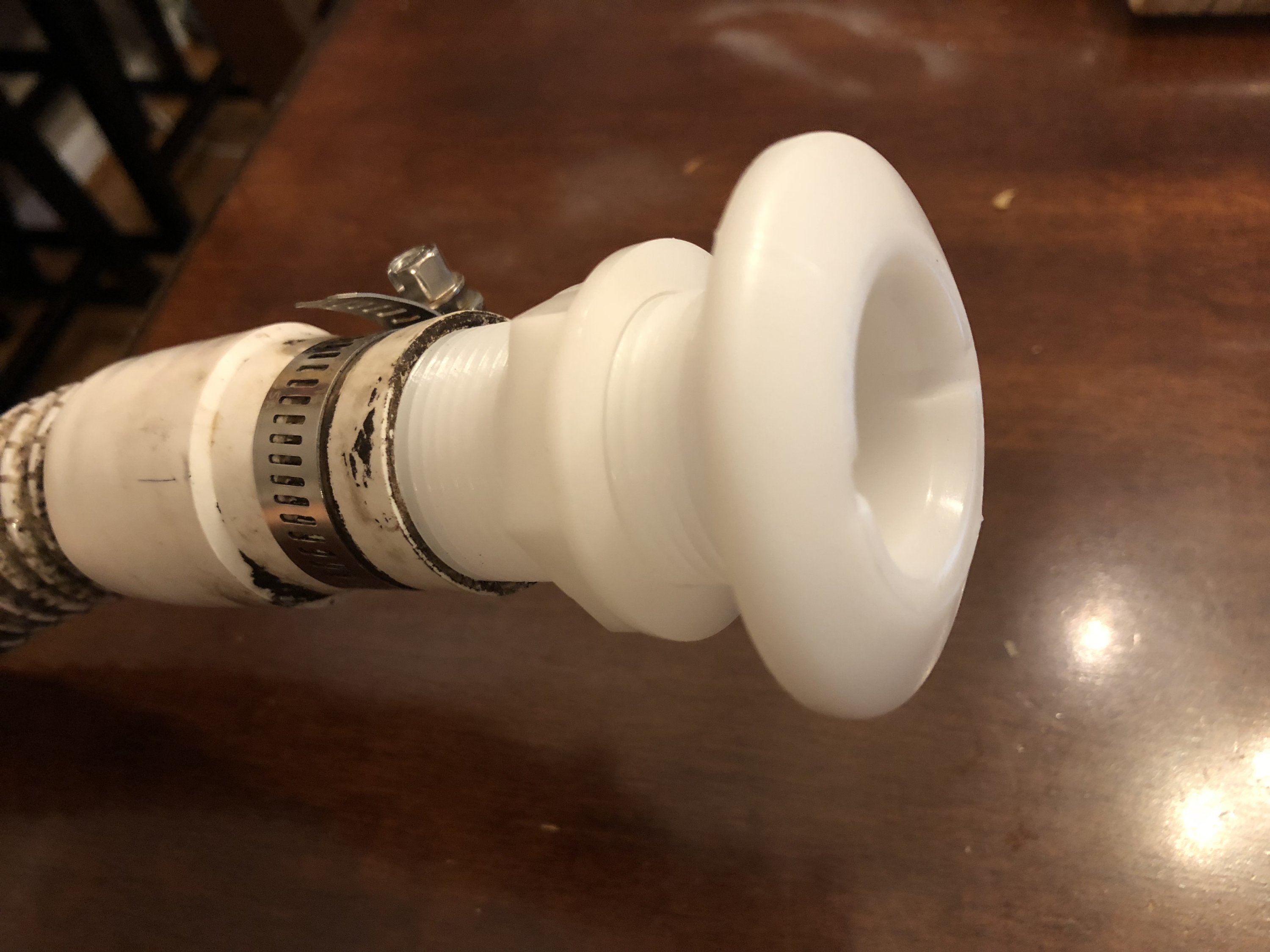

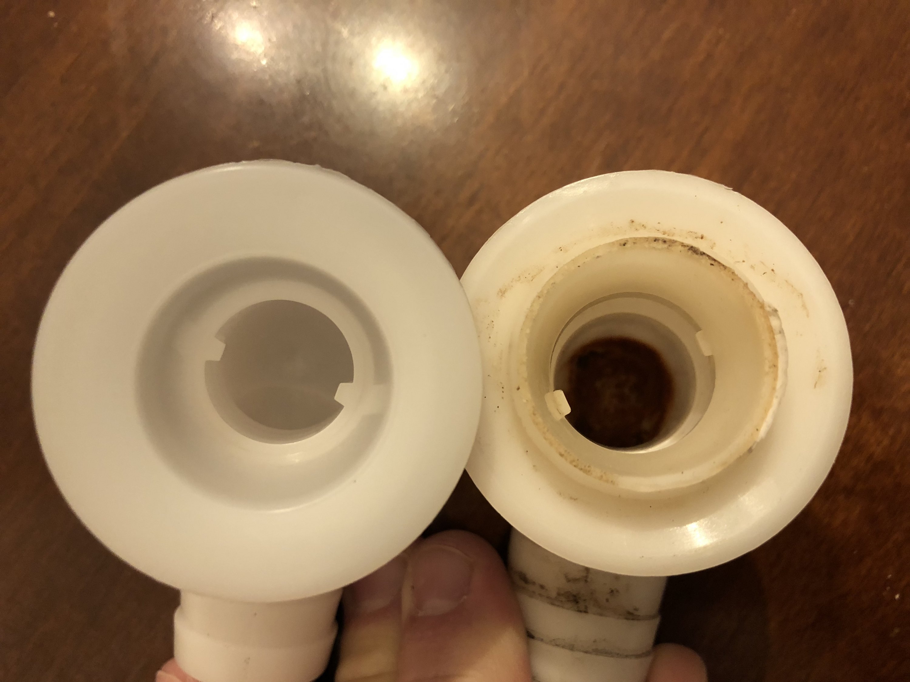

Hi everyone! So, I've finally gotten the correct fittings for the sink drain and here's the list! Yes, they are nylon, but it's kind of the only ones available I could find for a good price. I'll update later once I replace the rest of the thru-hull fittings. These are Amazon links.
Sink drain: Sea-Dog 90 degree http://amzn.to/2zoCVNm
Through-hull: Perko 1-1/8 http://amzn.to/2BWSoqA

The sink thru-hull on my boat doesn’t have a seacock. It is above the water-line.
