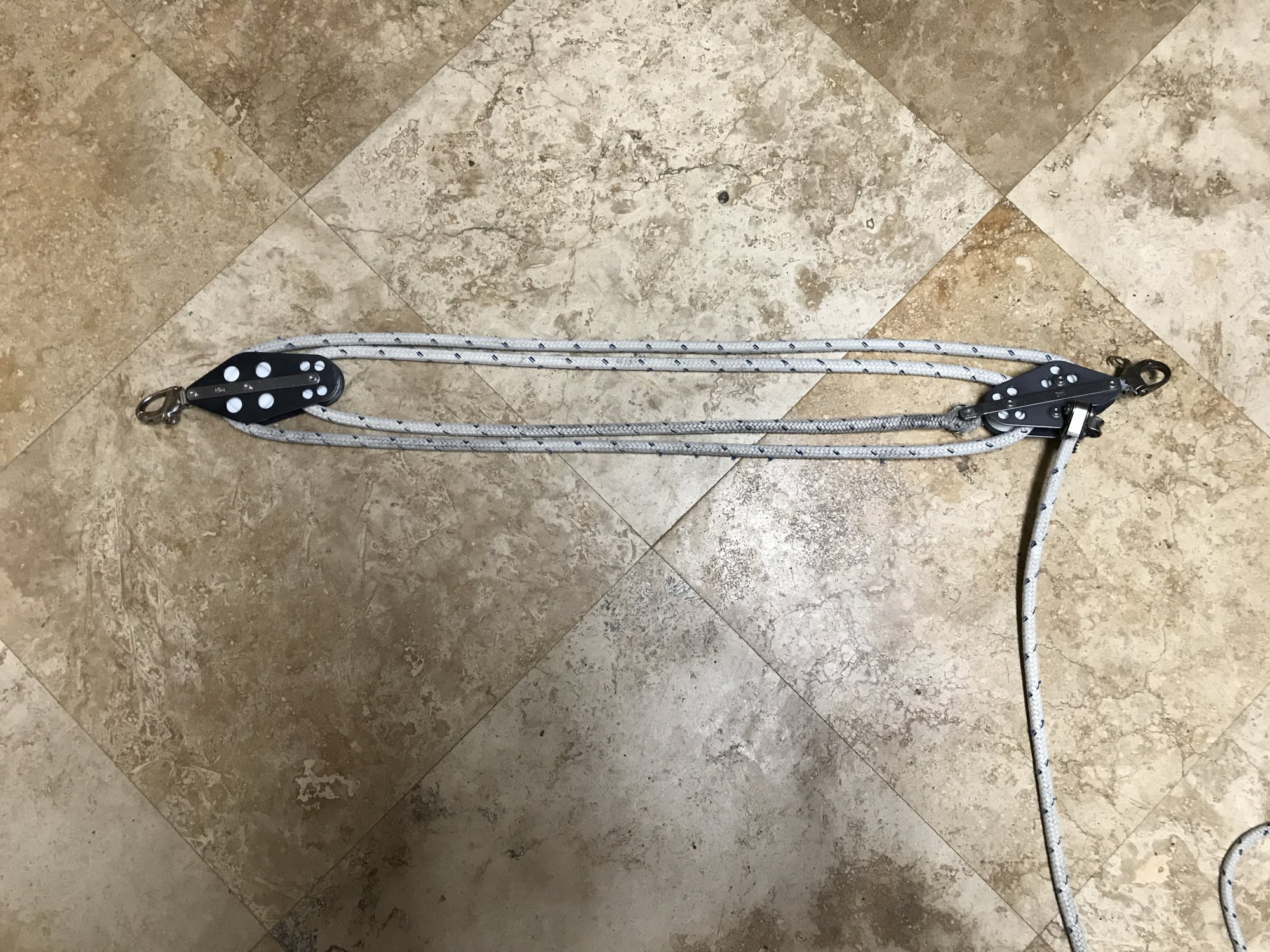

Thank you for the reply. We first tried to use the boom vang but it was too short. I think the PO modified it to have less clutter in the cockpit. I then used a two pulley set up that was in a pile of stuff that came with the boat. However, it’s design gives me much less mechanical advantage. That may be why I’m having to pull so much harder. I’ll rig something else up tomorrow that gives more advantage like the vang would and give it a try.

I’m sorry. I misspoke (mistyped?). I was using the main sheet but it was too short. I’m going to have to lengthen it.
And yes, the jib halyard is on the other side.

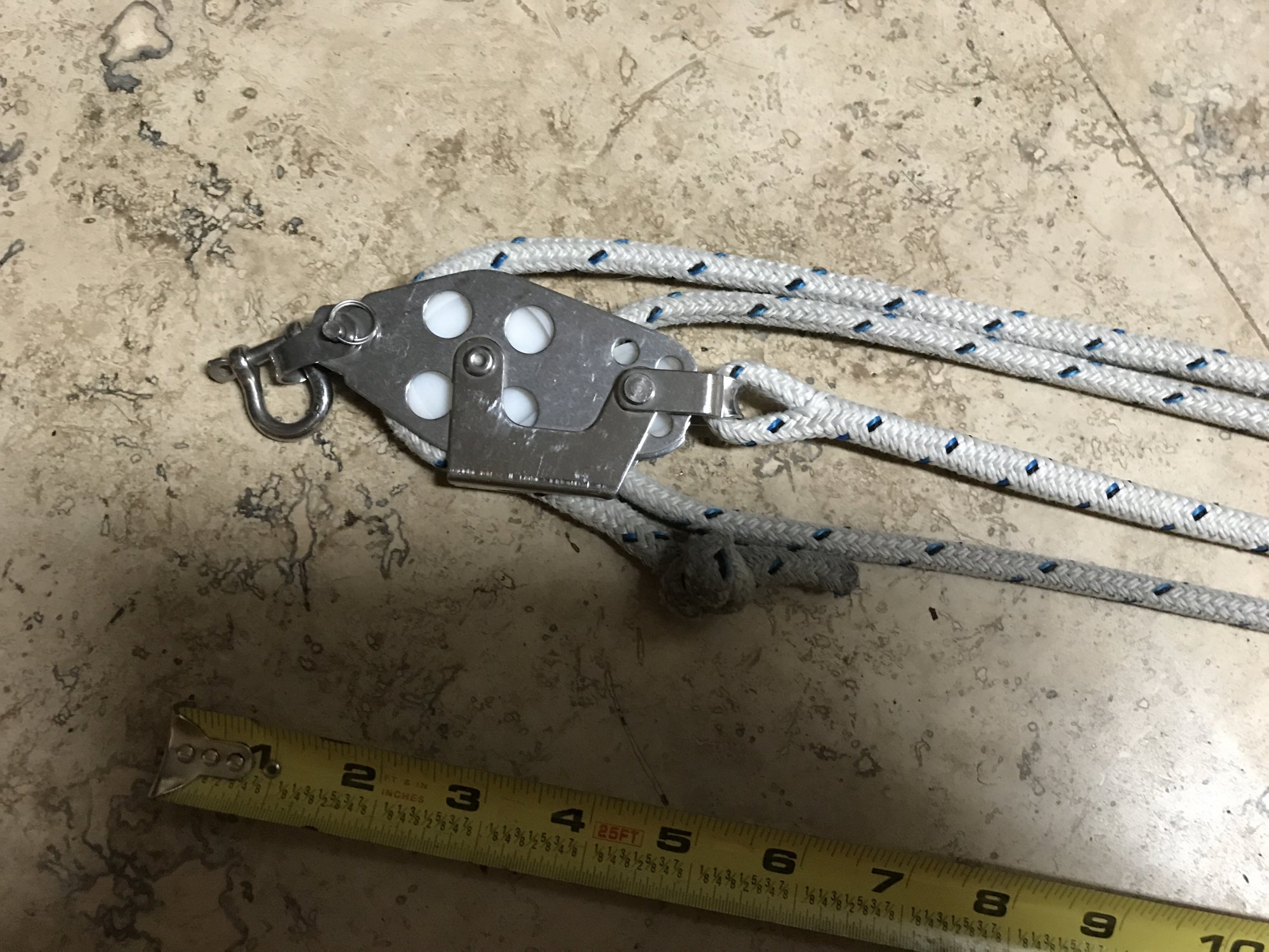

Because the two in the above pictures were too short, I went with the rig I found in the pile of stuff. However, it’s only 2:1. I believe therein lies my problem.
I sincerely appreciate the input from all of you. I believe we found the problem.

The second one you posed looks like the one I have. It extends maybe 7 feet or so which is enough to hook it up. That is what I use with success. If it is not long enough, try the line from the store here. First one I have not seen but maybe a replacement for the main sheet?

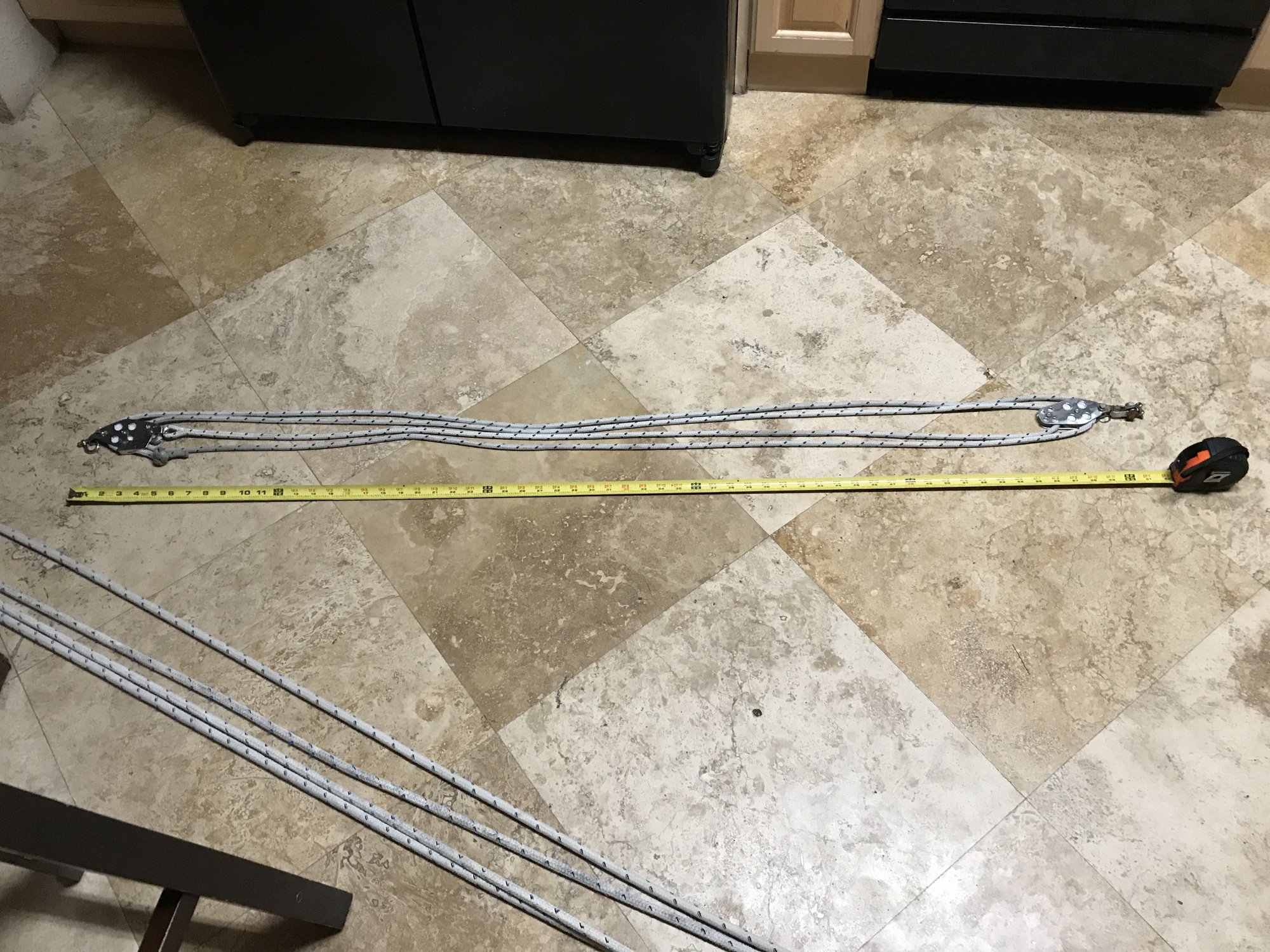

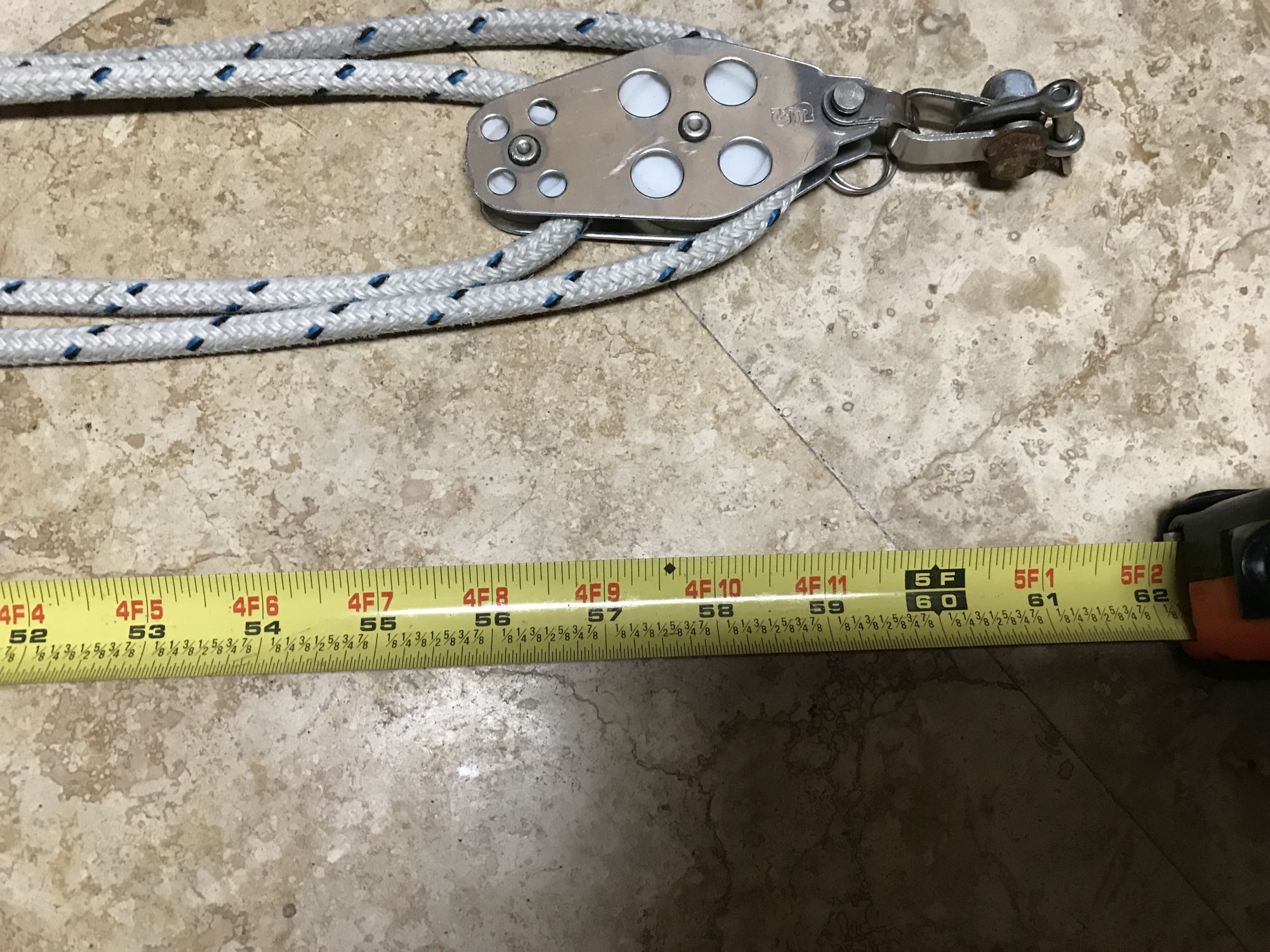

My longer one (9 feet) should work then but it didn’t reach.
I believe the PO cut the rope on the one like yours. The whole unit is just over 5 feet long when completely extended.

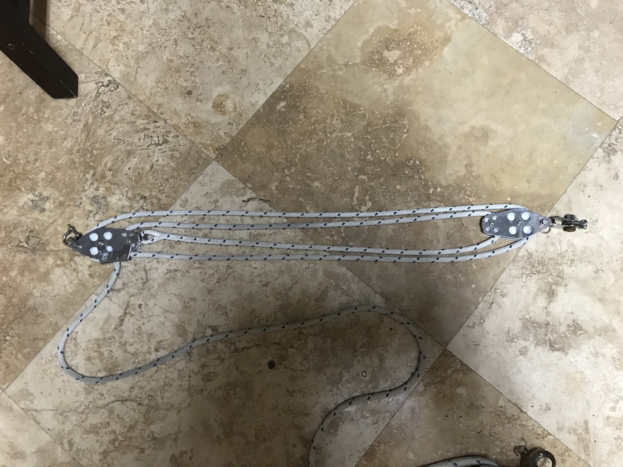

Looks like the line was shortened. I have two block and tackle setups because there is so much extra line after the mast is up and the main sheet is moved back to the boom. It should be long enough that the blocks are attached to the gin pole and the eyebolt in the anchor locker plus about 4 to 6 feet
I agree it must’ve been shortened. I have nowhere near that much line.
Is the second one I posted the factory mainsheet? It seems light weight.
When you say you have two, do you use one for mast stepping and the other as your mainsheet?
